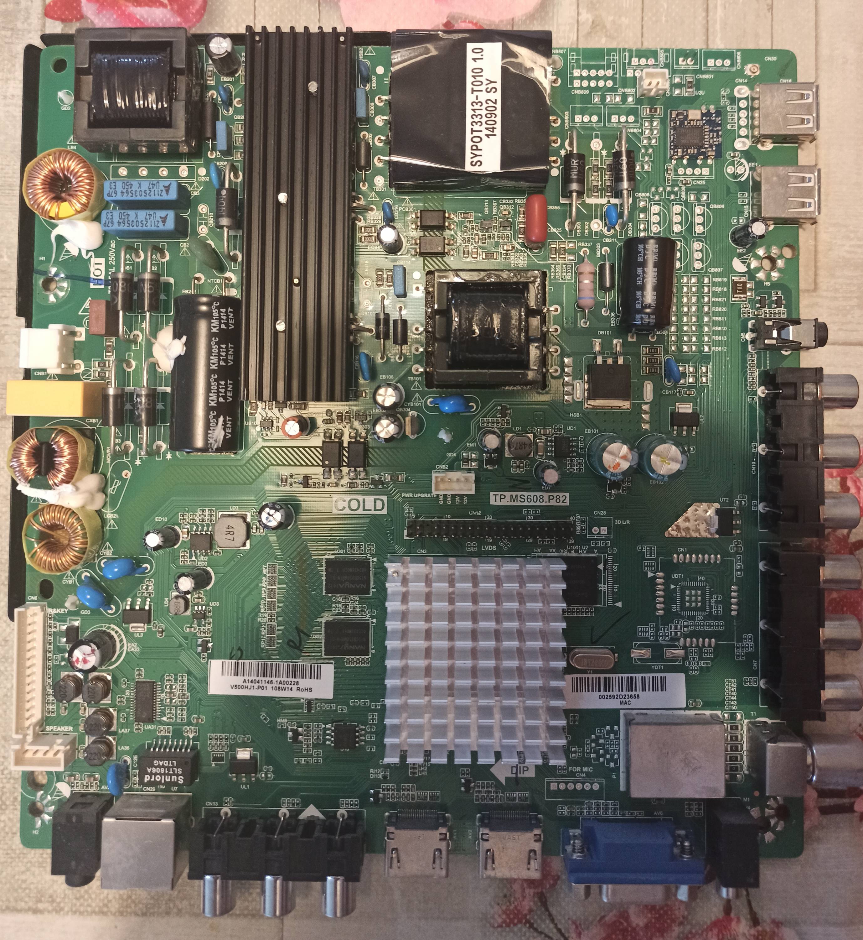

    Hello Friends

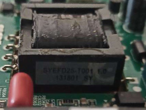

    I need a schema for that transformer SYEFD25-T001
    Also, link where to buy it
    I couldn't find this at all
    Please look at the added photos.
    Thanks for the help!
    atari
    Re: Chinese TV looking for Transformer SYEFD25-T001 in Board TP.MS608.P82
    Can we see good clear straight shot pictures of the whole top and bottom side of the board?
    What is wrong with the transformer? burnt?

      I suspect the transformer is bad and I don't have a schema.
      This transformer have got in one pin more than 600V on primary side and after that all the components have 0V. (Secondary has 0V)
      All the area around the primary side has high voltage more than 600v.

        Faulty PFC circuit.
        • R_J
          • Jun 2012
          • 9624
          You are not using the proper ground to measure the voltages. you need to use hot ground to check voltages in the primary.
          Check the voltage ACROSS the large elec. cap. in the primary, then use the negative lead of that capacitor for all other voltage checks on the primary side.
