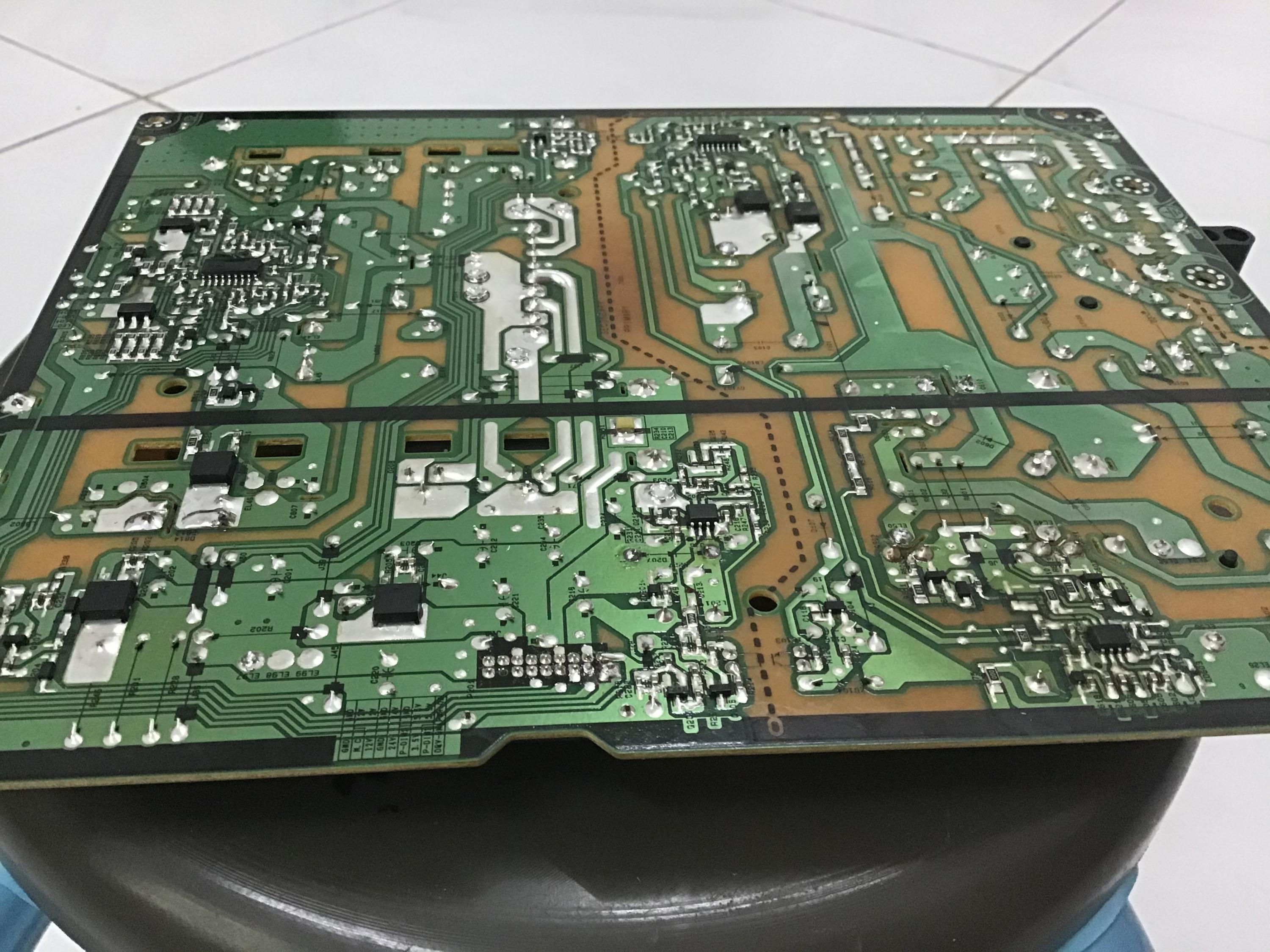

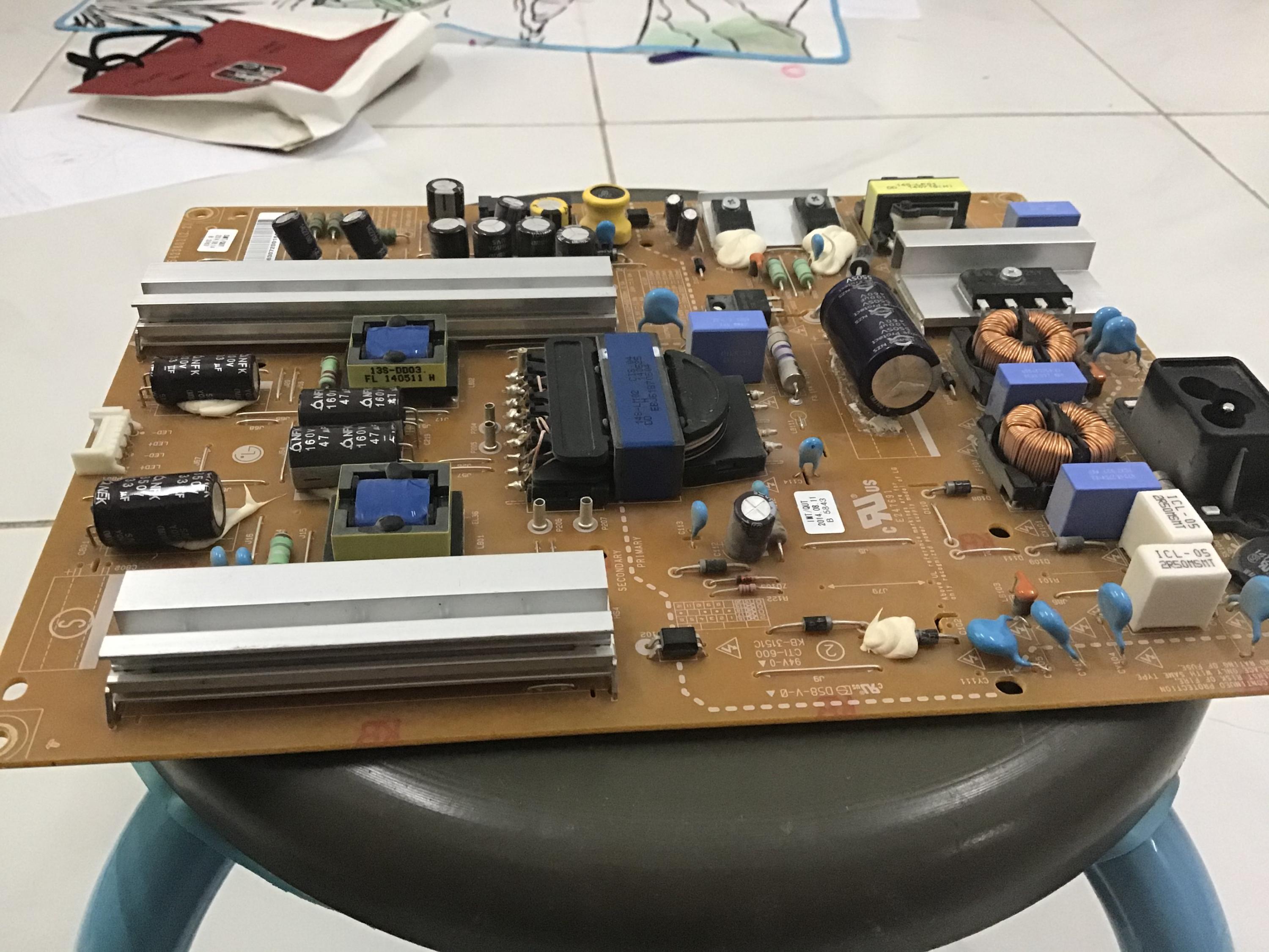

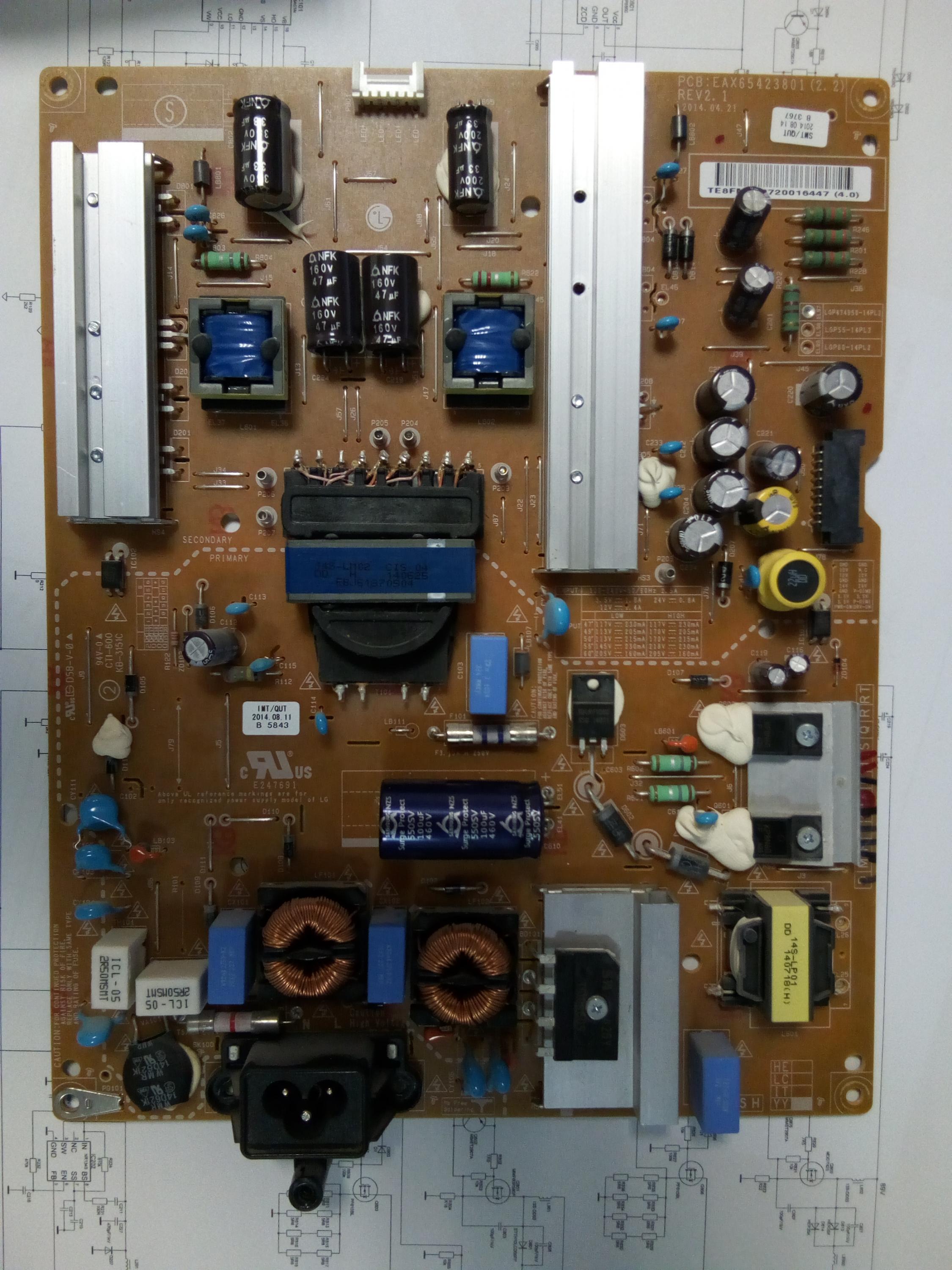

      Re: Lg tv - 47lb6530-td
      Can we see good clear straight shot of the whole top and bottom side of the power supply boars?

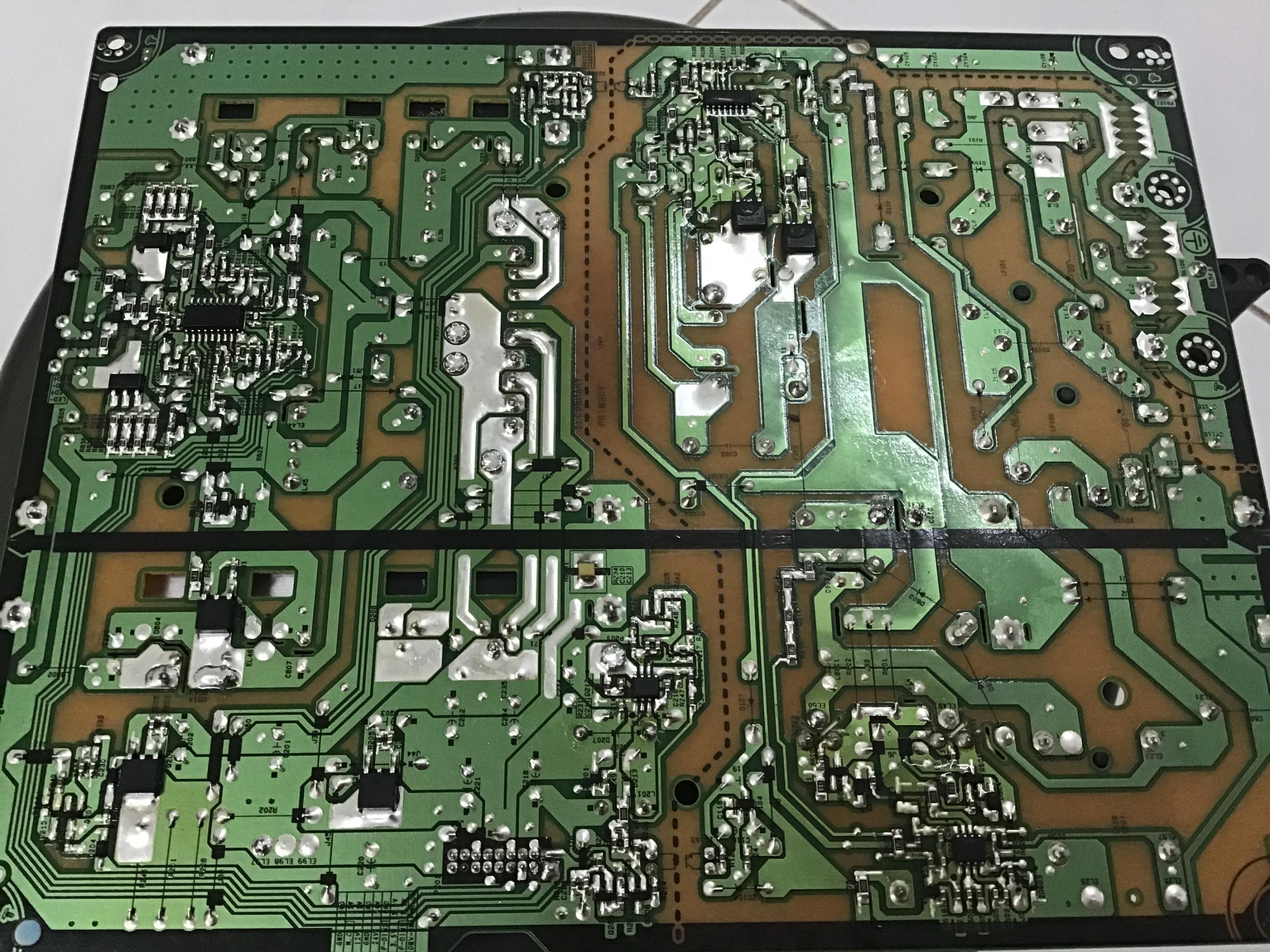

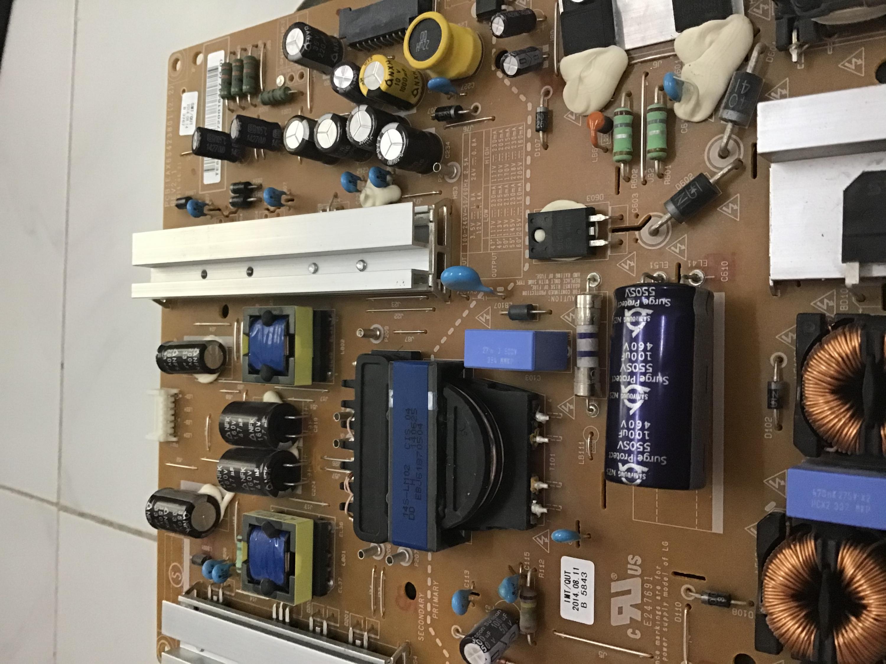

        I really don't know what just happen. but I'm getting now the voltages 3.5v,12v, and 24v but no backlight. but no voltage reading at DRV-ON, P-DIM1 and P-DIM2. as I understand to the BASIC LCD TROUBLE SHOOTING you had shared to me (thank you for that). 12v and 24v would not turn on without pressing the power button switch. but on my case, once the tv plug in to 220v the red power indicator immediately blinks 2 or 3 times and become steady without pressing the power on button. and at the same the other voltages are on except for those DRV-ON, P-DIM 1and 2. I begin to doubt the mainboard is defective.
        I uploaded the PSU images.
          Why would you doubt mainboard issue, drv-on signal COMES from mainboard so I am doubting the mainboard.
            Thank you guys for helping me out. I would replace the mainboard.
