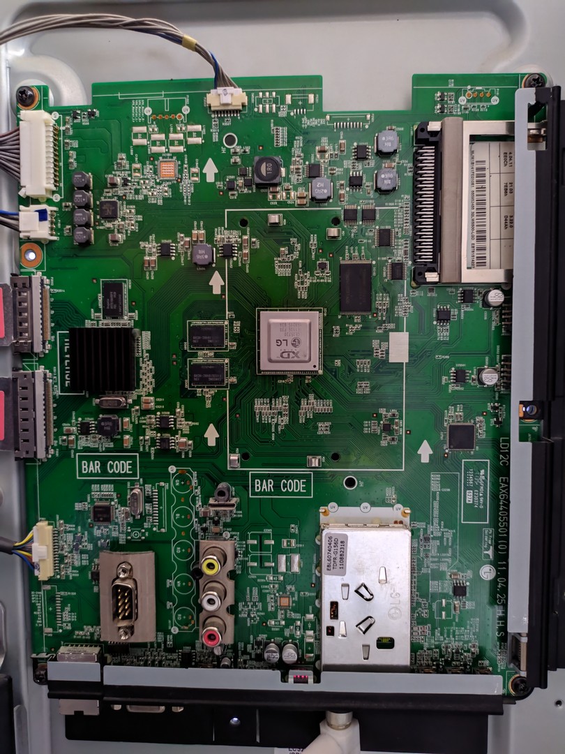

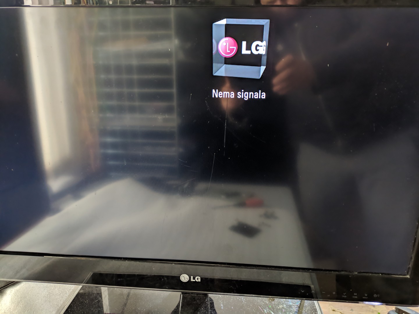

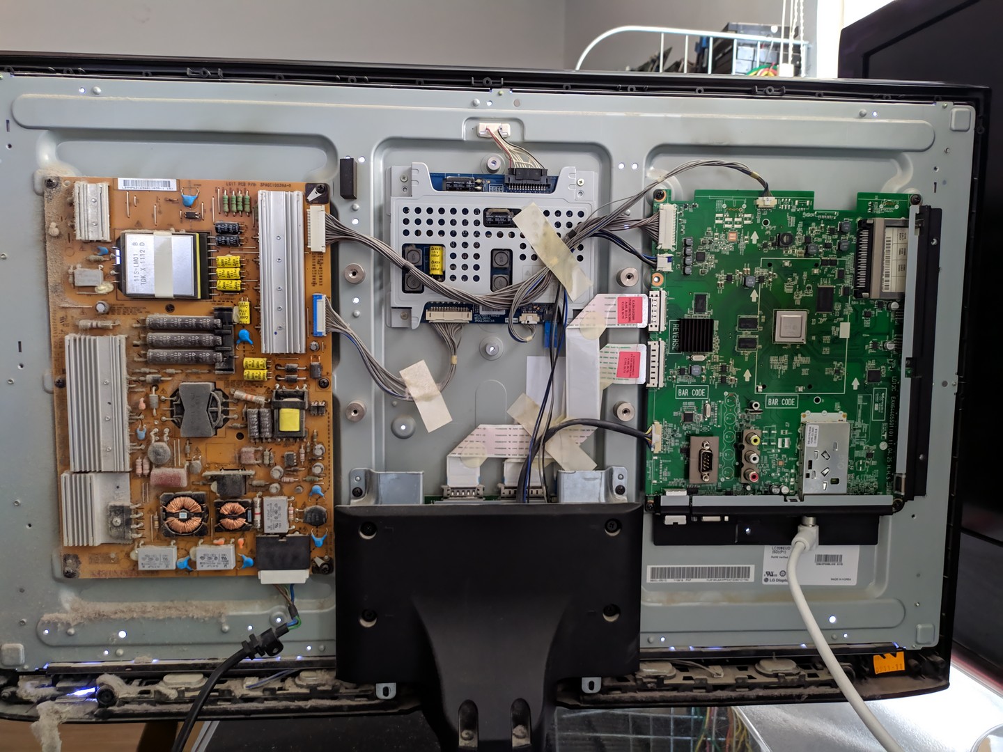

    Tv work but no picture. only say that no signal.
    About a month ago tv not working at all. i do reflow chip on main board and tv works for about mounth. Do i need reflow again?

    Sure try another reflow if it works consider a fan solution to keep the chip cooler.

      reflow again. tv works. now i need to figure out how to do cooling.
