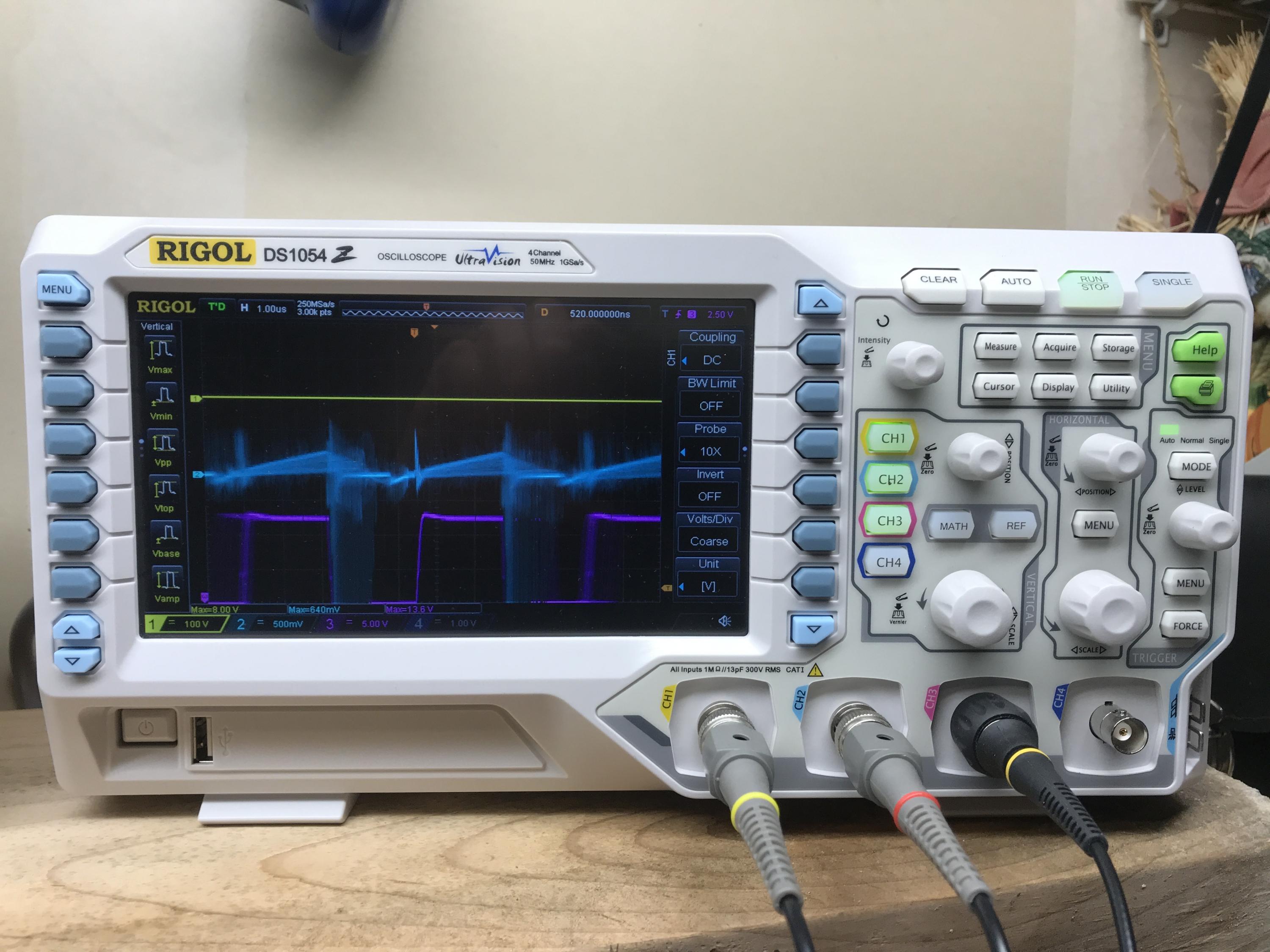

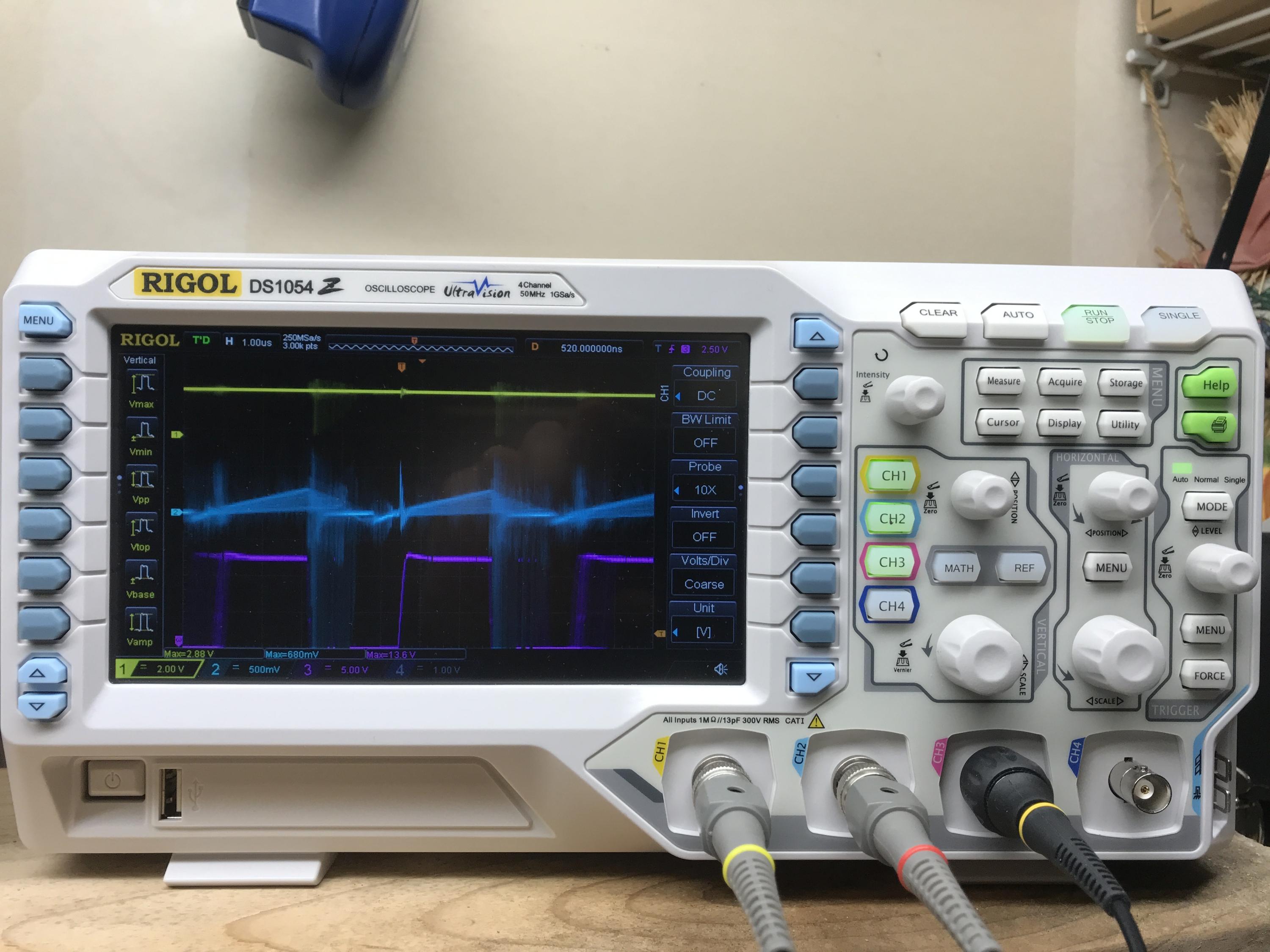

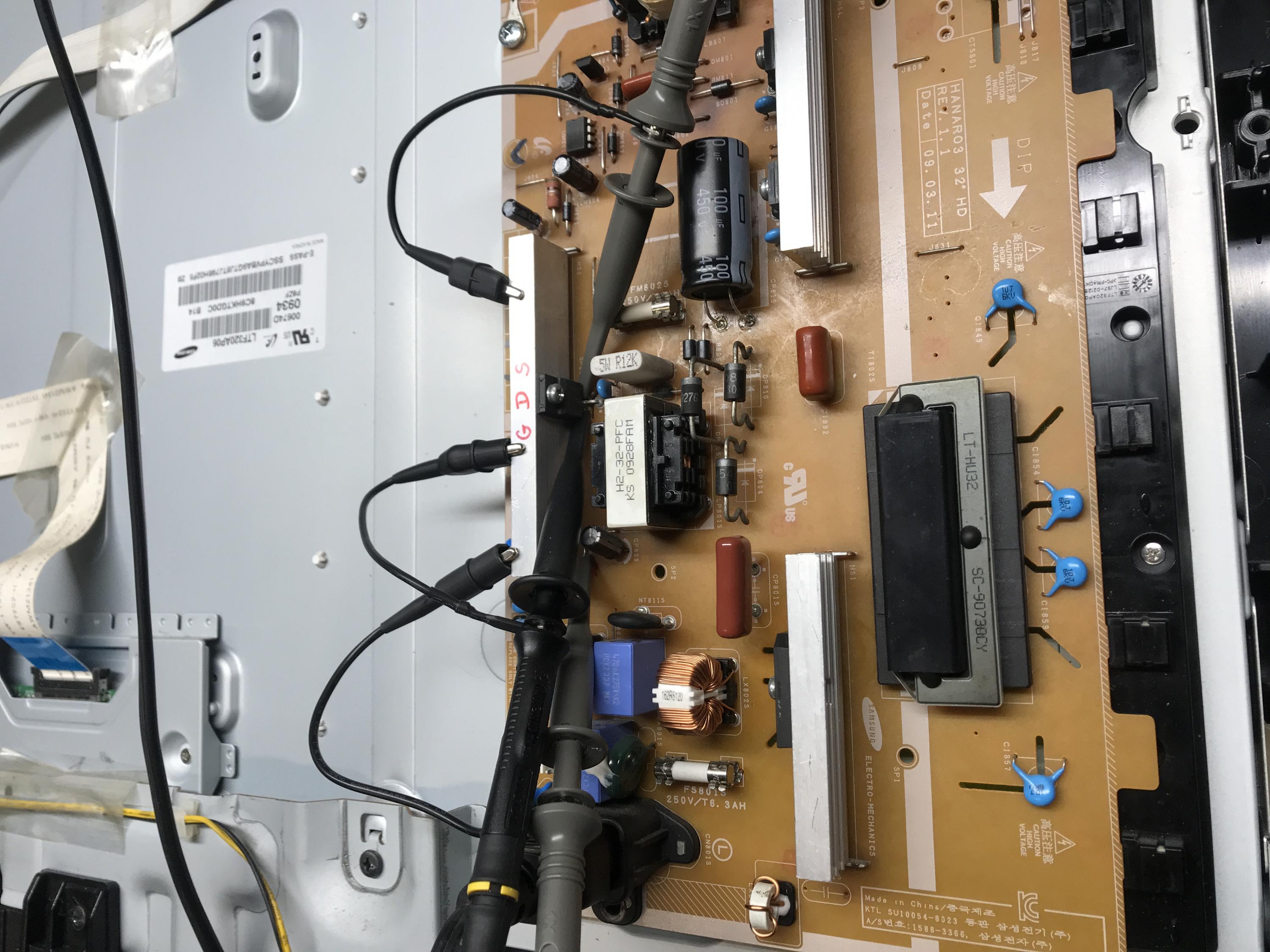

                  In the pictures attached, the yellow trace is UP801S pin 1, the blue trace is pin 4 and the purple trace is pin 7 at the gate of QP802S.
                  When working correctly or while in the boot-loop the voltage across CP815 is a clean 379vdc.
                  Pin 1 stays around 2.88v-3.5v when it the TV is working correctly as well as some of the time when it was boot-looping. It also got as high as 8v.
                  I've seen pin 4 creep above the .8vdc that triggers an over-current condition only when it is rebooting. When it was working correctly it has stayed in the 640mm-760mm range. The source on that switching transistor is pretty noisy so the ripple exceeds the trigger voltage quite often.
                  The output (pin 7) changes pulse width as necessary to maintain the output at 380vdc. It narrows when it reboots and then widens as the inverter load comes on.

                    #49
                    Re: Samsung 32 inch (LN32B360C5D) in perpetual restart loop...
                    You are getting the correct boosted Voltage even when the TV is power cycling and the PS-ON is steady, there is no problem with the PFC circuit, if the PFC shutdown the Voltage on the Voltage on the cap would have gone back down to 160vdc.
                    BTW, what did you use for the scope ground? The chassis? OR YOU FLOAT THE SCOPE?
                    The circuit has lots of high Voltage running around in the inverter section (>1000v) so scope ground leads will pick up lots of noise.
                      #50
                      When making the measurement on the hot side of the circuit, the scope ground is the negative leg of the main filter cap, not chassis ground.
                      YOU CANNOT DIRECTLY ATTACH THE SCOPE GROUND TO THE HOT SIDE CIRCUIT GROUND, YOU WILL BLOW UP THE POWER SUPPLY BOARD AND YOUR SCOPE, you have to connected the TV to the isolation transformer.
                      Are you floating your scope AC plug ground prong?
                      As I indicate, the backlights circuit is disable and the board is fooled to think that DET-5V is OK but the TV still power cycle, then you have problem in the main board.
                      You already know that the self test of the power supply board is OK and the backlights stay on a long as the AC is applied to the board.
                        Yes, I understand the difference between power ground and signal ground -- my scope connections are correct and the readings are correct. I have it plugged into a GFI outlet and have popped it a few times when I had one probe on the hot side and tried to simultaneously monitor a point on the cold side. Ha ha, it probably thought the difference in current between L1 and N was flowing through my heart.
                        Btw, the heat sinks inside the "hot line" on the PCB are part of power ground. But the negative side of the main filter cap is always a good point and easy to reach.
                        I'm curious as to why the source pin of the switching diode doesn't mirror the gate, just higher voltage.
                        As for this thread, I'm gonna be done with it. Its an old TV and I was tinkering with it out of curiosity. Besides, as you said, the power supply is doing what its supposed to. And the only documentation I've found on the mainboard is for the video components.

                          Isn't your scope probe ground connected to the safety ground prong of the scope AC plug?
                          If it is, I cannot see how you can have the scope probe ground connected to the hot side circuit ground which is not at ground potential.
                          At this point main board is the issue.
