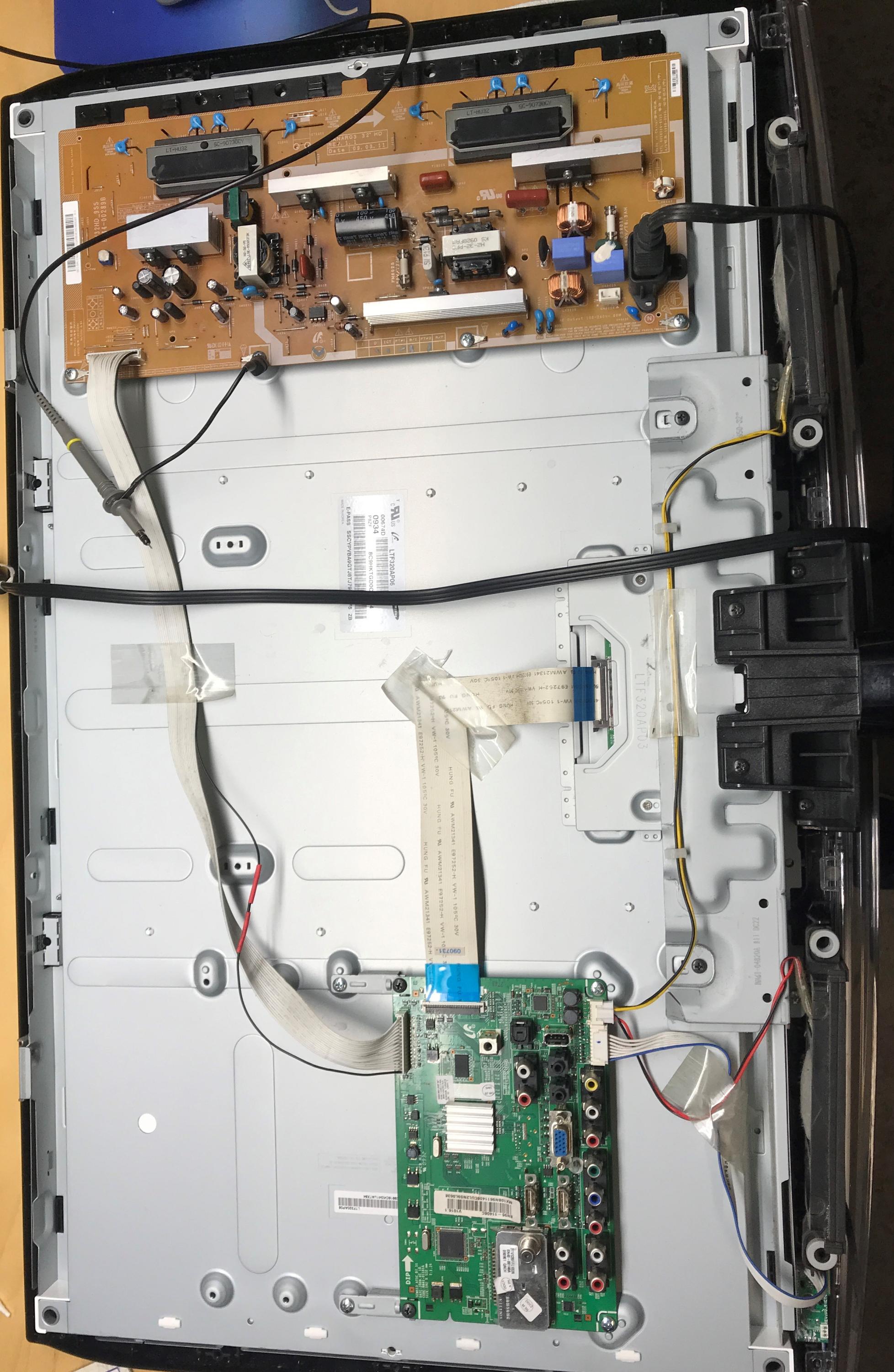

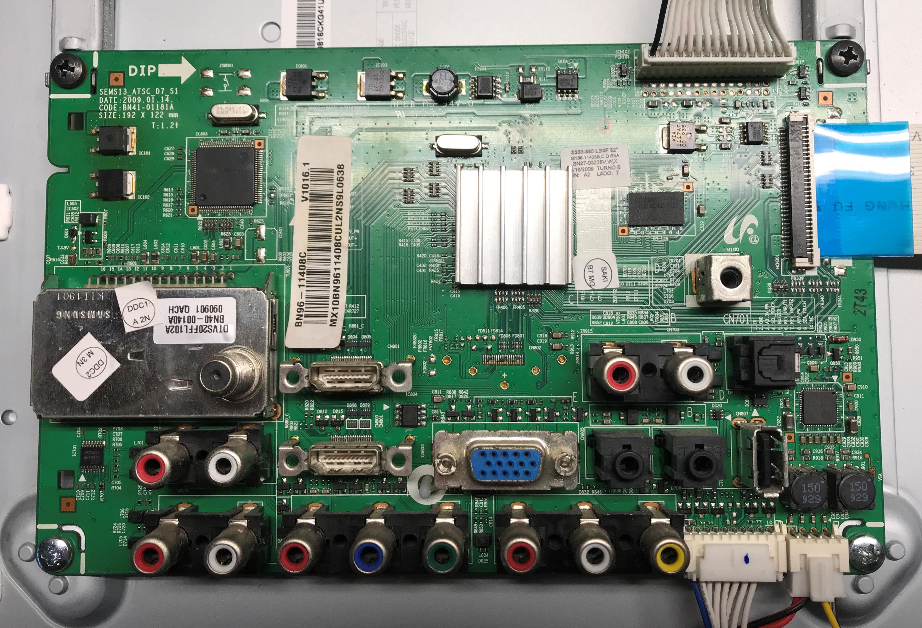

      Can we see good clear pictures of the whole backside of the TV showing all the boards?
      Also good clear pictures of the main board.
      • Howard_Woodard
        • Oct 2013
        • 57
        Re: Samsung 32 inch (LN32B360C5D) in perpetual restart loop...
        Sure thing. Thanks for your interest...
        Howard
        Seattle, WA

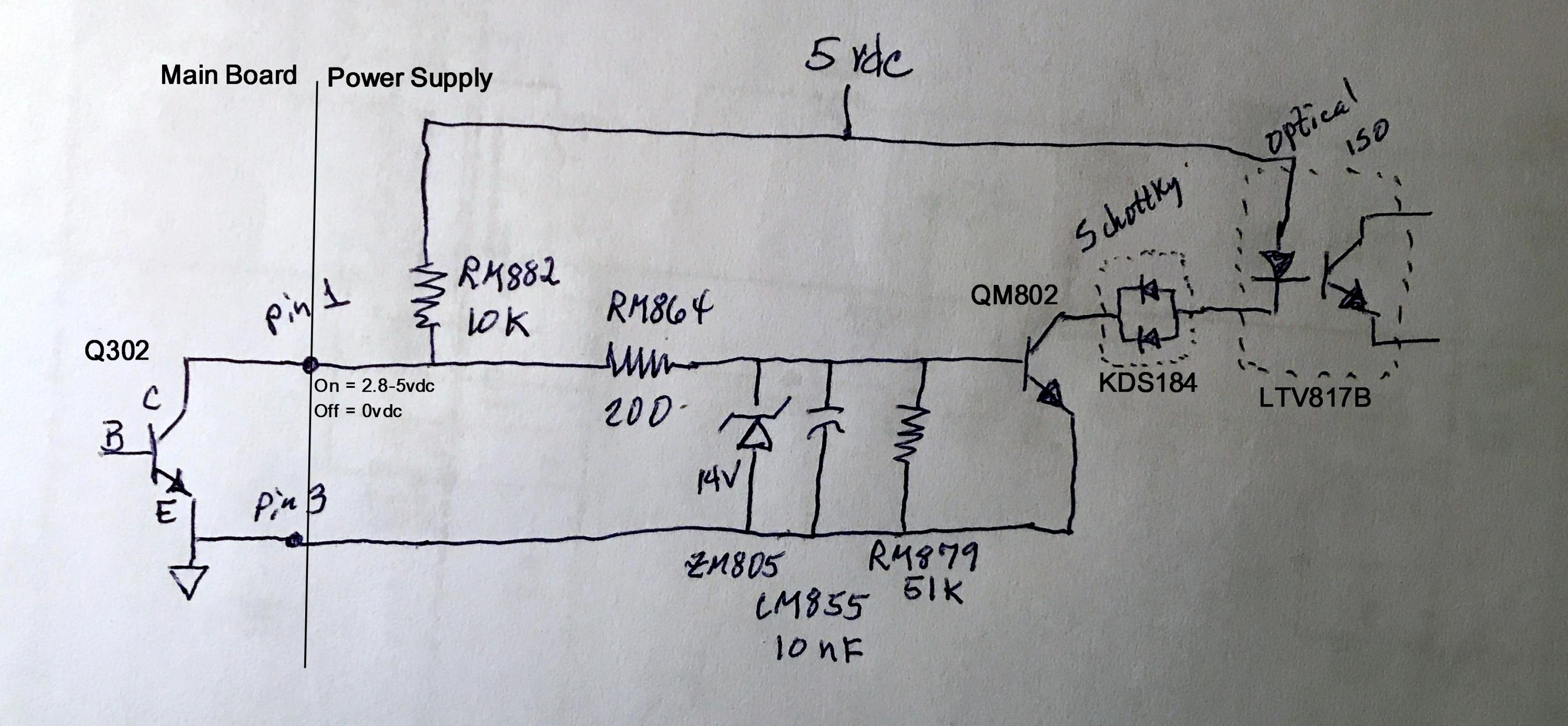

                            Thanks for helping me. Let me test my understanding here...
                            The TV gets plugged in and only the standby power should be on. Q302 should have a +vdc on its base, forward biasing it and pulling its collector (pin 1, PS-On) to ground (0vdc). When the keybd or remote on buttons are pressed that chip under the heat fin detects it and, along with whatever else it needs to do, it drops the voltage on the base of Q302, turning it off, causing the 5vdc through a pullup on the PSU to forward bias QM802 turning on the rest of the power supply -- including power to the processor which boots the TV up.
                            Now that we're up, what, besides over-current, would cause the BL-On to switch off? And if its over-current, how likely is it that it would repeat to possibly the millisecond? And if its over-current than why does it work after long periods disconnected and seems like it would just keep on working so long as it was never turned off?
                            Please don't get me wrong, I'm not challenging anything you're saying -- I'm just sharing the experience I have had with it the best that I can.

                              "The TV gets plugged in and only the standby power should be on. Q302 should have a +vdc on its base, forward biasing it and pulling its collector (pin 1, PS-On) to ground (0vdc). When the keybd or remote on buttons are pressed that chip under the heat fin detects it and, along with whatever else it needs to do, it drops the voltage on the base of Q302, turning it off, causing the 5vdc through a pullup on the PSU to forward bias QM802 turning on the rest of the power supply -- including power to the processor which boots the TV up." That is correct.

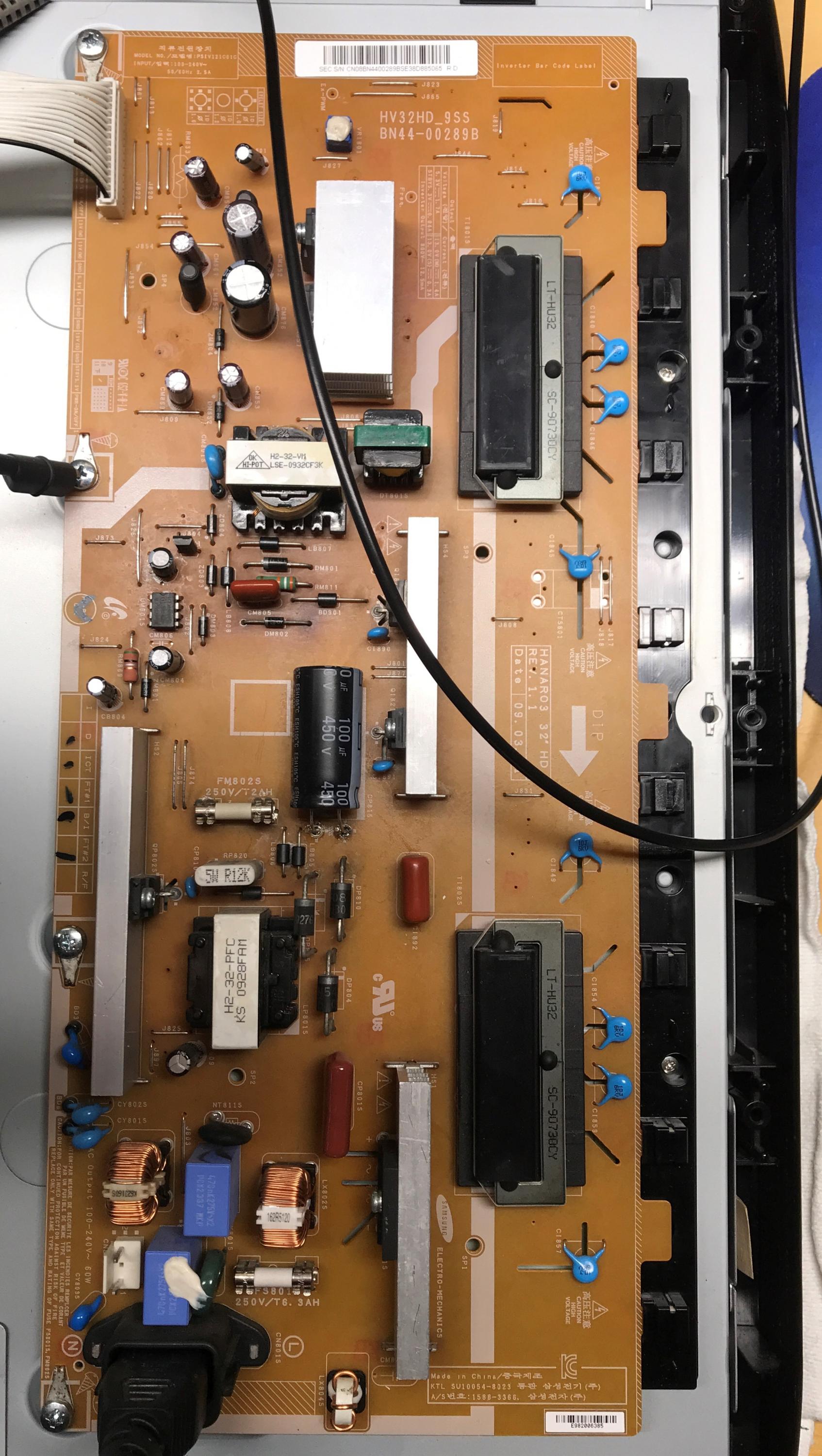

                              Your power supply/inverter board BN44-00289B has backlights error signal pin (DET-5V), the main board may or may not use this error signal in the your TV model.
                              The backlights inverter circuit has protection circuit that detect open lamp circuit, or over current protection circuit which will shutdown the backlghts circuit.
                              So far the self test of the power supply/inverter seems to indicate that it is OK.
                              See the attached PDF of the power supply/inverter circuit.
