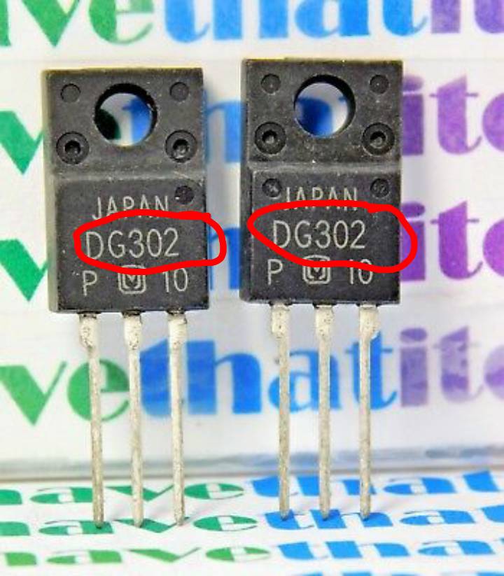

    What is stamped on the shorted transistors? Something like DG302?
    For Q402-404 the shortened one is D402 and Q401. For Q421-423 there is no shortened one.

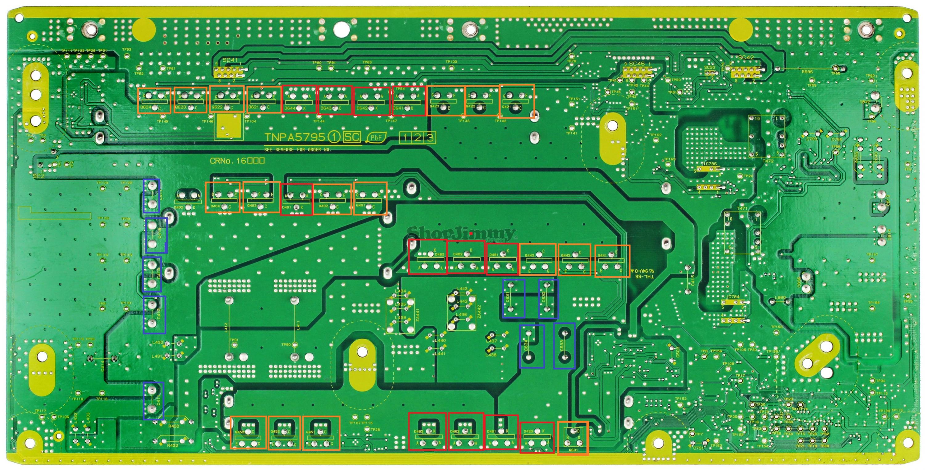

        In post #18 you said
        "Q421-423, Q402-404 Those were the only ones beeping as far as I could tell. I am not sure how to do the second part you described."
        In post #21 You said
        "For Q402-404 the shortened one is D402 and Q401. For Q421-423 there is no shortened one."
        Can you clarify this?
        I've attached a photo with the FETs, diodes and capacitors marked by color.
        Orange - FETs/transistors
        Red - Diodes
        Blue - Capacitors
        For all of the Orange ones (FETS/transistors):
        1. Set your meter on continuity mode (e.g. it beeps when you have your two leads touching each other).
        2. For each component, there are silk screen markings "G" "E" and "C".
        3. measure with the meter all the possible combinations:
        G - E
        G - C
        C - E
        4. Note down which combinations are shorted, and for which component.
        For all of the red ones (Diodes):
        2. For each component, there are silk screen markings "A" "A" and "K". (two anodes, one cathode, it's a dual diode package)
        3. Measure the possible combinations to see if there are any dead shorts across the diode(s)
        "A" (left side) to "K"
        "A" (right side) to "K"
        For all of the blue ones (Capacitors):
        2. For each component, put the meter leads - one on each pin and see if they continuously beep. If so, there is a short there (or caused by other components that share common pads.
        3. Note each component that continuously deeps.
        It may help if you take the SC board image and mark it up in mspaint
        -Thomas

          What I need to know is what is stamped on the front of the transistors, under the screw hole. Here are 2 examples.

            My bad, I thought by shortened you meant without nubs on the bottom sticking out.
            Q402 - All combinations beep
            Q403 - All combinations beep
            Q404 - All combinations beep
            Q421-423 - All combinations beep
            D401 - A to K both left and right side beep
            D423 - A to K both left and right side beep
            C411, C412, C413, C416, and C417 beep

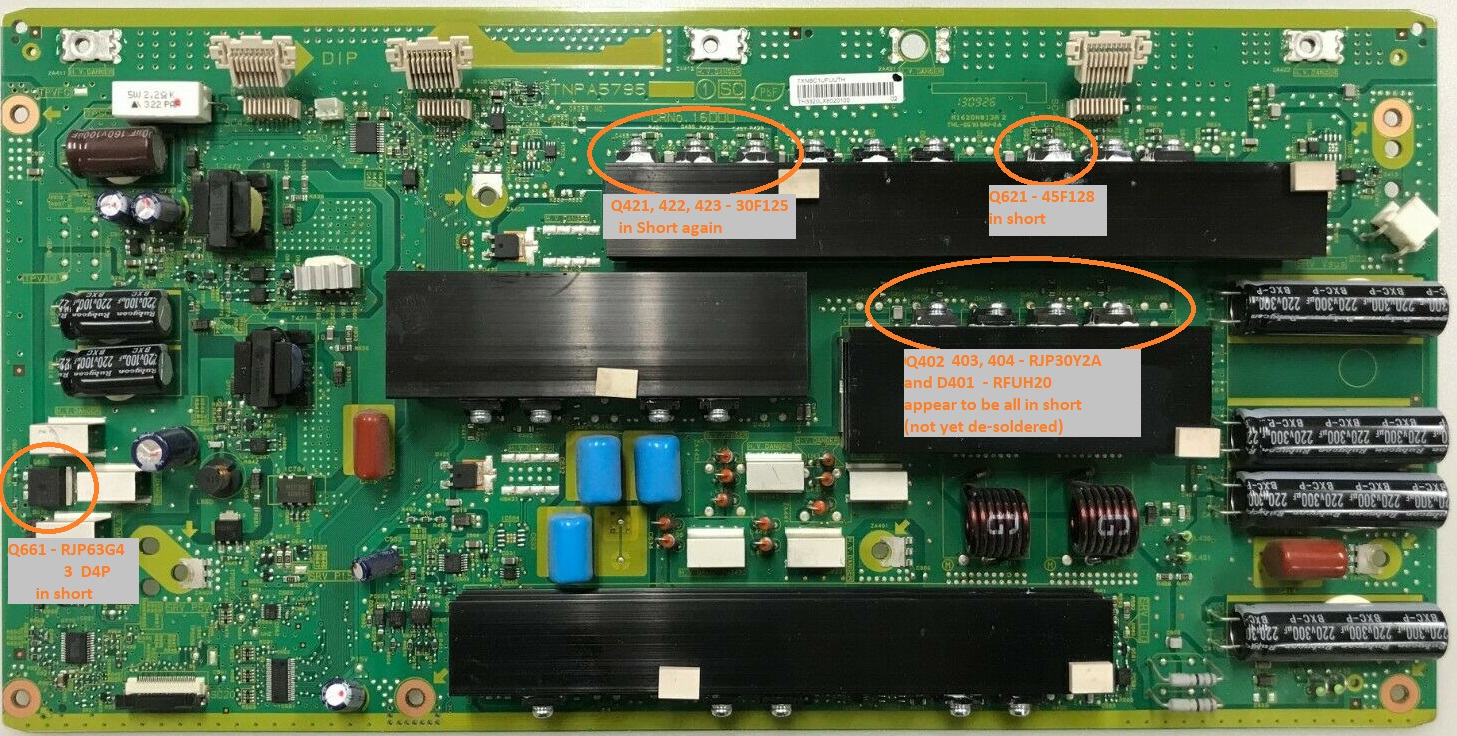

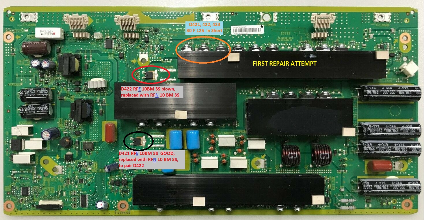

                  Hi Guys, I'm trying to repair the same board.
                  At first inspection it had one blown (exploded) diode (D422 - RFE10BM3S) and 3 transistors in short (Q421, 422 and 433 - 30F125).
                  The closest match for diode I found was RFN 10BM 3S, and replaced both D421 and D422. Note "RFN" instead of "RFE", not sure this makes a difference. These diodes I got from a reputable online AU supplier, I trust they are genuine.
                  For transistors, I could only find the exact part (30F125) on ebay, from China. These arrived last night (after 3 weeks).
                  Got quite excited and installed them straight away. Excitement was short lived, my first board repair failed with a faint buzz. Absolutely disappointing. No bang, no sparks, not even a thread of smoke .
                  A quick tally after second failure is pretty discouraging:
                  - Q421, 422 and 433 - 30F125 are in short again
                  - Q621 - 45F128 short (only one, 2 of the 3 are good)
                  - Q661 - RJP63G4 short
                  - Q402, 403, 404 - RJP30Y2A and D401 - RFUH20 appear to be in short, but I have not yet separated them. Some may be OK.
                  The 2 diodes I replaced appear to have survived.
                  I didn't even know I can get fake components on ebay, ex China. Thanks for sharing this. After reading your posts, I strongly suspect (80%) the 30F125 I got from ebay, were fake.
                  I would need a bit of guidance on what equivalents I could use in place of 30F125? I cannot find them with original name anywhere online, for Australia (RS-Components, Element14 ...).
                  I have not yet searched for the components failed last night, I may need to come back for advice on equivalents for those as well.
                  Also, the other help I need is: What else will I need to replace together with these transistors? I understand there are some small IC and SMD transistors, resistors which usually fail together?
                  Cheers, Sevciu

                    Re: Panasonic TC-P60ST60 Plasma TV 7 Blink Codes Help
                    To close my story, after replacing everything listed in previous post with genuine spares from reputable source, I had the board repaired and working OK. However the TV ran into 8 Blinks error code. Eventually I fixed that as well, and the TV is working just fine in my patio as outdoor TV.
