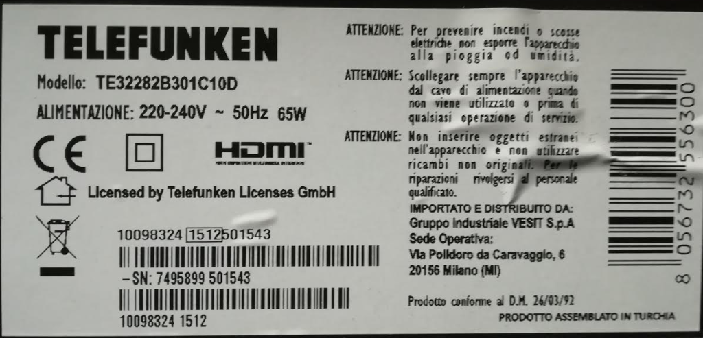

    hello, I'm looking for the telefunken led TV firmware TE32282B301C10D main vestel 17MB82-S
    thanks

        thanks for the answer, this TV only turns on the backlight, without the image, I don't know if the panel firm is also needed, let me know. panel: ves315wndl-2d-n02
        thank you

          Panel files installing via service menu. Write sn code for full firmware.

            where can i find the sn code?

                Re: tv led tfk need firmware
                this
