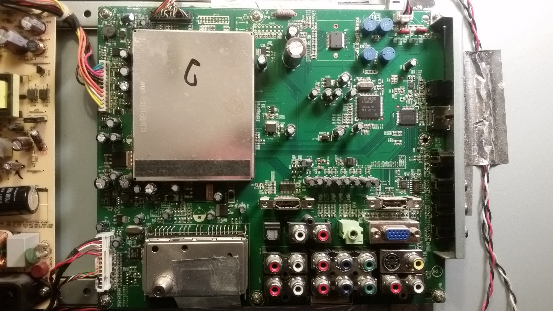

    I hoped I might be able to fix this for my sister, but I'd like to try to narrow it down as much as I can before ordering anything.
    It was supposedly taking multiple power button hits (remote or panel) to get it to boot, then eventually stopped coming on at all. The front LED will go from red to blue with no other sign of life. I've now verified that, by sitting there turning it on and off a bunch of times and have seen it boot maybe three, so it's not totally dead yet.
    Does this behavior for that model sound familiar to anyone or does anyone know which components or board might be responsible for it? The supply caps still look to be in good shape and the couple I poked at didn't seem terribly high on ESR, but I can pull a board and get some more thorough checks if it would help. The main supply voltages seemed OK, even while in the "dead" state, with the 24V maybe being a volt or so higher.

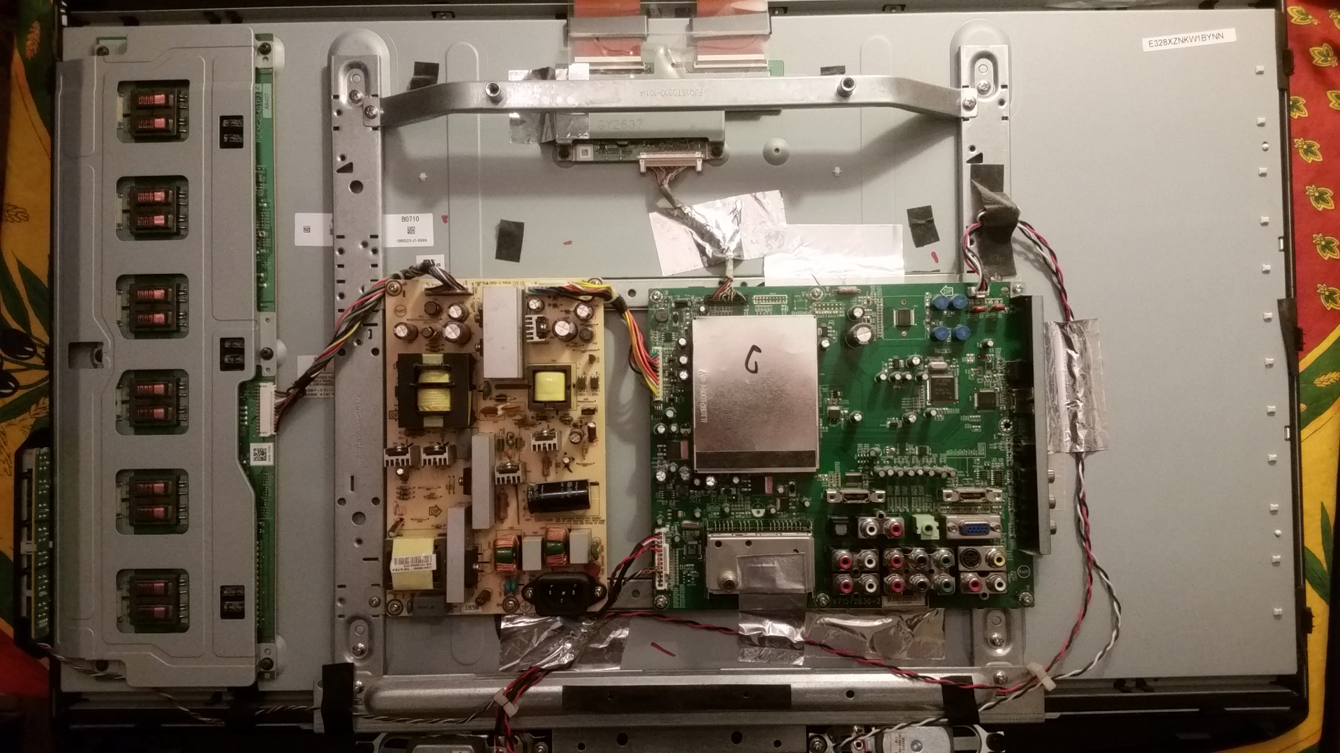

    You will get a lot more help if you upload good clear pictures of the whole backside of the TV showing all the boards so we can see what we are dealing with.
      Re: Insignia NS-LCD32-09 doesn't usually power up.
      Bud- I'm guessing you mean close-ups not the overall layout. I'll go get some.
        These aren't great, so let me know if you need better ones (not the best lighting where it is).

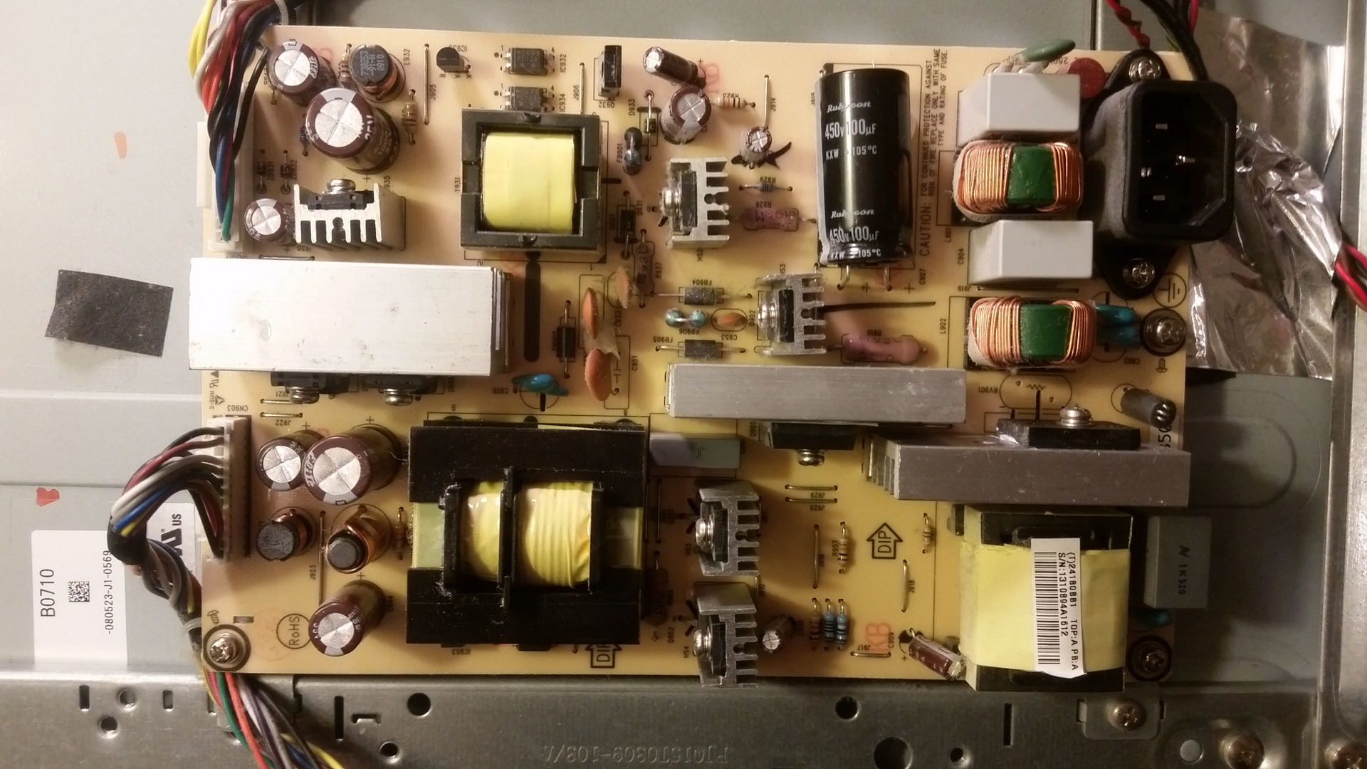

            You need to report the Voltage reading on the power supply connector that goes to the main board, the pins for the connector are label so you MUST put down the pin name and follow by the Voltage reading for each pin when TV is OFF and when power switch is activated so we can easily see if any of the output Voltages and Control Voltages are missing or not.
            There are two vesrion of the power supply board, I am not sure which version you have: https://www.shopjimmy.com/vizio-insi...wer-supply.htm

              PS- This does appear to be the same PS board pictured at Budm's shopjimmy link (with plug-in wiring).

                    With tv plugged in but off which is standby, check the voltage of the main filter cap C907, then turn tv on and check it, set meter to 200 vdc or next one up, positive probe on + positive leg of capacitor, negative probe on - negative leg, report both voltages here, BE VERY CAREFUL not to touch anything with your hands, this is the HOT/DEADLY side of the board.

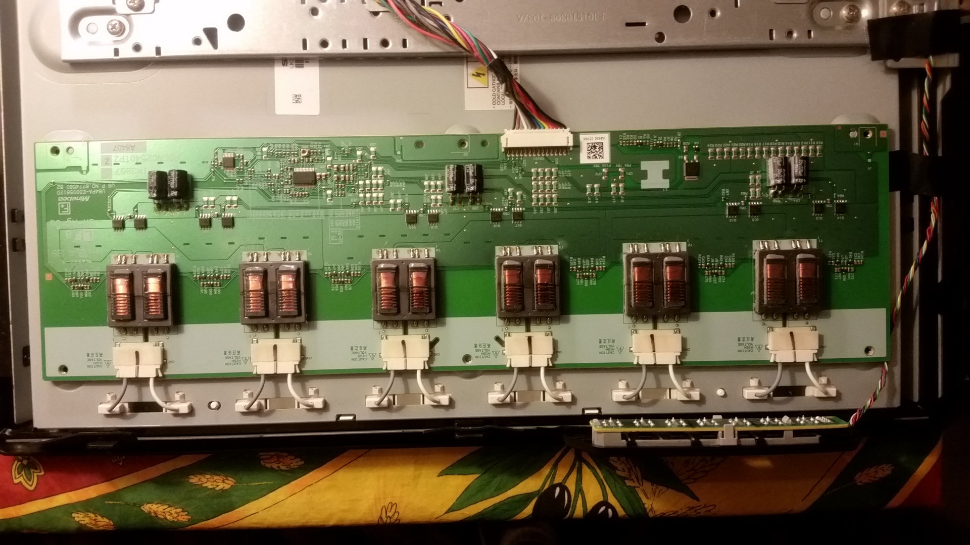

                      Could also heat up the inverter board with hairdryer, third picture, see if it reacts any better.

                        Main board issue, exact cause I do not know.

                          Hitting the inverter parts with the hair dryer didn't do it either.

                            Main board controls those two signals for the backights inverter board, so no ON/OFF, no DIM = no backlights. Something is causing the micro controller on the main board not to send those two signals to the inverter board.
                            You should read Basic LCD TV troubleshooting guide to understand how LCD TV works.
                            You can also force on the inverter board by disconnecting the ON/OFF and DIM wire going to the inverter board then use two pull-up resistors to simulate ON/OFF and Dim control signals, if everything else are OK then you should have backlights and all other functions of the TV.

                              I just tried with a couple 1k pullups to 5V on those two lines. It gets the backlight to come on when the set is turned on, but I don't get an image unless the set gets into the fully on state. If it's in that dead on state, I just get a glowing black screen.
                              Take Care
                                That means when in failed mode you just do not just lose the Backlights control signals, you also lose other function as well, so it is time for a replacement main board.

                                        TV is up and running!
                                        Main board showed up a few days early, so it's in and looks fine. I did have the bottom of the cable box image a little off the screen when I connected to that, but I think it's just in the wrong screen mode (I didn't get the remote with it). I'll get them to bring the remote when they come get the set to make sure.
