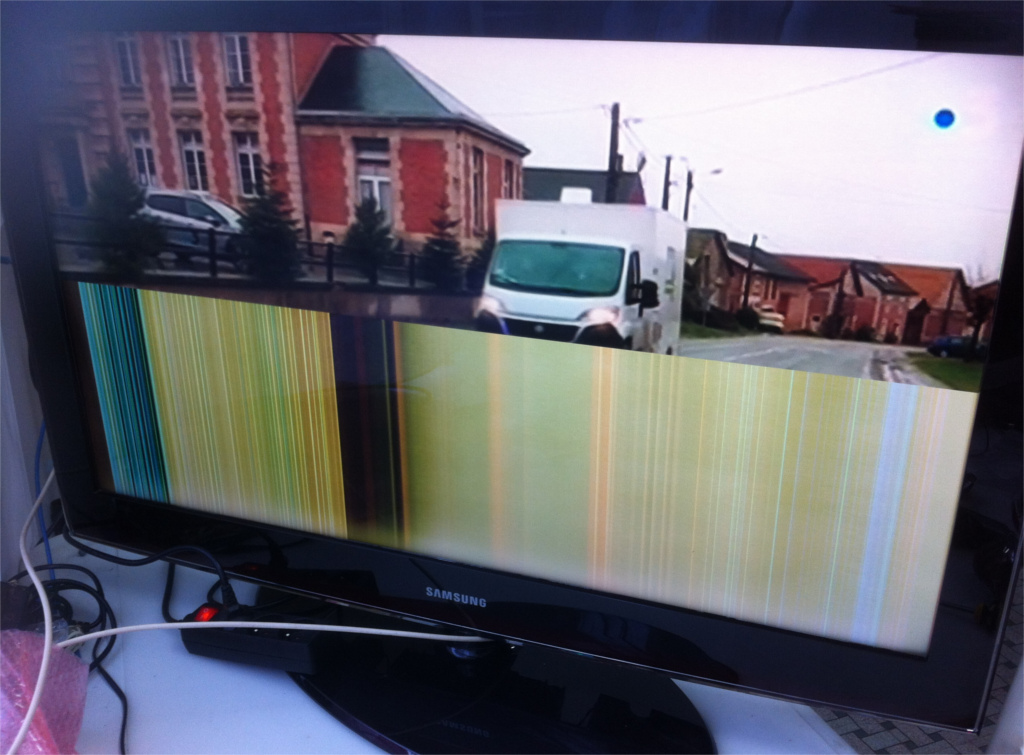

    TV Samsung LE40A656A1FXXC variable color bars image
    TV: Samsung LE40A656A1FXXC
    T-Con : BN81-01694A
    Motherboard: BN94-01741B
    LCD Display: Samsung LTF400HC01

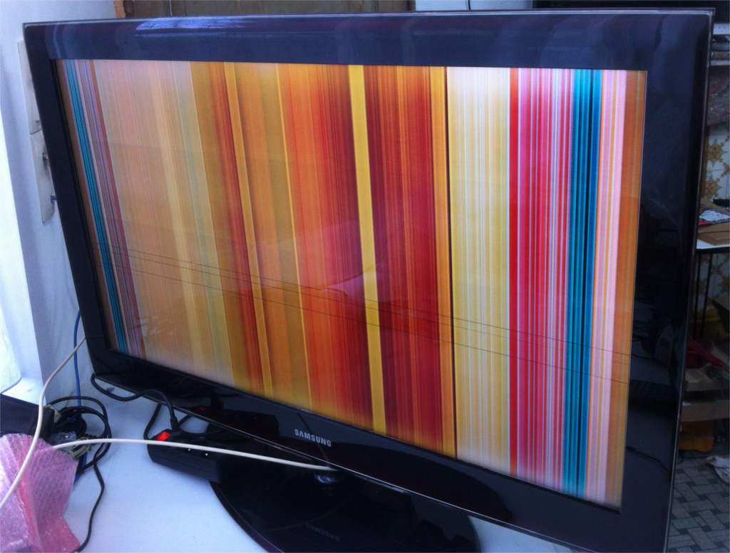

    Hello all, I need your help again, then I joined 2 pictures as it is an image issue.
    The image is sometime correct, sometime partially good, when it has a partial good image it is always on the top of the screen, sometime no image at all just only color bars as a gradient moving with the image contain like a curtain.
    I check already every ribbons and powers, I hesitate to say it is either the diplay or T-Con problem, can you help me please ? if coming from the t-con, any idea which chip may cause such issue ? The t-con looks no more available.
    Thanks by advance.

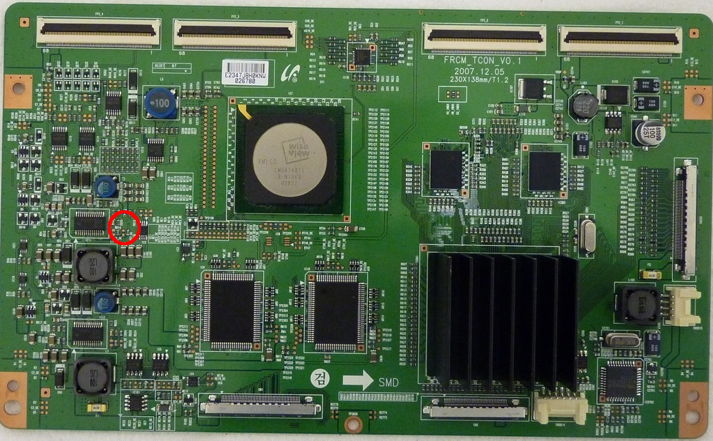

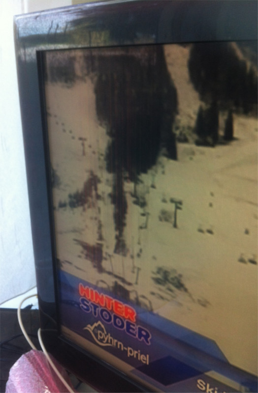

                      Re: TV Samsung LE40A656A1FXXC variable color bars image
                      Hello again
                      I have some new clues
                      When the image looks normal, it has an issue anyway above clear writing on the screen, difficult to see on the picture, then i will describe it, i have on this image writings on bottom left of the image, it has kind of blue red and green fine vertical line, starting from there to the top of the screen, nothing below !
                      Other thing interesting , when the images is garbled and i place my finger on the t-con board, on the place marked by the red circle, the image is freezing, when releasing my finger, the image becomes normal. there is a power supply chip TPS65160A just beside. Perhaps i am doing a reset downing a power line there. I am not sure what to think about it.
                      Have a nice day
