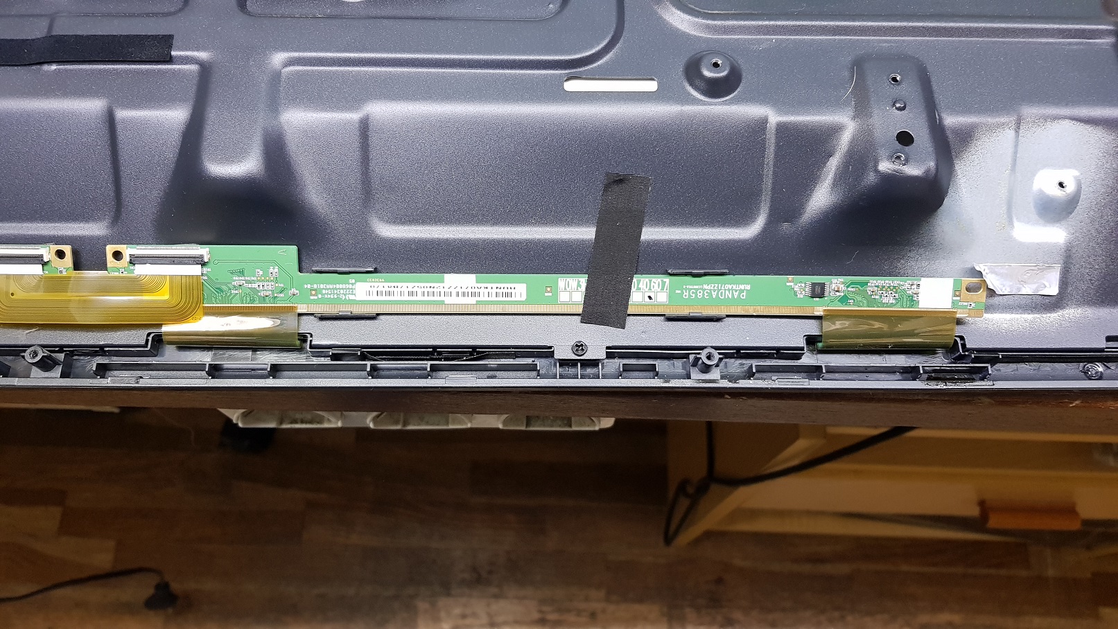

    philips 47pfl6158k/12 image faded away, sound still coming from TV
    by Kartowl
    Hi, my TV image started showing those lines and the image faded away, but sound is still coming from it, what could be the cause and is it fixable? I thought it could be the tcon board but I red on the internet that it could be a failing panel

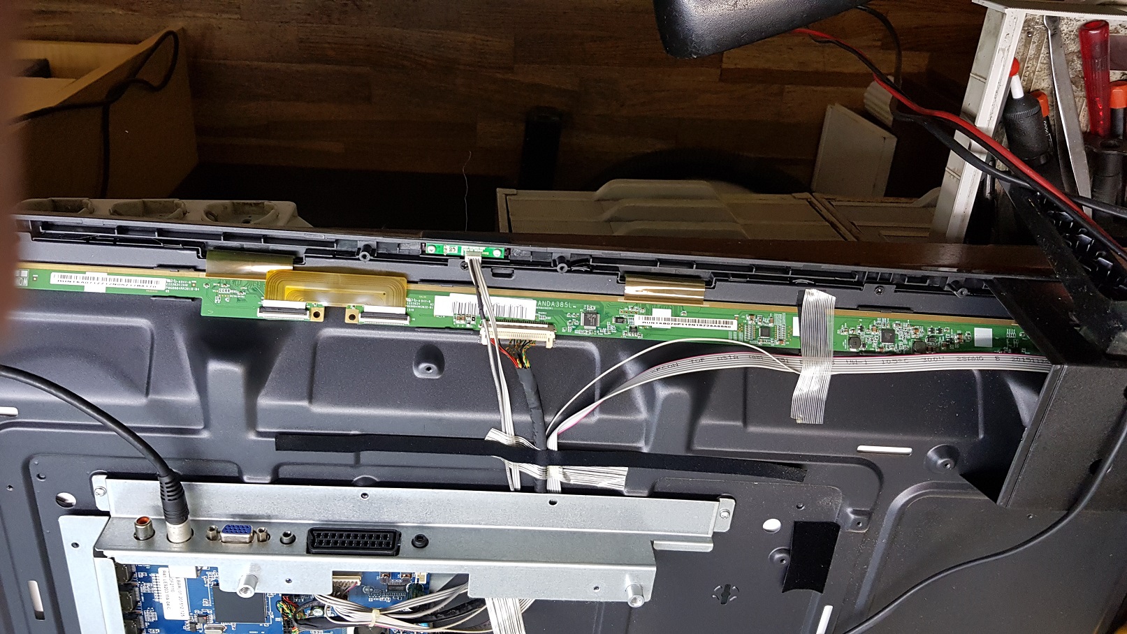

    samsung ue40d6100 has no backlight no sound and image
    by wolf1976
    hi to all
    on the above model of samsung i have the faults i have told already on the title
    iI have standby i can from remote control open and close the tv and it seems reacts the tv when i press someone button from remote control but and with the help of a torch i cannot see anything image on the tv and no sound
    any idea from someone what can i measure so i can find the problem ?
    the power supply is the bn44-00482a i cannot find the service manual so i can test if the leds are ok and maby these are the cause of my problem

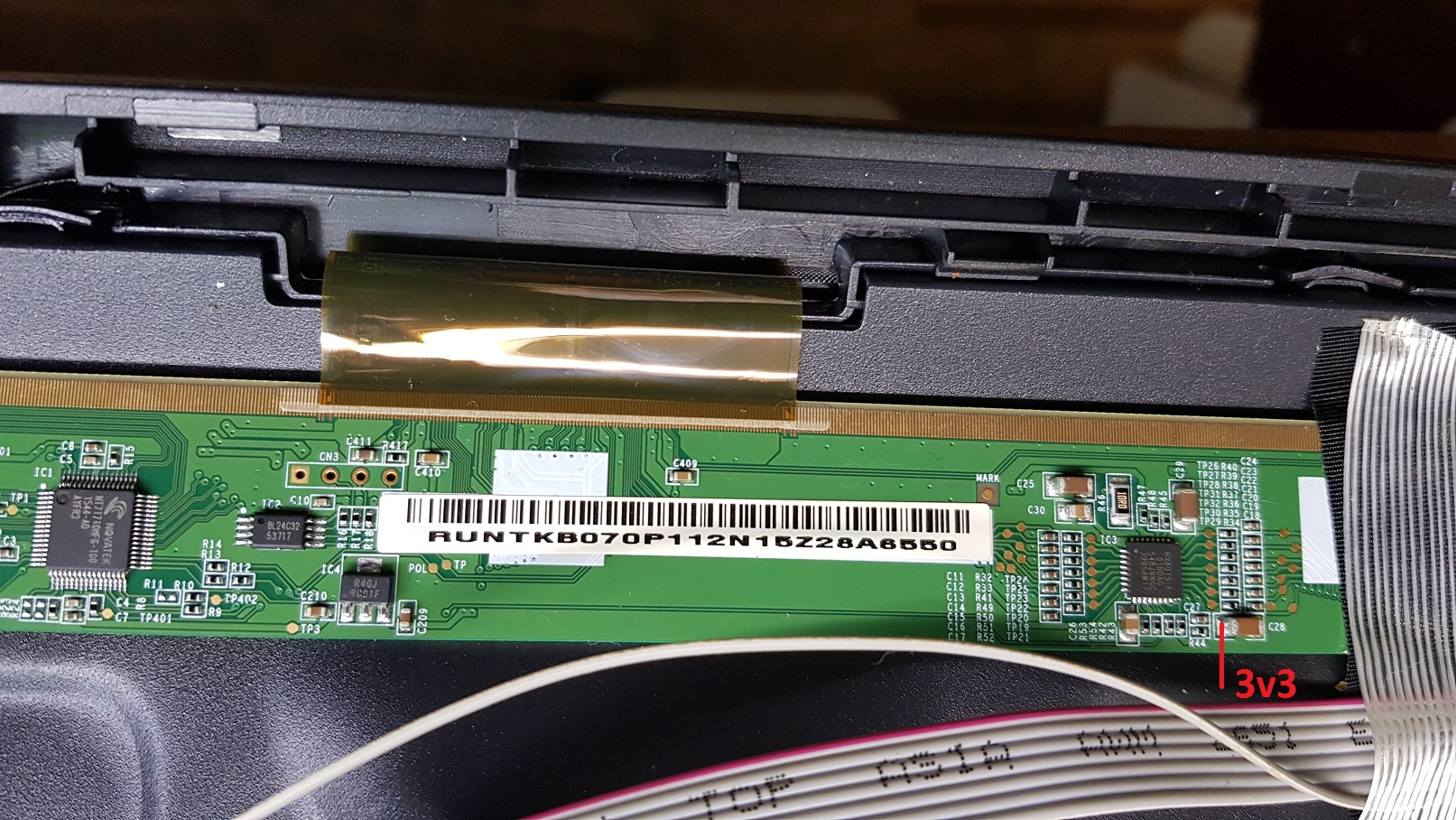

    LG 43UK6500AUA no LCD image, backlight and sound okay
    by howardc64
    Similar to another LG UK series here
    https://www.badcaps.net/forum/showthread.php?t=93943
    Have backlight and sound. no LCD image.
    • main board has integrated T-Con
    • main board T-Con has LCD DCDC/PMIC RT6950GQW QFN68 package. Richtek chip. Can't find datasheet. Chip generates VADD (10.44V), VGH (~28V), VGL (~-14.5V)
    • RT6950 pin 18-19 (clockwise) appeared to be bridged. Unlikely from my probing, looks like ball squeezage so it probably got hot
    • Cleaned up bridging. Pin 17 is VGL (-14V) Pin 20 is VGH (28V). Pin 18 (I think 19 too) jumps between VGL and VGH voltage
