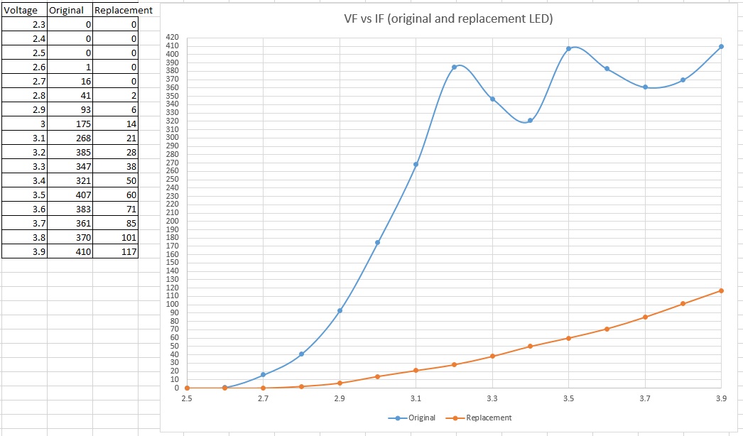

                                I was able to find a working LED from the original panel strip. I measured the voltage vs current and plotted the data. The original LED starting flashing above 3.4V. I wouldn't place too much emphasis above that voltage.
                                I heard back from the seller too - all they are just claiming is "Vf=3.0-3.2V, If=20mA"
                                -Thomas
                                I'm a hardware engineer focused on networking equipment for my day job. I void warranties and fix consumer electronics for fun.
                                  #36
                                  Re: SMPS schematic for Samsung UN46EH5000?
                                  It looks like your old LED is rated at about 350mA at most, so when you push higher current it starts breaking down, it is a 1 Watt LED.
                                  The power supply is capable of delivering 470 mA but it is not being used at max rating in your TV, more likely at 300mA or so.
                                  "all they are just claiming is "Vf=3.0-3.2V, If=20mA"
                                  Your replacement LED is not rated at 1W for sure, that is why it starts cutting out when forcing high current through it. So your replacement is no good as I suspect from the beginning, seller should be able to tell you the max current rating spec, I would not buy from seller like that. It is good that you learn to plot the LED graph.

                                        #39
                                        Thanks, this is a great place to learn, and thanks for the graph, now I can tell people how to see the effect of LED current and the Vf using your graph.
                                        And if the Vf rating at 3V (3.2V typical for high end), you can see that the replacement LED is rated at about 20mA.
