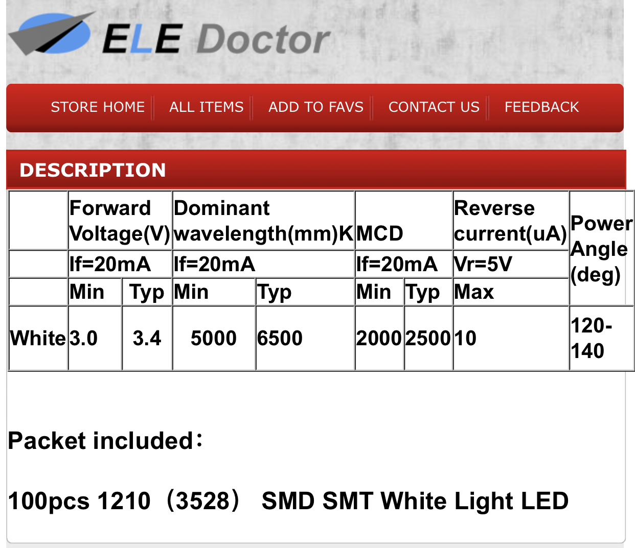

    I got the TV for $10. The unit worked, but 26 of the 44 back light LEDs were blown (all shorted). Looks like that is common with this model. Using my LED tester, it shows a Vf=2.6-2.7V.
    I replaced all of the LEDs with SMD parts that I have. The rated Vf=2.9V on these units.
    Right now, the backlight momentarily blinks on (all of them), then the supply shuts off. The backlight controller is a "SLC1012C" -- looks like this is equivalent to a Fairchild FAN7340.
    Instead of finding lower forward voltage white LEDs, i'm hoping to just bump up the overcurrent protection of the SMPS board.
    Any leads on the SMPS schematic would be appreciated. (if there are no leads i'll just end up replacing the LEDs).

      I ended up replacing all 44 from the LED strips. Yeah, no way I'm trusting the rest of them to work in the long term. Just need to find the correct Vf rated LEDs or the SMPS schematics time adjust the current limit.

        "Using my LED tester, it shows a Vf=2.6-2.7V." that is what you will see when you only drive the LED at about 30mA, so the Vf of the LED is not the problem, Vf will be higher at higher If.
        What is the current rating of the replacement LED?

          The LED rating is attached. I bought a 100 two years ago.

            Re: SMPS schematic for Samsung UN46EH5000?
            I do not see the If rating.
            Vf typ. of 3.4V at 20mA? That cannot not right for backlights LED.
            See Vf VS If graph sample, this example is rated at only 0.5W, most backlights use 1W LED.

              Hi Budm - unfortunately, that screenshoot is the only information that I have for this LED.

                I won't trust that seller spec, if that is all the seller can provide.

                      You can experiment by driving one of your replacement LED at about 200mA with DC power supply and see what happen.
