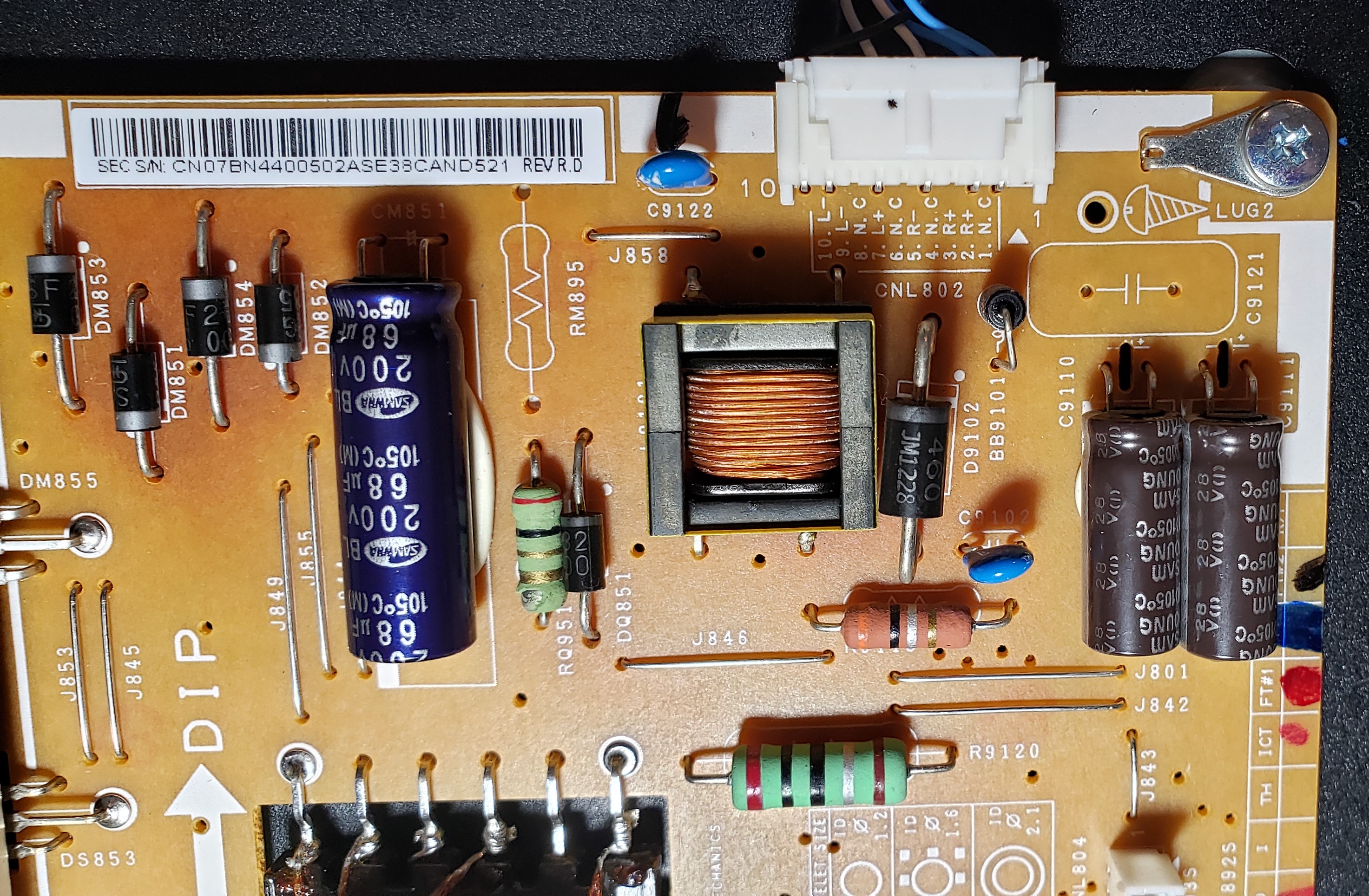

    I am trying to diagnose/repair a Samsung UN46ES6100 LED TV with no backlight. I have done the flashlight test and there is an image on the screen. Audio works fine as well.
    Testing the voltage from the BN44-00502a power supply to the LED backlight strips, (see attached photo) - the readings are as follows:
    both R+ = fluctuating between 250-265V
    R- and L+ = fluctuating, around 1-2V
    both L- fluctuating between 1-3V
    My understanding is that these should be steady DC voltage, not fluctuating. I suppose the fact that it's only reading 1V in the Left side of the circuit is the problem. How would I go about further isolating the problem?

        Re: Samsung UN46ES6100 / no backlight
        If you look at the bottom of the board you will see your answer.
        pins 2,3 (R+) are the supply voltage for the led string, pins 5,7 are connected together, only to join the two led strings. pins 9,10 are the return line. You have an open led string, thats why you have the high fluctuating voltage on pins 2,3 and not any others.
        If the leds were all working you would have about 190v on pins2,3. approx 90v on pins 5,7 and likely 10~15v on the return pins 9,10.

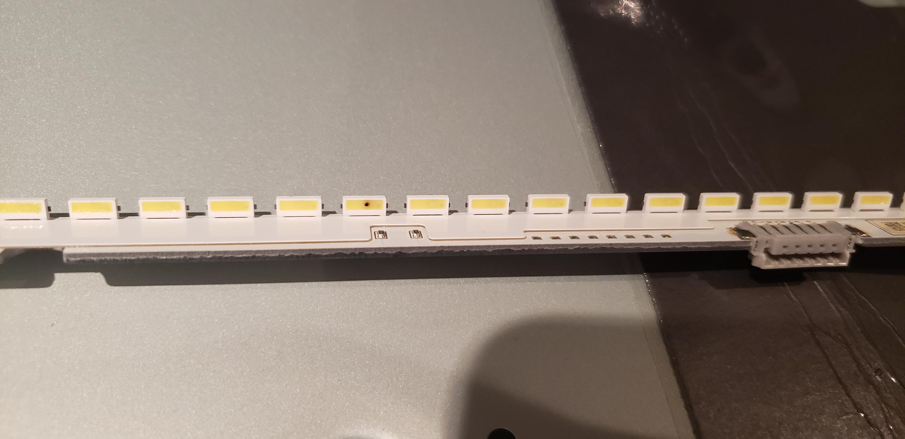

                      I opened it up the TV to get to the LED strips I see a black spot on one of the LEDs.
                      I have access to a bench power supply at work, so I'll take it in to try to confirm.
                      I see that there are individual LEDs available, but this style looks difficult to work with. Does anyone have any instructions or videos that would help with this?
                      If I'm unable to do it on my own I will eventually look into buying a whole replacement strip.
                        I would replace the whole set of the strip, one LED already failed so it is better to replace all the strips at once instead of taking panel apart again when other LED's fail.
                        Then turn down the backlights level to as low as you can on all inputs to extend the life of the LED's.
