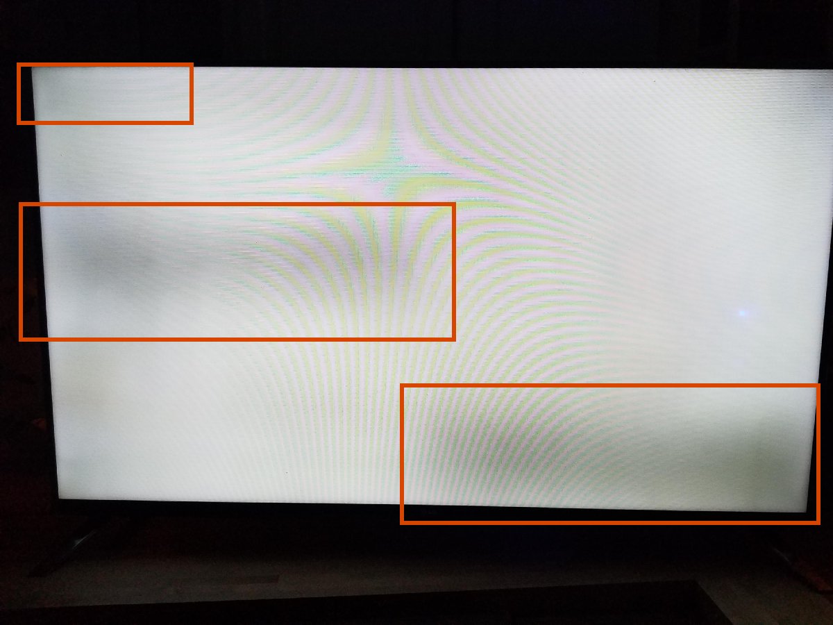

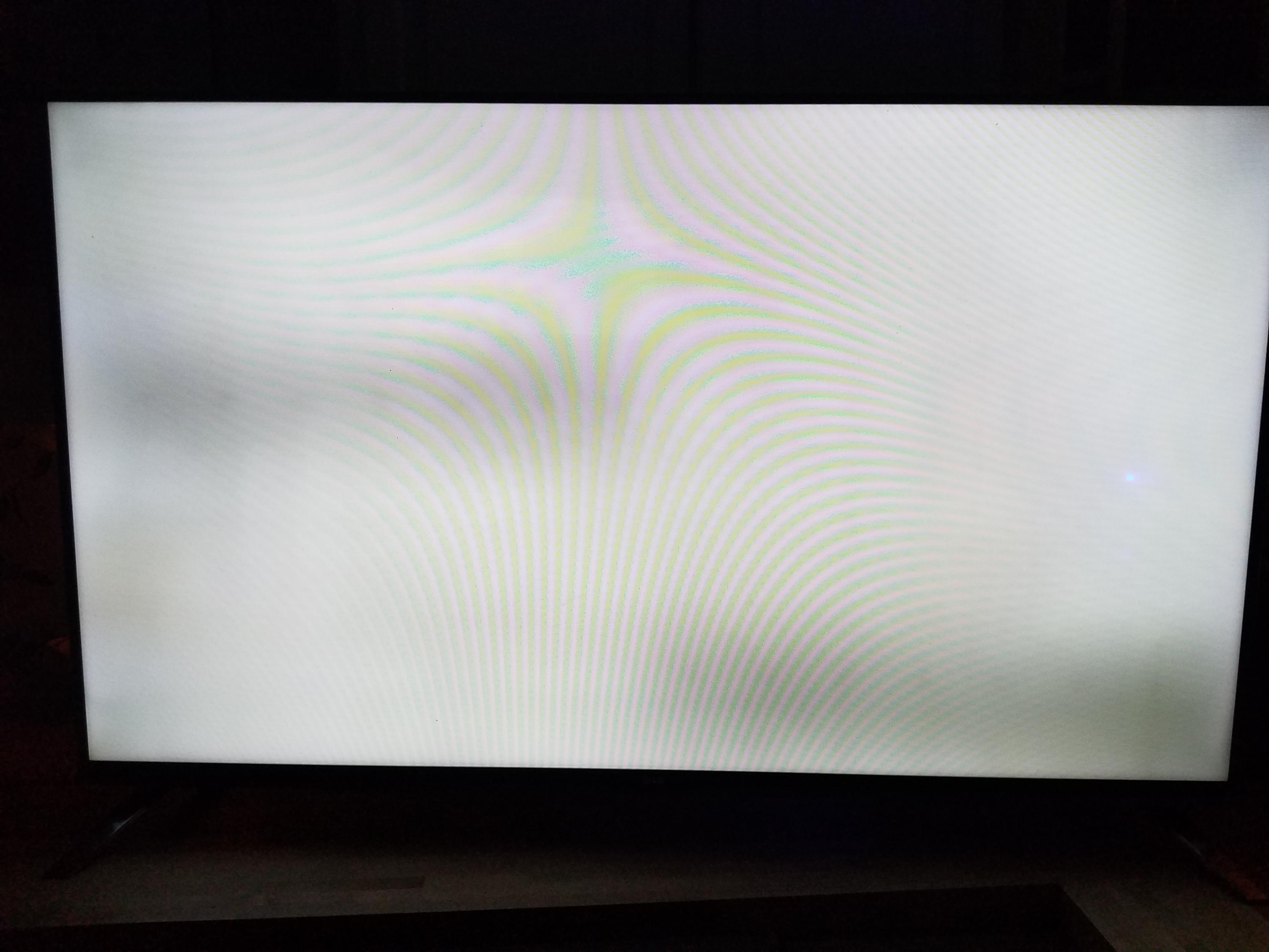

    Hey, guys! I picked up this set last night. The owner complained the picture would turn off after various lengths of time, but the sound would persist. I think I'm looking at two bad LED strips. In previous sets I've worked on, a single LED failure caused the whole backlight to turn off. Is it possible only certain strips are failing here?
    I've not come across the mura effect yet. Could this be the issue? I also noticed temporary image persistence after sitting in the menu for some time.
    I attached a picture of it on a solid white screen.
    Thanks for your opinions!

    Yea, it looks like you have 2 bad half-strips and a possible 1 or 2 LEDs..
    I am assuming you are using an LED Power Supply to get the LEDs going??
    It's been my experience that, especially with LGs, you can have 1 bad LED and, depending on it's position, it can take down the whole array...

      Thanks for the reply! I didn't take the first screw out yet. The TV works - but with the dark spots (and that temporary image persistence). I just used a solid white video to better see the situation.
      I guess I'll pull the unit apart this weekend and replace some LEDs.
