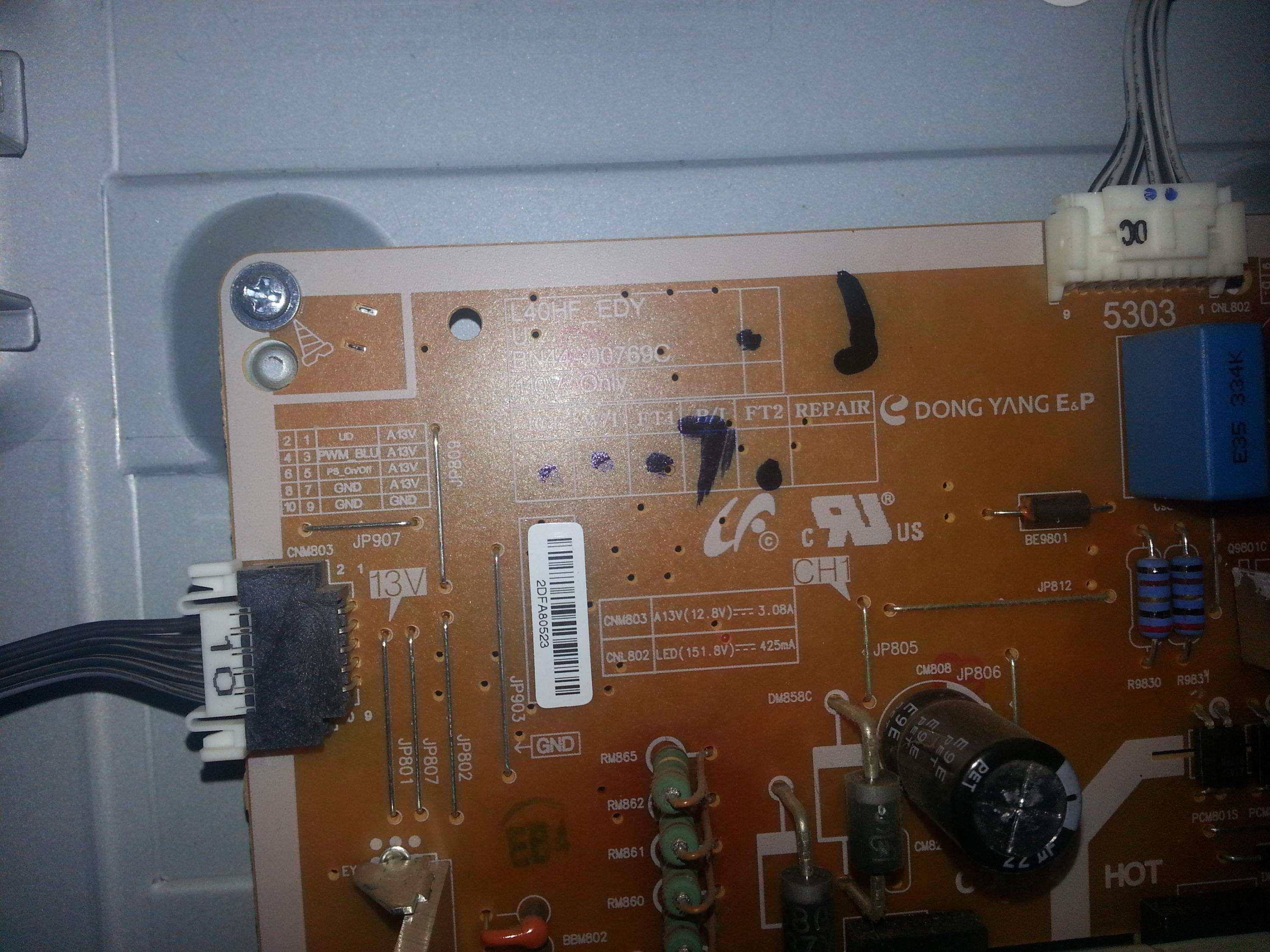

    Samsung UN40H5203AF LED backlight is blinking on and off. Set doesn't turn on.
    If I unplug the LEDS from the power LED driver board, the set turns on, has sound and it passes the flashlight test.
    On the BN44-00769C Power Supply / LED Board shows the LED supply voltage should be 151.8v at 425ma with the LEDs connected but I can't get good measurements on the LED connector with the LEDs blinking.
    With the LEDs disconnected the open circuit voltage on pins 1 and 2 (D+) to chassis is 211v.
    I thought I'd post to ask if the problem is more likely to be the LED strips or the Power Supply / LED Board.

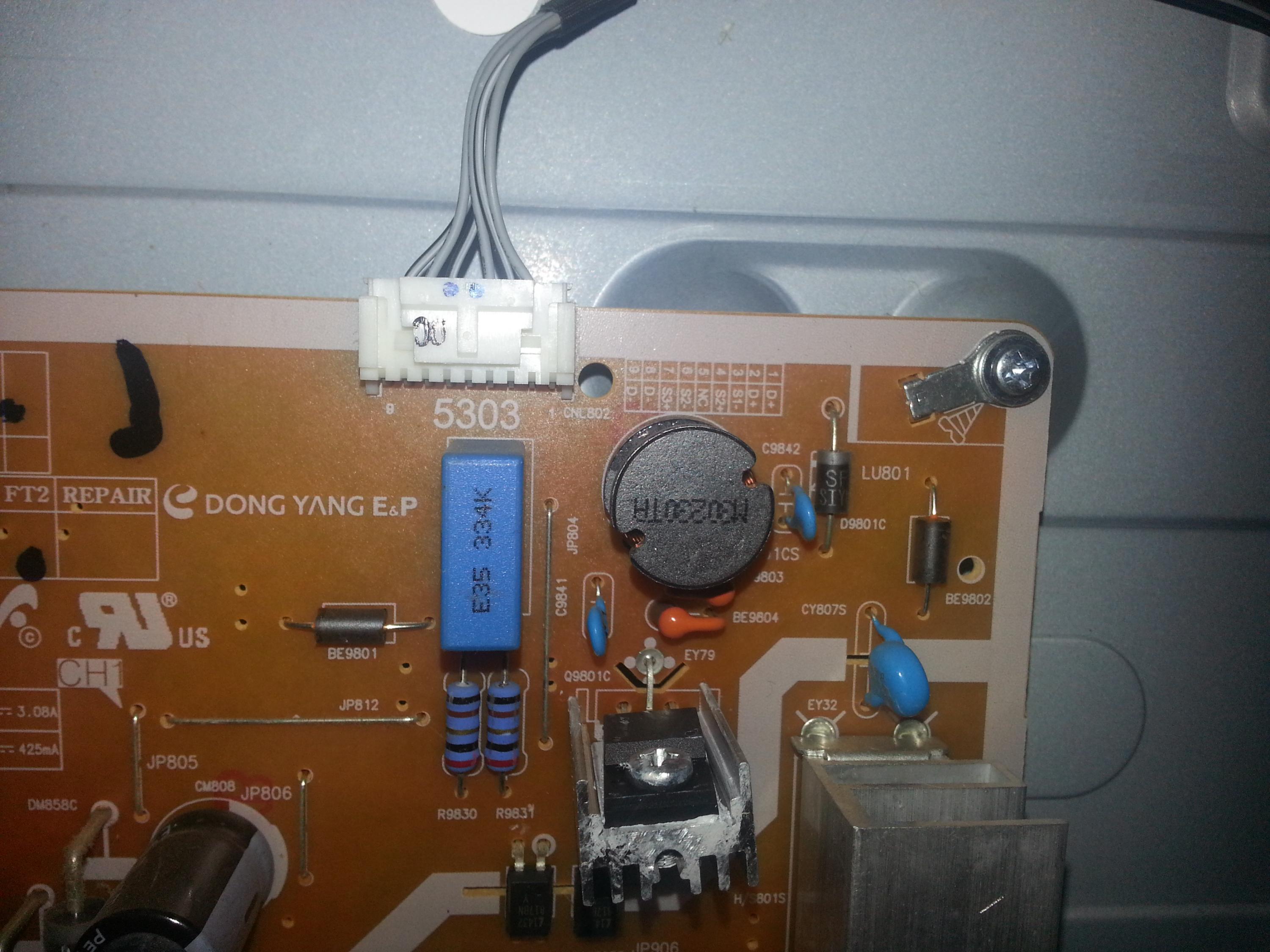

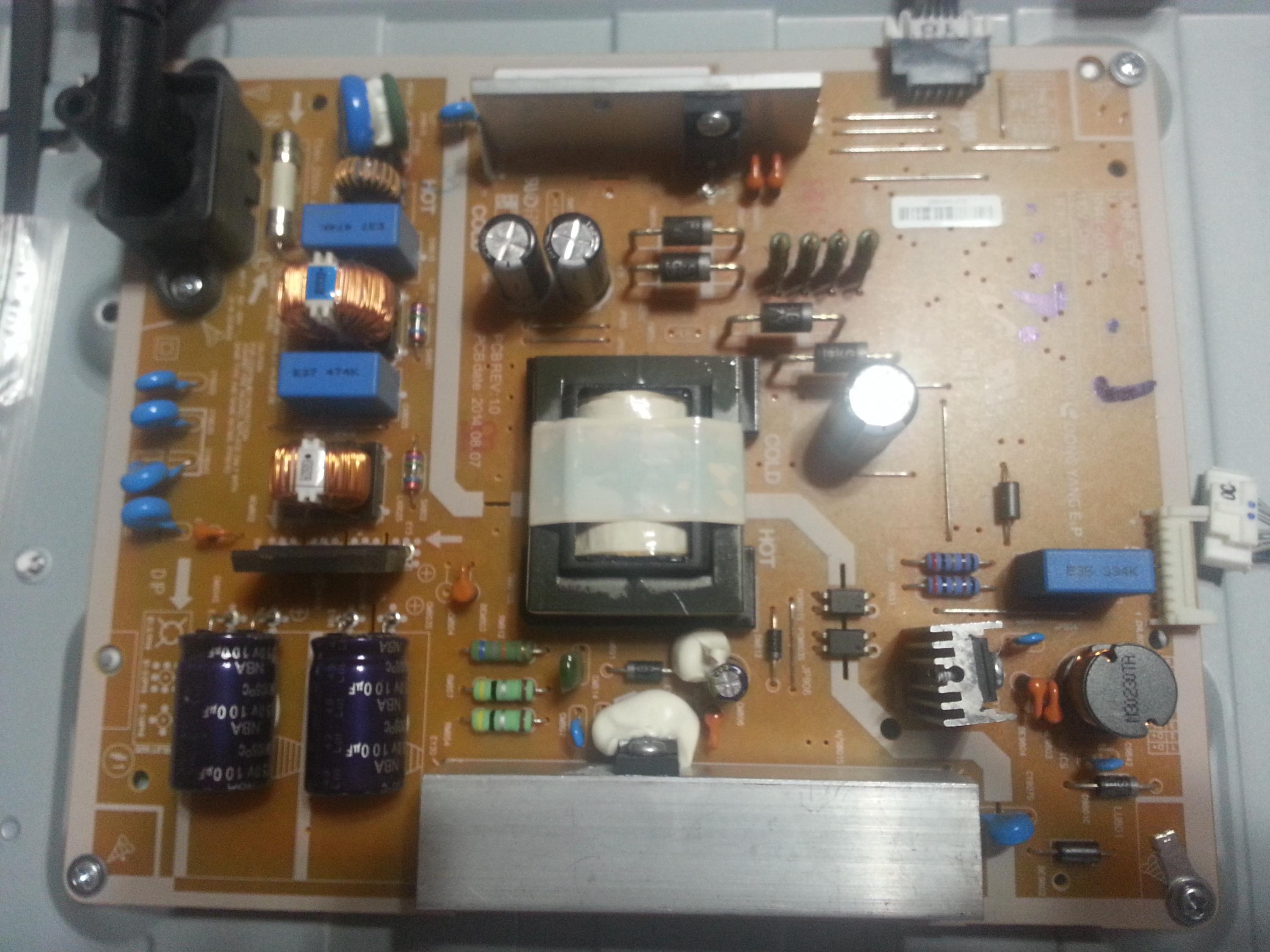

    Here are a couple of pics of the power LED board.

      Re: Samsung UN40H5203AF LED backlight blinking
      Your results do tend to agree that it's an led problem. Is it' possible to reduce the backlights and see if they then stay on?
        The only long term solution is to replace the LED Backlights. Not just the bad strip but ALL the strips to prevent having to open up the Panel multiple times.

            I think you need to invest in a led tester. The newest models can be set to a couple hundred mA. On Samsungs, there is no protection circuitry which causes almost all leds to burn out and can also damage the power supply.
              https://www.badcaps.net/forum/attach...9&d=1570706323
              Lift up one leg of diode D9801C and check RESISTANCE in both directions.

                Looks like a good diode. On ohms 1.9Mohm one way, open the other. On diode test. Forward bias one way, open the other way
                  Good, if that diode has leakage it will also cause the backlghts flickering. LED tester at this point will help narrowing down the issue.
