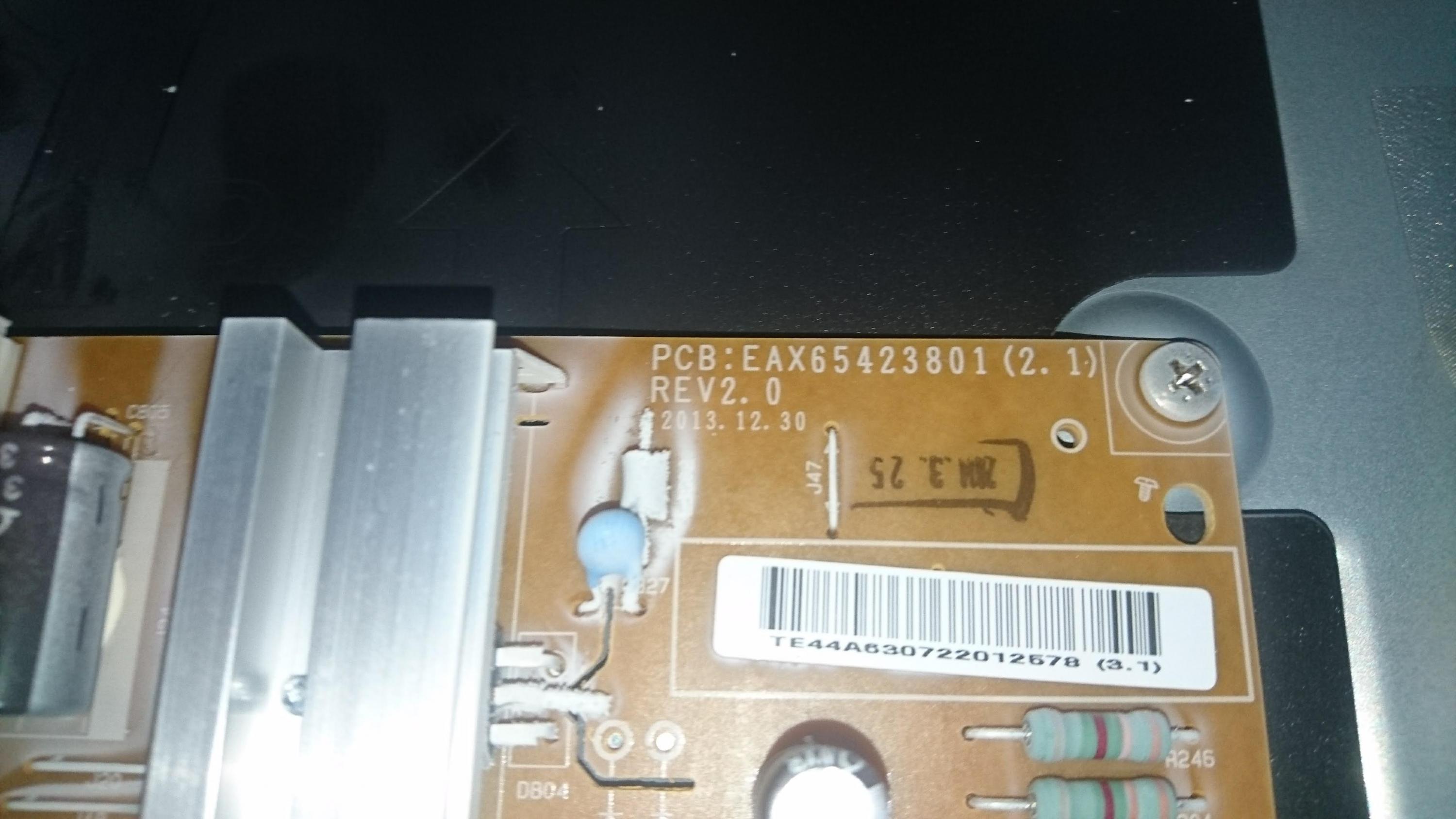

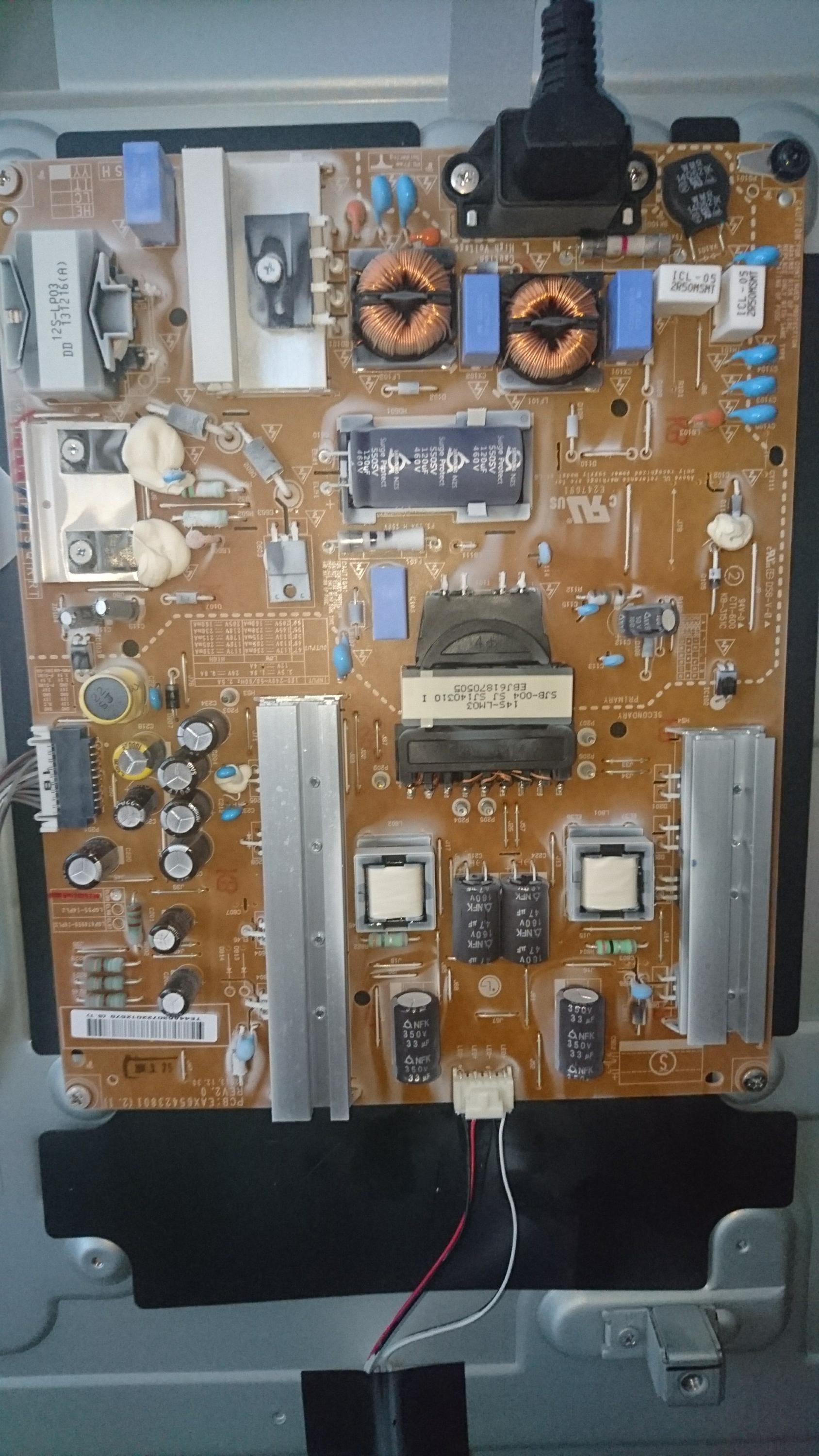

    Hi respected members of this forum,
    I've just received a LG 60LB650V LCD (PSU board EAX65423801) that has a flashing backlight. It flashes about every second with one dim flash and the second with full brightness. When the menu is showing on the screen is seems intact without any dark areas. I´ve searched for info about this and most (out of few) cases it was due to bad LED strips which needed replacement. However, my sympthom isn´t quite the same with that dim/bright/dim/bright cycling.
    Also worth mensioning is that the voltage on the connector out to the LED strips is changing accordingly with disconnected LED´s. That´s strange? All the capacitors measures fine.
    Where should I begin?
    Thanks!

    Re: Flashing LED backlight on a LG 60LB650V
    It's the backlights. Here is what happens: As a start, the LED backlights are not voltage controlled, they are current controlled. So the PSU is looking for a certain current draw from the backlights. LED's can fail in a weird way, the can work fine for a few seconds, then not. Don't get distracted too much and fix what you know isn't right.

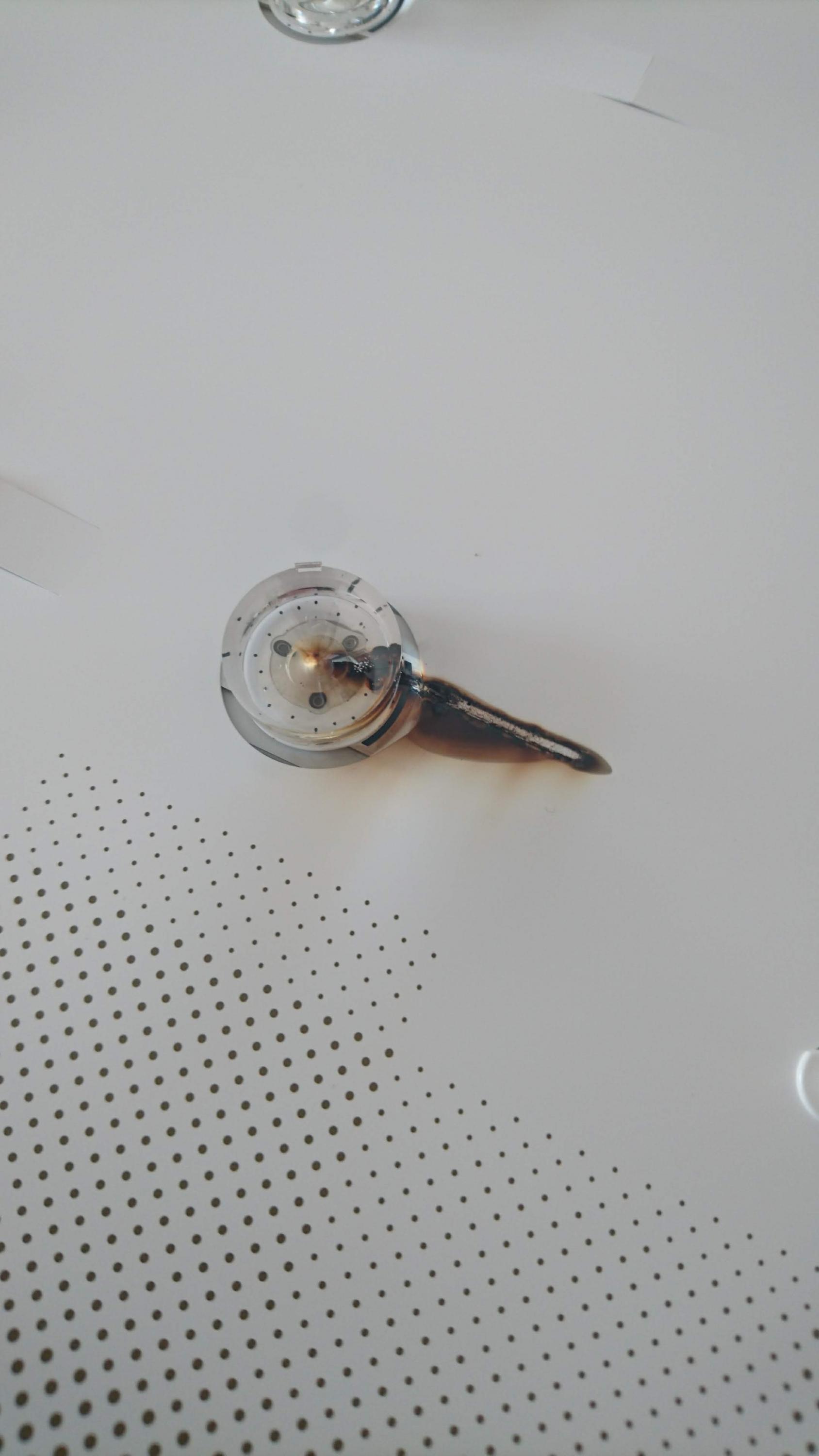

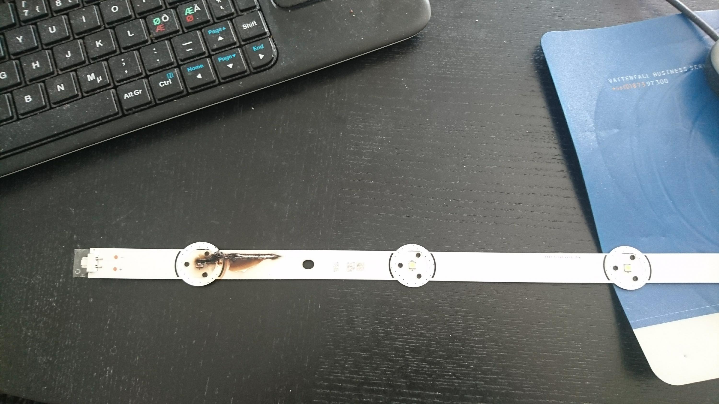

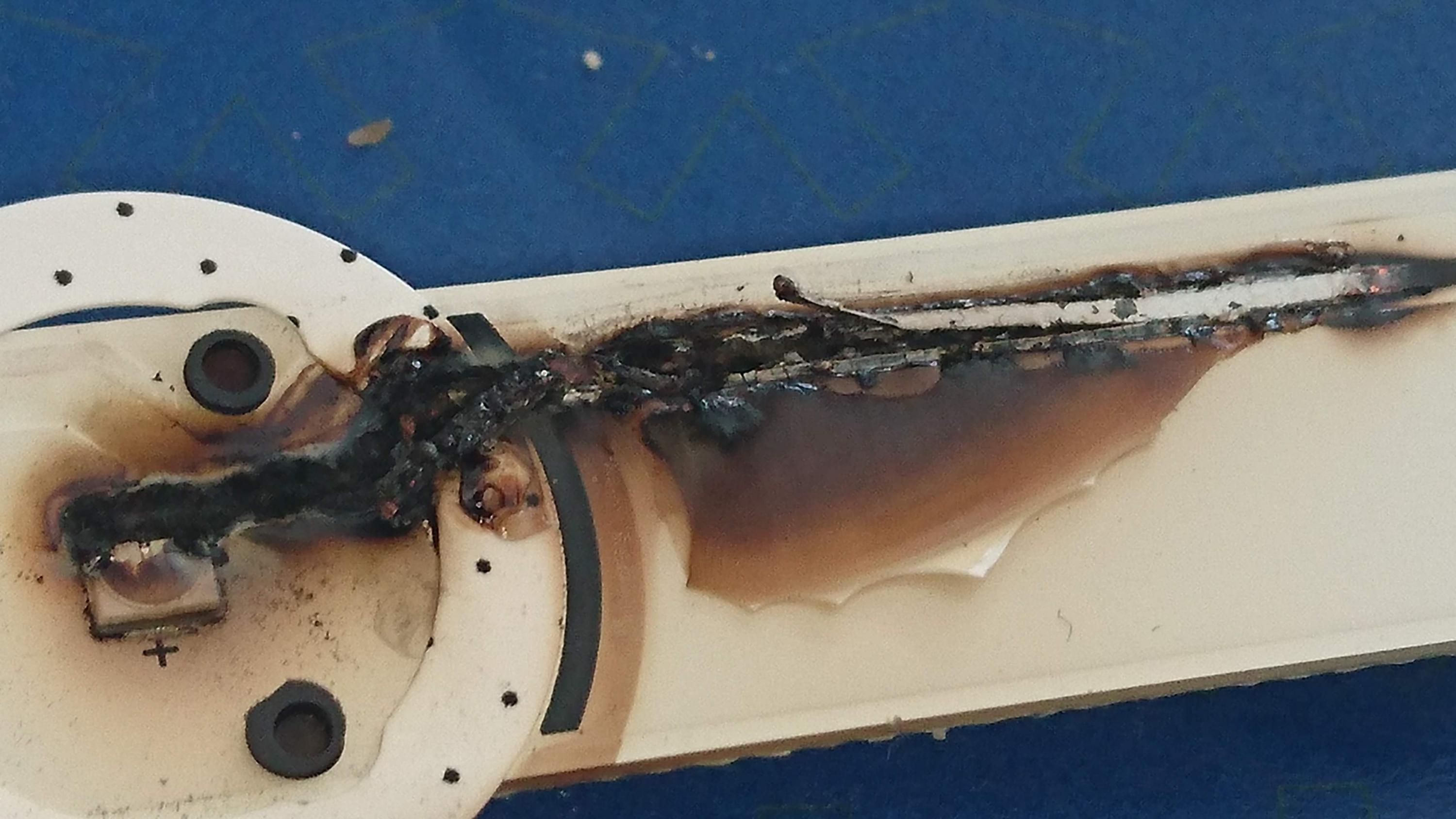

        Found the problem
        Just ordered a complete set of new LED strips from Aliexpress and hopefully the TV will become as new again.
          I would get some white electrical tape to cover up the burn on the plastic led cover sheet.
            Yup, either that or some white paint. I guess it must be reflective in some way too?
              scrub the crap out of it with 99% IPA
