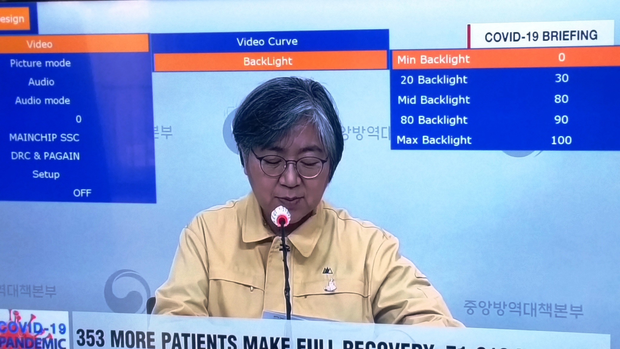

                            the subject become interesting.. good all of us can now agree on Pulse width roll at this subject. Pulse width are Firmware script Steps, usually this script started to control the LEDs currents with first startup steps. ( we can notice the Logo come out bright then the screen dimming.) the important things at this script it can sending test (TX) and receive answer (RX) not only about the healthy condition of BL but also LVDS/T-CON/Sound/Tuner etc. any answer failed it will turn self to shutdown or ERROR blinking code this depend of the type of the script if engineer included this function at it.
                            we do know this Pulse width will turn on PWM to it 100. but its currents always under the LED Units capacities, removing ONE of the sensing Resistor indeed it will decrease the 100 start. but we will let MOSFET and the U1 IC under less protection if one of the LEDs shorted. ( So why they put 3 R .. they can put 1 or 2 to reach the same value of all 3 together in parallel !
                            Software designer considered this, and gave to users / factories the abilities to decrease the 100 start ( see attached photo the eeprom of BL steps setting ). beside this they used circuit at HW level to let the 100 Start always are 90% or less of the LED capacities. ( unfortunately not all of course ).
