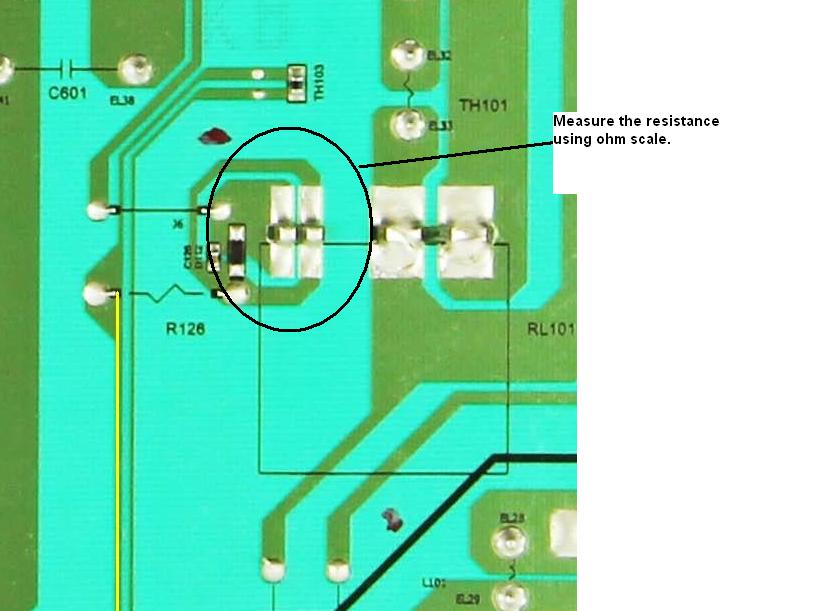

    There is no need to take the relay apart. also if there was a load in the circuits that are supplied by F101 and F102 the relay would turn on and the fuses would blow.
    I believe he is measuring 120vac from chassis ground to the fuse, that is why he is measuring 120vac

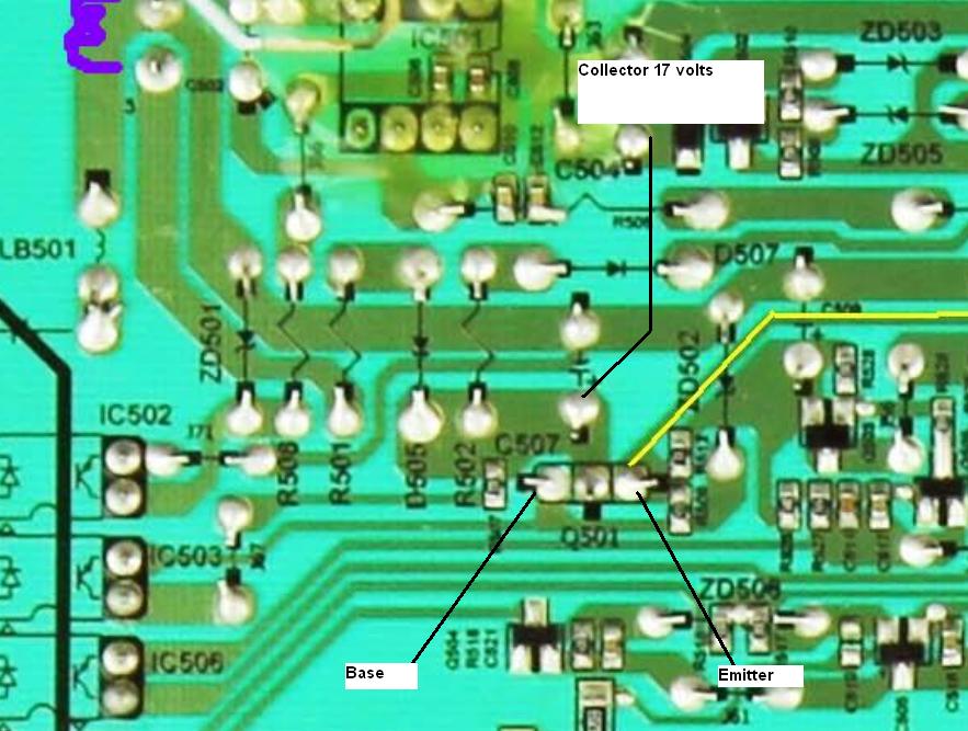

      Ok, Firstly, thank you both for your help
      @R_J
      My initial voltages were erroneous vs chassis - the correct voltages are 331 vs C621 (-ve)
      I measured the following voltages vs J50 with no jumper then with jumper P1 (verified by coloured wire and triangle on the board) to P3 the next pin up.
      C507 17.0 0-2V
      C503 16.5 6.6-6.7
      C504 15.3 13.6-14
      I don't have the experience to tell which cap is bad (no schematic) but I'm guessing its C507?

        You are getting close to solving this problem.
        The voltage on C507 should not drop to 0 when the power supply is turned on, I suspect you could have a short on Q501 emitter to hot ground. (The transistor will be ok)
        Check that ZD502 is not shorted.
        Check the resistance across the relay coil, There is a small diode and a capacitor across the coil also. The coil, diode or small cap could be shorted.
        When Q501 is turned on by the opto, it must be switching the 17 volts to hot ground. This also reduces the feedback feedback voltage in the standby circuit and that is why the standby 3.3 volts also drops.
        The voltage should be about 12v on Q501 emitter to turn on the relay, the voltage is not there son no relay click and without the relay turning ON, you will not have any of the other power supply voltages.

          Thanks R_J - I see where we are going with this.
          OK - ZD502 is not shorted.
          Coil resistance 49.7 ohms - neither the diode or cap shorted (i.e. resistance across each consistent at 49.7).
          I checked the Q501 voltages with the jumper in and out - 17V collector and Zero B/E - no Jumper. With Jumper 2V Collector and 500mV B/E so its turning on a little but not enough.
          I checked further down the chain C509 has a resistance of only 5 Ohms. I'm going to replace it and see what happens

            Re: 55EC930V Help please
            Well either the voltage at the collector can't supply enough current to turn on the relay, or something is drawing too much current. Check R501 and R502, they could have changed value?
            Even if the base voltage is not high enough, the voltage on the collector should not drop.
            This transistor acts like a switch but also as a regulator that supplies the voltage to the relay but also supplies the VCC for the pfc ic. The zener diode on its base sets the regulators output voltage, likely 12v.
              C509 replaced - CLICK!
              Now to start checking voltages...
              With only Pins 1 and 3 jumpered, 12V and 24 V present on correct pins of P102 - working through the rest of the troubleshooting guide - will update

                Ok, so C509 was measuring 5Ω out of circuit? Check Q501 emitter voltage.
