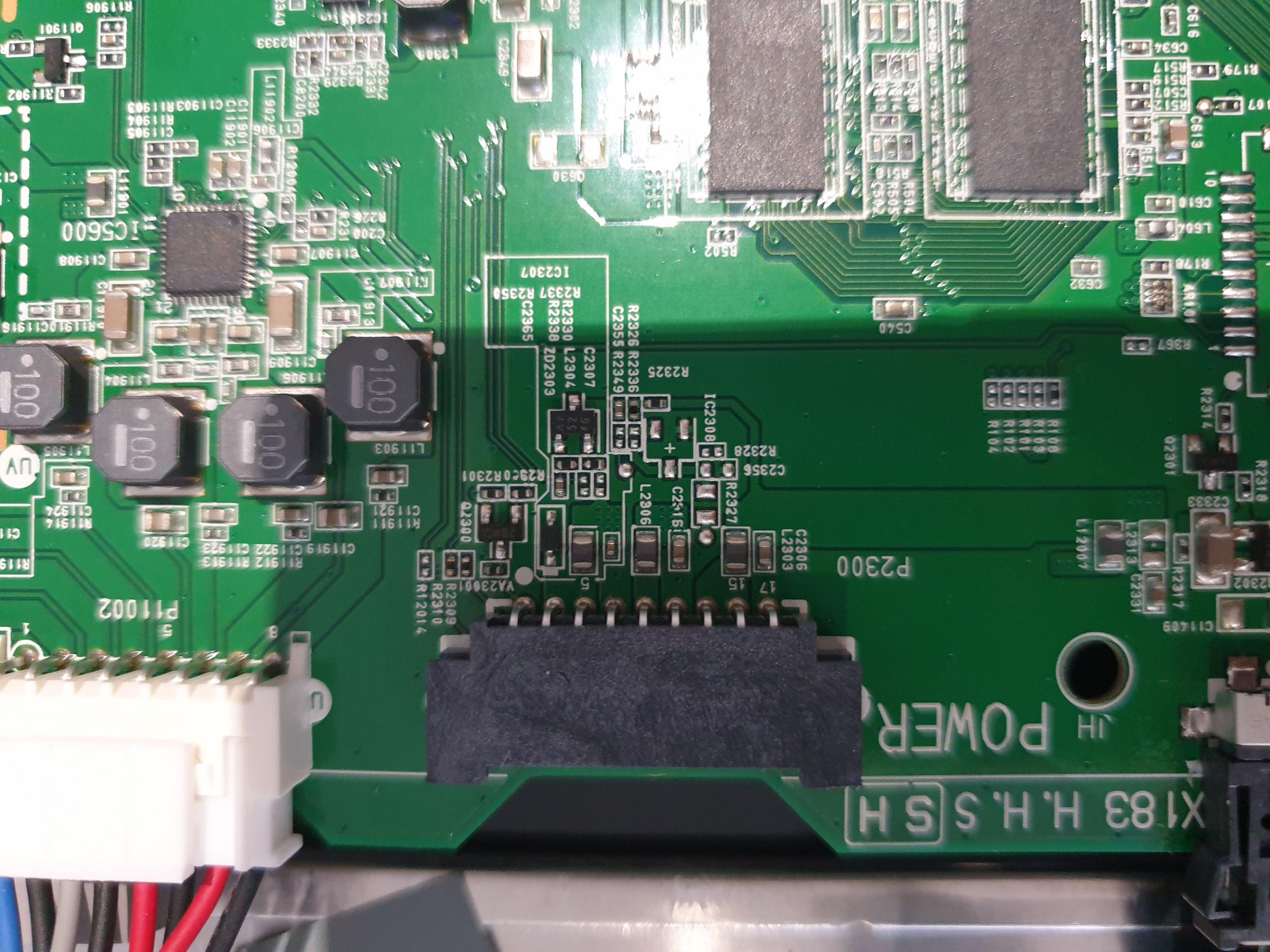

    The symptoms are that the LG symbol lights and flickers when the black power button on the back of the unit is pressed and also when the remote power button is pressed. The TV does not power on.
    AC (240V) is present ath the sck100? where the power arrives on the main board. All fuses are intact and all apart from the one by the main socket have 120V.
    Power Supply Board Low Voltage Test 1 yields the following:
    3.5V at pins 3 and 5 of P201.
    I disconnected P2300 ribbon cable and added R110 across pins 1&3 or 1&5 but this yields no click and no 12v or 24v power when AC is supplied.
    So either the relay is bad or ??? Any guidance greatly appreciated

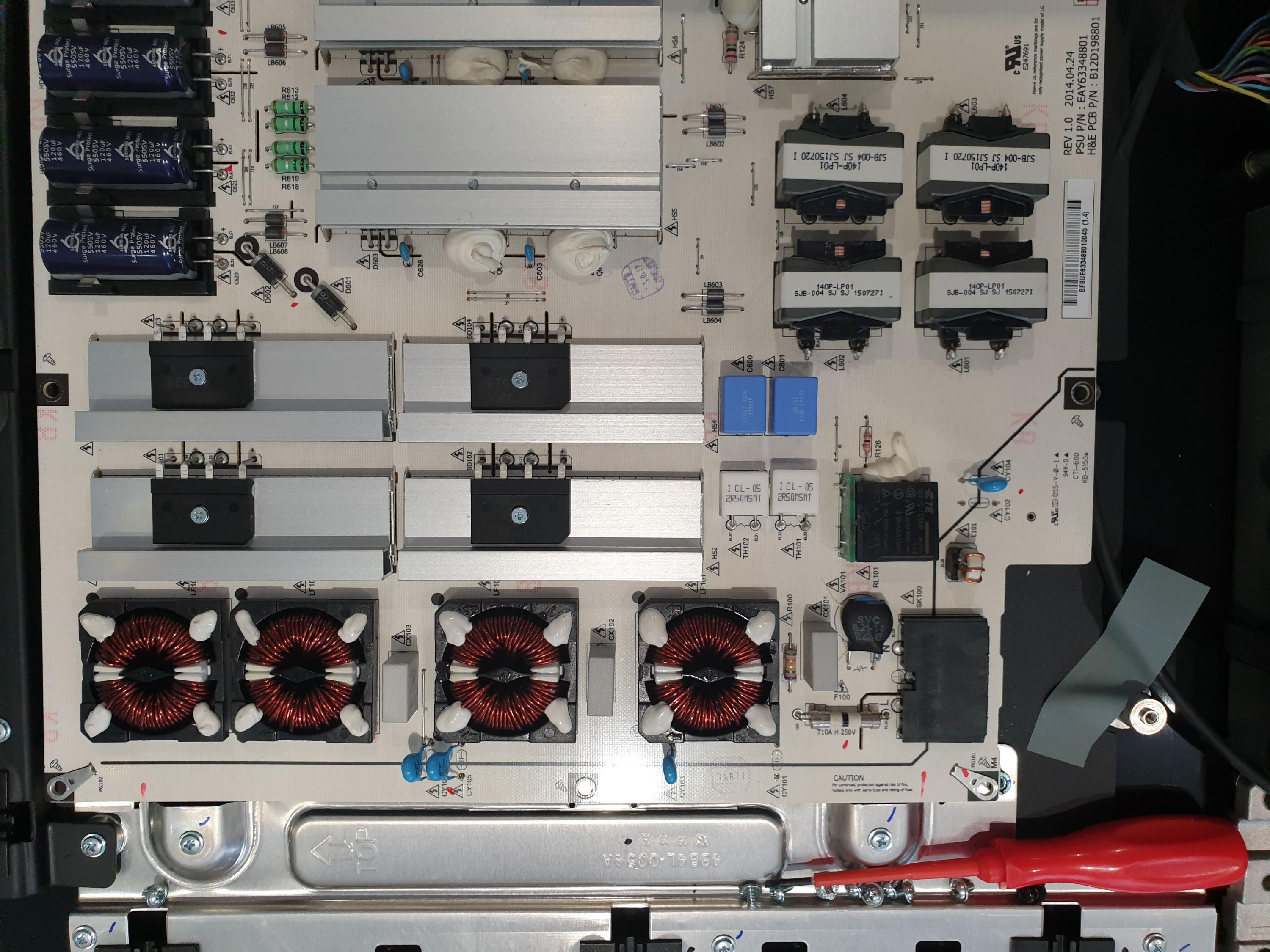

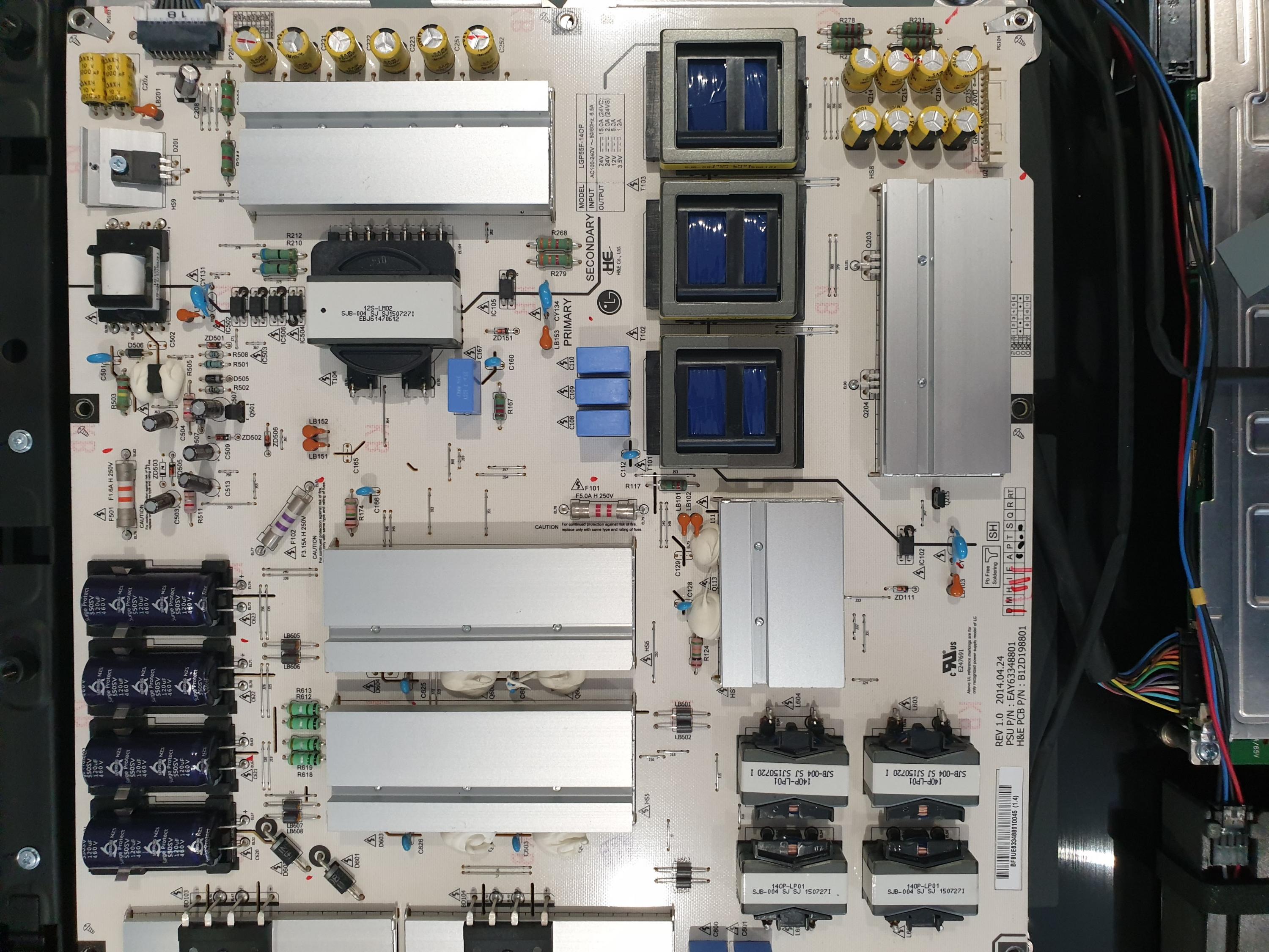

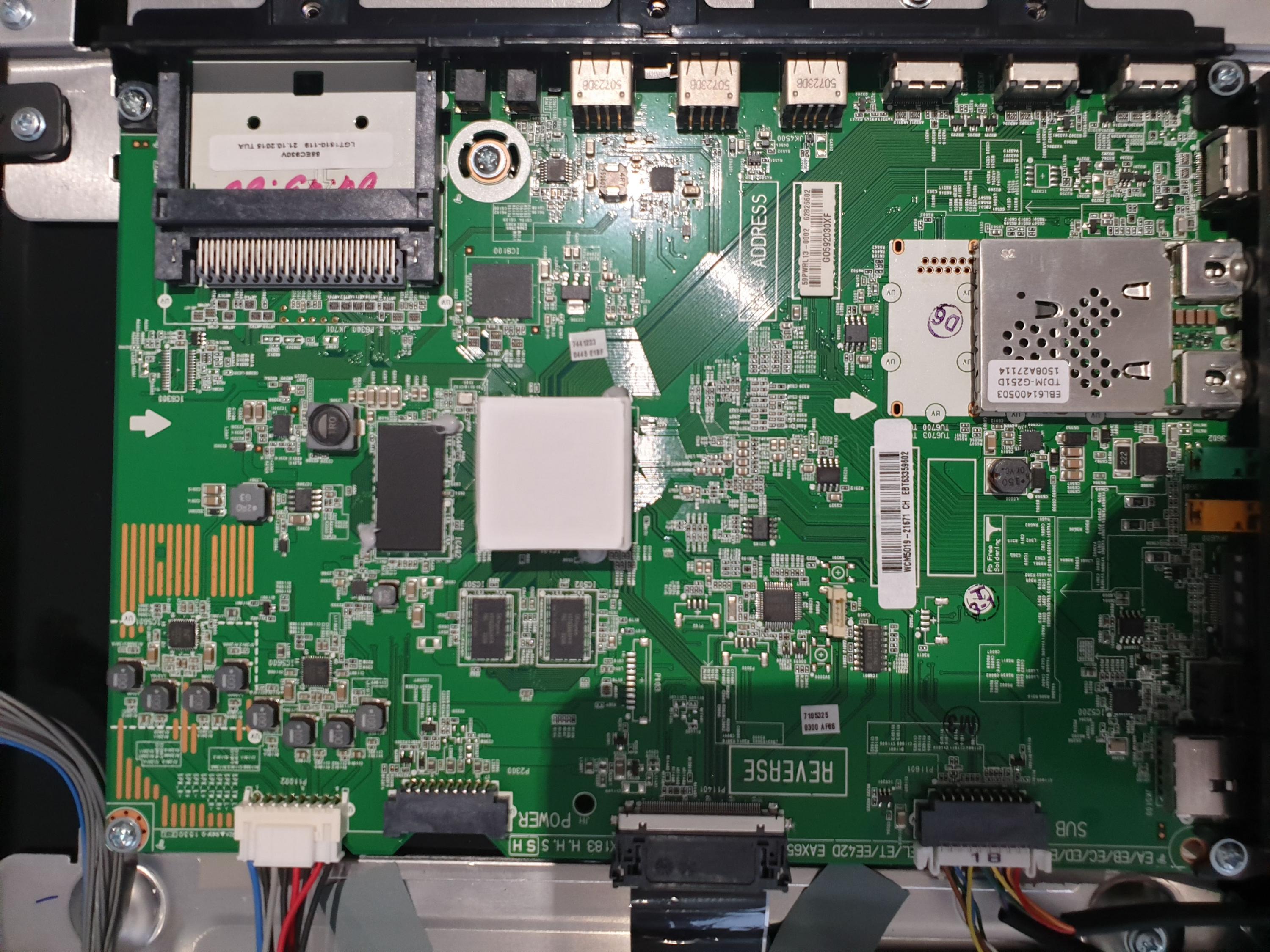

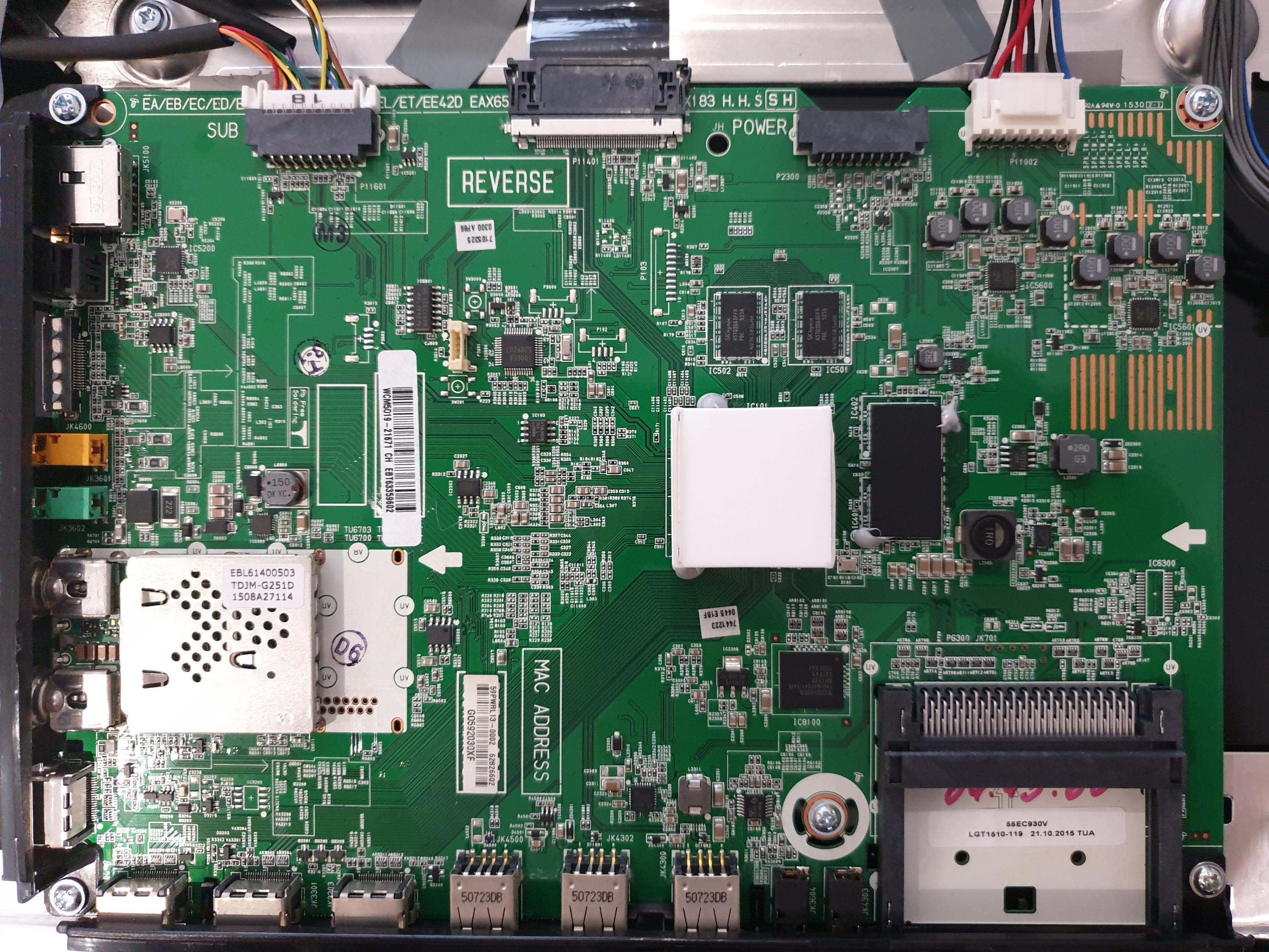

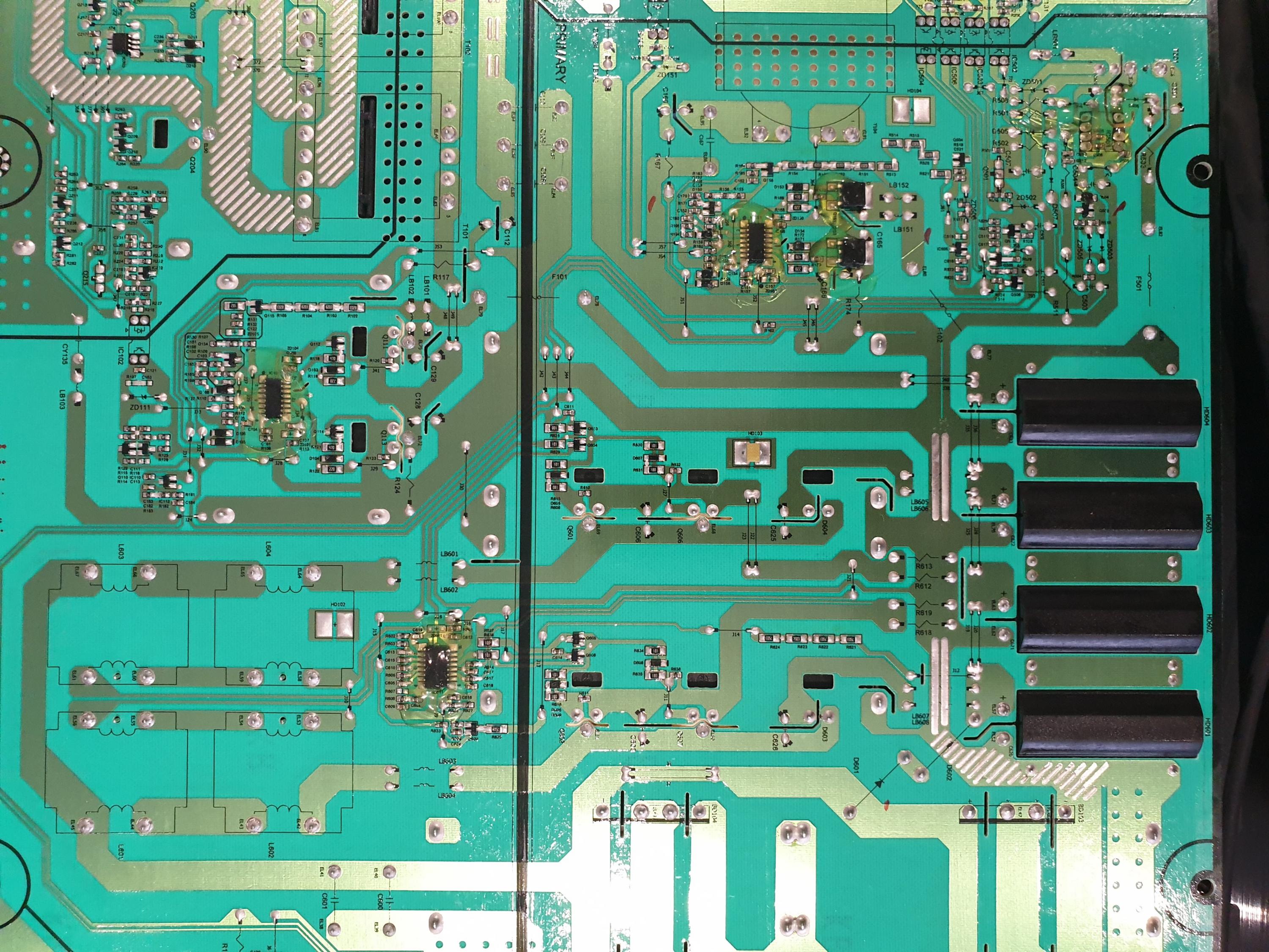

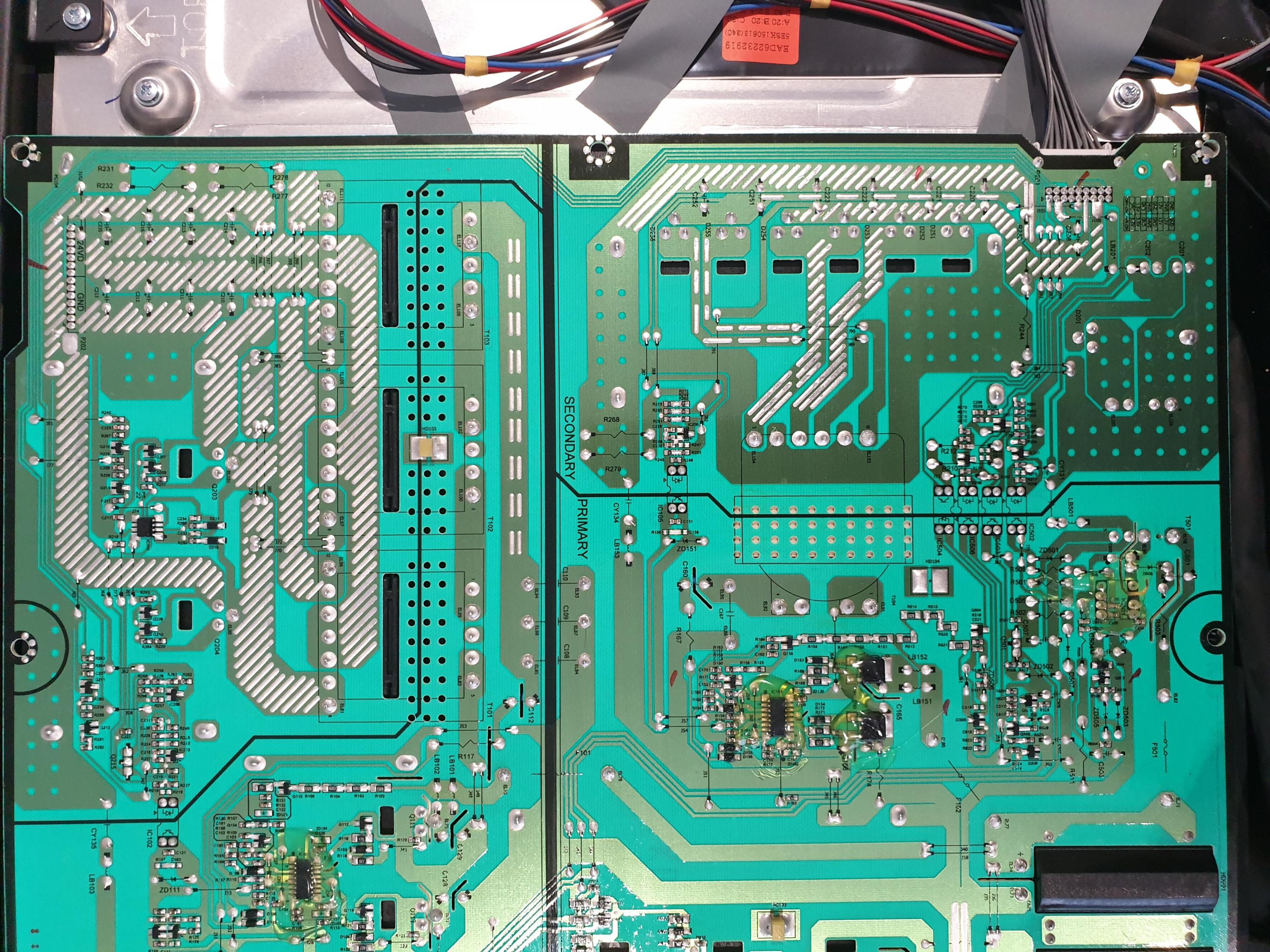

    How bout some good pictures of all the boards and one of the whole back including all the boards, and a up close picture of the P2300 and any legend/map of the expected voltages.

        @nomoresonys - I'll attach the photos below.
        @R_J - The fuses are all good. On checking the voltage to the Opto with the link across pins 1&3, I see a fluctuating voltage of 1V +- 0.1v which is not good (I expected 3.55V - correct?).
        With the link removed, I see a steady 3.55V at the terminals on IC503 (on the low side)

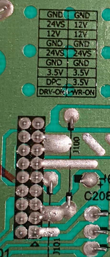

          Re: 55EC930V Help please
          Recheck P201, do it just like #3 in my signature below.

                OK - I'm back! Many thanks for your good wishes

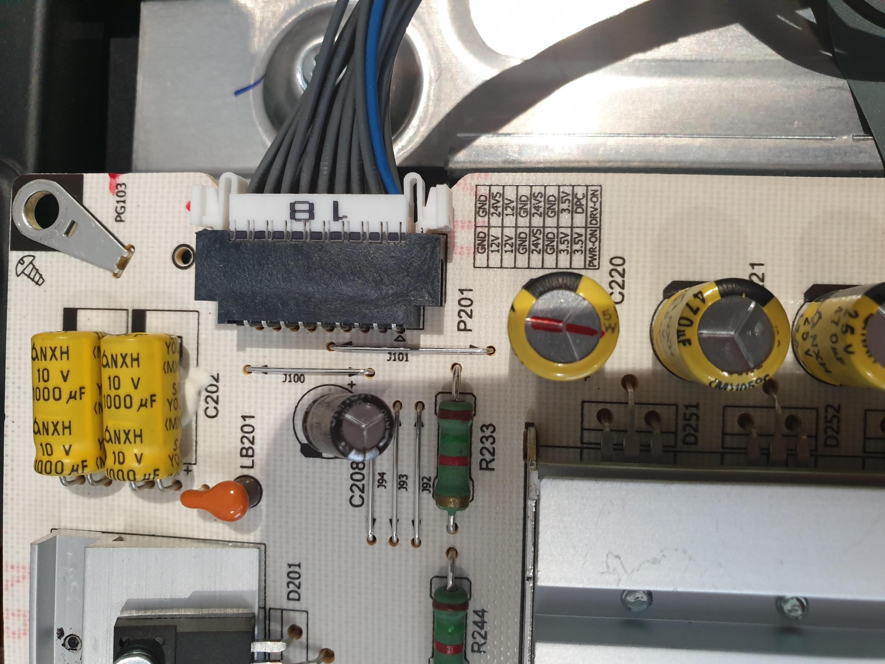

                I made sure everything was plugged in but inverted the power board to gain access to P201 pins from the rear. I attach a picture of the pins and the legend above
                The voltages are as follows:
                System power on but in standby
                0 0
                0 0
                0 0
                0 0
                0 0
                0 0
                3.55 3.55
                0 3.55
                1.9mV 0
                I then pressed the remote power button once. The LG led dimmed and recovered.
                the following (same) voltages were measured
                0 0
                0 0
                0 0
                0 0
                0 0
                0 0
                3.55 3.55
                0 3.55
                1.9mV 0

                  Did you meaure the voltages WHILE pushing the power button, or just push the power button, and after the led dimmed/recovered, measured the voltages again?
                  Check the PWR-ON pin while pressing the power button

                    OK with the PWR button held ON
                    0 0
                    0-5mV 2-40mV*
                    0-35mV* 2-40mV*
                    0 0
                    0-5mV* 1-5mV*
                    0 0
                    3.55V 3.55V
                    0 3.55V
                    1.9 - 50mV 0-?? Volts - oscillates high enough to get the meter to switch scales and then cuts off to zero and restarts - period about 2 seconds
                    *These values oscillate up and down with a period of about 2-3 seconds

                      this is wrong work. your MB and T-CON driver boards should disconnected from PSU when you like to trace the 12 & 24 Volts on PSU.
                      Never..NEVER connect the both mentioned board to PSU if you are dont have clear stable 12 & 24 V on PSU.
                      yours photo https://www.badcaps.net/forum/attach...2&d=1566988083 solder out the both driver IC near to LB501 502 0n the back side of PSU. you will find the issue there if one of them cracked out.

                                    i think you had wrong contact.
                                    you should connect 3.5V to the pin PWR_on not DRV_on
                                    PWR_ON = power on ( Supplying 12 24 V to MB ) Relay Click .... this one we like to trace first.
                                    DRV_ON = driver on ( supplying 24 volts to T-CON driver this will work only if you have relay click and 12 24 V present by step (PWR_ON )
