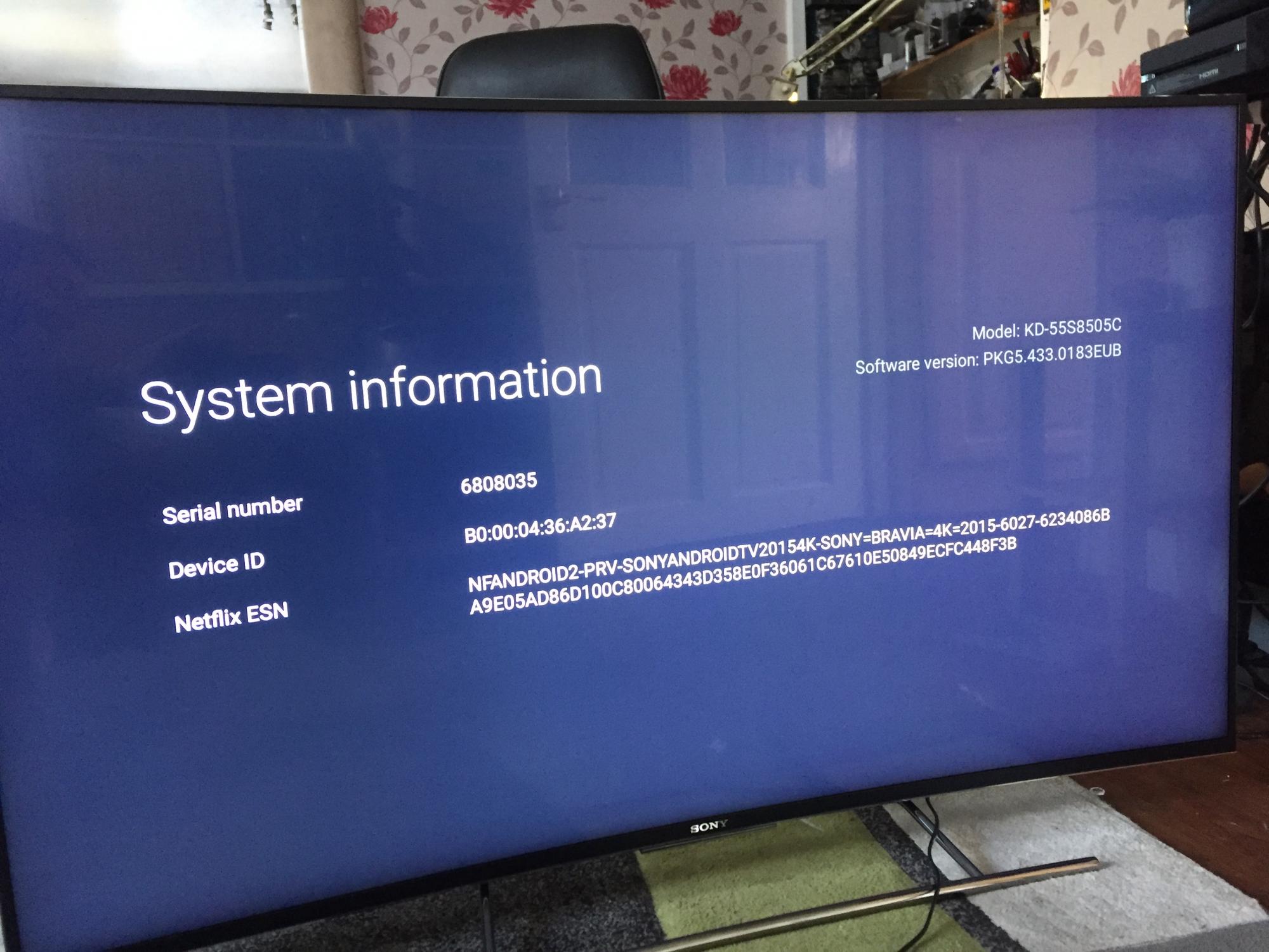

    Hi got a Sony kid-55s8505c that keeps rebooting.
    Tried resetting but no joy, could anybody confirm reset is done by pressing vol - on control and power on back of set whilst plugging set in ?
    Also tried firmware update via usb but as the tv does not boot its not doing the update.
    So I suspect mainboard.
    Anybody any ideas ?

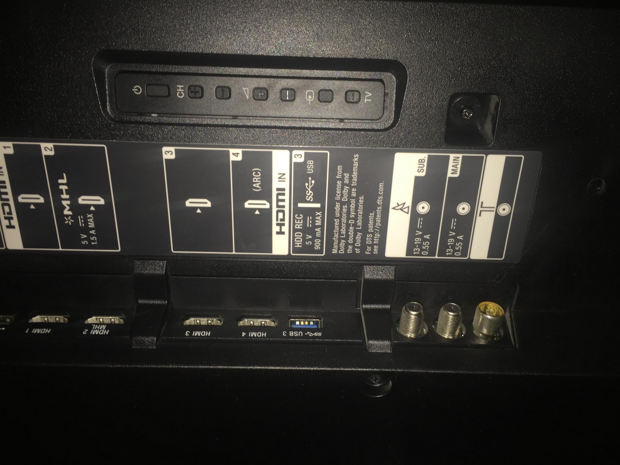

      Re: Sony KD-55s8505c restart loop
      No it got 7 buttons (pic attached) and as of yet not seen anything from the power led, and it uses the BMFW main board.

                You can see which number firmware that you have?
                • ozy
                  • Jun 2009
                  • 44
                  Yes as I said earlier one time it did boot up and I got into help menu to see the firmware version, then it rebooted from that screen and reverted back to original fault.

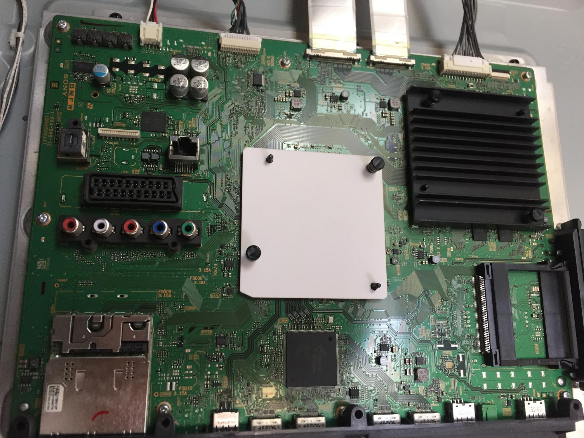

                    Maybe check your boards for bad/cold solder joints, examples there but some are not so obvious: https://www.youtube.com/watch?v=XhlNewlhH3U
                      Already done that, few possibles on psu but nothing obvious, resoldered them and all the usual suspects but made no difference, main board looks ok may try a reflow on cpu / ram later, just wanted to see if anybody else has resolved this issue without replacing board.

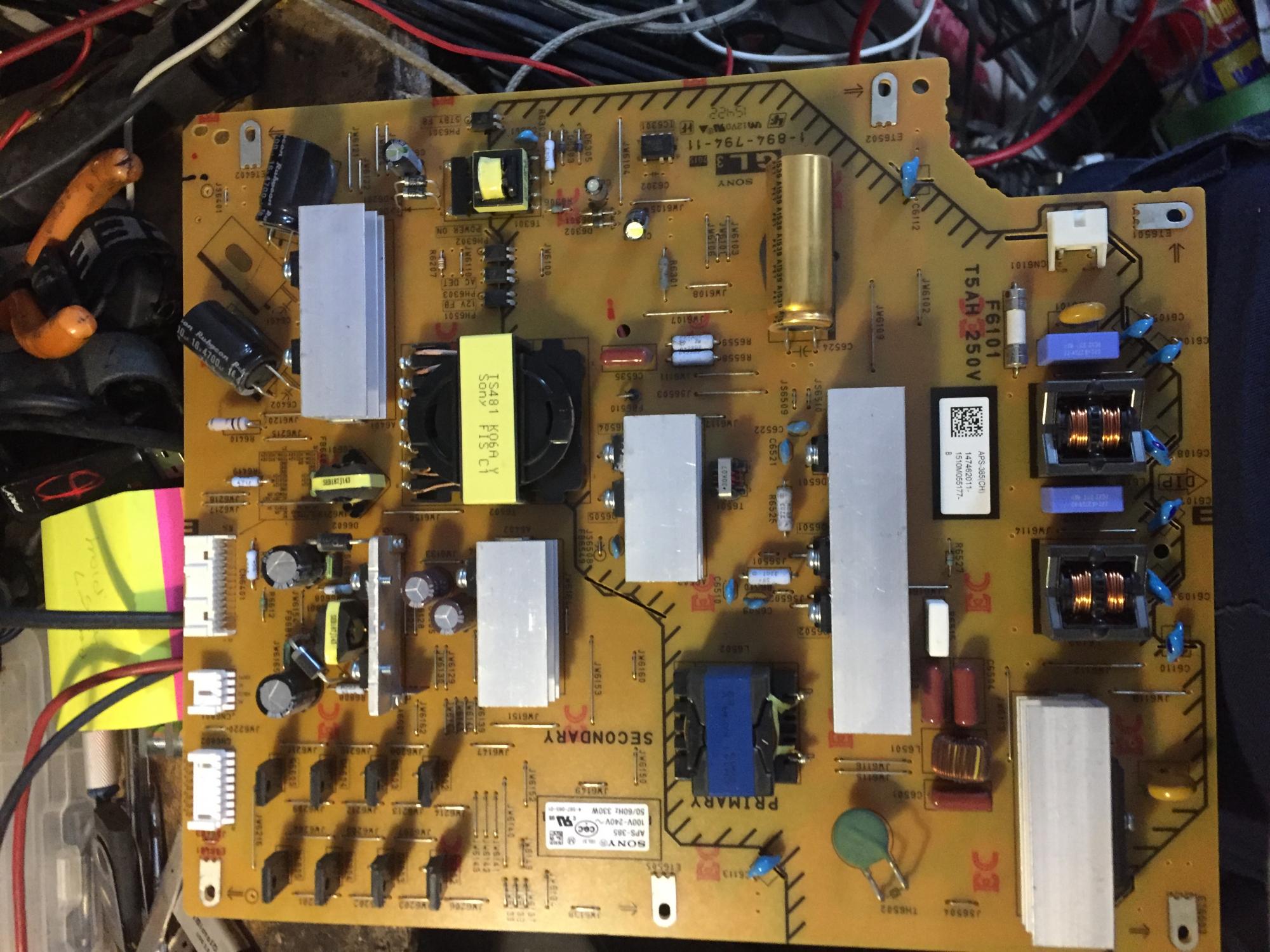

                        Try with power cord unplugged from outlet, unplug cable from powerboard to mainboard, plug power cord back into powerboard, see if backlights come on and stay on, ie if you didn't already.

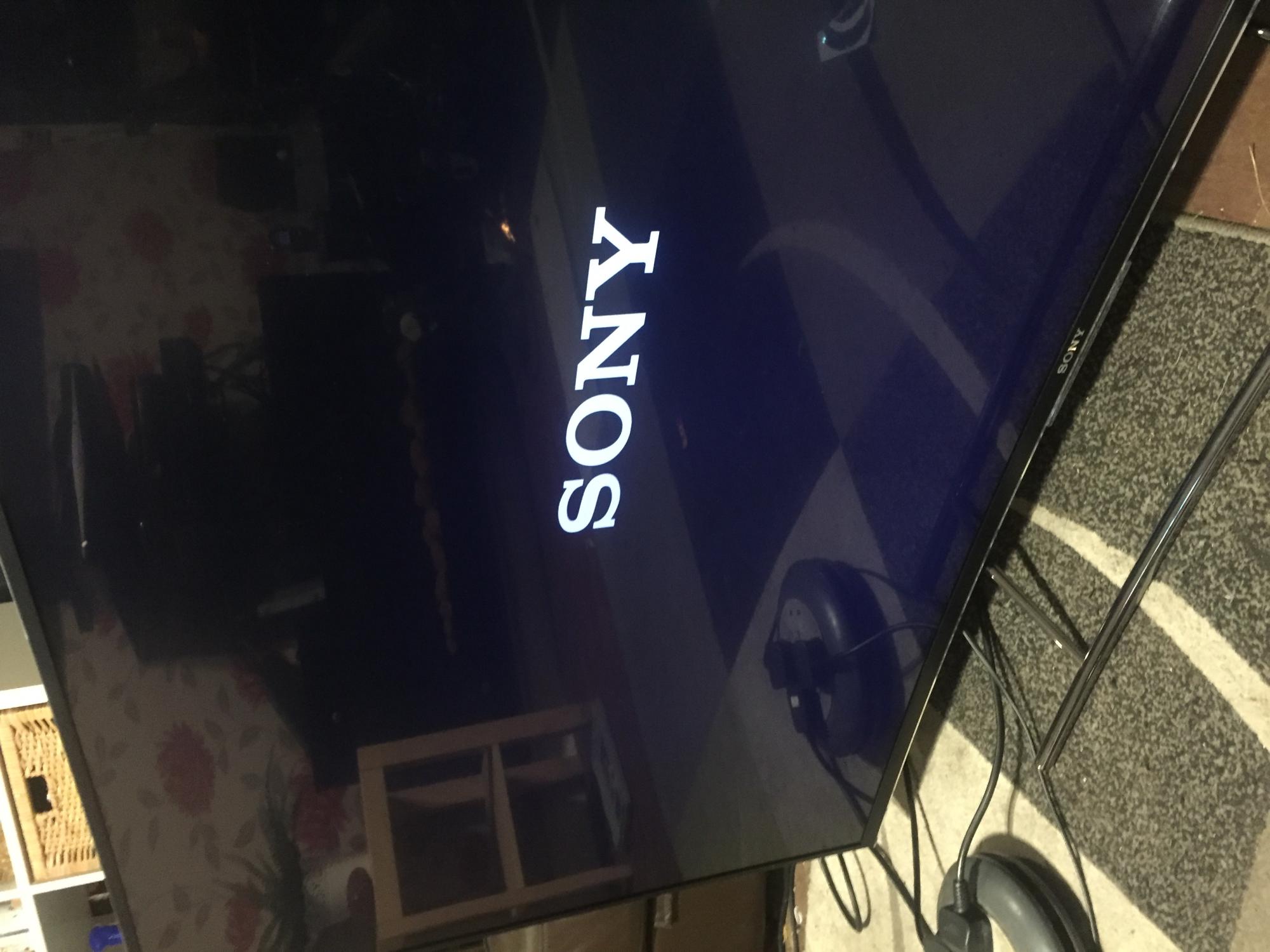

                          did Try that but there was no backlights on, tried with mainboard disconnected and with main and tcon disconnected but not even a flicker from the backlights,
                          Don’t think it’s a backlight issue though as the boot up animation freezes before the backlight switches off.
                          Also tried heating and cooling the boards but this doesn’t seem to have any effect either.

                            Your tv is about a 2015, I can't imagine it not having pullup resistors, my 2009 does, so when you have the power and mainboards unhooked the backlights should come on and stay on, might not be the only problem but I think it has to do with powerboard or backlights circuit.
                            • ozy
                              • Jun 2009
                              • 44
                              I will have another look later see if I can find bl-on and monitor it or manually trigger the backlight, I did get power led to pulse error 6 when I disconnected the led plug so assuming the current draw from backlight is within tolerance.
                              • nomoresonys
                                • Jan 2013
                                • 12331
                                • U.S.
                                Picture isn't very clear, can you list the pins and their description for the connector on powerboard that runs
                                to mainboard, might be a lebend/map close by.
