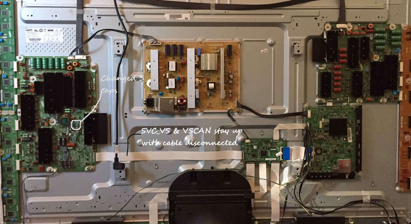

    Hey guys need some help with this one. I've changed the three caps on the
    y sustain board. If cable between the y sustain and the control board is removed the svc_vs,vscan as well as the voltages on the x board stay up.
    If cable is reconnected voltages come up briefly and go down. Never see the
    screen prime. What am i missing thanks

    Video here says to replace all 17 ceramic caps on ysus.
    https://youtu.be/FIJlsuyY3No

      Thanks for the reply i saw the video before and was looking for a shorted cap and did not
      see any. I will like the video suggest change all the capacitors in question. Just curious as to what is missing voltage wise which would cause shutdown.
