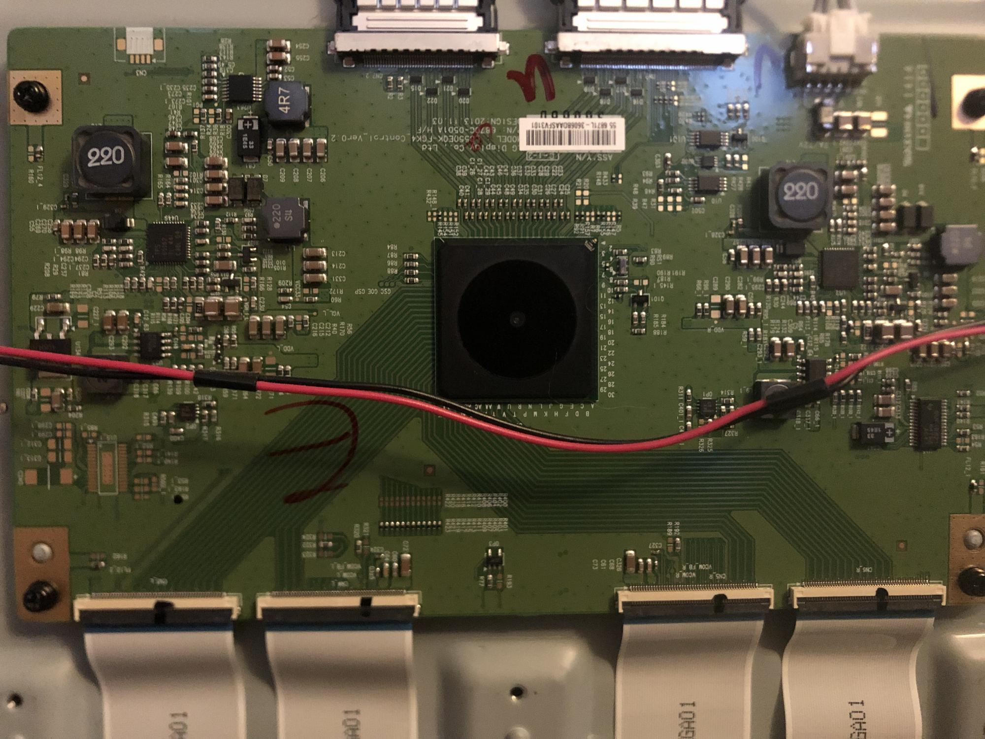

      Please post good clear straight shot of the whole T-CON board. There should be lots of Voltage test points on that T-CON board and we also need to check the DC resistance on those test points also.

            Tcon
              Re: XBR55X850B Backlight, audio but no video
              Pictures is not clear enough for me to read all the test points.
              I can see VDD_L, VDD_R, VGL_L, VGL_R, VCC33.
              Look for VGL_L, VGL_R.
              You get the idea what we are looking for, Vxxx.
              Test them Voltages
              P/n of the IC next to the inductor with 220 printed on top?.

                I stared at the board and found every tiny round gold point and here’s what I get:
                VDD_L 16.26VDC
                VDD_R 16.28VDC
                VGG_L -5.44VDC
                VGL_R -5.44VDC
                VCC33 3.34VDC
                VCC18 2.01VDC
                VGH_I_R 28.8VDC
                VGH_I_L 28.9VDC
                The top of that square IC that is symmetrical to the other side is TPS65162
                  Those Voltages look to be normal.
                  TPS65162 LCD BIAS IC.

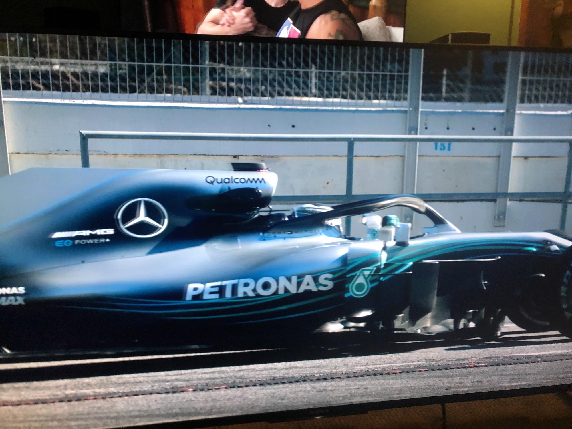

                          Looking into the LVDS cables at the main board paid off! They didn't appear to be evenly seated and the smaller one of the two was pushed in slightly farther and the little tabs at the end of the cable were torn off from not pushing the releases on top of the main board connection. Pulled out slightly on the LVDS and now have full and perfect video. Another 4K saved from the scrap heap. Thanks all for the help!
                            Good news, sometime good inspection helps, so it may have happened when you install the replacement main board.
