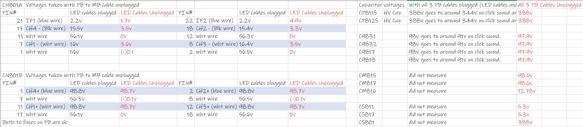

            Re: No display, No audio, six times blinking Standby LED on Samsung LED TV UA40D6600W
            The clicking repeats every few second or so.
            Capacitor voltages:
            Voltages at the 2 high voltage capacitors (CP811S and CP812S) are at 388v goes to around 344v on click sound and comes back
            Voltages at C9831, C9832, C9817, C9818 are at 98v goes to around 91v on click sound.

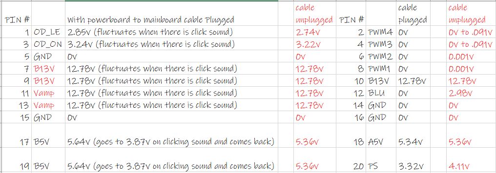

                      Nomoresonys and budm, my apologies, for the incorrect info. In both cases i.e. with the LED cables plugged and unplugged along with PB to MB cable unplugged, the relay clicks only once and stays on after tv power cord is plugged.
                      I have taken all the voltages once again, please see the attached pic. Let me know what I can do further. Appreciate your help guys.
                          You need to do is supply the backlight circuit with the proper PWM signals, OD_LE and OD_ON and then they should turn on.
                            #33
                            You can pull the PWM pins high to simulate 100% full on, just do not do it for too long.
                              how do I pull the PWM pins high to simulate 100% full on? The voltages that I am getting on the all the three connectors as per the pics sent, are they good? What should be the PWM signals, OD_LE and OD_ON voltages to lit the led strips?
                                #35
                                Use a 1K resistor on each PWM pin and A5V pin, so you will need 4 resistors together, and no cable between main board and power supply board.
                                You can also read this Samsung Tech-talk to learn how Samsung does it without resistor when the board does not have pull-up resistors., I always use resistors in case the jumper is connected to the wrong pin.
                                  Looking like the mainboard isn't sending pwm signals, guess next question is, is it something that can be fixed on component level or would it be better to just buy a replacement mainboard if that is the case?
                                    Shouldn't the backlight LEDs light up with power board to main board cable unplugged if the power supply board and LED strips are good? or Do we have to have the PWM signals from the main board for hte backlights LEDs to lightup?
                                      #38
                                      PWM needs to be present for the backlights to be on that is why you need to use the resistors for each PWM pins. Did you not read the PDF?
                                      I did the research and provide you the info, but you are not following through with it.
                                      I also explained why you should use the resistors. I am wasting my times in this post.
                                      Exert from PDF:
                                      Testing the SMPS and Backlight Operation with No Main Board Connection
                                      It‘s important to understand that disconnecting the Power Supply line to the Main Board and plugging in the AC Power Cord turns on the Power Supply circuits but does not light the Backlights in this model. Follow these steps to test the SMPS and Backlights:
                                      1. With the AC Power Cord removed, disconnect the Power Supply Cable to the Main Board at the Main Board end.
                                      2. Connect the AC Power Cord. This will turn on the SMPS Power Supply, but, because all four P-DIM Control Signals are at approximately 0V, there will be no Backlight LEDs lighting.
                                      3. Check the four SMPS Backlight Power Supply Voltages at the four Electrolytic Capacitors: C9010, C9210, C9310 and 9410. They will have changed from 150VDC, the normal supply operation, to approx 95V VDC. The voltages may also begin fluctuating at each supply between 50-85VDC with the supply cycling on and off. This is also a nor-mal possibility in this condition.
                                      4. Check the four backlight strings one at a time. Using an external wire jumper, locate and connect A5V to the P-DIM 1 control pins found on CNM803. This will light the left and right LEDs responsible for the top quarter of the screen.
