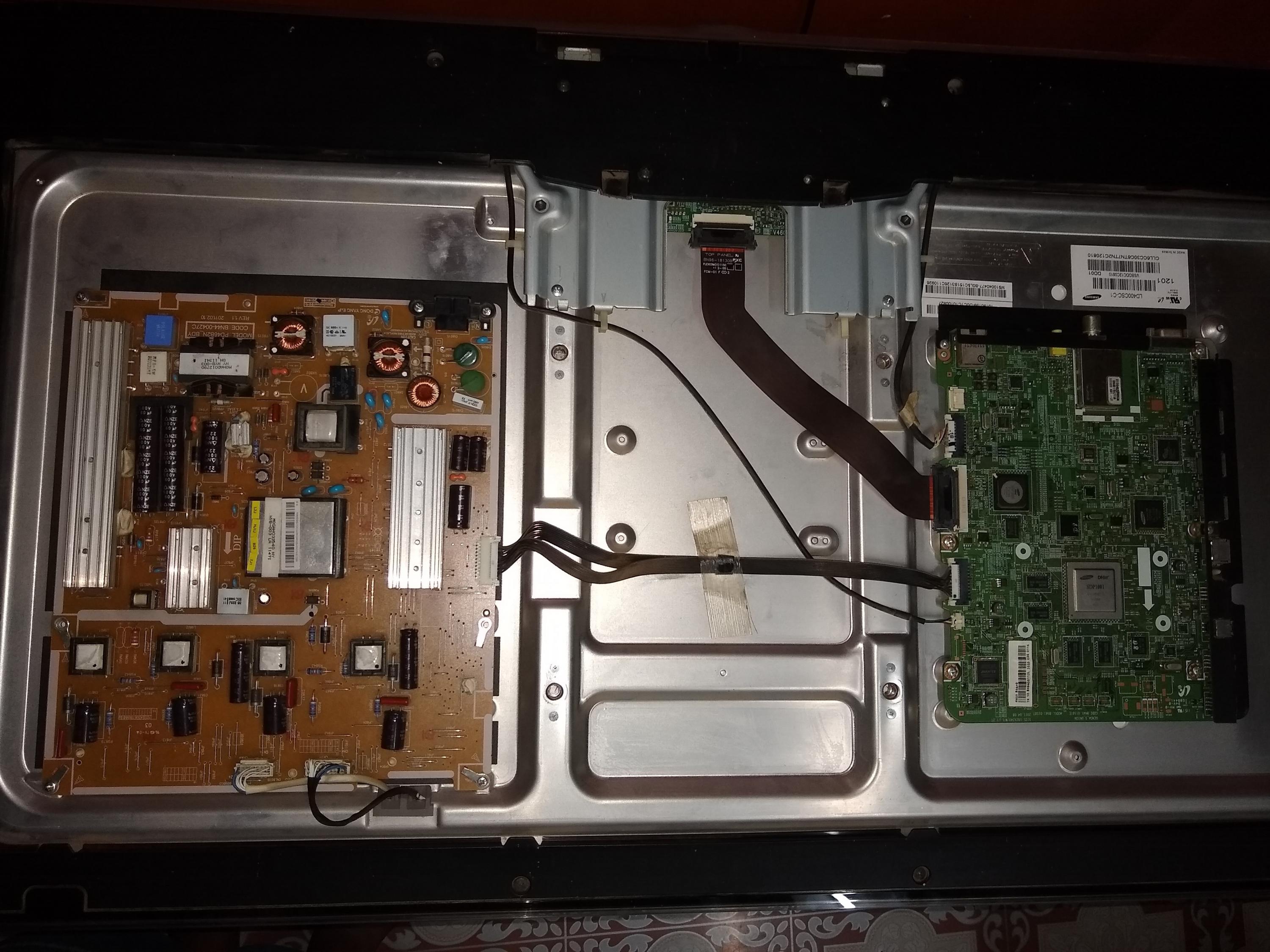

            We also need good clear pictures of the whole backside of the TV showing all the boards so we see what we are dealing with.

                  here's the pic of back side of the tv, the pics are not so good, hope they are ok. Will send more pics of PS and MB boards
                  • devbh
                    • Jul 2019
                    • 20
                    Re: No display, No audio, six times blinking Standby LED on Samsung LED TV UA40D6600W
                    here's another pic

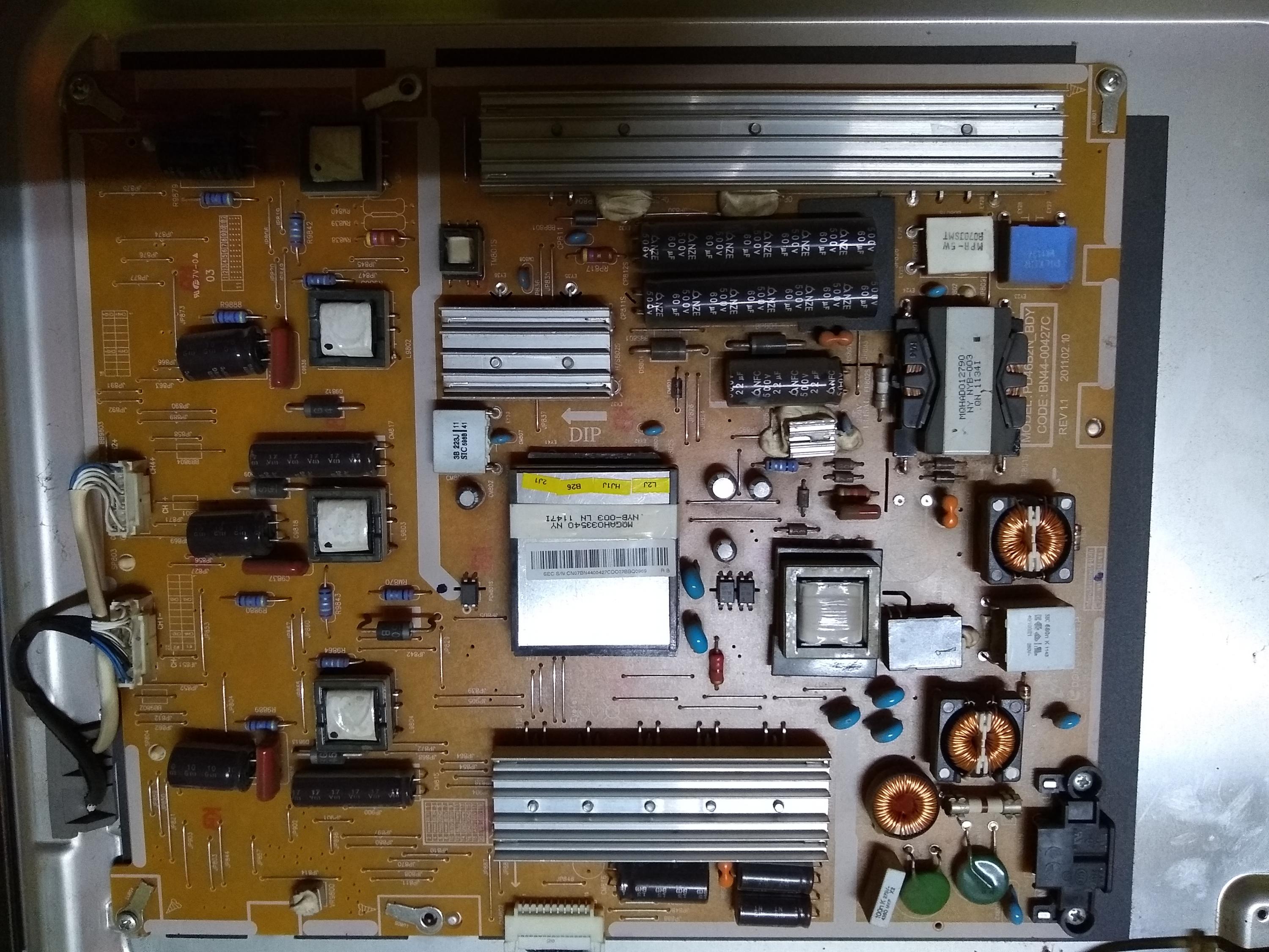

                              what should be the voltages on the all the power board connectors in a working set.
                              • devbh
                                • Jul 2019
                                • 20
                                Here's the picture of the powerboard
