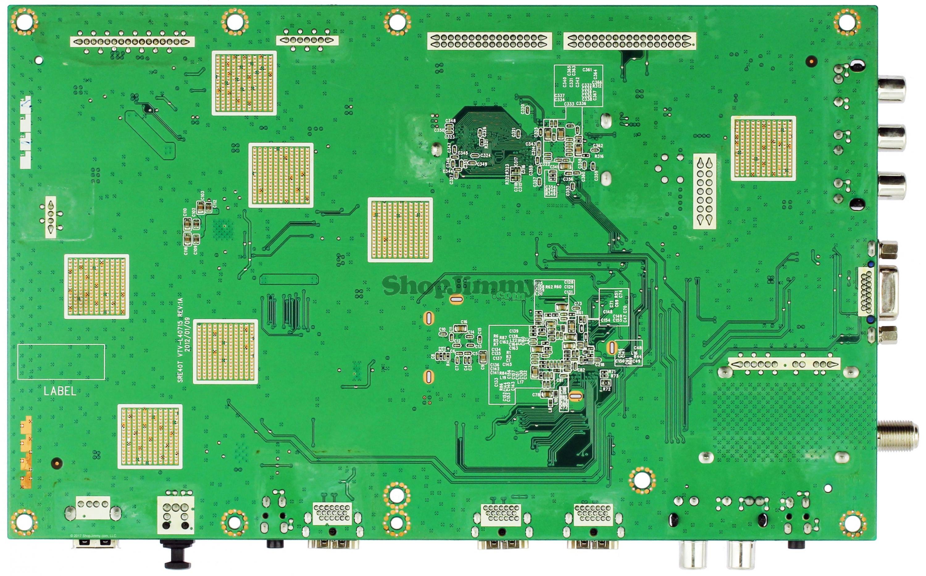

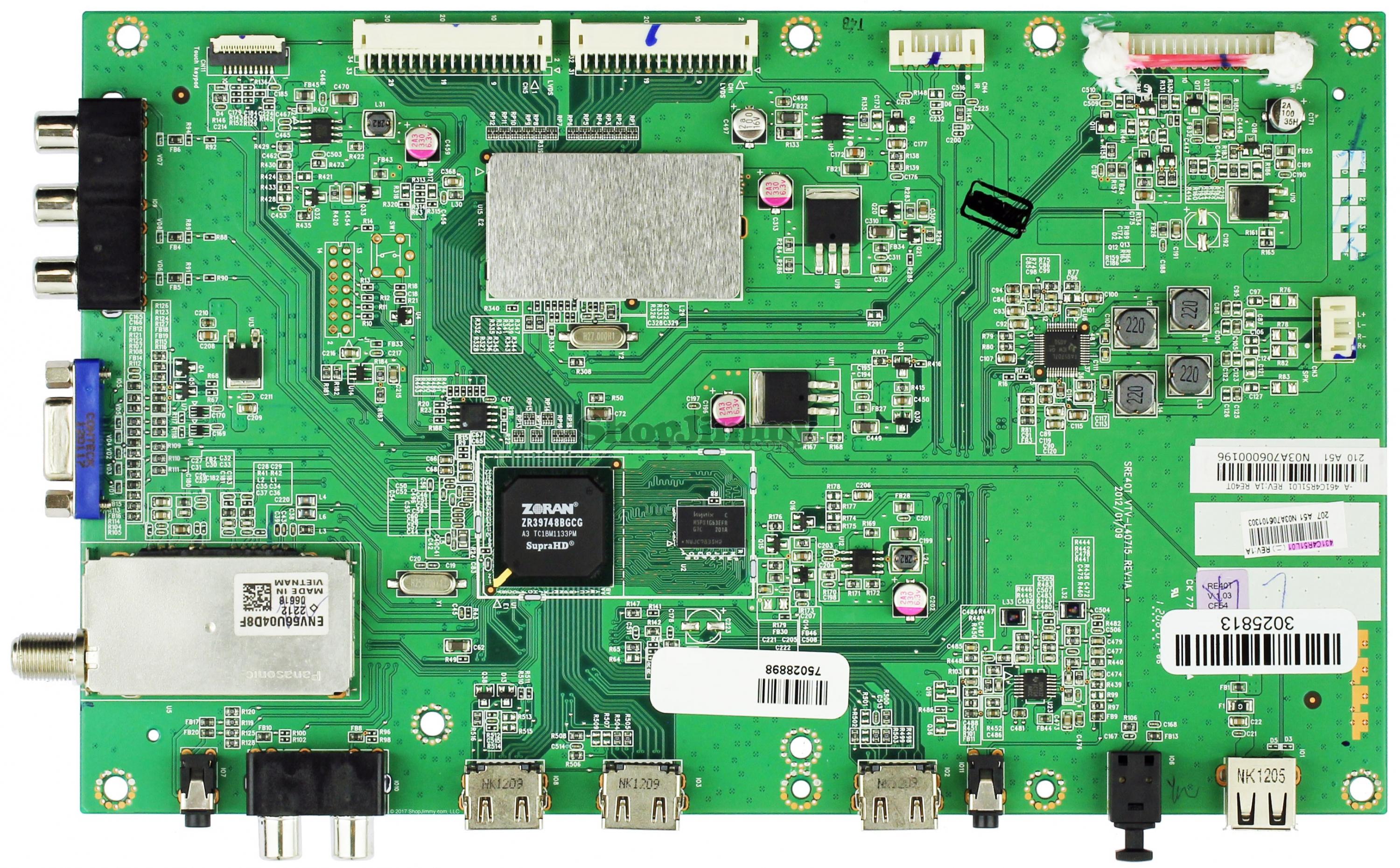

    TV has no backlight. BLON is missing. All other voltages for main board and LED driver are present. CPU on a main board was getting hot. There was no cold spray around so I used a "thermo paper receipt method" under the CPU and found a coil L17 "being hot". Removed it, now the CPU is not getting hot anymore but I still don't have BLON.
    Can't find any schematic for that main board which is Toshiba 75028898 (431C4R51L01) Main Board. I know that it is available on ShopJimmy, waiting for a customer response on a price.
    For the time being I thought maybe anyone has any suggestions beside changing the whole main board. Thanks!
    Pictures credit goes to ShopJimmy
    Re: Toshiba 40L5200U
    Where is L17 located? It sounds like you disconnected the power to the CPU when the inductor is removed.
    • Chuper
      • Sep 2017
      • 36
      So replacement Main board fixed it.
