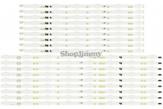

    According to SJ, the LCD panel is backlit, but since we do not have any pictures form OP, we cannot verify if that is true or not. Based on OP pictures, it looks like one set of the LED string is not driven the same as the other set of the LED string.
    https://www.shopjimmy.com/samsung-bn...ght-strips.htm
    https://www.shopjimmy.com/catalogsea...ung+ue55ju6800

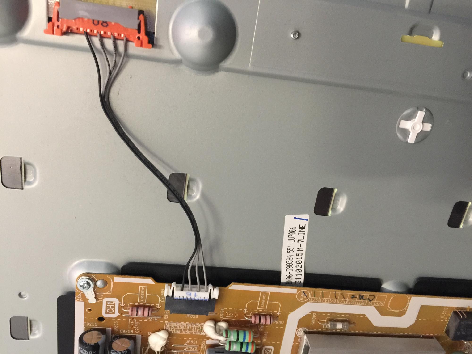

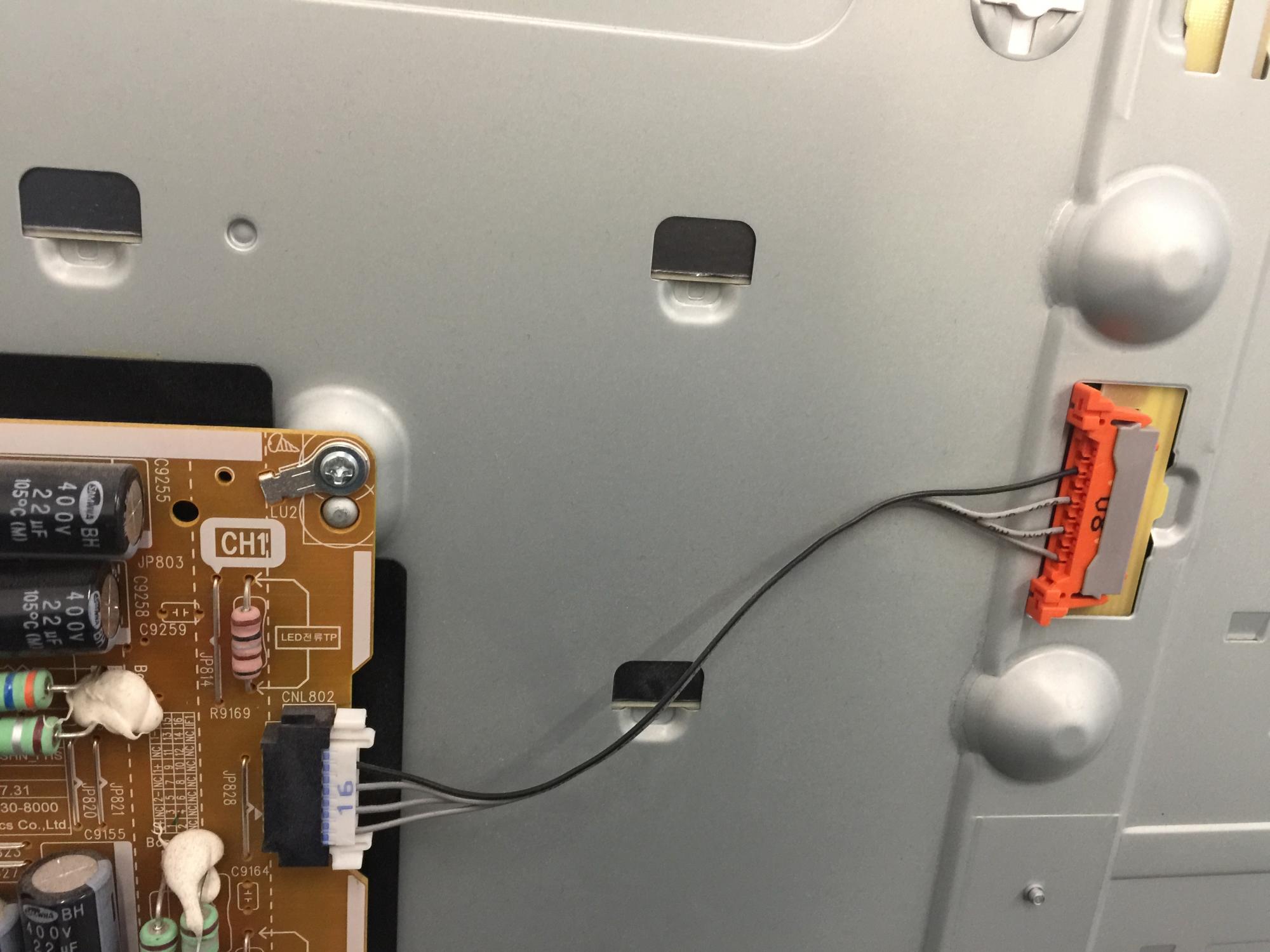

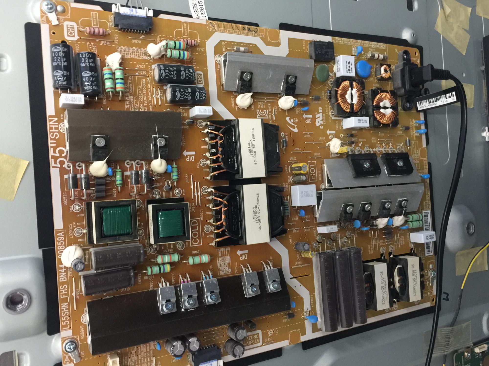

            Re: samsung ue55ju6800 problem with brightness
            Good afternoon
            Sorry for delay reply
            I take some photos
            As you see from power supply to red connector(led bar) i have in first grey cable 310volt ,second gray 100volt and 3 grey 290 volt is that allright?
              I think you need to measure across the "+" to "-" as labeled... those are "driving pairs" for the backlights.

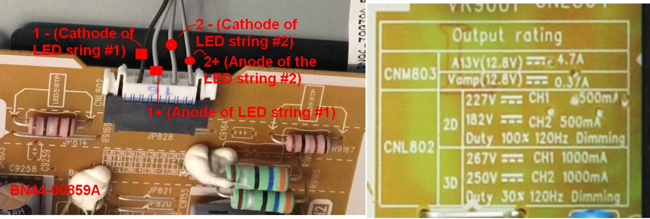

                Your TV has two LED driver circuits, and two LED strings.
                https://www.badcaps.net/forum/attach...4&d=1564065956
                https://www.badcaps.net/forum/attach...7&d=1564065956
                Do you see the two resistors (R9167, 9169) by the LED connector? As you can see, they are labeled for using as the test point, so with the TV turned off, keep the DC Volt meter probes (polarity does not matter if you use DMM) on the two legs of R9167 then turn on the TV while watching the meter and then wait 10 seconds to see what the Voltage changes to, repeat the same test on R9169.

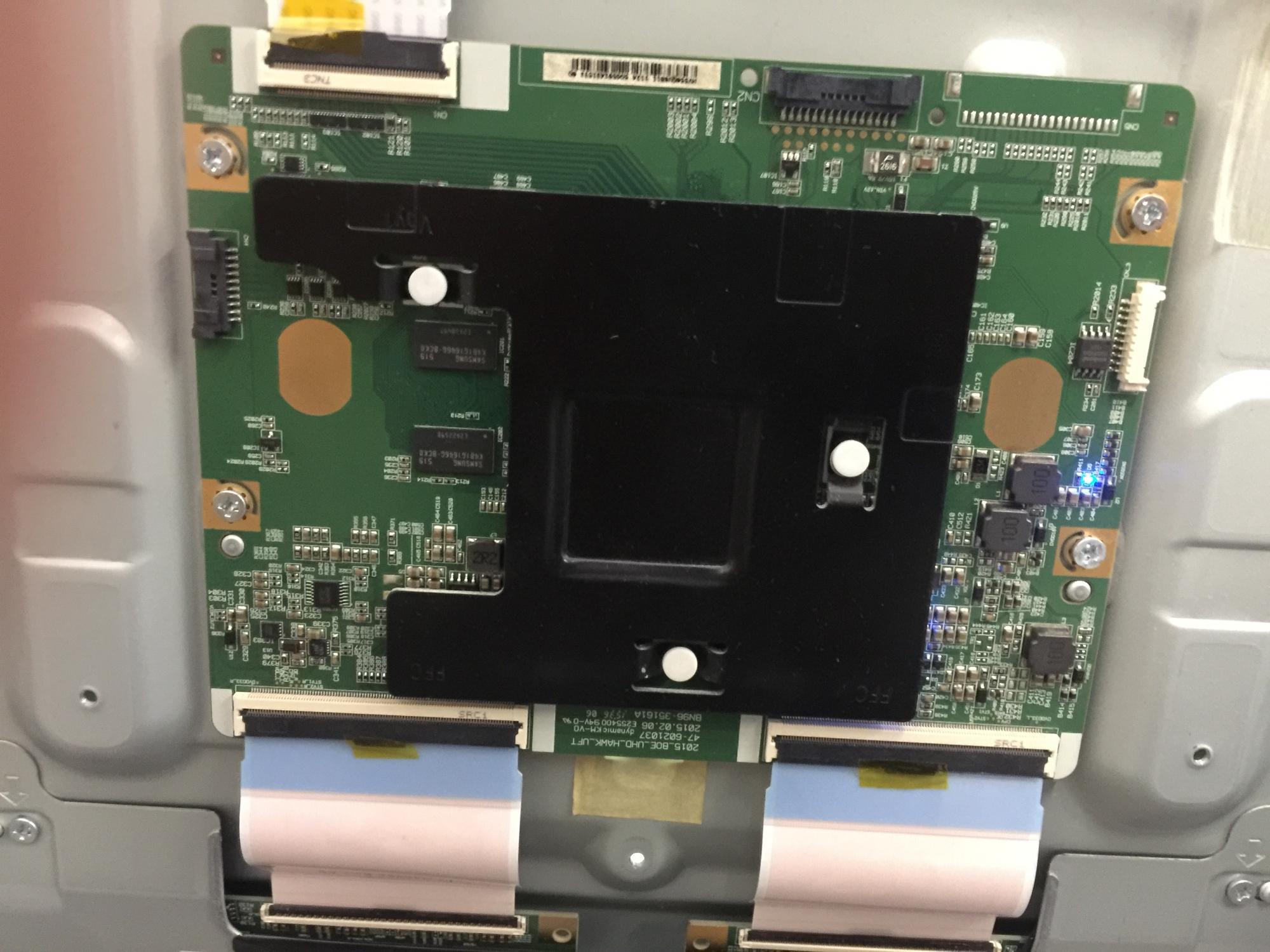

                  Originally posted by budwich
                  gamma chip problem... Maybe.
                  +10
                  from his photos the darkness straight its tell not LED issue

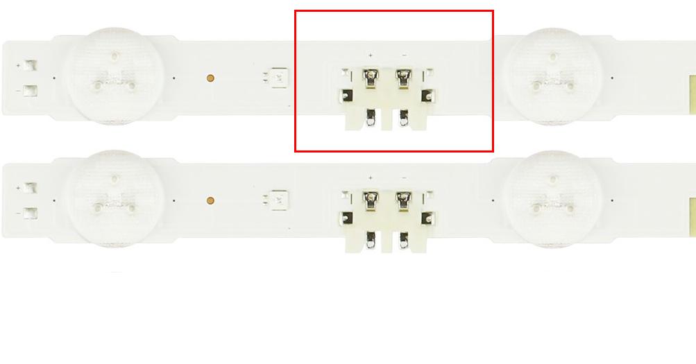

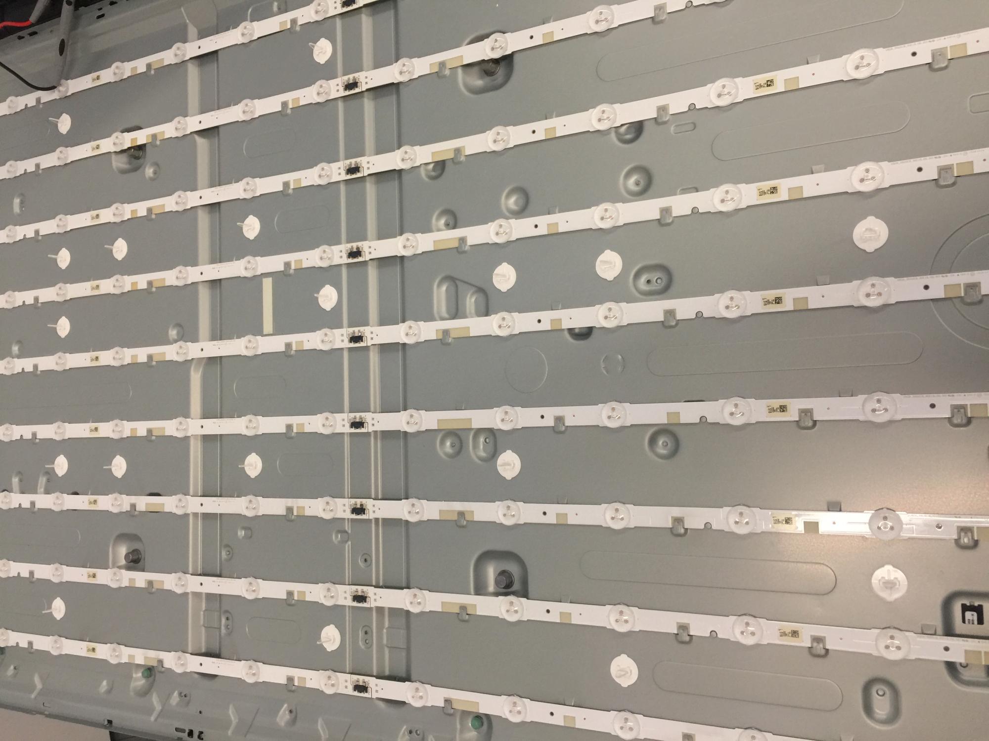

                          There are 18 strips in the panel (according to SJ) There are 2 connected together to form 1 horizontal strip. Each of the 9 strips are connected to 1 vertical connector strip. If one strip is going out it may not trigger an error to shut down the backlight.
                          I could be wrong but I don't see how any other board would cause this fault
                          It looks like one string is 4 strips (168v) and one string is 5 strips (210v)
                          The power supply lists (2D) 227v & 182v for each string
                          It should be easy to check the voltage across the string when it is working and not working

                            It looks like some of the LEDs are shorted out, especially at the top right corner you see dark section compared to the top left corner of the screen.
                            Checking the Voltage on the resistors will give us a clue but it may take another 2 weeks to find out from OP.
                            Most of the time they will arrange the LED strips in alternate rows, I.E. LED ROW 1, 3, and 5 may be driven by LED driver #1, row 2, 4, and 6 may be driven by LED driver #2.
                                Good day
                                i measure dc voltage in 2 resistors , only r9169 has 0,0036 volt ( r 9167 no dc voltage)
                                i measure right this time the cnl802 connector ( from power supply to led bar connection in panel) i have 220 volt in 3 greys (+)
                                i notice 2 led bars up in monitor has low brigthtness
                                  See photo
                                    #37
                                    Originally posted by george_gpu
                                    Good day
                                    1) R9169 is connected in series with LED string #2, R9167 is connected in series with LED string #1, you indicated 0V reading on R9167 which means there is no current flow through LED string #1.
                                    2) You indicated all 3 grey wires (+) have 220V on each one, but if you look at the pin names of the LED connectors, there are only TWO + pins, 1+ (pin 9) and 2+ (pin 1). 1- is pin 13), 2- is pin 5.
                                    So based on your measurement, are you 100% sure that your measurements are correct?
                                    See attached picture.

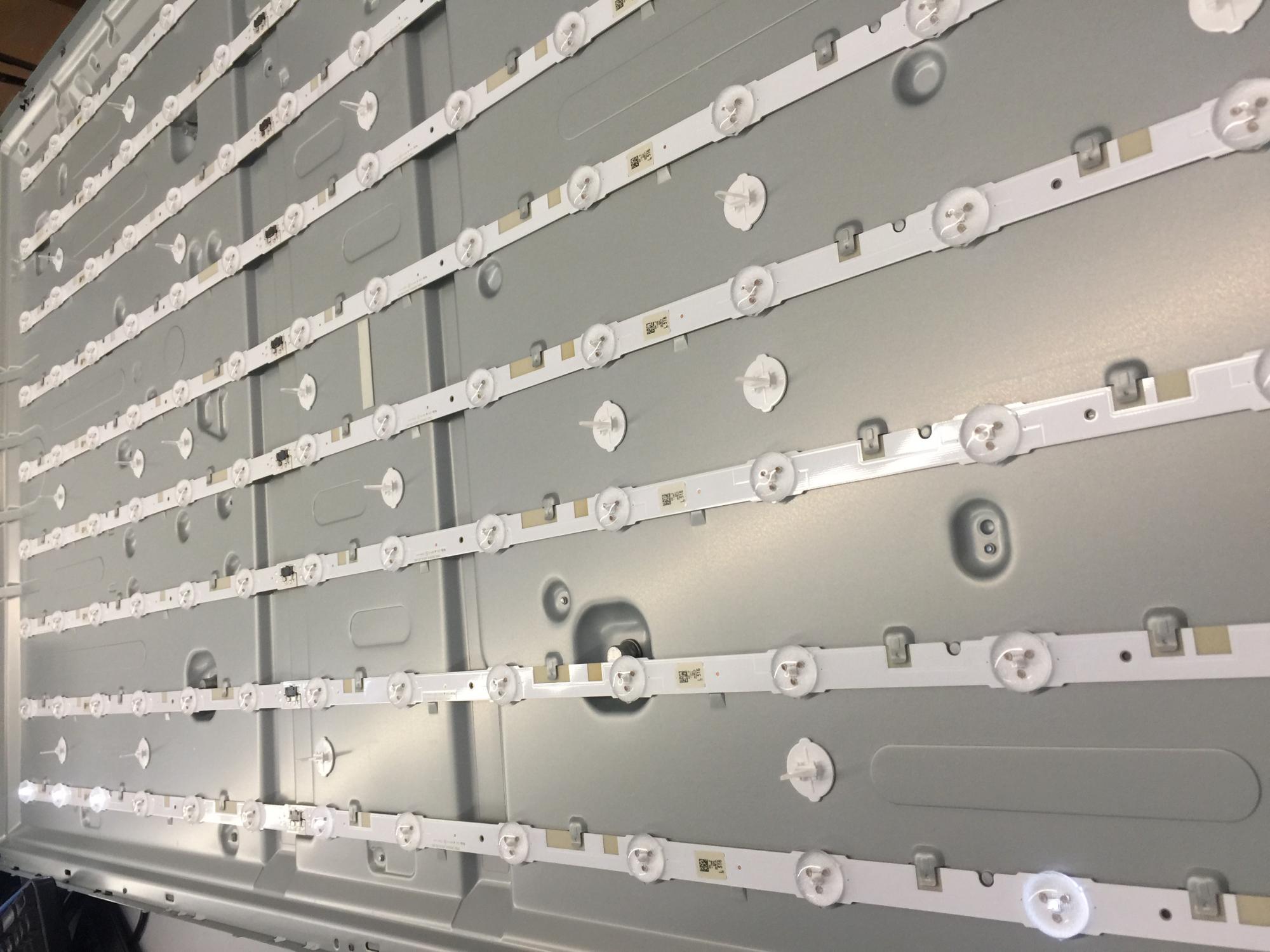

                                      good day
                                      i remove panel
                                      i measure led bars
                                      i have in 3 up bars many fault leds
                                      can you send me the type (is :bn96-38486a) for order

                                        What do you mean "Can you send me the type (is :bn96-38486a) for order"? You cannot buy the set of the replacement LED strips?
                                        BTW, can we see the pictures of the panel showing the LED strips?
                                          I have 40 burn leds
