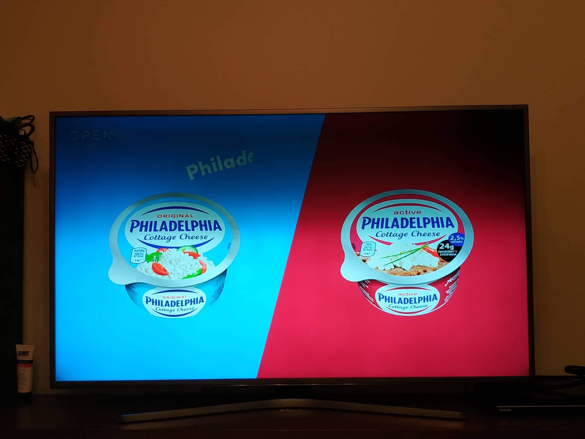

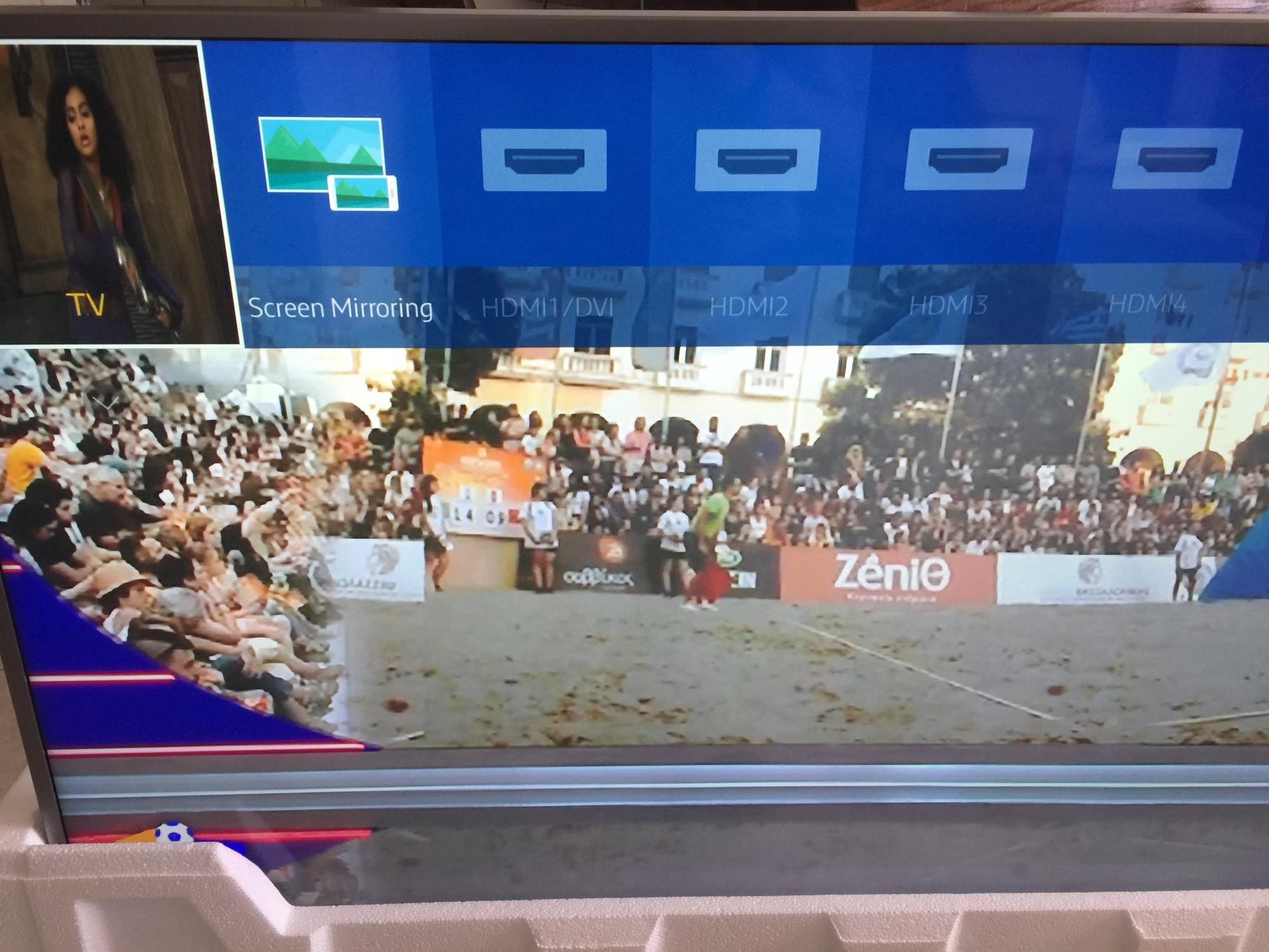

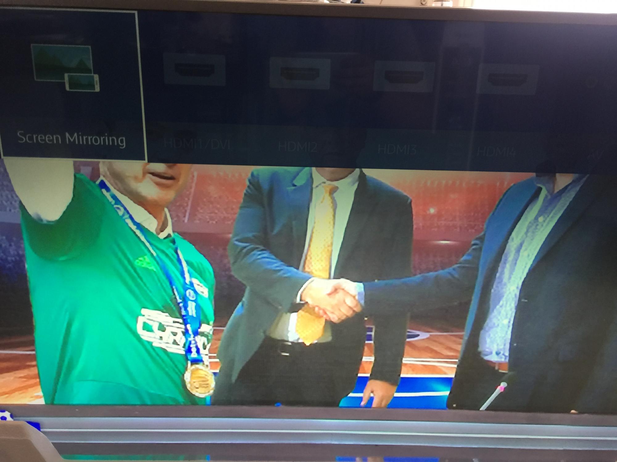

    good day
    It has difference upper , rearmost has 1/4 of the normal brightness
    first photo is with problem ,second is after reflow tcon but last for 5 days only
    https://we.tl/t-iXPSvuEpQP
    It is tcon or panel fault (cof bad ) ?

    Re: samsung ue55ju6800 problem with brightness
    Try uploading pictures here, not dealing with unfamiliar sites.
        gamma chip problem... maybe.

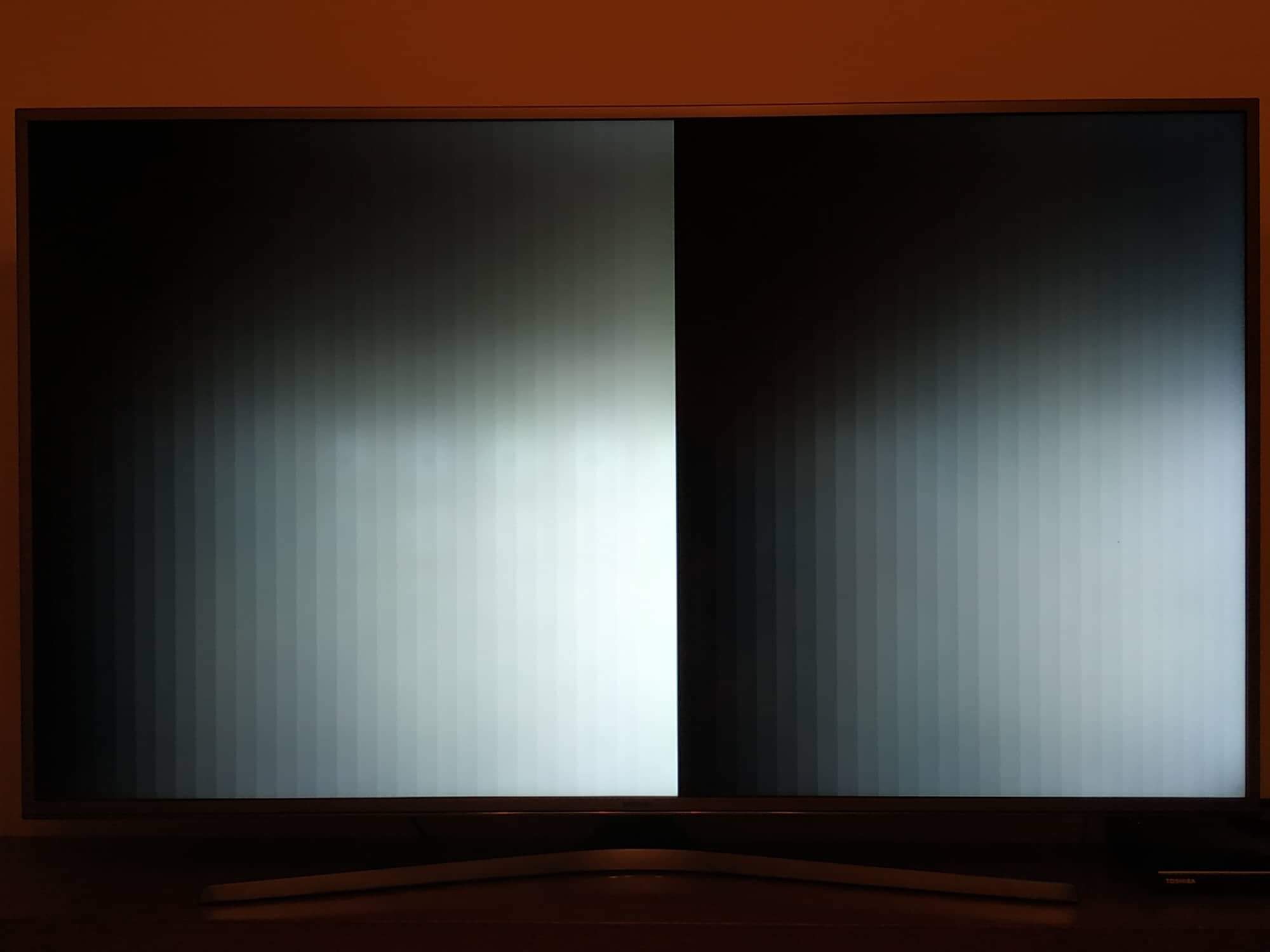

            input a test screen for gamma and you will see what the result is.

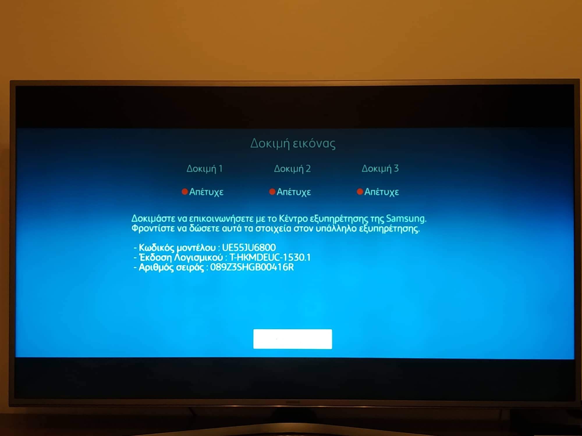

              you mean menu\support\selfdiagnosis\picture test ?
              panel is:55B6AU0TJ
                Good day check after the test
                                        I am still curious also though. If it was a string issue, then supposedly this set is edge lit then how does the test pattern with the gradients light somewhat in the borders at the top but have such a nice "boundary" of "lost brightness " in his first display.... doesn't seem right for a led display issue versus a problem elsewhere.
