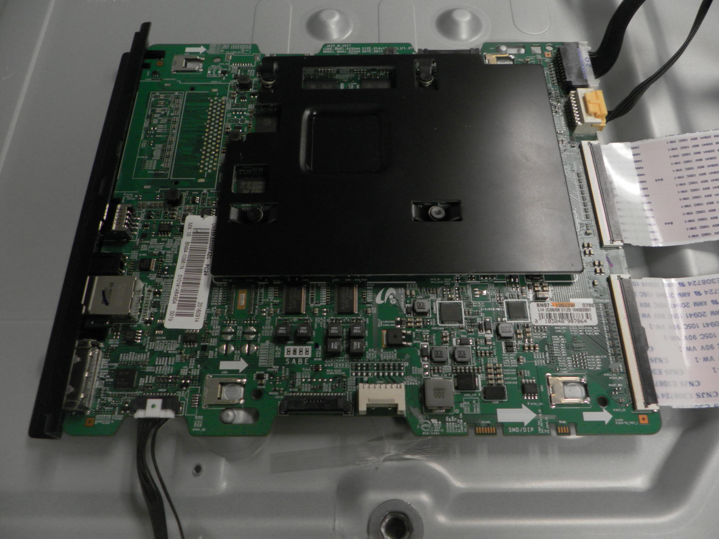

    TV turns on then almost immediately shuts off and does this for as long as it is plugged in. I did remove power to the main board and the tv stays on. I put what I thought was a good replacement main board in and the same problem. I am now wondering if I am dealing with a bad panel.

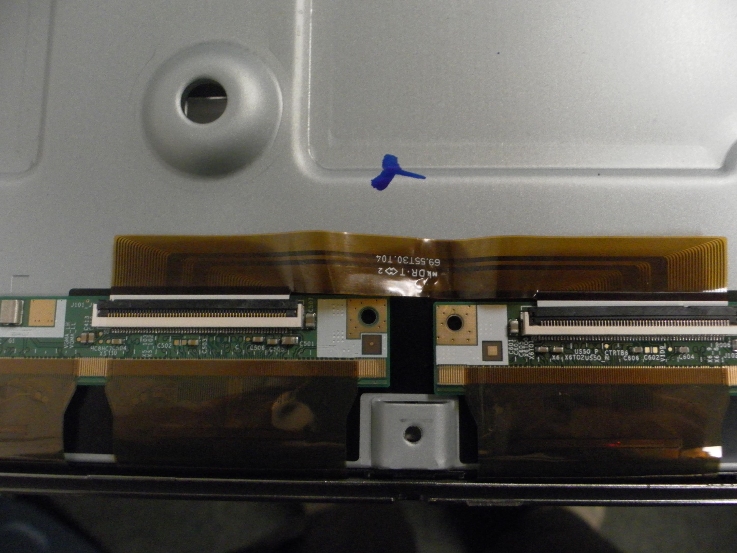

                Re: Samsung UN55KS8000fxza turns on then off repeatedly
                Think I finally found the problem. I took nomoresonys advice and checked the driver board and found one of the flat ribbon cables that is between the right side driver boards was crimped. If I remove it the picture no longer flashes and if I put it back but not quite in straight I get a scrambled picture. Now I just need to find a undamaged flat ribbon cable to test my theory

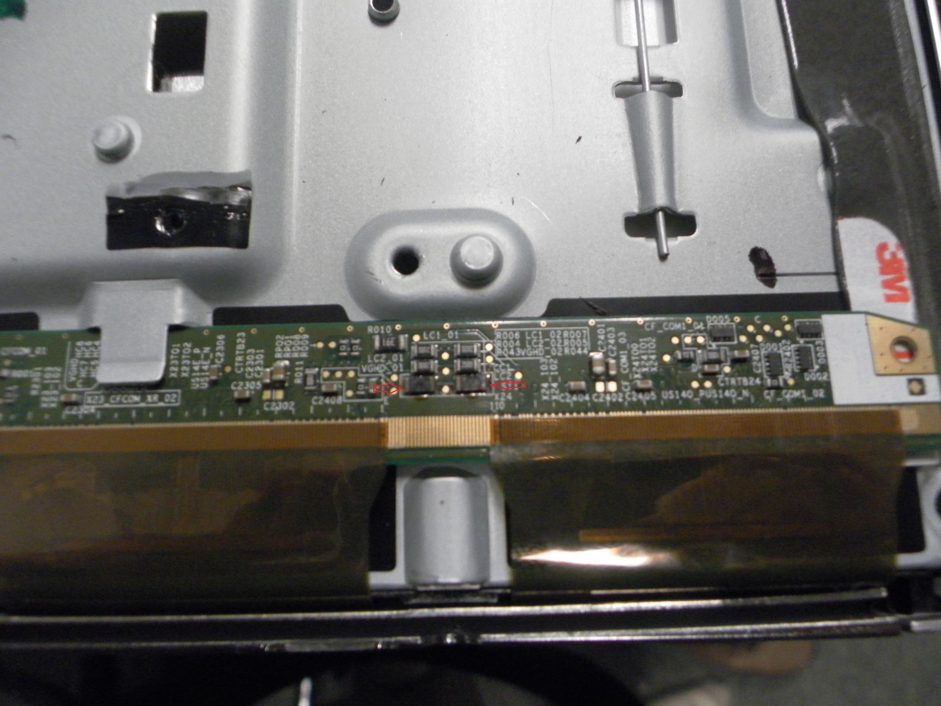

                  Spoke too soon. I found what looks like two burnt resistors on the far right board. Any know how I can find replacements?

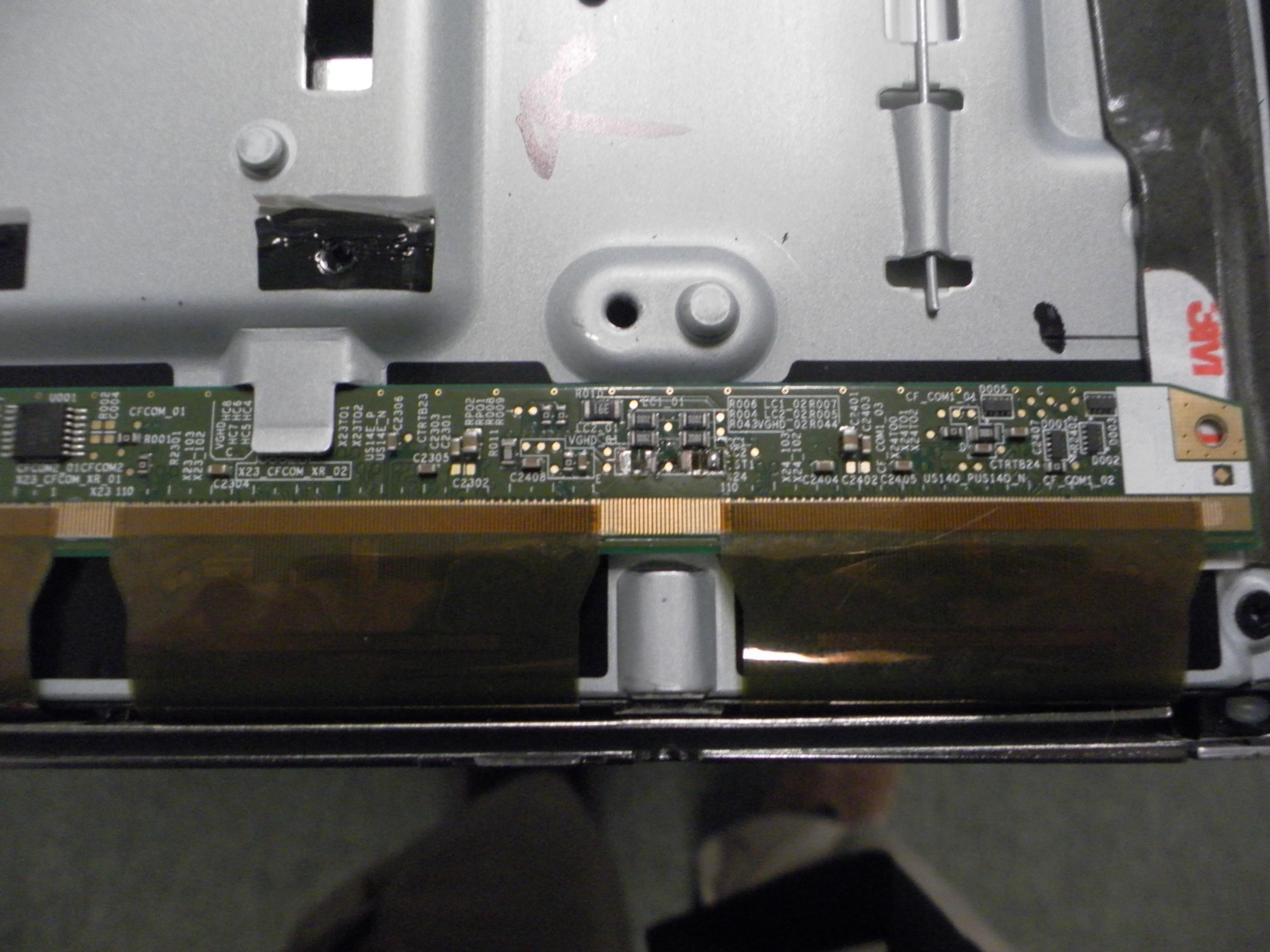

                    Check the far left board as they are usually symmetrical. The values are written on them.
                      I did and it is not configured the exact same way so I found 4 resistors on it but different values.
                        Update to this problem in hopes it will help someone else. Removed the two bad resistors on the far right (looking at the back) driver board (again thanks to nomoresonys) and now the tv works fine.
