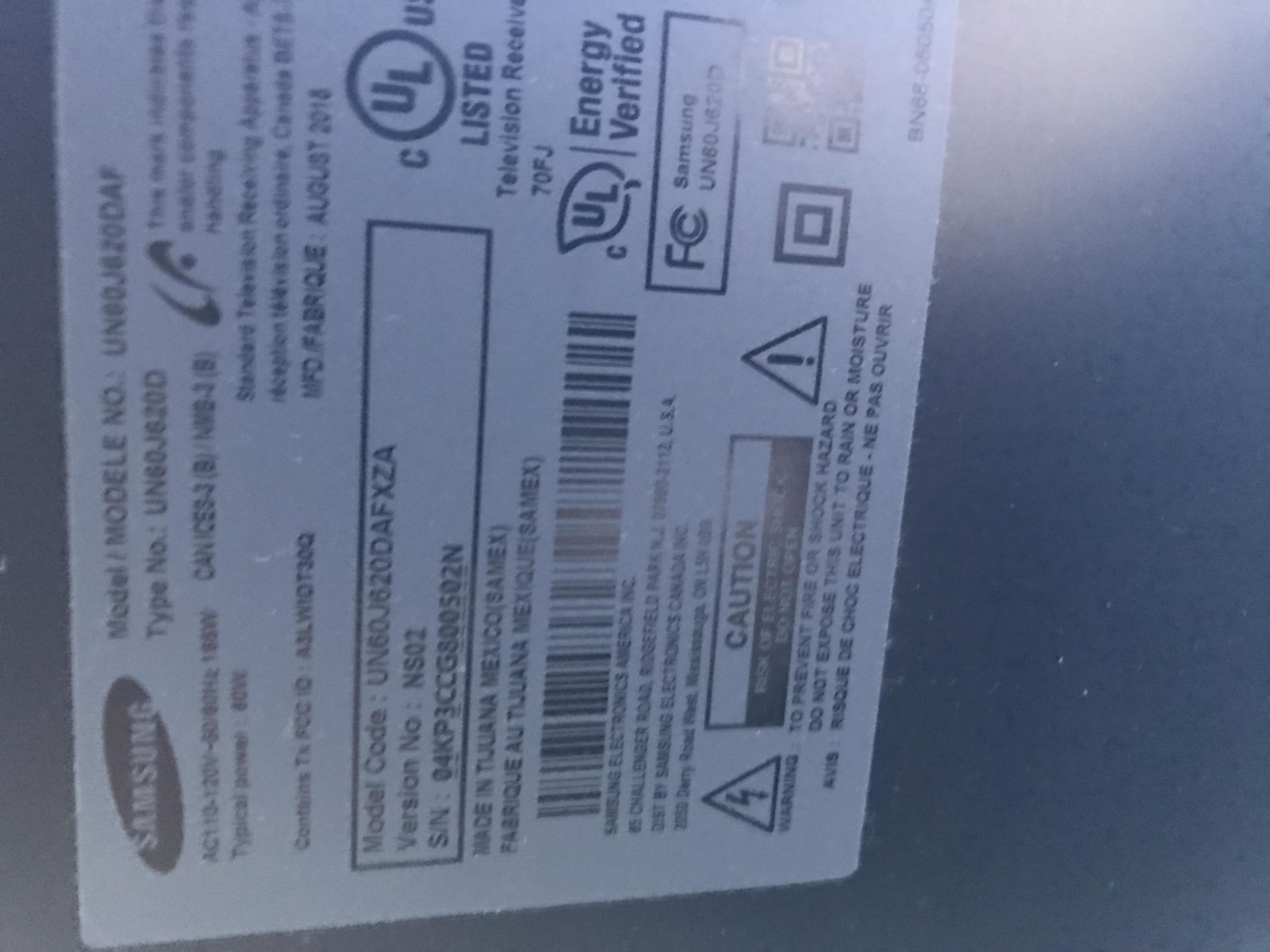

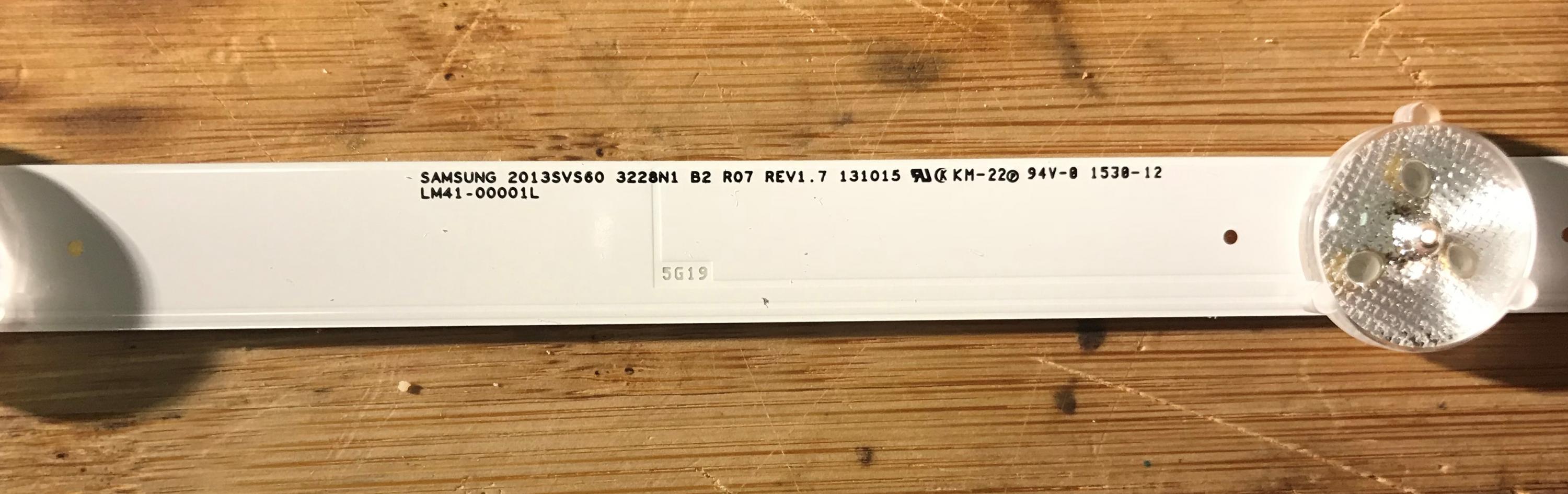

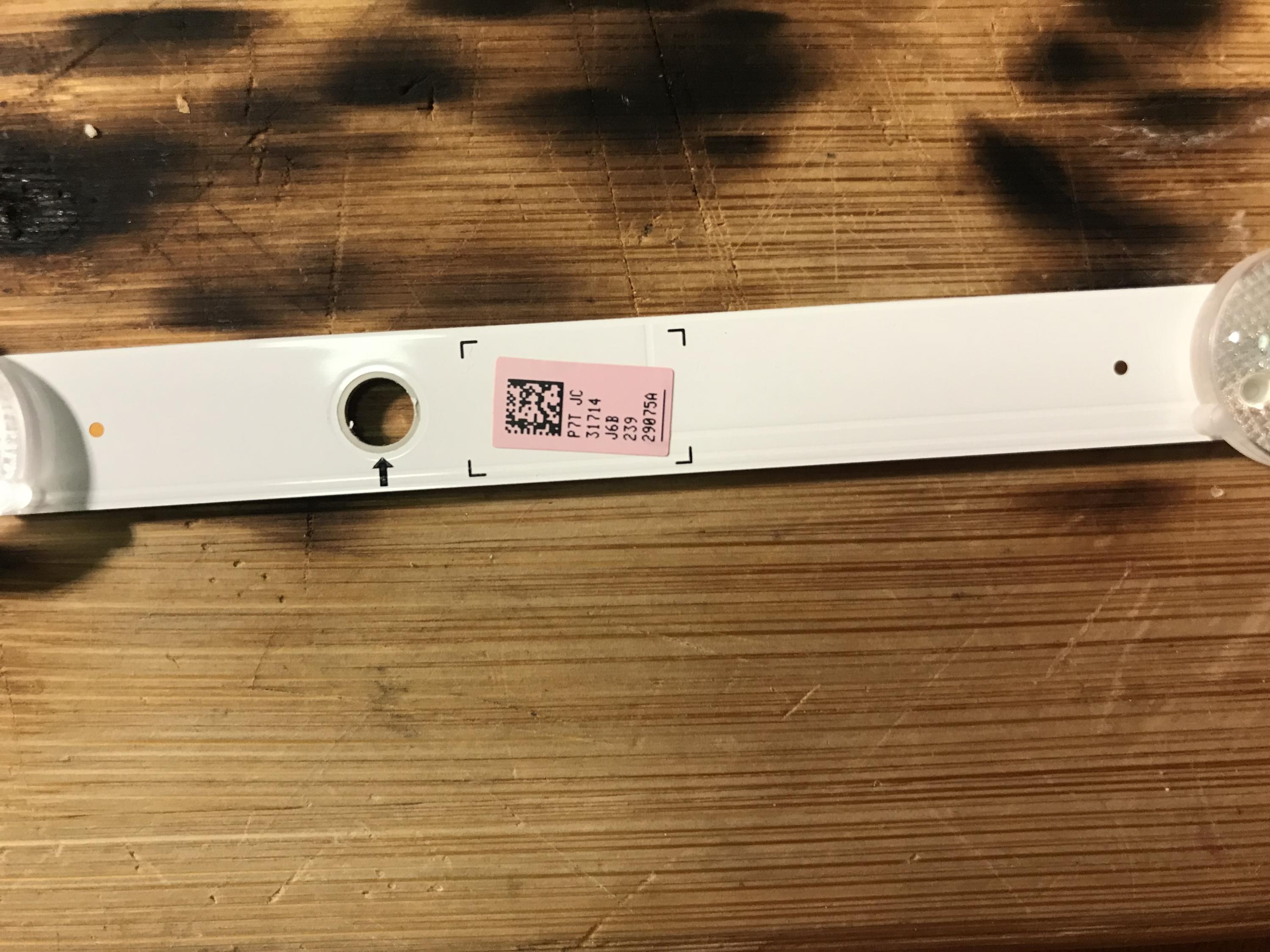

samsung un60j620dafxza backlight led smd diode
  • ca2014mp2
    • May 2016
    • 48
    • usa
    samsung un60j620dafxza backlight led smd diode
    I have a samsung un60j620dafxza with a many dead leds' for the backlight. What is the proper replacement for this tv. I'm looking to put them on myself, just need the right part to buy. I do have all the equipment to put on the smd's.
  • Wilderone
    • May 2018
    • 76
    Re: samsung un60j620dafxza backlight led smd diode
    I haven't yet found a way to know precisely what LED's are without stripping the TV down.
    When you find out let me know.
    Best to buy an assortment kit off AliExpress vendor.
    • neilc6
      • Nov 2015
      • 1550
      Re: samsung un60j620dafxza backlight led smd diode
      Samsungs, unlike LGs, dont have a protection mode which shut down the backlights . I typically find 50 to 90% of leds bad and will do a full strip replacement. Repairing individual LEDs is a lot of work and the remaining ones are likely to fail. Shopjimmy can give you a clue what strips are in your tv if you search the full model number.
      • ca2014mp2
        • May 2016
        • 48
        • usa
        Re: samsung un60j620dafxza backlight led smd diode
        Yeah going new is 100 and only 10 bucks for loose smd. I have the right equipment for the job again just need to know what kind to get. The old ones that still work uses 770 mA at 30 volts so 23w or 4.3dc at 100mA at .43 Watts each with 7 each on a stick. So should I get 6v at 1 watt or what is best? Maybe 2 watt since they seem to blow more and just throttle them back to last longer? Idk that’s why I’m asking!
        • ca2014mp2
          • May 2016
          • 48
          • usa
          Re: samsung un60j620dafxza backlight led smd diode
          I’m leaning toward 3030 led but that’s me dumbly guessing . I know that’s never good so I’m asking the board!!
          • neilc6
            • Nov 2015
            • 1550
            Re: samsung un60j620dafxza backlight led smd diode
            The other issue is that the lenses have to sit perfectly both centered and height. Slightly off will create bright spots. A couple may not be too noticeable but if all the LEDs are off it's going to look terrible.
            • nomoresonys
              • Jan 2013
              • 12306
              • U.S.
              Re: samsung un60j620dafxza backlight led smd diode
              Here's an ad with close up of the numbers on the strips, maybe someone can figure out what they are by that: https://www.ebay.com/itm/Samsung-BN9...0AAOSw8oxaw~Ql
              • SLK001
                • May 2014
                • 264
                Re: samsung un60j620dafxza backlight led smd diode
                Where are your pictures? Without pictures, all WE are doing is "dumbly guessing". How did you get the voltages? I would suspect that the LEDs are around 3V devices. If they are being driven to 4.3V, that explains why you have so many failures. Is the large pad the CATHODE or ANODE? What is the size of the device?
                It is incorrect to assume that Samsung only uses one kind of diode or another. Each set has to be evaluated as to the "flavor of the day" LED wise. Mostly, they used 3V one watt devices. Unless you plan on redesigning the strip PCB, you'll have to stick with what they originally used.
                • ca2014mp2
                  • May 2016
                  • 48
                  • usa
                  Re: samsung un60j620dafxza backlight led smd diode
                  Originally posted by neilc6
                  The other issue is that the lenses have to sit perfectly both centered and height. Slightly off will create bright spots. A couple may not be too noticeable but if all the LEDs are off it's going to look terrible.
                  Yes, I already anticipated that and have worked out the details. Ok so I know it will be hard and I thank you for your suggestion but I want to attempt it. I did take a laser measurements and found 43 thousands height over the led to the lens. I then made a shim that sits on top of the let as the lens is placed. after it sets with optically clear super glue I remove the shim and it's good. My testing shows variance but no different then what the stock lens are showing from OEM production. I'm confident this will not be an issue.
                  I just need the data on the best to get.
                  • ca2014mp2
                    • May 2016
                    • 48
                    • usa
                    Re: samsung un60j620dafxza backlight led smd diode
                    Here's an ad with close up of the numbers on the strips, maybe someone can figure out what they are by that: https://www.ebay.com/itm/Samsung-BN9...0AAOSw8oxaw~Ql
                    @nomoresonys - thanks for the link and the help. This link provided a clue as to the chips by following the part numbers around. Still haven't found anything yet, but every little bit helps.
                    Thanks and if you can think of anything else that would be helpful please pass it along.
                    • ca2014mp2
                      • May 2016
                      • 48
                      • usa
                      Re: samsung un60j620dafxza backlight led smd diode
                      Originally posted by SLK001
                      Where are your pictures? Without pictures, all WE are doing is "dumbly guessing". How did you get the voltages? I would suspect that the LEDs are around 3V devices. If they are being driven to 4.3V, that explains why you have so many failures. Is the large pad the CATHODE or ANODE? What is the size of the device?
                      It is incorrect to assume that Samsung only uses one kind of diode or another. Each set has to be evaluated as to the "flavor of the day" LED wise. Mostly, they used 3V one watt devices. Unless you plan on redesigning the strip PCB, you'll have to stick with what they originally used.
                      @SLK001 -Yeah, I don't share your concern on what a picture will do but I took some anyway. I trust the picture of the diode will give you more information as to what it is. You know they don't have any numbers on them, as these don't either. As for "flavor of the day", I would also have to disagree as temperature size and ratings all play into it. As I will assume that you mean any led that is sourced from procurement, that I would agree with but they need to follow specifications and it's those specs that I'm looking for. Lastly, umm no I don't plan on redesigning the strip pcb.. umm yeah that idea is not helpful. You see I'm just trying to get an idea of the right LED to get.
                      Last edited by ca2014mp2; 06-17-2019, 12:42 AM.
                      • neilc6
                        • Nov 2015
                        • 1550
                        Re: samsung un60j620dafxza backlight led smd diode
                        https://www.aliexpress.com/item/100P...967087145.html
                        • jkb242
                          • Mar 2012
                          • 175
                          Re: samsung un60j620dafxza backlight led smd diode
                          Originally posted by ca2014mp2
                          Yeah going new is 100 and only 10 bucks for loose smd. I have the right equipment for the job again just need to know what kind to get. The old ones that still work uses 770 mA at 30 volts so 23w or 4.3dc at 100mA at .43 Watts each with 7 each on a stick. So should I get 6v at 1 watt or what is best? Maybe 2 watt since they seem to blow more and just throttle them back to last longer? Idk that's why I'm asking!
                          I don't believe 3v/6v replacement LEDs for any strips being repaired is an option. It depends on the LED driver potential for the strips. You must replace with the same voltage LEDs. 30v?? 770ma? These are generally in series, so in that case the current is the same through each LED through the entire array.
                          • jkb242
                            • Mar 2012
                            • 175
                            Re: samsung un60j620dafxza backlight led smd diode
                            Just to comment on this subject i full agree replacement of all the strips is the fastest and easiest. For those who are familiar with SMD component soldering and choosing to replace the defective LEDs, hot air works great and it’s just a few seconds to remove the bad ones and another minute or so to reflow the replacement. Without familiarity of using hot air, however, there is no other solution unless one want to purchase a hot plate, cost more than the entire replacement areas of LEDs
                              09-07-2024, 05:50 AM
                            • C152Heavy
                              Samsung LN46C630K1F – Intermittent Backlight, BN44-00341B Power Board
                              by C152Heavy
                              Samsung LN46C630K1F – Intermittent Backlight, BN44-00341B Power Board
                              Summary for TL-DR readers:
                              • Backlight is intermittent, may come on with TV boot or not. No flickering, never fails during TV on.
                              • Have obtained Samsung schematic & service documents - Can upload if helpful.
                              • Have read ALL applicable threads
                              • C1818 and CP820 replaced as low hanging fruit
                              • CN802 data taken for normal and failed BL operation. SUMMARY: Pin 2 - 5vDet = 3.52 @normal, 0.0 @BL fail. Pin 6 - EPWM = 1.631 @normal, 1.058 @BL fail.
                              • VCC pin (18) of PFC...
                              01-11-2023, 02:53 PM
                            • ohren
                              Samsung ue55nu7096u - no backlight - faulty LEDs?
                              by ohren
                              I'm looking at a Samsung model ue55nu7096u that I've only ever seen in a non-working condition, i.e. I don't know if the failure was progressive or instant.
                              Symptoms
                              No backlight at all — LCD and logic board are working normally. Resetting all settings and installing system updates has no effect.
                              I tried reseating the connectors between PS and logic board, and PS and panel. No difference there.
                              I could not find a service manual.
                              Measurements when powered on
                              Bulk cap: 388 V. Stable....
                              04-04-2022, 02:58 PM
                            • sansanpartida
                              Samsung QE82Q70RAT no backlight
                              by sansanpartida
                              Hi everyone!
                              Hope you're all having a great day, and thank you very much for stopping by and taking the time to read this post to help me with my parents' Samsung TV.
                              My issue: No backlight.
                              Model: QE82Q70RAT
                              Type No: QE82Q70RAT
                              The TV was already serviced by Samsung once under warranty for the exact same issue, but six months after the fix, the backlight went out again. Now, Samsung is asking for nearly the same price as a brand new TV to fix this with the same 6-month guarantee.
                              So hopefully, I can fix this cheaper.
                              05-22-2024, 06:56 AM
                            • howardc64
                              Samsung QN75Q6FNA backlight no display, red LED blink 2x, fault in panel
                              by howardc64
                              • Prior owner tried a replacement main board. No difference.
                              • Samsung 2x red blinking standby LED = panel fault
                              • Jumpered FB_TRDY_1 (pin 1 CN1300 left. main tcon->left side buffer boards) and FB_TRDY_3 (pin 95 CN1301 right. main tcon->right side buffer boards) This allows testing individual T-Con (on main board) connection to panel on this Samsung. Found fault on left side (viewing from rear of TV)
                              • Each side has 2 buffer boards, disconnected left side flex between 2 buffer boards. Fault is on the left most board.
                              • Tape masking eventually isolated to CN1300 pin 15 (CKV4_GOA) Display
                              07-19-2025, 10:54 PM
