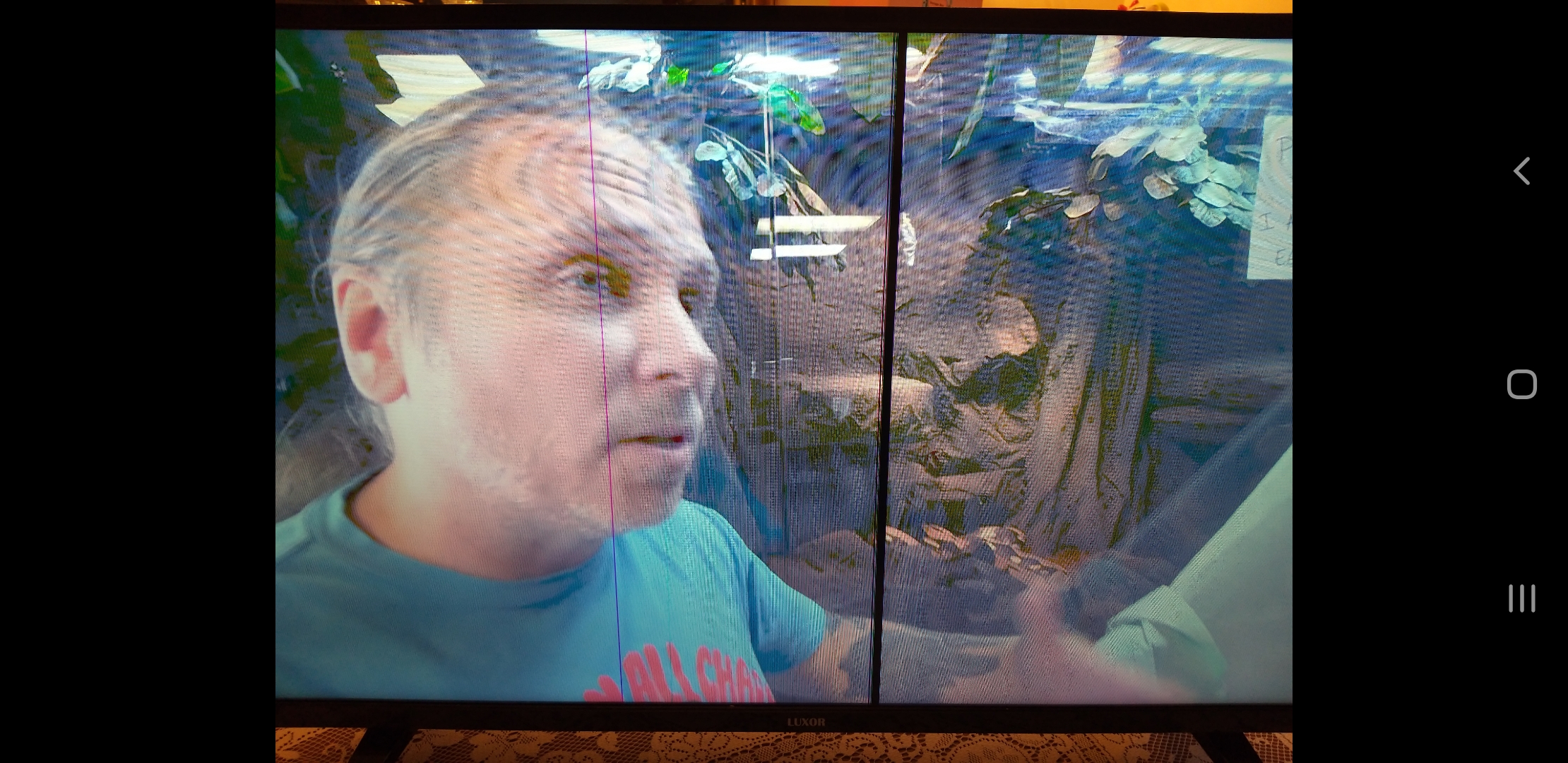

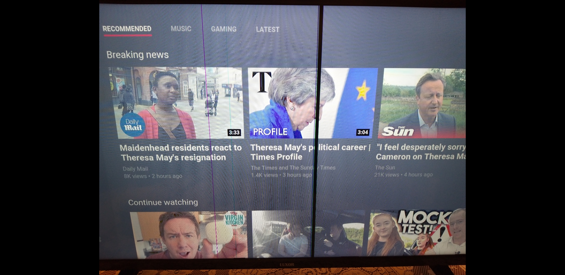

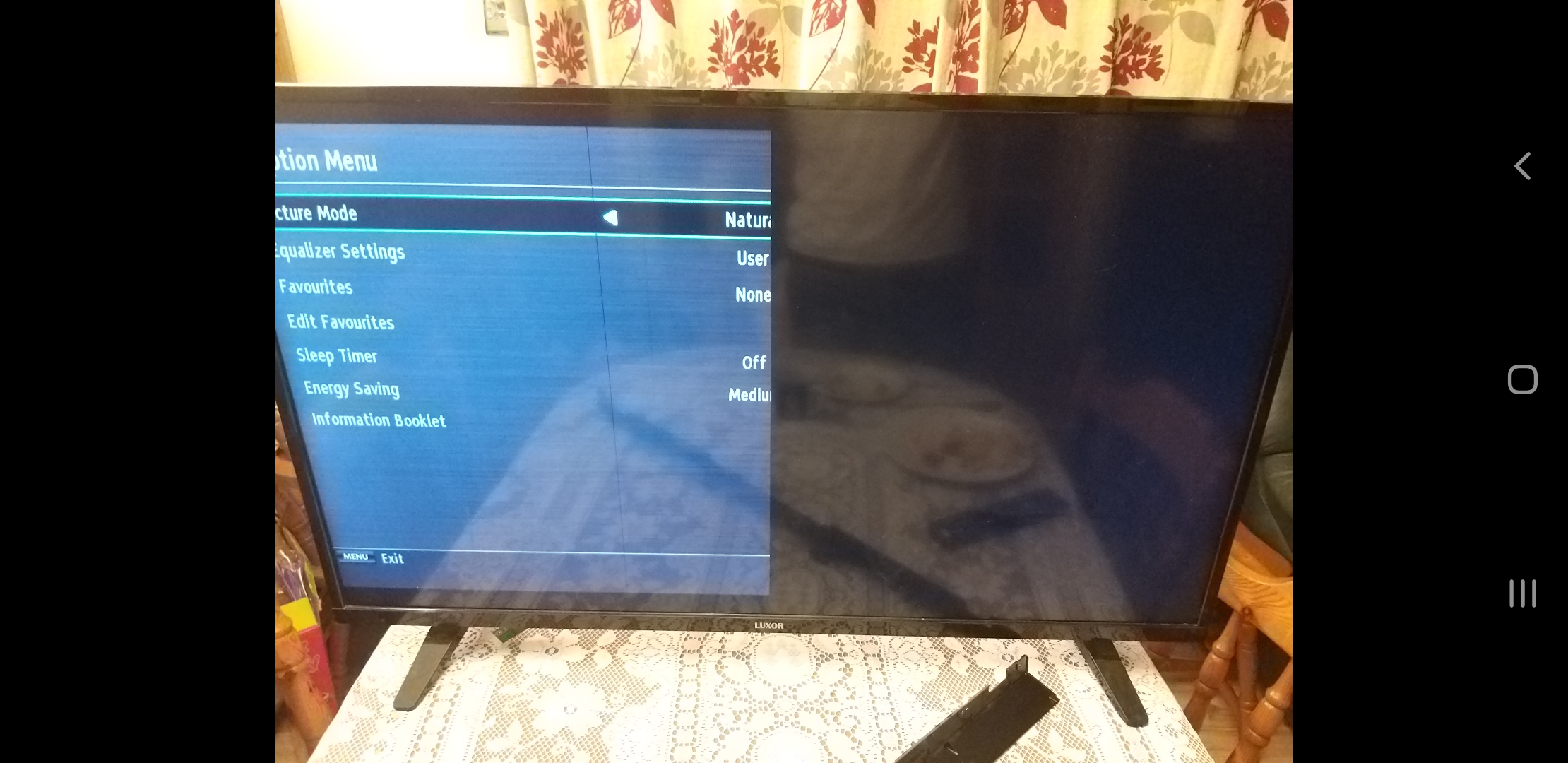

Luxor Lux0143002/01 tab bond issue?
  • notallbad
    • Oct 2012
    • 1190
    Tab bond?

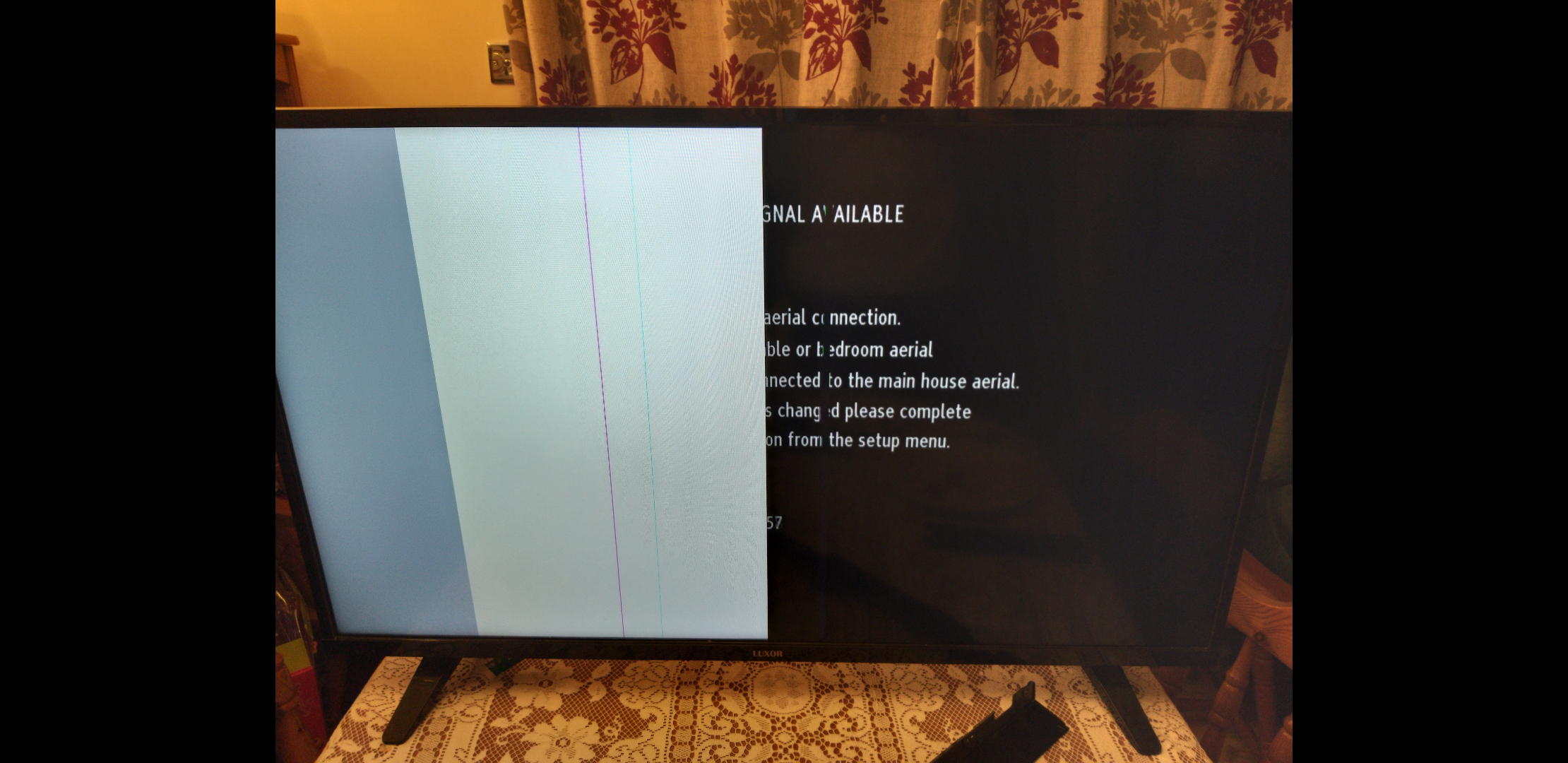

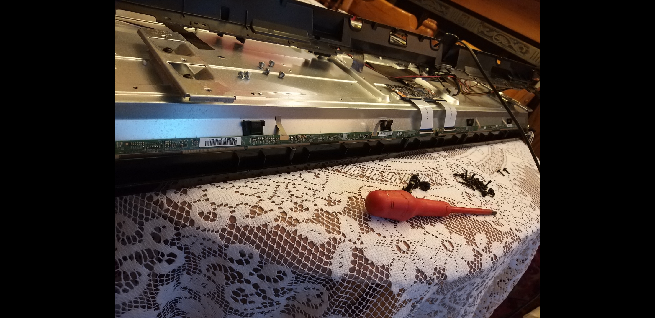

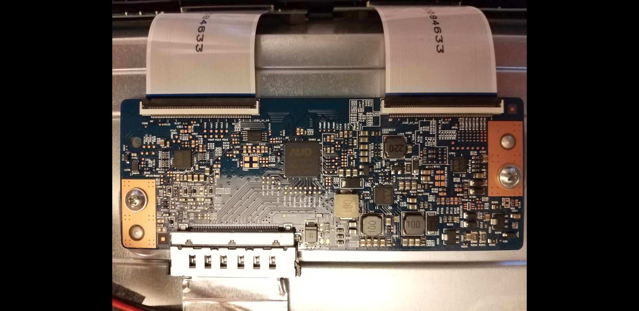

    Last 2 photos showing results of having t-con ribbon cables removed one at a time.
      Re: Luxor Lux0143002/01 tab bond issue?
      You have panel problem, inspect the tab bonding board around where the solid color lines are.

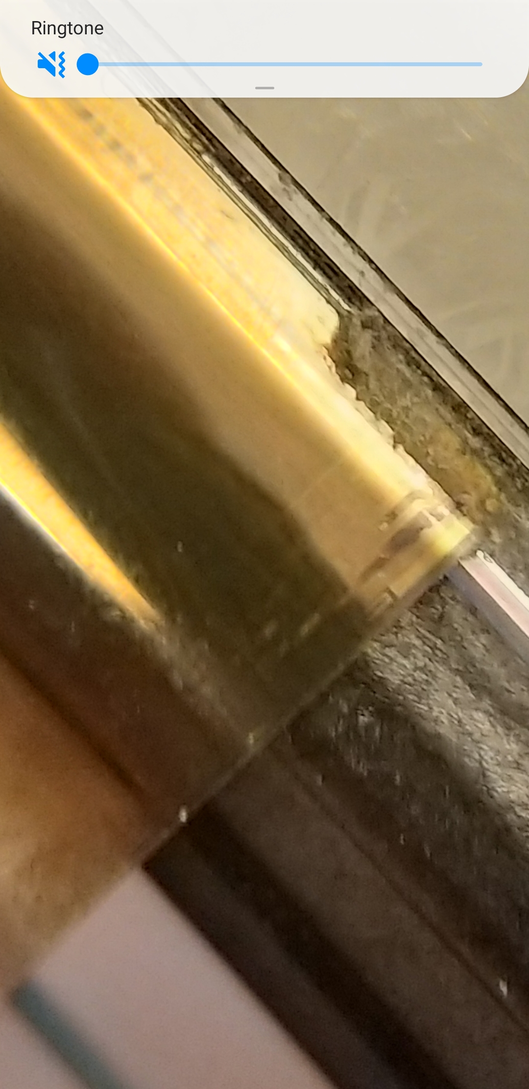

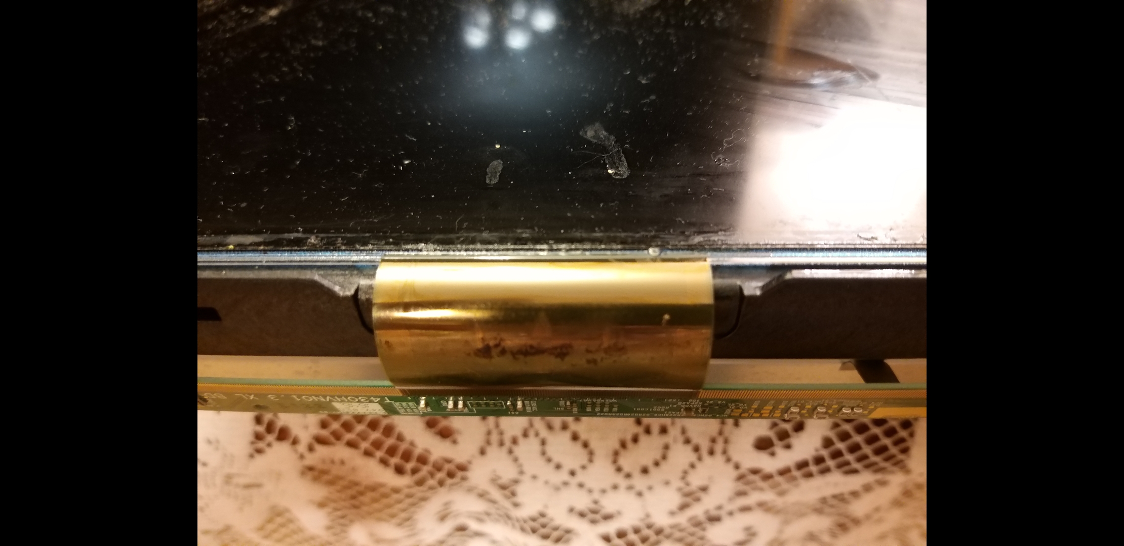

        brown sticky goo on some of the tabs

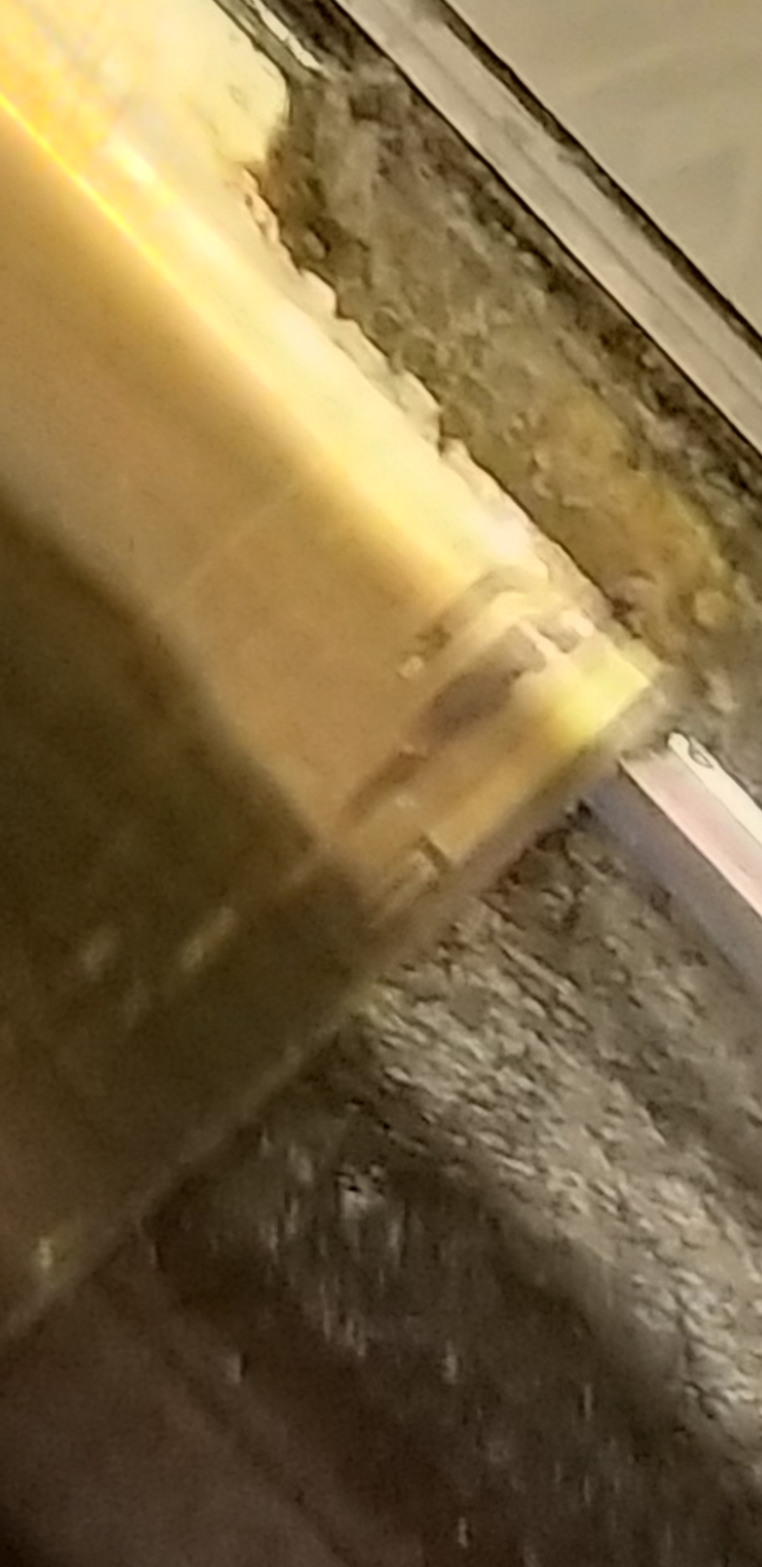

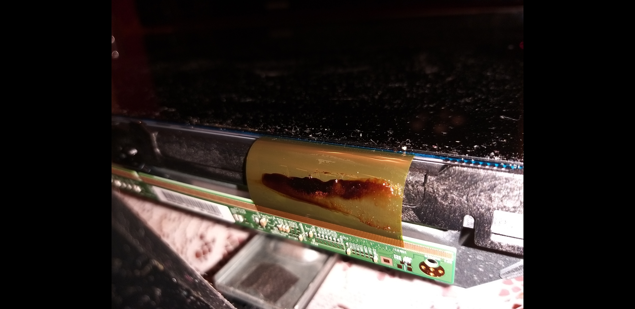

          On closer inspection it looks like burnt tracks on tabs at panel side

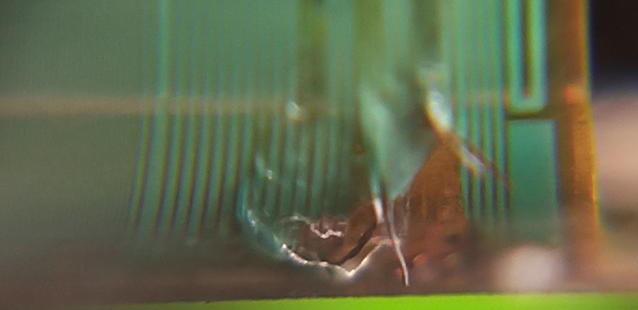

            Tracks damaged at the panel on the underside, think the picture speaks for itself!
