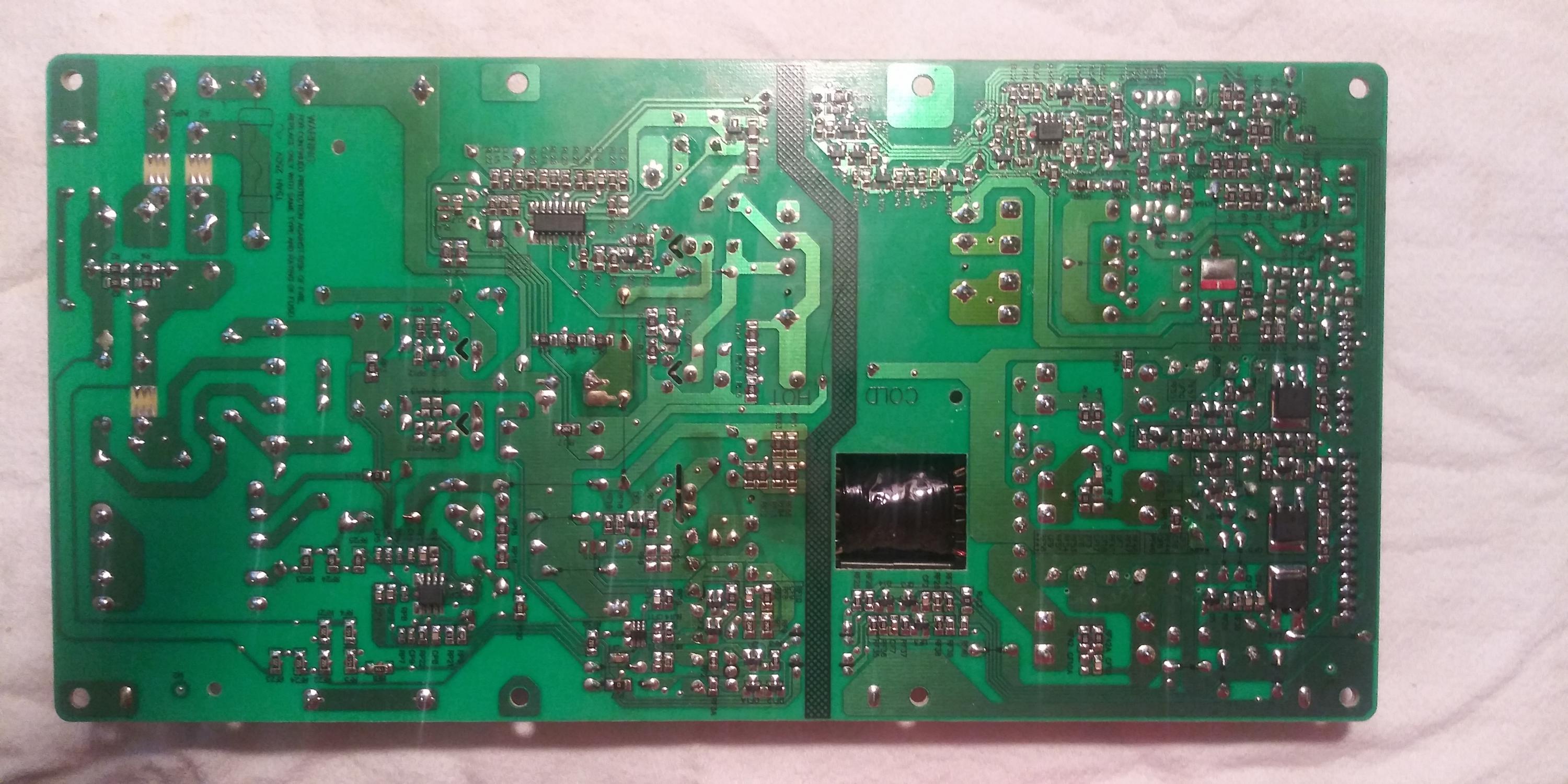

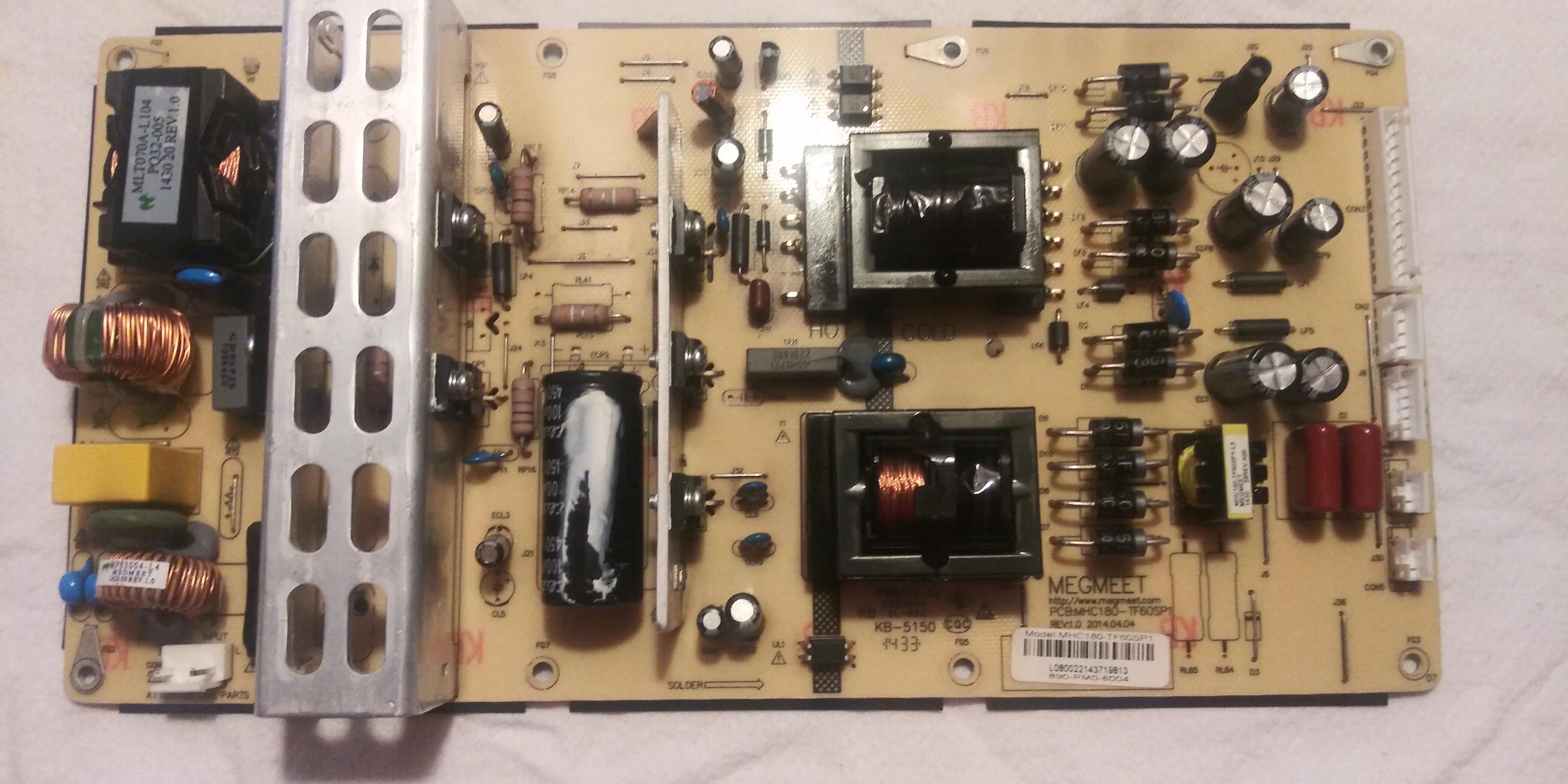

            Pictures of the power supply trace side

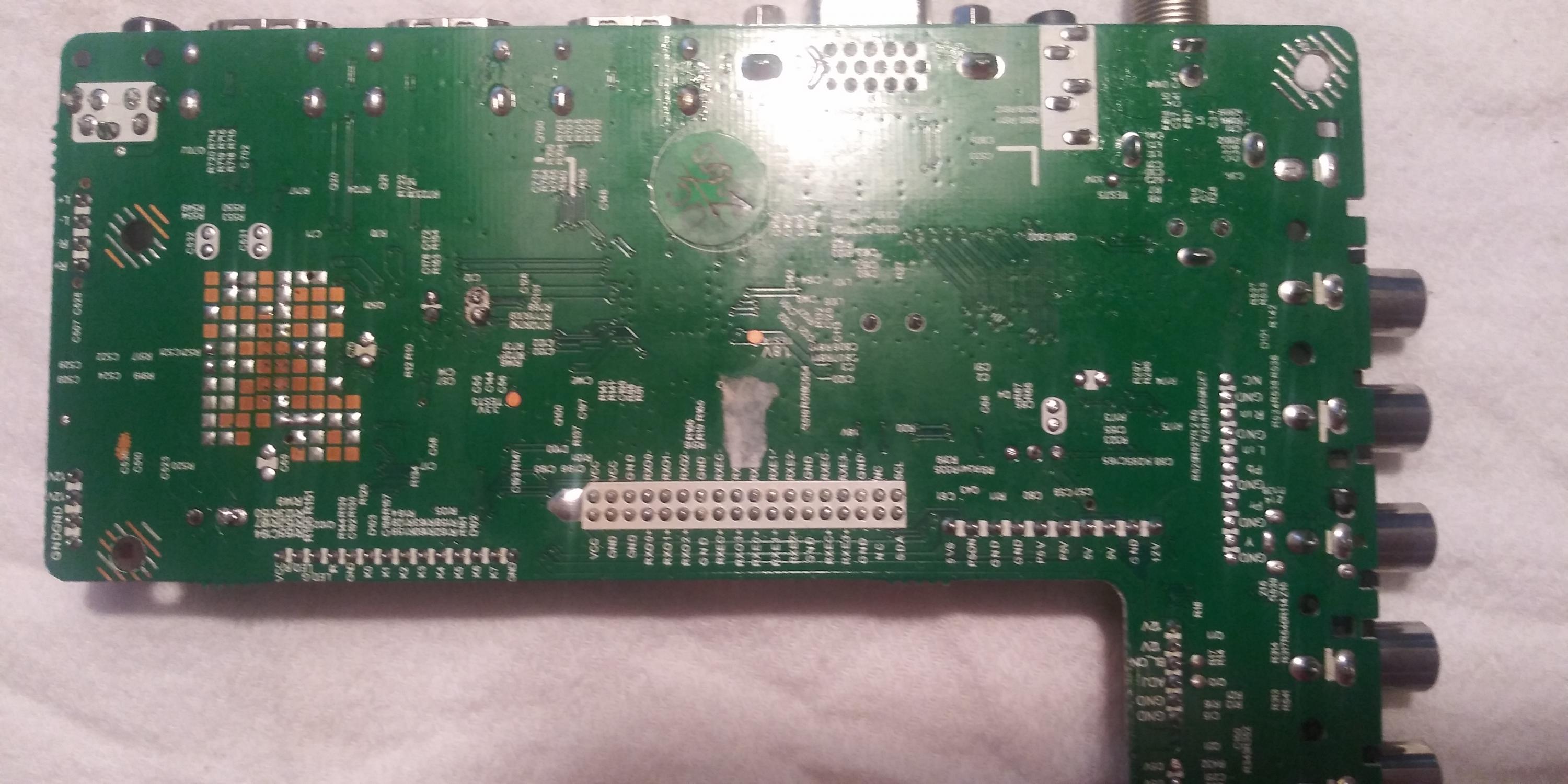

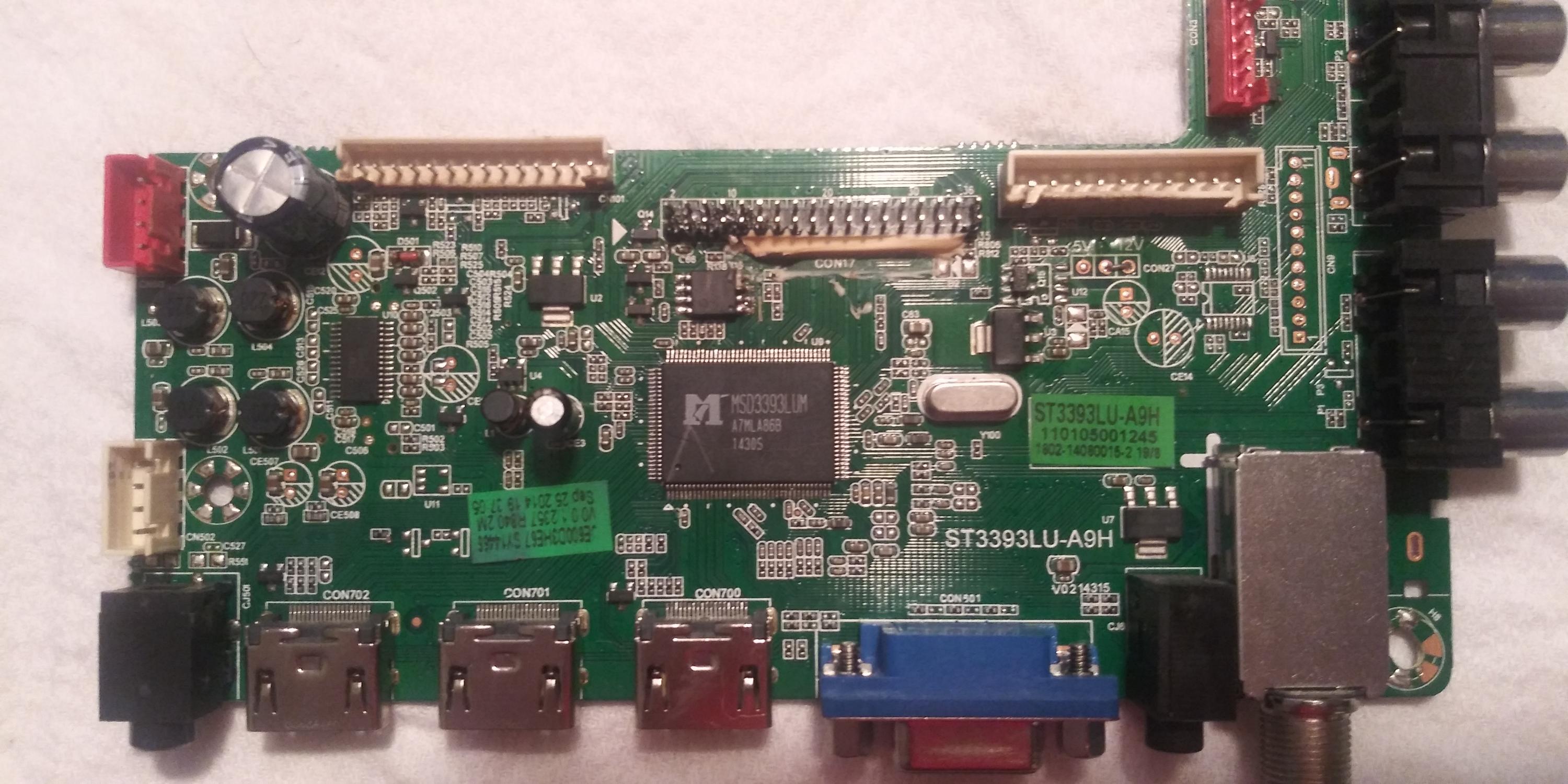

              I included the important parts of the main also

                I tried to trace the 5vsb pin back but I can't make out the traces.
                If you disconnect the main board from the power supply the 5vsb reads 5 volts correct?

                    Too bad the bottom side picture of the power supply board to too blur.

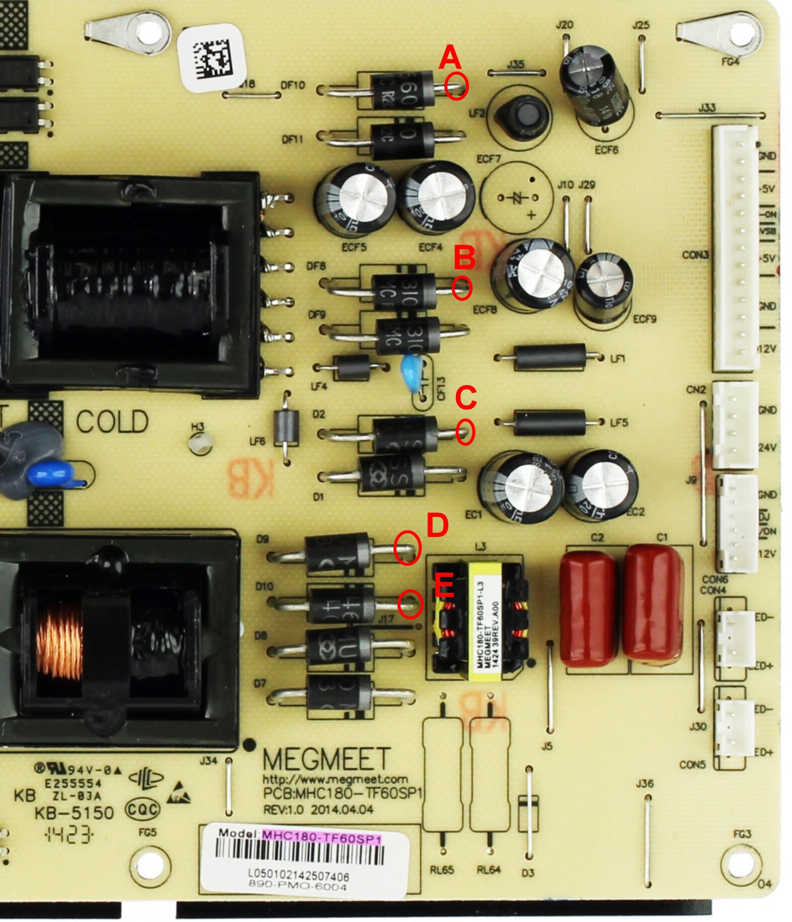

                    So please connect everything back up and check the Voltages on test points A ~ E against cold side circuit ground.
                    BTW, please also report the Voltage on the PS-ON pin (CN3 pin 5) again.

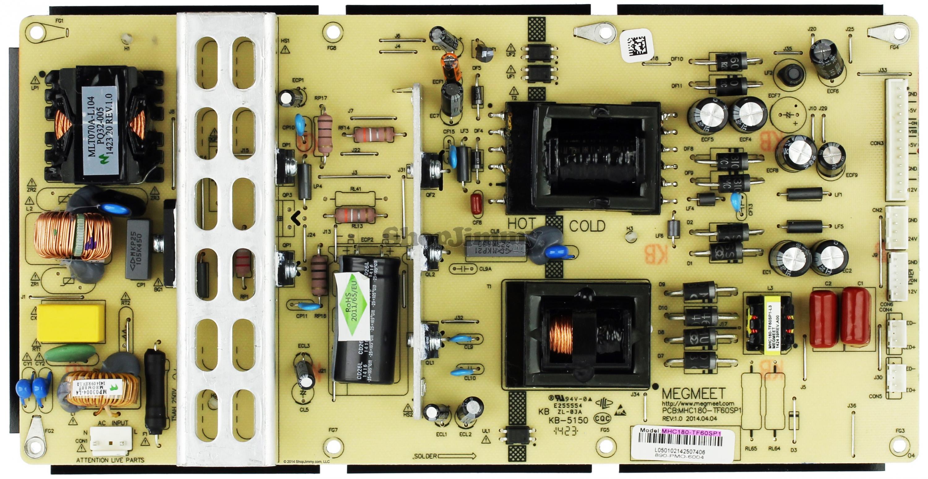

                    Pictures provided by shojimmy.
                    Element MHC180-TF60SP1 Power Supply / LED Driver Board ELEFW605

                      A: 5.20
                      B: 12.48
                      C: 24.24
                      D: .10 (And fluctuating)
                      E .5 (And fluctuating)
                      PS_ON: 4v's

                        A: 5.20
                        B: 12.48
                        C: 24.24
                        PS_ON: 4v's
                        They are what I expected.
                        OK, now check the Voltage on CN3 pin 6 (+5VSB) and tell me what you get.
                        Then disconnect AC from the TV then check the resistance between point A and CN 3 pin 6 (+5VSB).
                          Yeah im realizing now i must have been one off on the pinout like you were saying. Thats 100% my bad :/
                          the 5vsb is 5.20
                          the resistances between 5vsb and pin A is .01
                            #53
                            Re: Element elefw605 power issue maybe?
                            That is what I thought because no way to have PS-ON signal higher Voltage than the Standby Voltage as explained earlier in post #26, there is nothing wrong with the 5VSB at all. When something does not make logical sense that is when it is need to be verified. Too bad we had to spend 28 threads to prove that there is no problem with standby Voltage.
                            Point A is the +5VSTBY.
                            So back to then main board, try cooling the EEPROM the apply AC to the TV and see what happen.

                                          I"ve replaced the eeprom on a few tvs (one Haier and one Element) with that same main processor. One started with freezing and the other didn"t. Both started after replacement of the eeprom with a preprogrammed one available online for that model. If you dont have the skills or tools to replace it, get a new main board.
