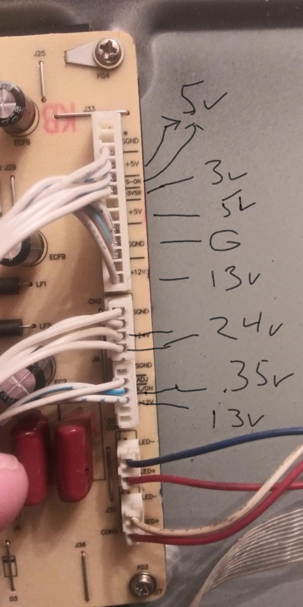

          Oh how i wish that could be true. I have everything to fix a power supply lol. Ive also been reading how they used cheap caps which go out frequently. It doesnt look bad though. And the fact that i dont see any voltage difference on ps on or bl on when i try to turn it on makes me question the main.
          Give me a few ill post pictures and a pin out
            Re: Element elefw605 power issue maybe?
            So when you try to turn on the tv, and it does NOT turn on you have +13 volts ?
            There are a couple other voltages like the standby AL+3.3V
            and P-ON+21V
            I believe the 12 volts is actually AMP+13V
            Is this a BA3AU0F0102 3 power supply board?

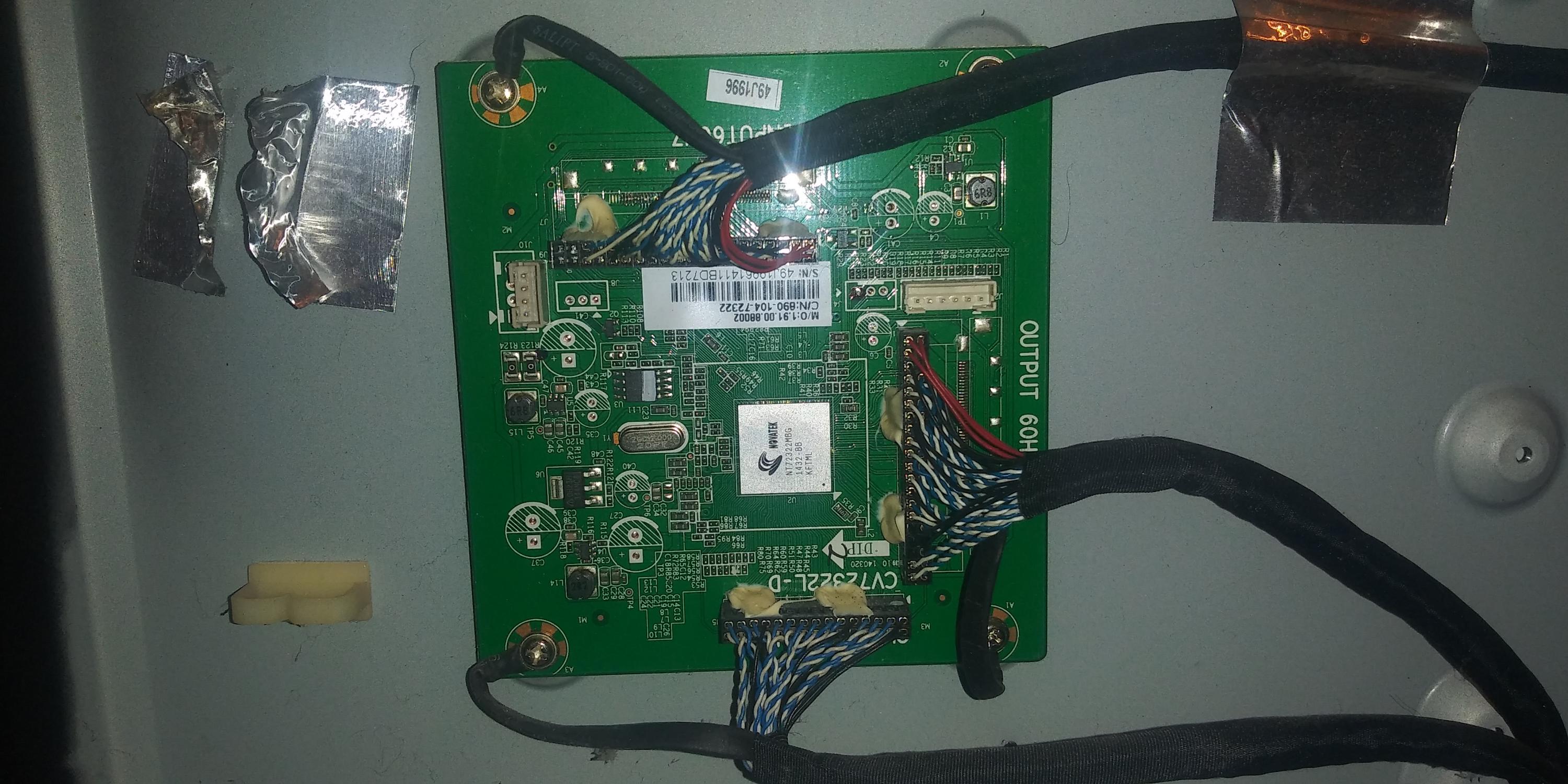

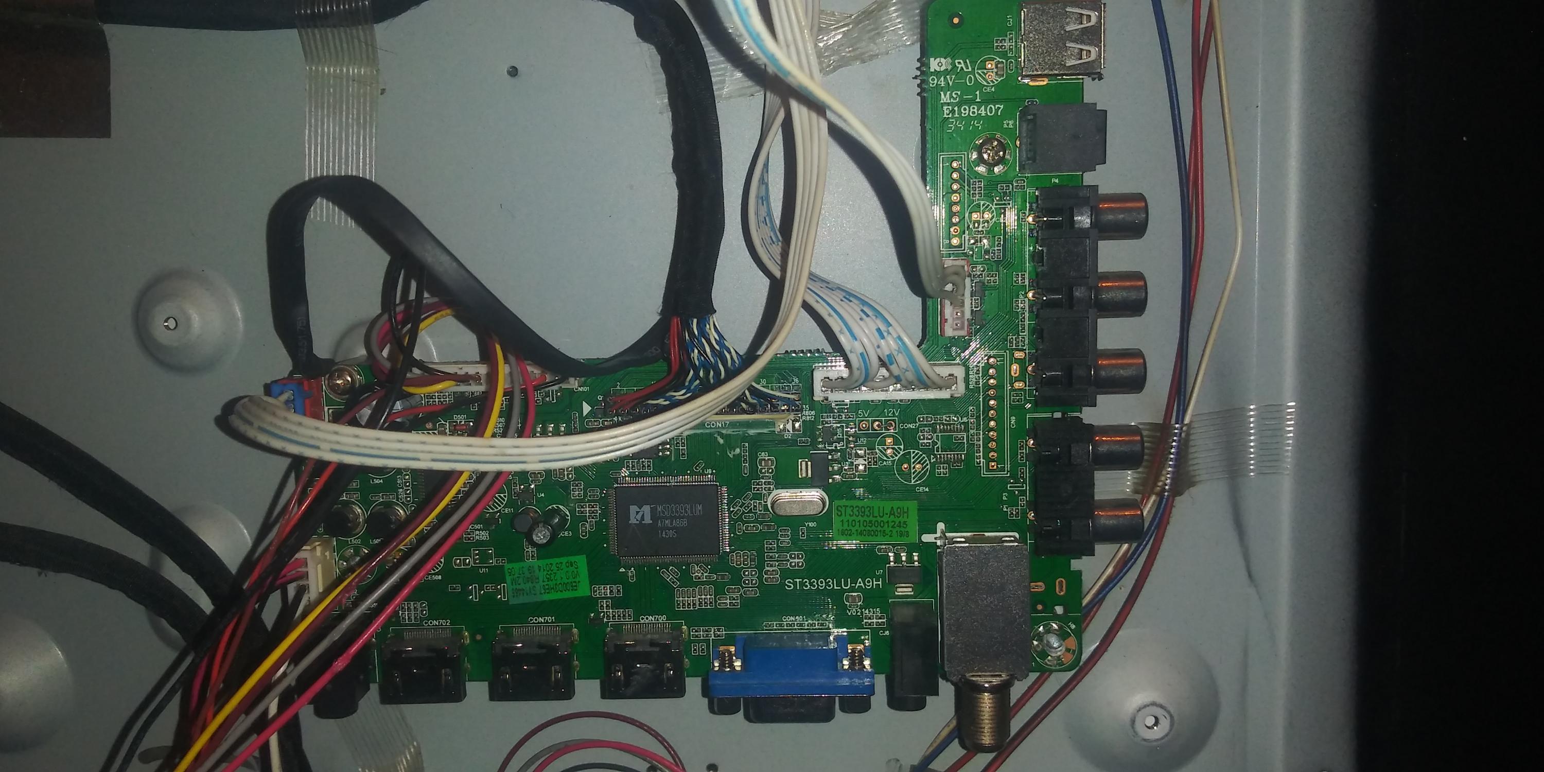

              The pinout is on the picture. Sorry for the bad handwriting. I was rushed lol
              Main
              Tcon
              P-Board
              P-Board Pinout

                No voltage changes on any of the pins upon hitting the button. You hear no clicking or anything like that. I did check on the main to be sure the button was working. I see voltage drops when you hit the on button so i think thats working.
                I could be way off base here but isnt it not normal to have all the voltages on in standby mode?
                Edit also my p on is 5 v not 21!?

                  Oh that's a megmeet power supply, not the BA3AU0F0102 3
                  I see your 5VSB is only 3 volts, that should be 5 volts I believe but could be wrong

                        Just saw your edit. Heres the pictures

                            Thats better, Ok so it is the whole tv that won't turn on. Can you post a clear picture of the back of the power supply board, If that standby voltage is only 3 volts and it should be 5 volts that would cause the problem.

                              It does sound like EEPROM problem.
                                  Is there any tricks to possibly knowing a little be more certainly. Ive tried heating the eeprom up with a reflow station. Which ive heard some people do successfully. But i only used 150 f cause i didnt want to damage it if it wasnt the problem.
                                    You usually cool it with freeze spray (or us canned air duster upside down) then plug the TV into ac outlet and try to turn it on.
                                      It certainly could be the eeprom, I have had luck with freezing the eeprom ic. But you need to unplug the tv, then freeze the eeprom, plug in the tv and try turing it on. The eeprom is read at plugin, after its pluged in heating or freezing usually has no effect
