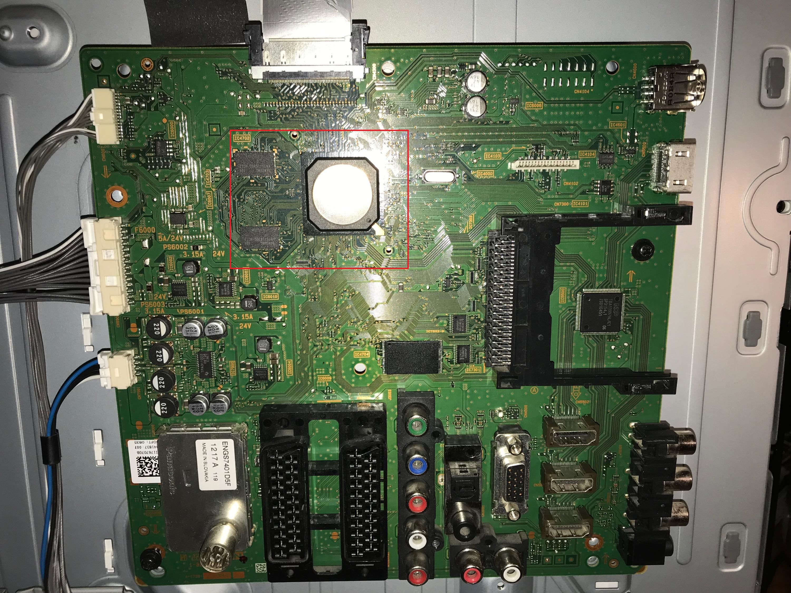

                            Re: Kdl-32bx400 green led on, restarting every 30sec
                            Hello
                            Changing Nand Memory didn't have the desired result.
                            I read the installed one to a file and copy it to a new chip.
                            The behavior is almost the same with the diference that i could start the tv more often although the restart problem stills there.
                            I tried also the suggestion of the air dryer and now what i see is when i locate the air dryer above the chips signaled on the attached picture the tv allways start.
                            I now can see some programs in the tv although some times it freezes and then restarts... A little more of the air drier and the tv restarts working...
                            Any sugestion? Chip replacement? Dead Mainboard?
                            Thanks in advance.
                              #34
                              Sounds like it needs BGA reballing.
                              • nomoresonys
                                • Jan 2013
                                • 12272
                                • U.S.
                                #35
                                Yep, probably need a mainboard, here's an interesting video, he's doing a diy bga reflow, usually only a temporary fix tho. Some use heat guns, some bake the whole board in the oven, he says this method keeps it from overheating the bga. https://www.youtube.com/watch?v=ZDQNOU2w_ek
