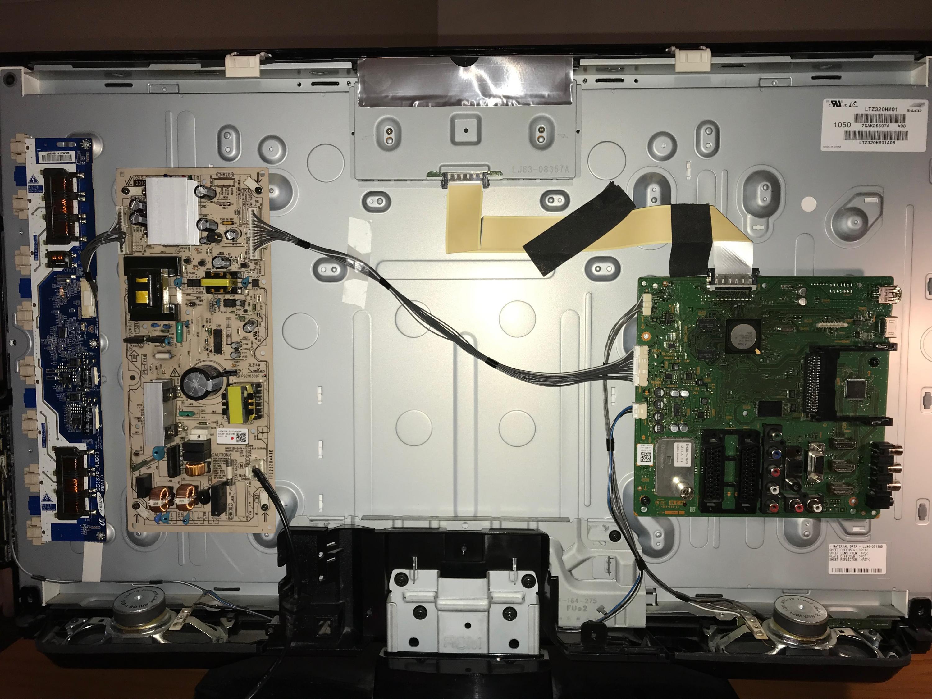

    Hello
    I have a faulty Sony Kdl-32bx400.
    When i connect it to the plug the green led imediatly turns on.
    After that, sometimes the backlights turns on i got sound and the sonny logo appears, sometimes nothing happens(no sound, no picture and no backlight).
    It remains in this state for aprox. 30 seconds and the restarts.
    After the restart green led stays on and nothing happens for 30 seconds and then it restars again.
    The TV doesn't answer to any command from the remote.
    Already check readings from connectors. I have voltage in Standby(3,2V), Power(3,2V), 12V is at 12,5V, BL_ON is 0V, and BL_error is about 3V.
    Already disconnect BL_error on the inverter and ground BL_error on the main board with 110ohm resistors. BL_ON normaly stays at 0V even with this modification.
    Already disconnect dimmer pin on inverter board.
    Nothing changed with all this modifications.
    I kindly ask you for your help because i am out of ideas
    PS: Since the beggining this TV as a small defect, a vertical yellow line appears when the screen is on with the background color black.

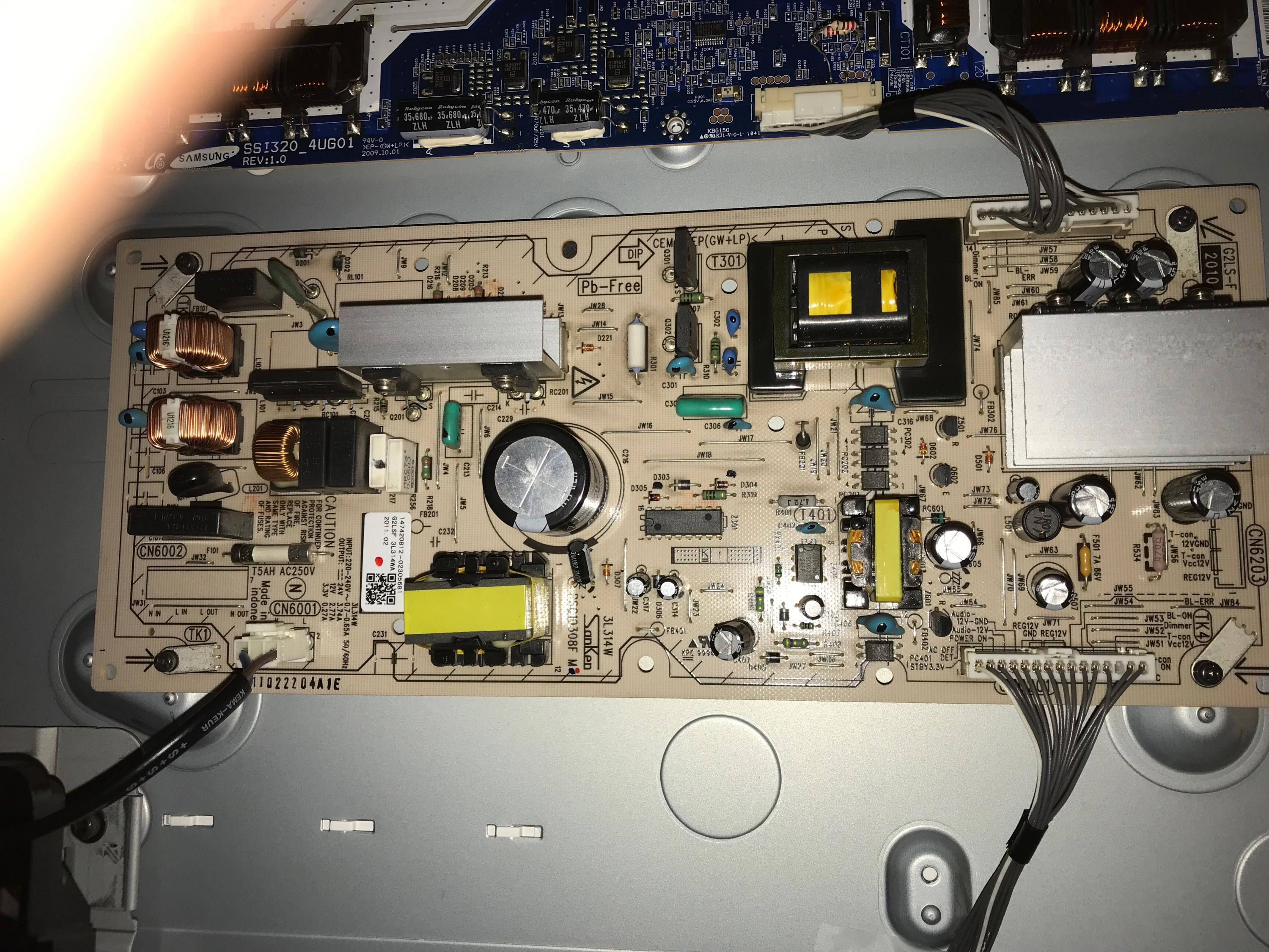

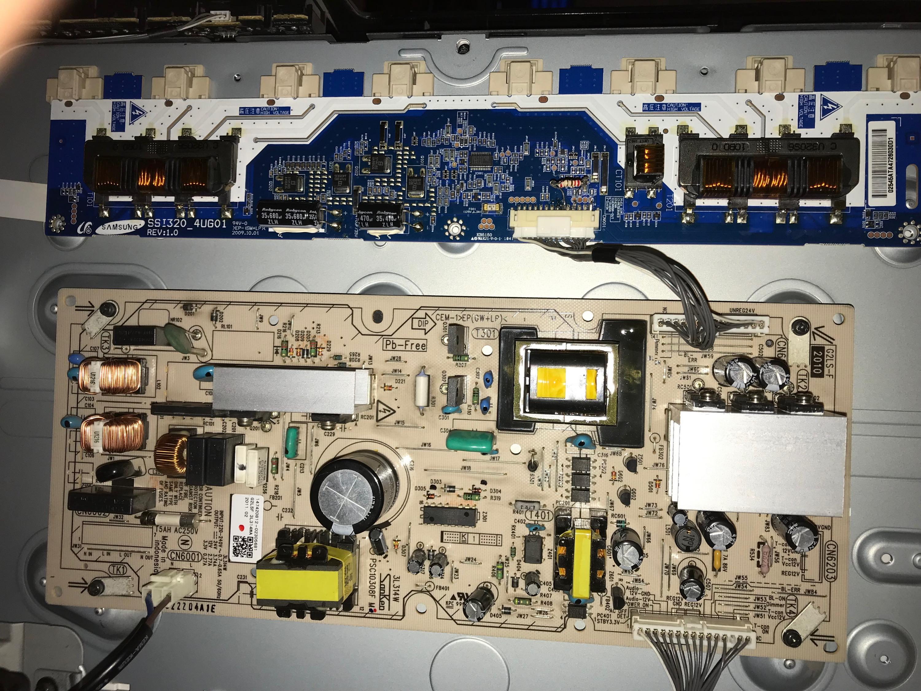

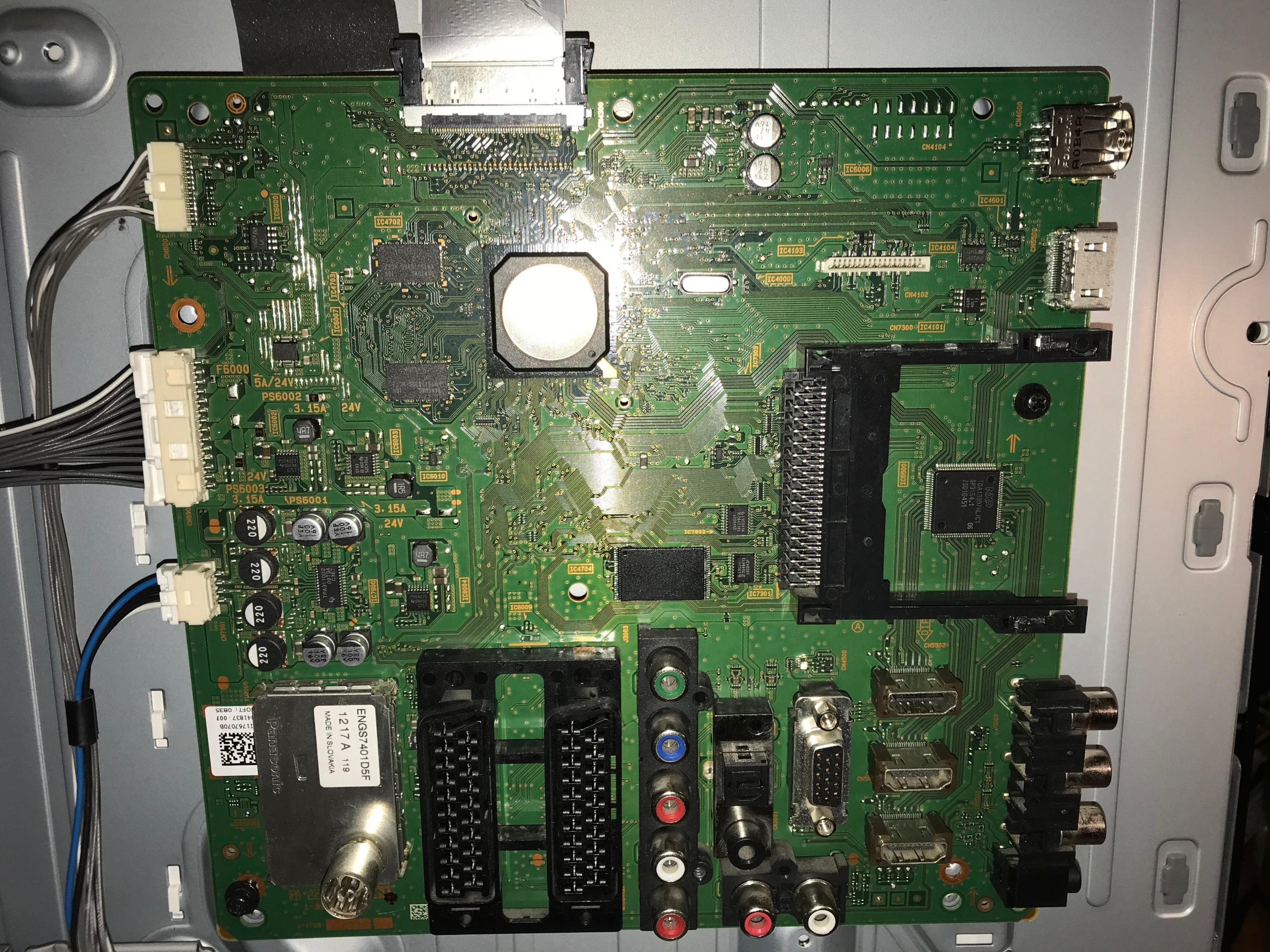

    Attached pictures from the TV.
    Thanks.

          Re: Kdl-32bx400 green led on, restarting every 30sec
          Appears to me that you have a Main Bd problem and to be more exact corrupted software.
              Check F001 fuse on inverter board.
                      Yes bl-on signal comes from mainboard, when testing the powerboard by itself, cable from powerboard to mainboard should be unplgged, then maybe use 1 k resitor from standby pin to power on pin and another resistor from standby pin to bl-on pin, see if backlights and voltages come up to normal, MAKE SURE cable from powerboard to mainboard is unplugged for this test.
                              Hello
                              I gave 3,3V to PowerOn and BL_On and Baclights turned on normal and sustain the normal state for some minutes. So the inverter board is ok and power to Inverter is OK(I think!).
                                After that test, it's looking like the mainboard is the problem.
