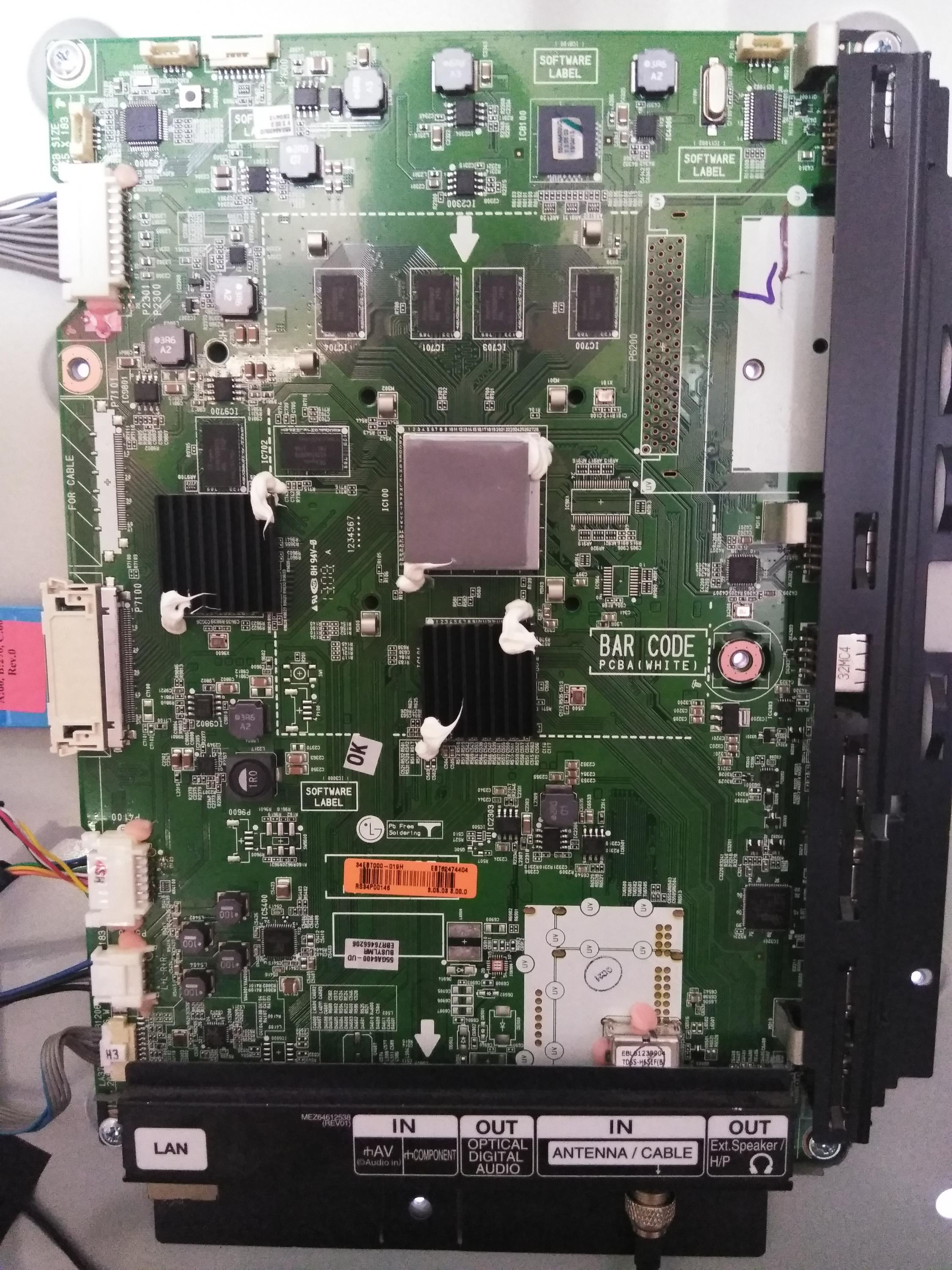

    Problem: has no sound through the internal speakers.
    Sound OK through headphones.

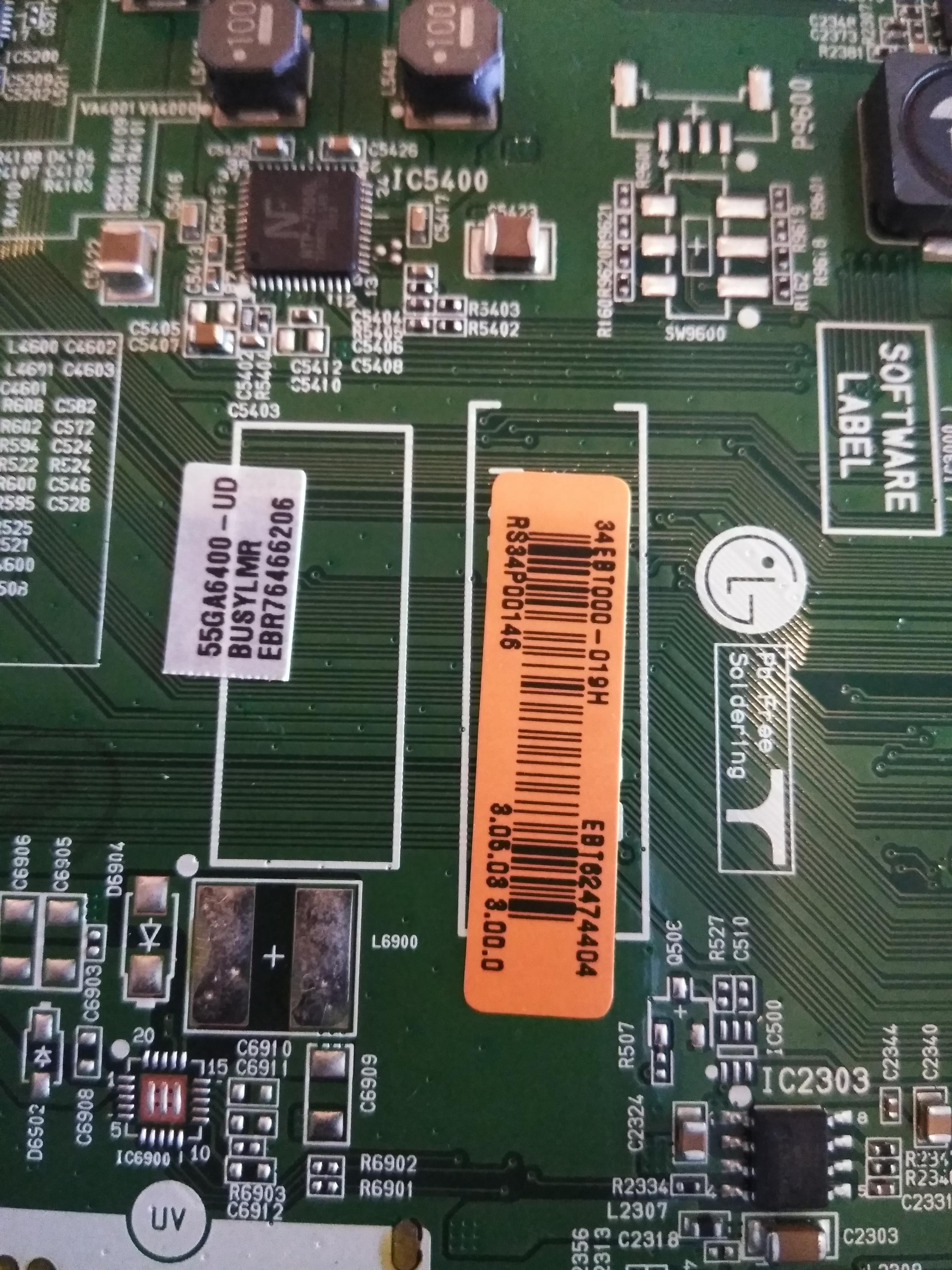

    Main Board: EBR76466206

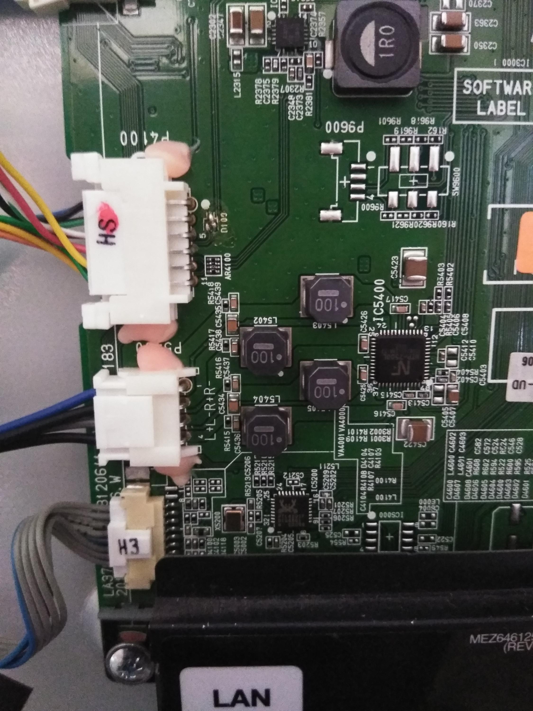

    Speakers Connector Voltage: L+, L-, R+, R- to Gnd: 12.37v
    Speakers Resistance: 8ohm

          Download the service manual, there is a schematic of the main board.
          12v on each speaker wire to ground is normal (half of the 24v vcc to the ic)
          My guess is the audio output ic is ok, if an output was bad, usually you will have 0 or 24 volts on the speaker lines
          I suspect either the headphone jack (sending a mute signal to the speaker amp ic) or maybe something in the firmware is corrupt?
