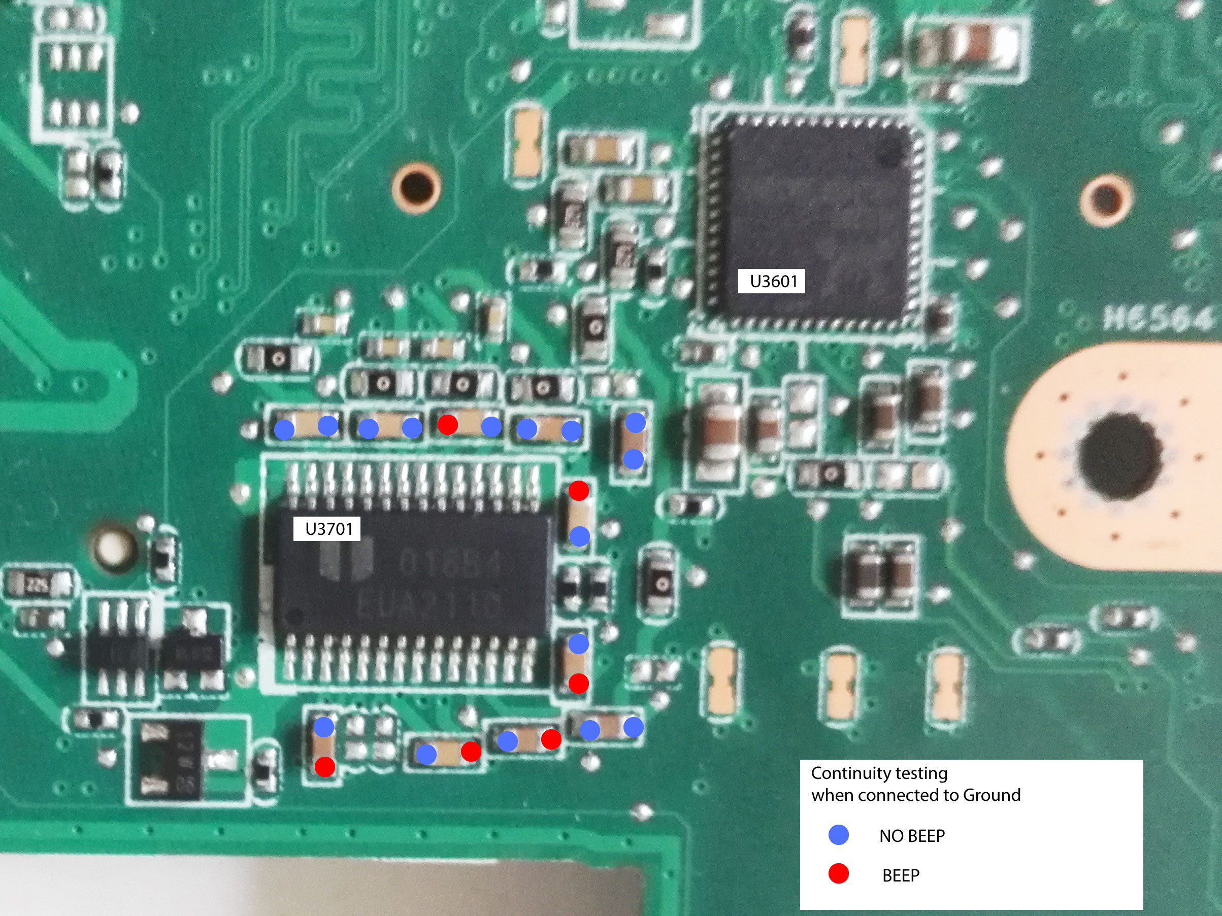

            • Cyrielle
              • Sep 2018
              • 18
              • France
              Re: Asus N73 no sound in internal speakers
              I had time to investigate around the amplifier. I tested the components around it with a multimeter in continuity mode.
              See the results in the picture below
              [for reference, schematics can be found in my 1st post above]
              I hope it can help narrow down the problem. Apologies in advance if it's not relevant, since I am a newbie.
              • piernov
                • Jan 2016
                • 4439
                • France
                On the speaker amplifier IC U3701:
                If you have an oscilloscope, probe on the audio input (LINN/LINP, RINN/RINP) to make sure the audio signal is making its way through.
                Then probe on the audio output (OUTNL/OUTPL, OUTNR/OUTPR).
                Without an oscilloscope, a good multimeter with a bar graph will also allow to watch the variation of the audio signal on the bar graph. Some also have a dBm mode but I don't know if it'll help, depends on the amplitude of the input signal.
                Will also help if you measure the voltage on all the pins.
                Or if you don't want to bother, just replace the chip.
