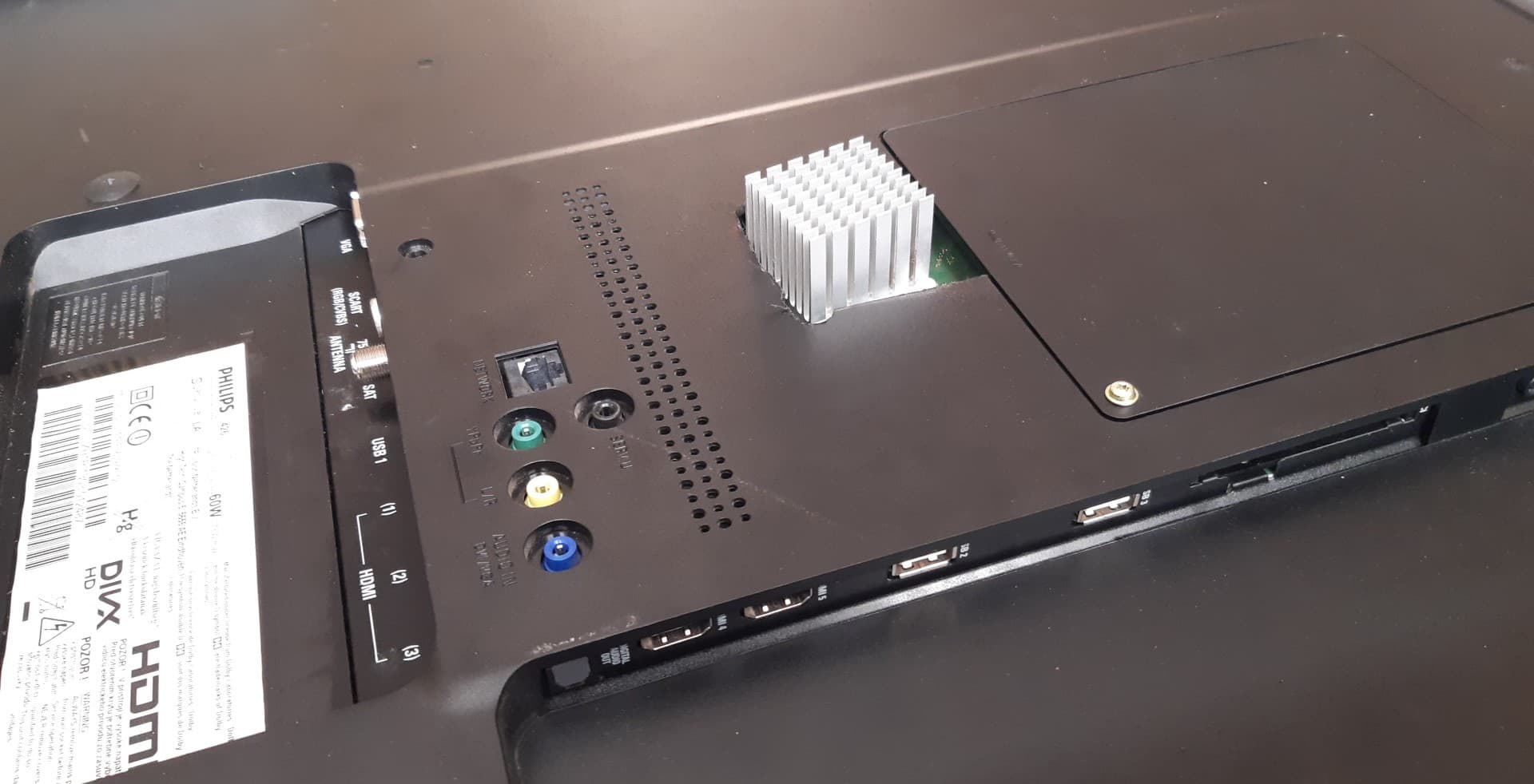

                        #111
                        Re: Philips 60PFL8708S/12 - QFU1.2E LA - Error code 53
                        Hello
                        It works for me too. Error 2 -> Code 53 -> reflow cpu -> sucess.
                        Thank you to all for this thread.

                          • dominik0801
                            • Feb 2018
                            • 98
                            • Hungary
                            #113
                            Originally posted by Maalobs
                            Well done, monsieur!
                            You dared to tackle the reflow yourself, and succeeded.
                            Another nice fellow here on the forum contacted me in pm last year, he also had a QFU-chassis Philips TV that had suffered the same fate.
                            I don't know why he had such stage fright that he couldn't start his own thread, because after his successful reflow I think he made an elegant solution by simply handsawing into the PLA-plastic to make room for a bigger heatsink from an old computer-motherboard:
                            Regarding the heatsink; if your TV-model also has the two mounting holes diagonally across the main processor in the same way as on the TV in this thread, I've realized later that the standard format distance between the holes isn't 55mm as I had measured it, but 54.6mm, so if you search for that then you will find a lot more options on heatsinks:
                            https://www.google.com/search?tbm=is...eatsink+54.6mm
                            400 micrometers makes all the difference.
                            The TV that I fixed in this thread is still going strong, and still remains the main TV of my friend that I fixed it for.
                            Generally though, to prolong the longevity of the device, you should run the brightness and Ambilight at as low a level as you can tolerate.
                            In a consumer agency test a couple of years ago here in Sweden, it was discovered that if you ran the brightness at the maximum level on the TV, some manufacturers were actually running the backlight-LEDs at over-voltage!
                            But even running the LEDs at close to their limit is very bad for their life expectancy, so try lowering the brightness and see how low you can set it and still maintain an acceptable picture.
                            My friend who owns this particular TV is keeping it dialed down, so we are not expecting any LED issues.
                            I bought the NAND Flash chip in a lot of 2 from AliExpress, so he has one more NAND chip left as backup, for when the current one eventually fails.
                            Then we'll replace in the last NAND chip and he'll be able to run the TV a few more years.
                            Sometimes I come back to the QFU series TV threads, because as dodgy they are, the more I love them.
                            I bought mine as faulty, because I have joy in fixing stuff for myself.
                            It makes me a lot happier, than buying something off the shelf.
                            It was nice to see my picture in your post, but let me tell you my story about this TV.
                            I bought the TV as used, not working, however, the problem was just the flat cable, I had to jump the +12V between the mainboard and tcon. It was working fine. This was in 2020 september, so 1 year ago.
                            Then one day I woke up seeing my TV's stand by led blink 2 times, not turning on anymore. (2020 december)
                            I read about the 2 blink issue exactly in this thread, so I blew the CPU with my hot air soldering station at like 300C, low air, for 1 minutes. I then assembled the TV back together, with the stock cooler. After a few days, I did the cooler modification in Maloobs' post. It lasted for exactly 2 weeks.
                            Please note, that 300c upper heating without bottom heating is impossible to actually reflow the chip, especially under 1 minutes. Just a regular VGA VRAM chip needs 450c to melt the solder balls under it, and its a lot smaller and thinner.
                            Then I heated the chip again, this time with 215c, as I read on another forum.
                            The TV lasted for 1 month. Maybe important to note, that while it was working this time, I was constantly checking the heat of the heatsink with my hands while the TV was on. This will be an interesting information for later on.
                            (Also, note that when I first heated the chip, I also touched and modified the CPU area of the board physically several times.)
                            After that happened, I heated the heatsink itself to 220c without taking off the back cover of the TV, because I was lazy. The thing is, it worked. That time I also put a small fan on the heatsink and soldered it to the 3.3V line on the motherboard. I again, checked the temps many times with my hand on the heatsink, and to be honest, it was almost COLD with the fan on, so I knew that I might have fixed the overheating issue. (2021 january)
                            It died again after 1 month.
                            Since I was trying different time and temperature values, that time I again heated the heatsink on the chip with 260c for like 1-2 minutes, put the TV back on the shelf, worked again, and I did NOT touch the heatsink anymore.. (2021 february)
                            not until this Monday (2021 september), when I noticed that the fan on the heatsink got a bit louder, and took it off to oil it up, then put back.
                            Boom, after 7 months of working, the TV died again the same day I touched the heatsink of the chip.
                            This got me thinking.. maybe my TV actually has a bad BGA contact, rather than a bad CPU? Dunno, but I just lazily reheated the heatsink again, but after 1 day it died again.
                            So... today I went against my laziness, disassembled the TV, put the motherboard on the BGA machine, and properly gave it a controlled reflow with liquid flux.
                            Put everything back together, TV works, and now theres just one question: for how long will it work? Time will tell!
                            Sorry for the long post, I really wanted to share every piece of information, in case it could help other people here.
                            If you would ask me, why I struggle this much with this TV... my answer would be to read the first paragraph of my post!

                                      • Maalobs
                                        • Jun 2016
                                        • 120
                                        • Sweden
                                        #119
                                        Dominik; Wait, so you had access to a BGA soldering machine the whole time, but you didn't use it?
                                        The guy who did the reflow for me, which was just a reheat and reuse of existing solder, he used a huge hot air station that is not meant for soldering I think but for other industrial purposes.
                                        The handle was the size of the operator's remote control for a small industrial crane.
                                        It was a few years ago now, but as I recall the actual heating took just a couple of minutes or something, and after that we chatted for maybe fifteen minutes while we waited for the board to slowly cool down.
                                        He talk about how there was an art to doing this sort of thing.
                                        He heated up the chip until it "danced" on the melted solder, then he gently tapped the corner of the chip with a pair of tweezers and watched the chip flow back into position again by itself.
                                        Then he immediately stopped heating the chip any further.
                                        Maybe he applied additional flux too around the edges, I didn't see that, I just heard him start up what sounded like a leaf blower in the back room.
                                        I don't know what temperature or air flow he was running at, but he said the benefit of the big machine was that the nozzle was so wide that it heated the entire chip at once, and the machine was powerful enough to heat consistently across the entire area which also meant that he could work fast enough without heating the chip for too long.
