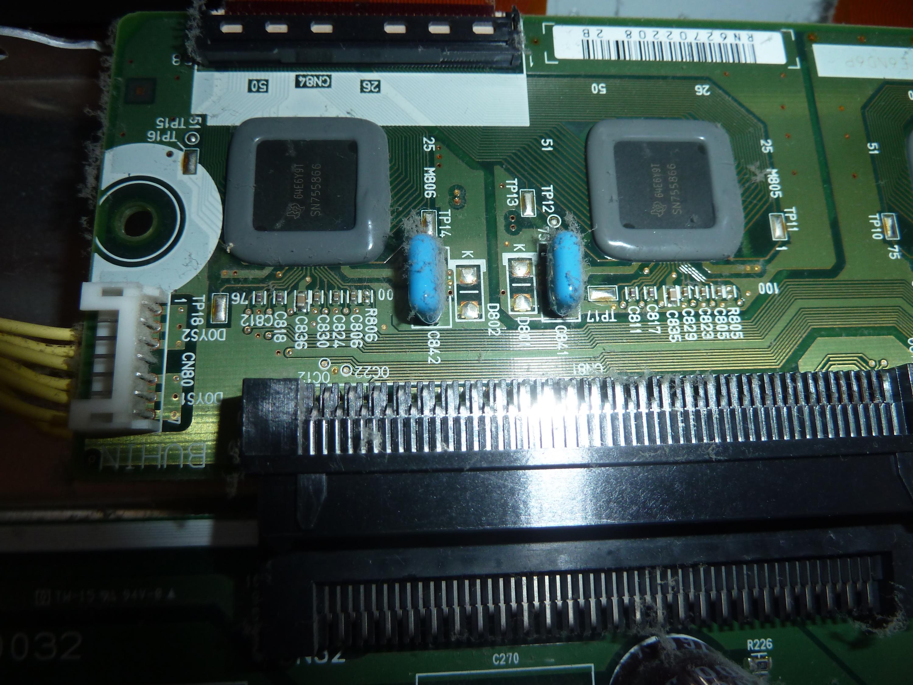

          I disconnected the two buffer boards from the y-sus board and powered it on for a second. After it booted up I got the 5, 60, and 80 volt rails that were missing before.
          Each buffer board does have 6 blue caps on it but I will have to disconnect the ribbons from the boards and remove them to access the bottom side. I'm also not sure how I would go about testing the IC's on the board.

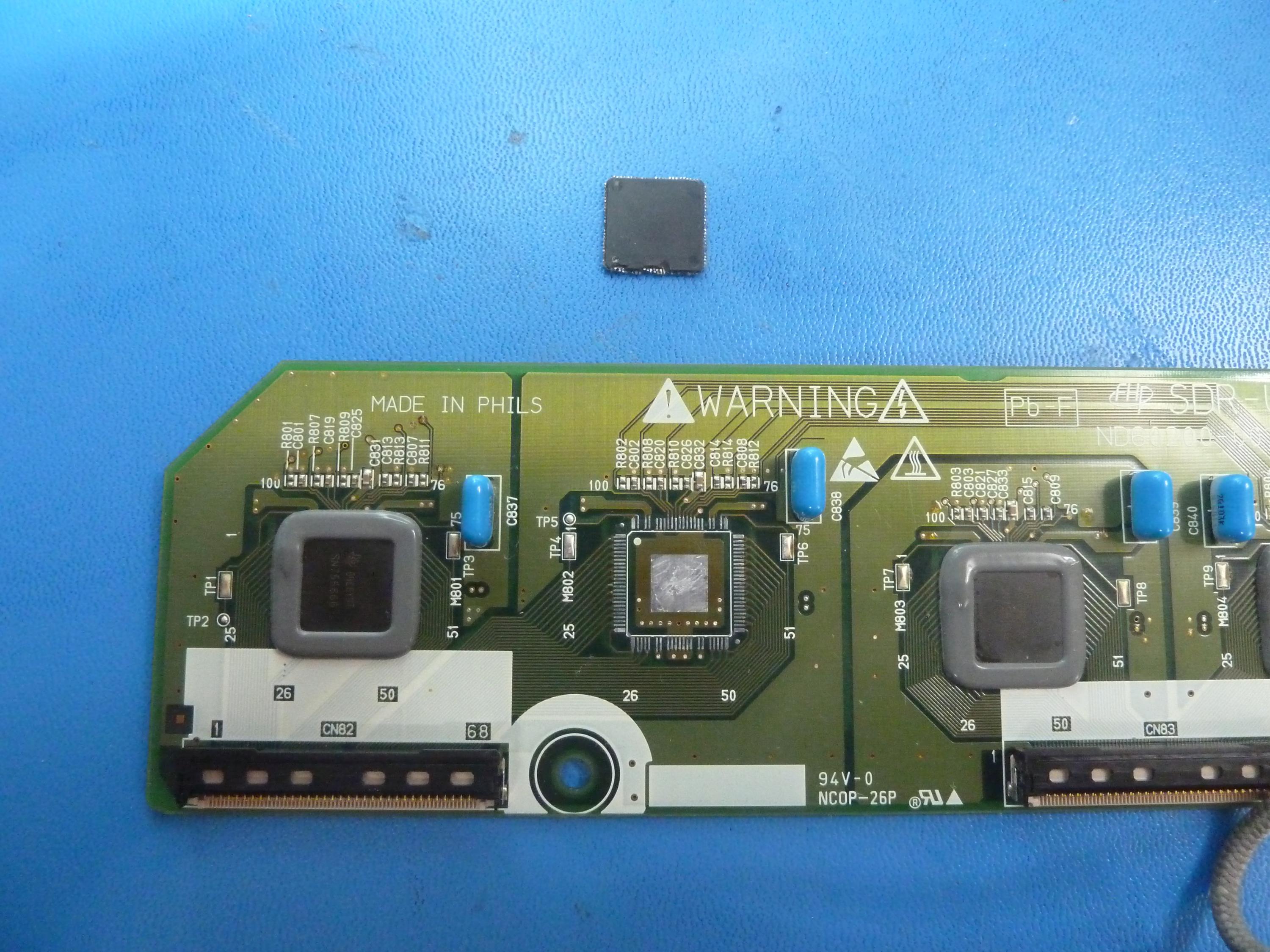

          I've attached pictures of the buffer boards.

            Re: Hitachi 55HDX99 Plasma Powers on but no picture
            a good buffer line would measure about .6xx - .7xx on the meter, a shorted pin indicates the bad buffer line (ic) and that ic would be bad
            It's usually the upper board that fails so you could connect the lower buffer and see if you get a picture on the lower half of the screen. If you do, don't leave it on very long, just a few minutes should be ok

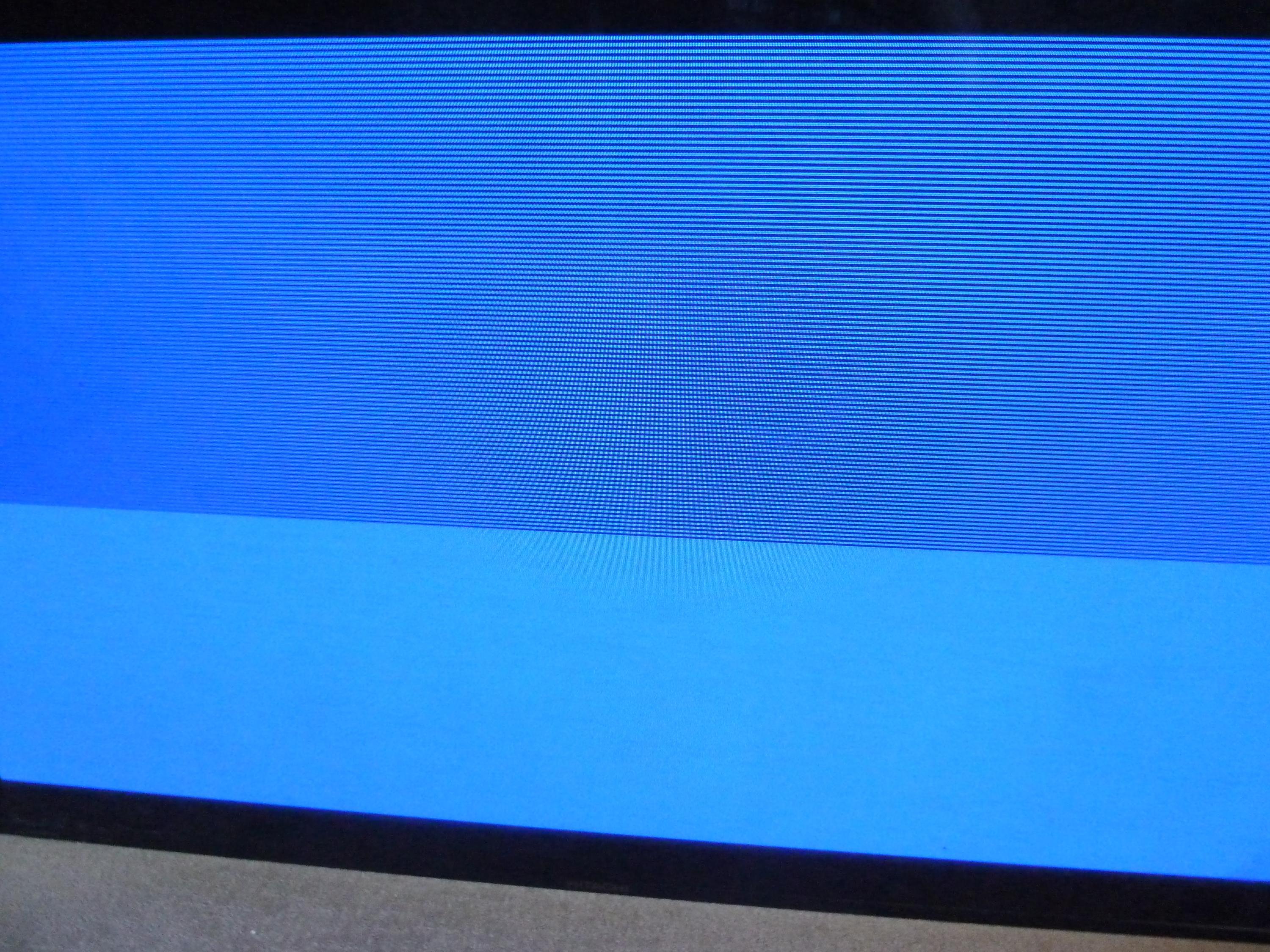

              I plugged in the bottom board and did get a picture on the bottom half. It was just a blank blue screen from my VCR. Impressive diagnosis on your part. There is some light blue speckled artifacting which I hope is just due to having half the thing apart?
              I'll have to wait until after the weekend to test the upper buffer board. Thanks for all the help so far.
                Yes I believe you will get some speckling with just one board, I think it is usually the top ic on the upper buffer that goes bad also, but could be anyone of them.
                  Well I did the tests and they all test 0.7v except for the chip second from the top. A couple of the pins tested 0.7v but some were 0.1v some were shorted and some didn't show anything. So it looks like that chip is dead. Found some on fleabay that I'll try and order.

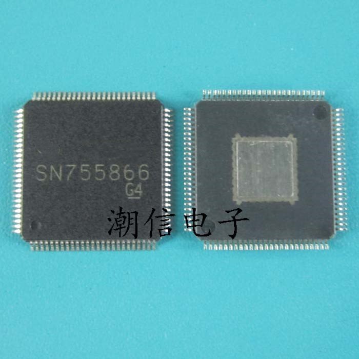

                        It is the bottom half of the top connector which is testing as bad and those traces all lead to the chip second from the top. Interestingly, it is the same chips as the one with the silicone removed from around it on the picture R_J posted.
                        Those are all good tips for soldering the chip. I have the liquid flux and hot air station. I have replaced chips of a similar size and pin density on my laptop successfully so I have a bit of experience.
                        The chip is an SN755866.

                          It's not so much the ic's pins, but it's 1/4 inch heatsink pad. I would carefully cut the pins on the old ic then unsolder it from the heatsink pad, then deal with removing the left over pins from the traces.
                          The picture I use was from the internet, One of the boards I have had the first ic bad. Others I have seen have had more than one ic bad.

                              I got the chip removed from the board. I first peeled all of the silicone off then used a thin knife to cut all of the pins. I flooded solder over all the pads to remove the pins and then went back with solder wick to remove any solder that might be bridging from the chip to the pads.
                              After I did that on all 4 sides, I got some old heatsinks that had large enough fin spacing to go over top of the connectors and protect them from the heat. I used the hot air at 400C and unsurprisingly it was taking forever. I had a pair of tweezers resting under the edge of the chip so that the weight was providing some upwards pressure on it since there were no pins to be worried about ripping off. After a while I nudged the heat up to 420C and the chip popped off.
                              I then cleaned the flux up and put the board in the TV. It turned on and the display has the pattern shown in the pictures I've attached. I'm surprised that is how the display is set up. I was expecting to have one thin black bar at the top, not the black stripes that it has. Doesn't matter though because the other chips obviously aren't shorted as it is now working.
                              Guess I'll order a couple chips in case I stuff one up and wait a month for them to come from china...

                                Great job. Very clean. It's like you're following in the exact footsteps of my Hitachi plasma repairs.
                                In my case i only needed to go to 400C because i also had a lower pre-heater. In your case going higher to 420C was probably necessary if you didn't use a lower pre-heater.
                                And yes, by reconnecting without that IC in place and getting an image, you have confirmed that IC alone was your issue - everything else looks like it's working.
                                That's even the same IC that I had to replace - 2nd from the top.
                                Best of luck with the rest of your repair.
