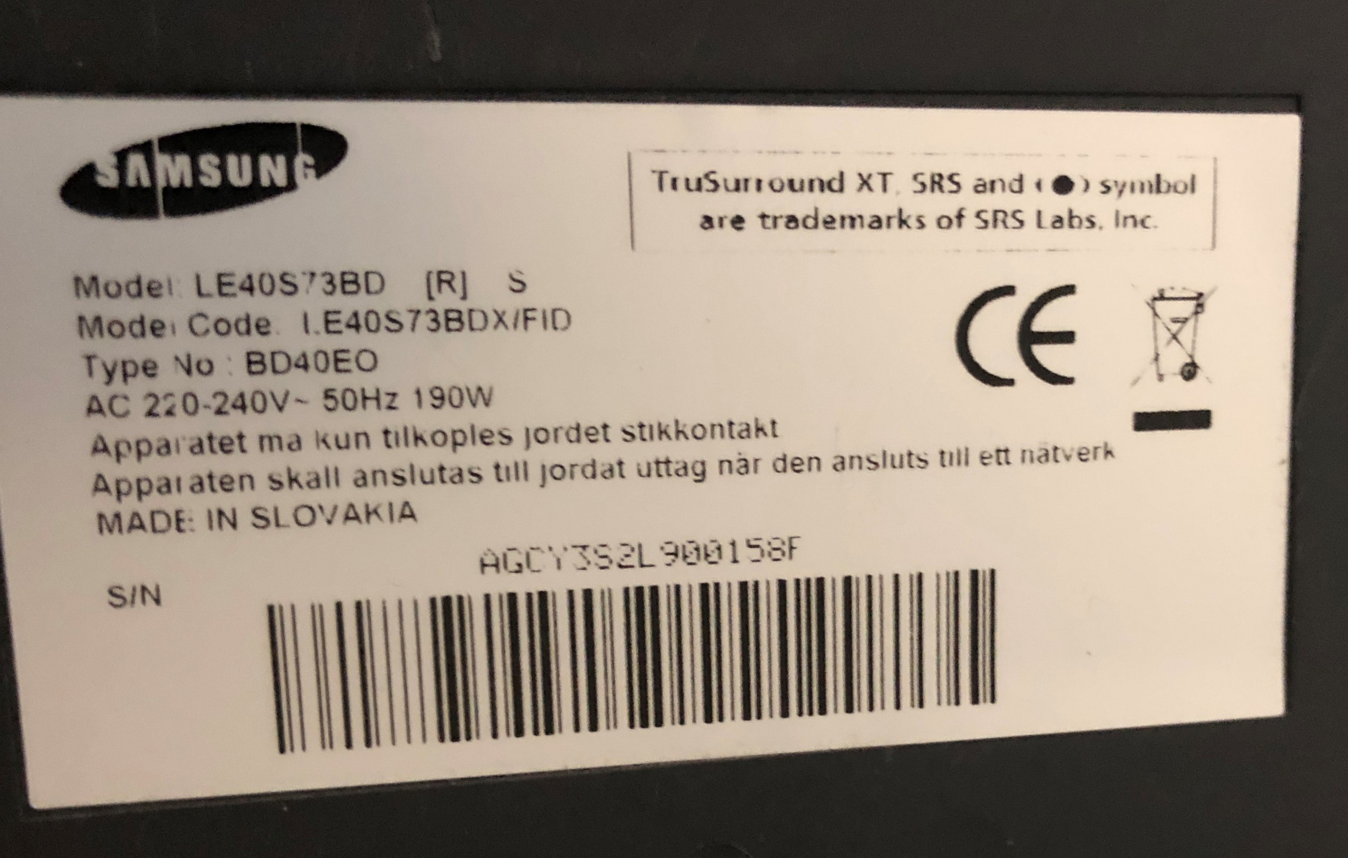

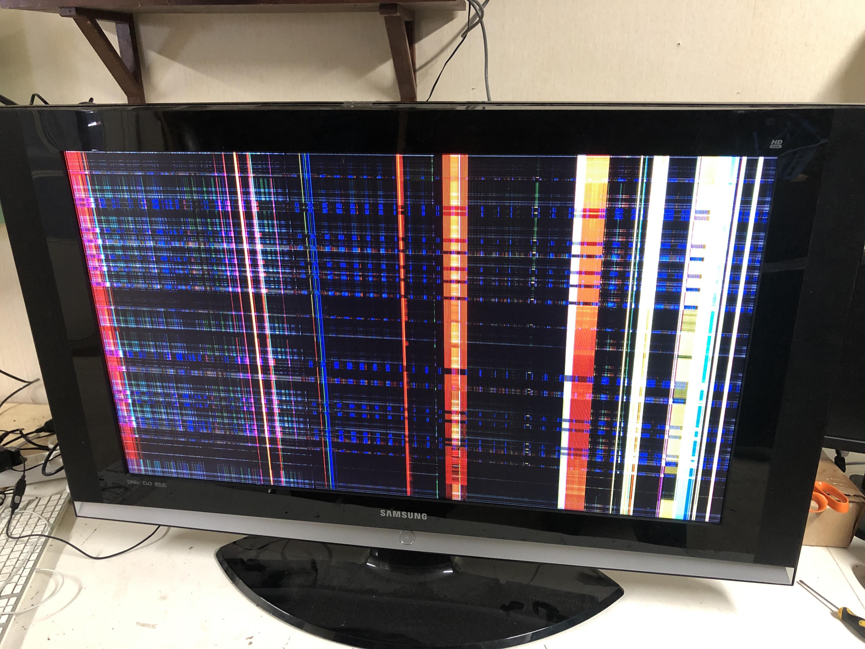

    Could i please get some help troubleshooting this on?
    Video and pictures below. Sometimes screen is good and clear but mostly totally distorted.

    Re: SAMSUNG LE40S73BDX Distorted screen - VIDEO AVAILABLE
    This may be a problem with poor solder connections of the large square QFP IC on your mainboard. You will need to use lots of flux, and re-touch each pin of this IC on the mainboard with a very fine tip solder iron.
    Reflowing with a hot-air rework station may work, but re-using the existing crappy lead-free solder may not be as successful as retouching each pin with fresh solder.
    Before attempting repair, you may try applying heat from hot air dryer over the mainboard before turning the TV on to see if any of the lines change or go away completely.
