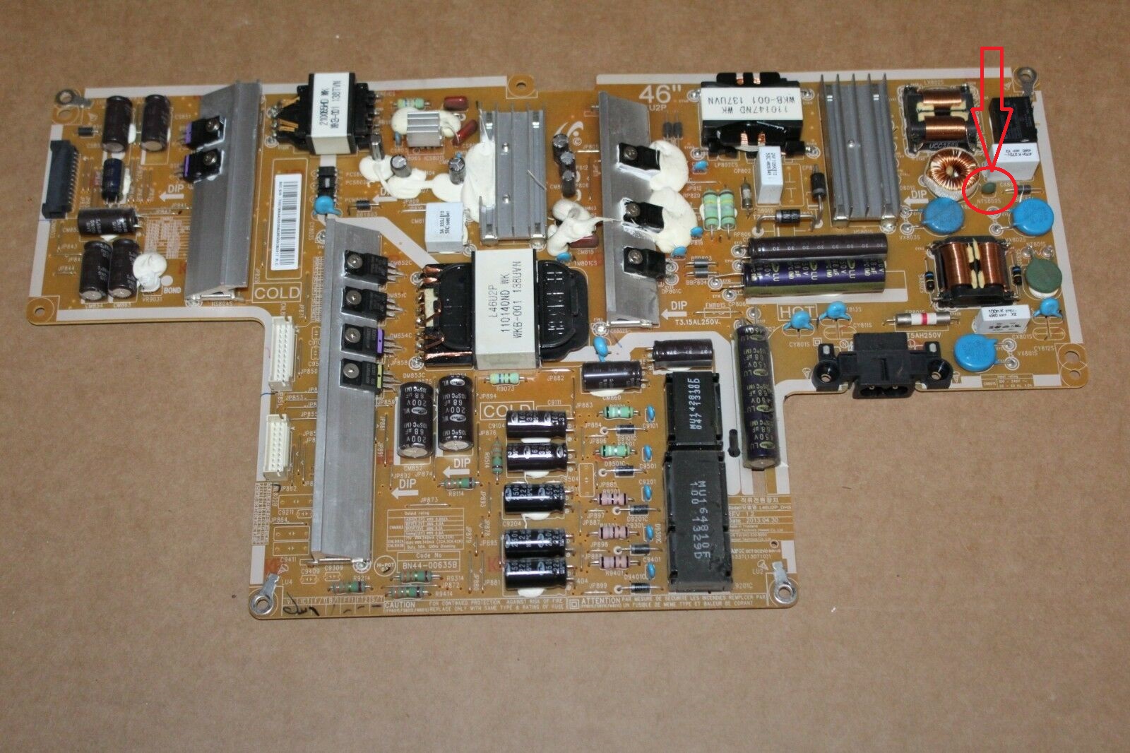

    Hi people,
    power supply BN44-00635B L46U2P_DHS REV 1.2
    need a bit of help, im looking for the schematic for this board, as i need to find out what the value is for a small Thermistor Resistor, i'll point it out in the pic of the board.
    there is also the bigger Thermistor that as blown as well, but i can see that it is WTR 15D050, also blown fuse,
    what if anything could also be blown, or may have caused these items to all blow at once.
    Re: SAMSUNG UE46F8000 power board
    I need to see good clear focused pictures of the whole top and bottom side of the board, your picture is too blur for me.
    NTC WTR 15D050 is 15mm Dia. 5 Ohm.
    Start checking all the power devices in the hot side of the circuit for shorts.
      if the NTC is blown, there is a good chance something else is blown too.
