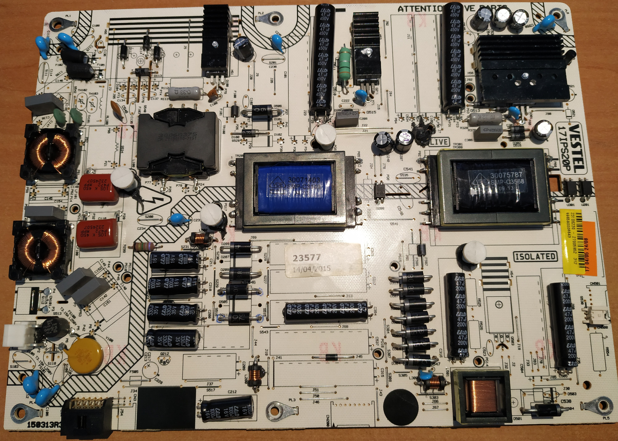

    I've got this unlucky board, a Vestel 17IPS20P (150313R3) that got a couples surgeries during its lifetime. The last time I fixed it there was a blown diode (D208), nothing extraordinary, happened already two years ago, changed it and everything was fine. Then after about a month I had the brilliant idea to add the unpopulated diodes D207 and D505 to harden this weak spot. During this operation I must have splattered some solder on the HV section cos after closing the lid and giving power a loud boom happened.
    U202, S536, Q211, R230, R22, R242, D201, D208, D228, D522, D523 were destroyed.
    Removed the extra diodes, replaced these parts and now the board is pulsating. It makes a clicking noise in the region of TR200. VCC_MAIN and VCC_M are trying to reach operational voltage during these pulses. From time to time if you let the board do this thing for a minute or two it may start and give around 10V on +12VCC and 20V on C217, the TV backlight turns on briefly as it should and the red standby led stays on (there is a buzzing noise, maybe caused by the undervoltage). Trying to use the remote to turn on the TV makes it cycle back to pulsating.
    Not sure what to do now, the pulses and the damaged components on the FB_M line could mean a bad U200, but i tried with a 3171 (should be compatible) and nothing changed.

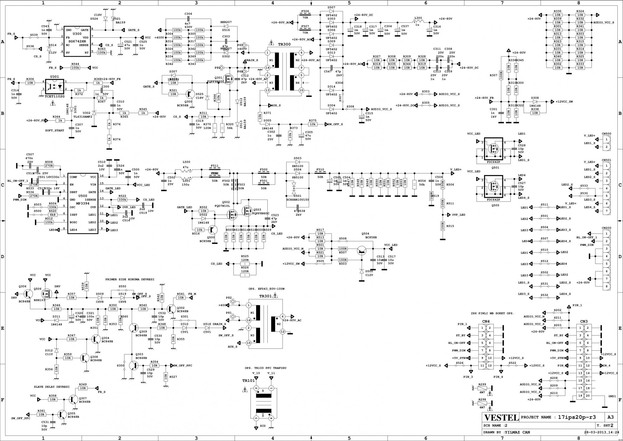

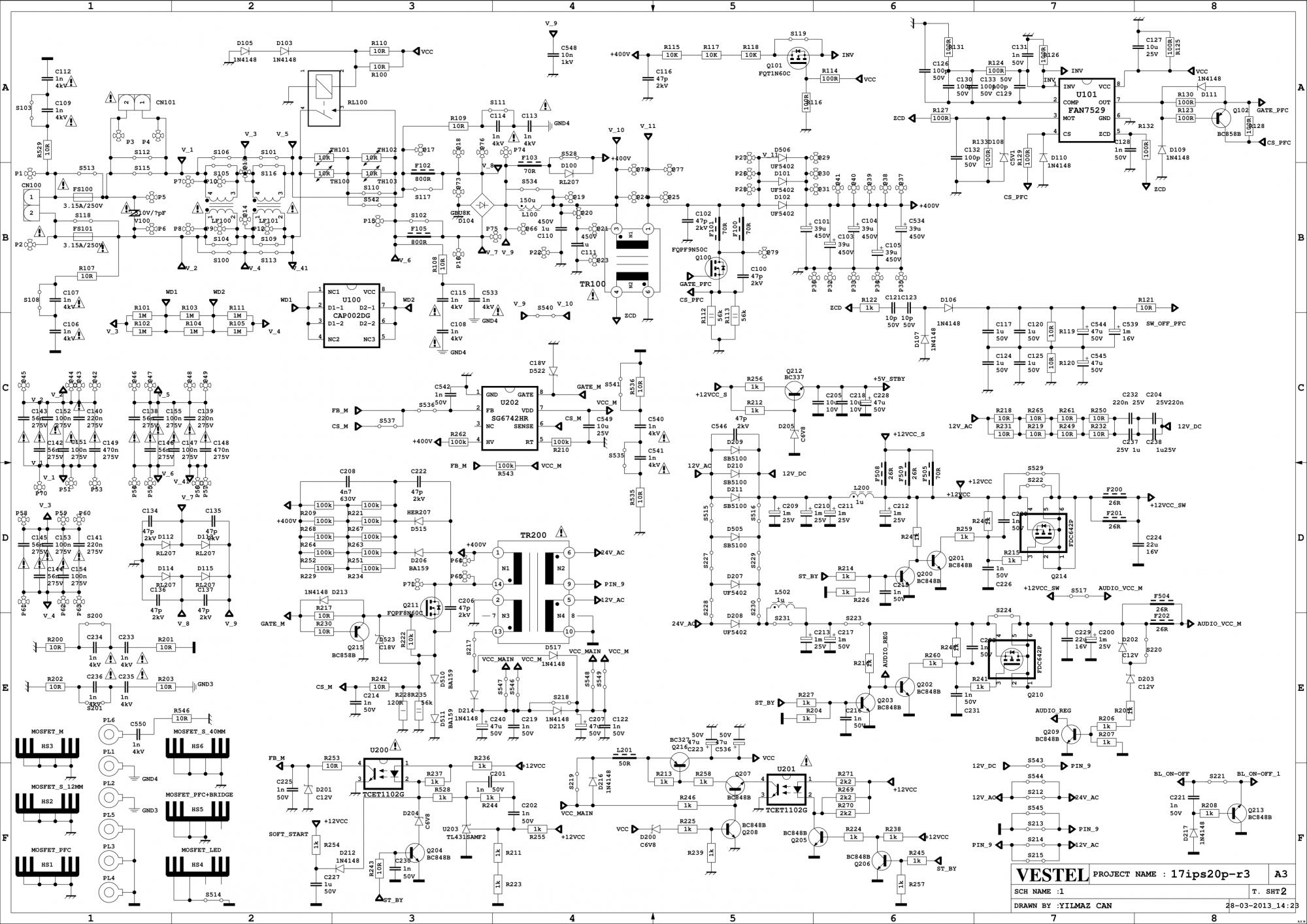

      What value did you use for R228, did you go by the original resistor or the schematic? If d201 was bad, the optocouler may be bad also

        The original resistor was 0,33 , the schematics says 120.

          The schematic is wrong, 0.33Ω should be the value, It might be the optocoupler or maybe the reference (U203) got damaged?
          Also check D214

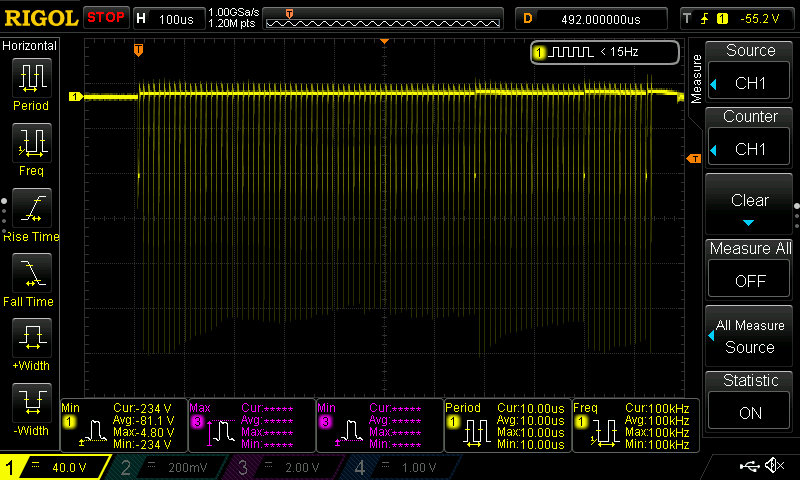

                    Maybe this board is a little different from the reference, the section for generating +5_STBY is not populated, Q212 and the surrounding components are missing.

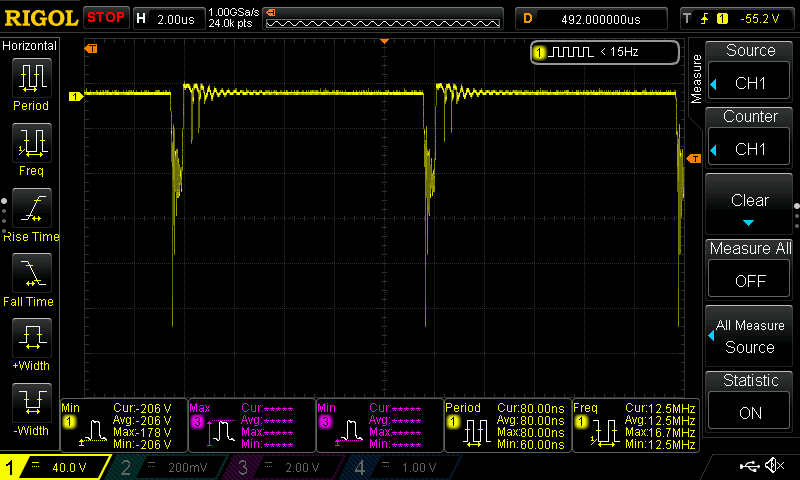

                    Attached the screens on the pin 13 of TR200. Apart from the huge negative spikes there is a positive voltage of 12V. U202 is trying hard to boot up it seems.

                      TR200 pin 13 is on the hot side, you can not connect the scope ground to the hot ground without an isolation transformer

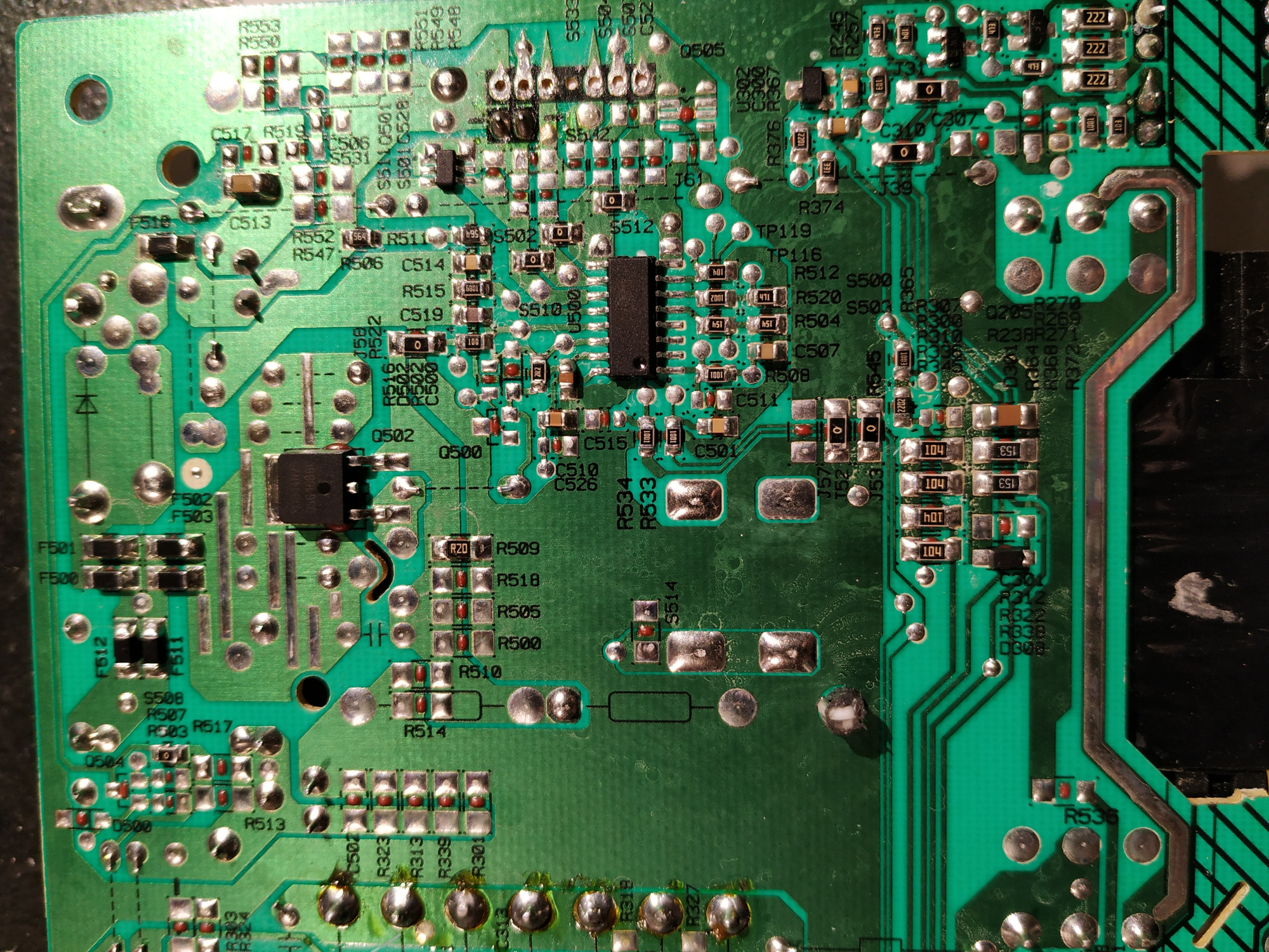

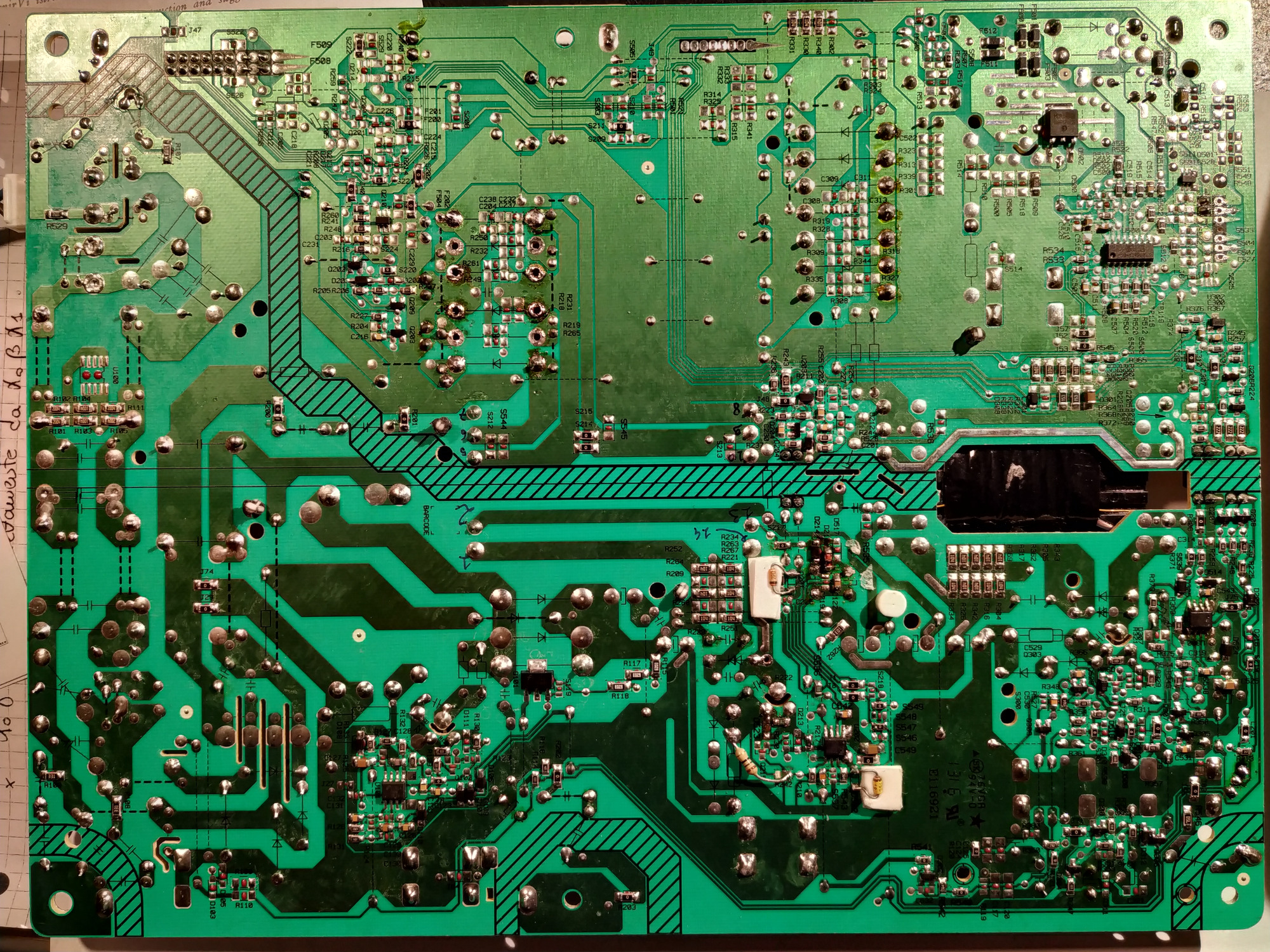

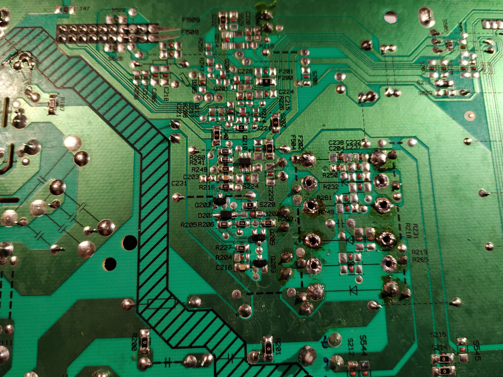

                        This is the back of the board, yes, I've mangled the board after desoldering the same components over and over...

                                    This morning I tried again to check the U202 surrounding components, with the scope I saw it trying to boot, but it never completed the sequence and remained stuck in a cycle.
                                    Then it struck me... Did I use the correct values for the destroyed components? The schematics is useless in this respect, random values all over the place, so I checked U300 and Q301 and what do you know, the current sense resistor in circuit is 100 Ohm, the schematics says 10 Ohm.
                                    After soldering a 100 Ohm resistor the board came back to life!
                                    Nice, but it doesn't end here, this was only my first mistake.
                                    Thinking I got it finally sorted I soldered back the diodes D207, D208, D209, D210, D211, D505. Powered up and BOOOM.
                                    D207, U202, Q211, FS100, D115, D112 gone. What in the world was happening? It is almost like the first time, everythings working, add a couple diodes and board explodes...
                                    There is where I experience enlightenment (sort of). Im using all SR5100, but originally they were different, expecially the one on the 24V rail! The second mistake was using a schottky barrier with 100V blocking voltage in parallel with a a UF5404. The SR5100 dies instantly after power up and takes with him the HV side of the board (bad design?).
                                    In the end I replaced (again) the damaged components, left UF5404 (D208) alone and the TV is now working.
                                    Thanks R_J for the help, it was a messy fix, I did more harm than good trying to harden the diode section. If it aint broke don't mess with it? Damn right.

                                      Well good to here its fixed. That SR5100 is ment for a 60hz power supply, Its not even close to being fast enough for this 132Khz power supply, The UF5404 is a Ultrafast recovery diode. makes a big difference.
                                      I made a note of the resistor value change (R311 = 100Ω) correct
                                      I hate these schematics, they are all over the place with values etc. but, better than nothing.
