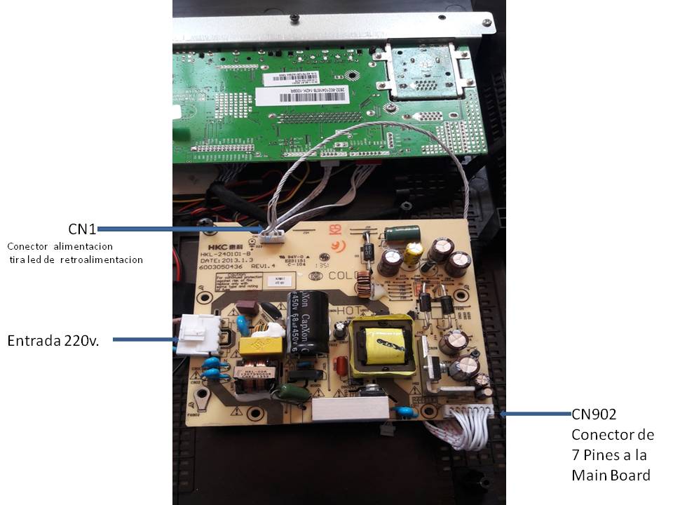

      Hello CapLeaker:
      Acontinuacion step to inform you of the tensions
      that are measured, in the CN1 connector that goes to the backlight LEDs.
      TV connected and blue led on with cable disconnected.- 11.21v
      Connected TV and blue LED on with connected cable.- 11.21v.
      In the CN902 connector that goes to the Main Board the voltages with
      Connected cable are:
      Pin 1.- +11.51 v
      Pin 2-3.- +5.06 v
      Pin 4-6.- GND
      Pin 5.- +4.85 v
      Pin 7.- 0.027 v
      Greetings and thanks for your guidance

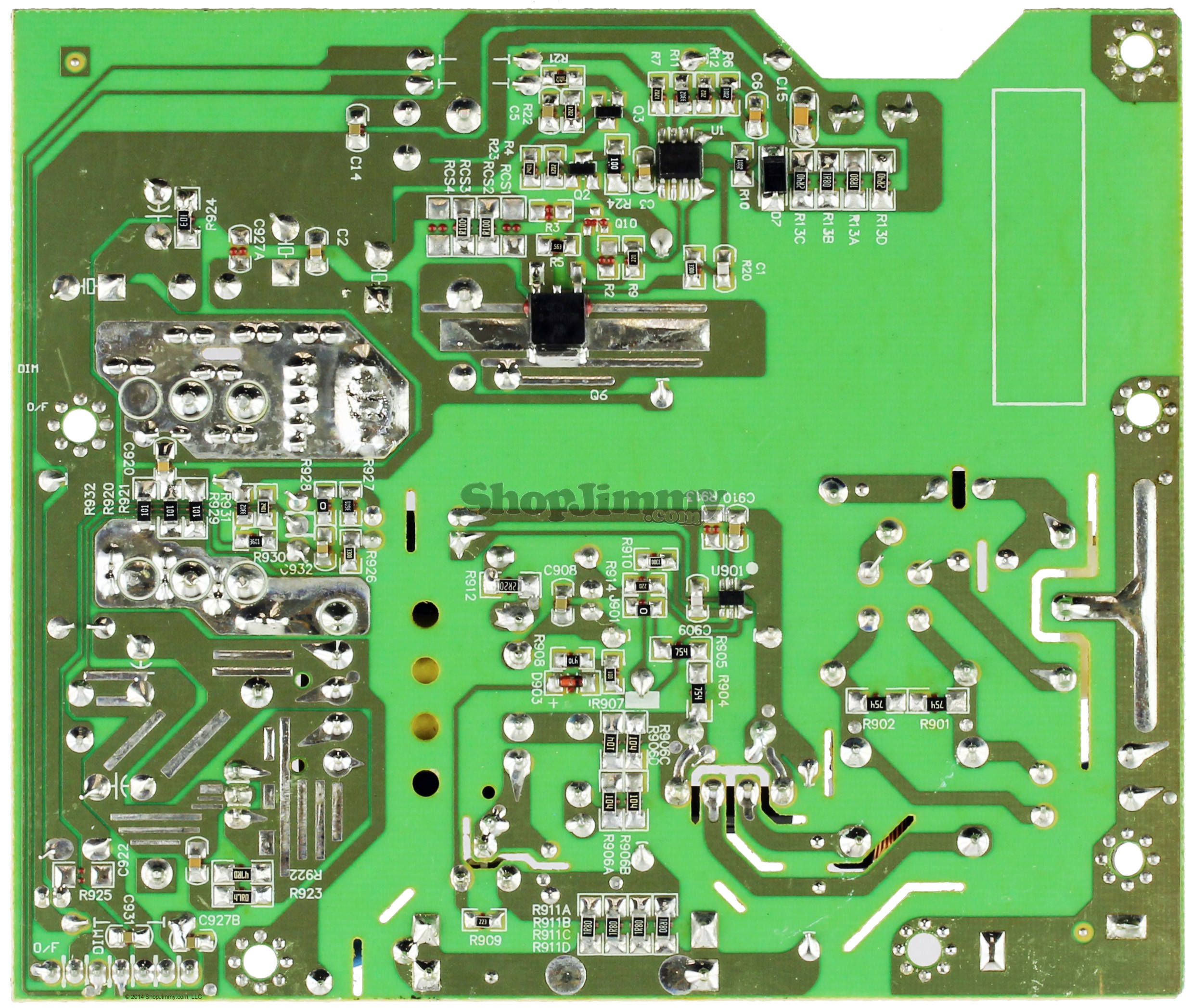

        can you upload a high resolution picture of the top of the whole PSU? Like this the pin numbers do not tell me anything.
          Re: Problem Source HKL-240101
          https://www.badcaps.net/forum/attach...3&d=1550514215
          Pin 5.- +4.85V is DIM control: OK
          Pin 7.- 0.027V O/F = BL-ON: BAD (if it is Active high signal type)

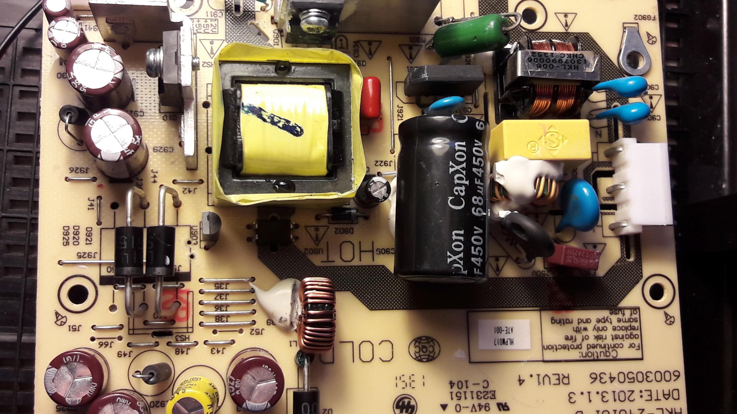

            CapLeaker, I send you a picture with the information
            that you request, I hope it serves you.
            The backlight LED strip is on the bottom of the
            TV and is composed of 60 led, of which the source feeds
            30 plus 30 in parallel.
            A greeting.

                    Unhook the main board from the PSU. On the power supply, take a 1k resistor and jumper STBY to the On Off pin. Plug the PSU in and all the voltage rails, plus the back lights should be on. If it doesn't work, take another 1k resistor and jump STBY to the DIM pin.
                    CN902 has a pin out legend that says what pin does what.
                    12V
                    5V
                    5V
                    GND
                    DIM
                    GND

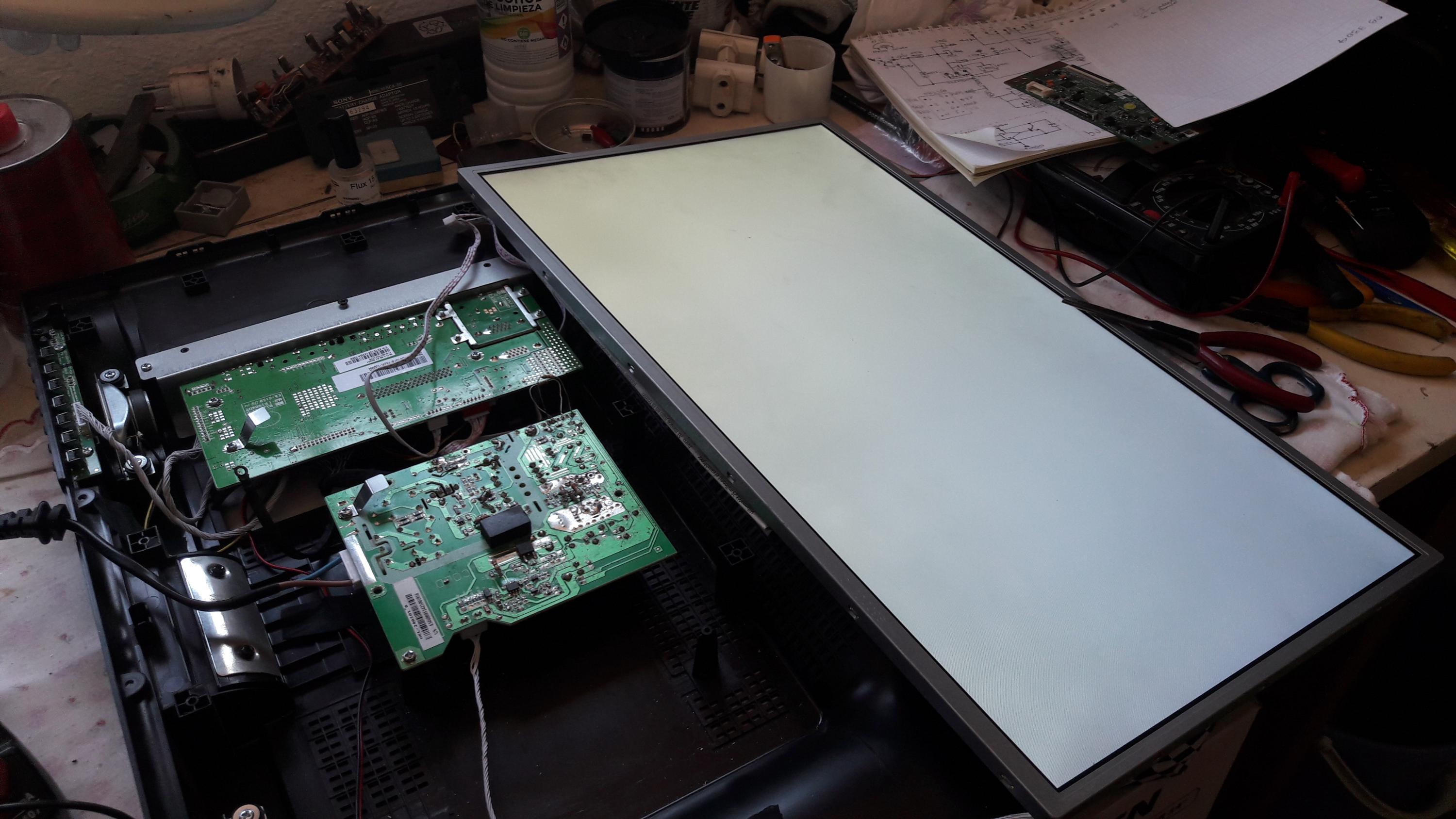

                        Hello Capleaker.
                        Back from my trip, I've done the test you tell me in the
                        post 8 (disconnecting the PSU from the source and putting the + 5v with two resistors in series of 1K with the pins DIM and On / Off). The result of the test is the one indicated in the attached file.
                        As you can see, the backlight LEDs turn off and on continuously and do not remain fixed.
                        Waiting for your opinion I greet you and thank you.

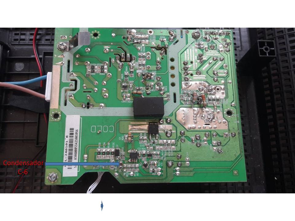

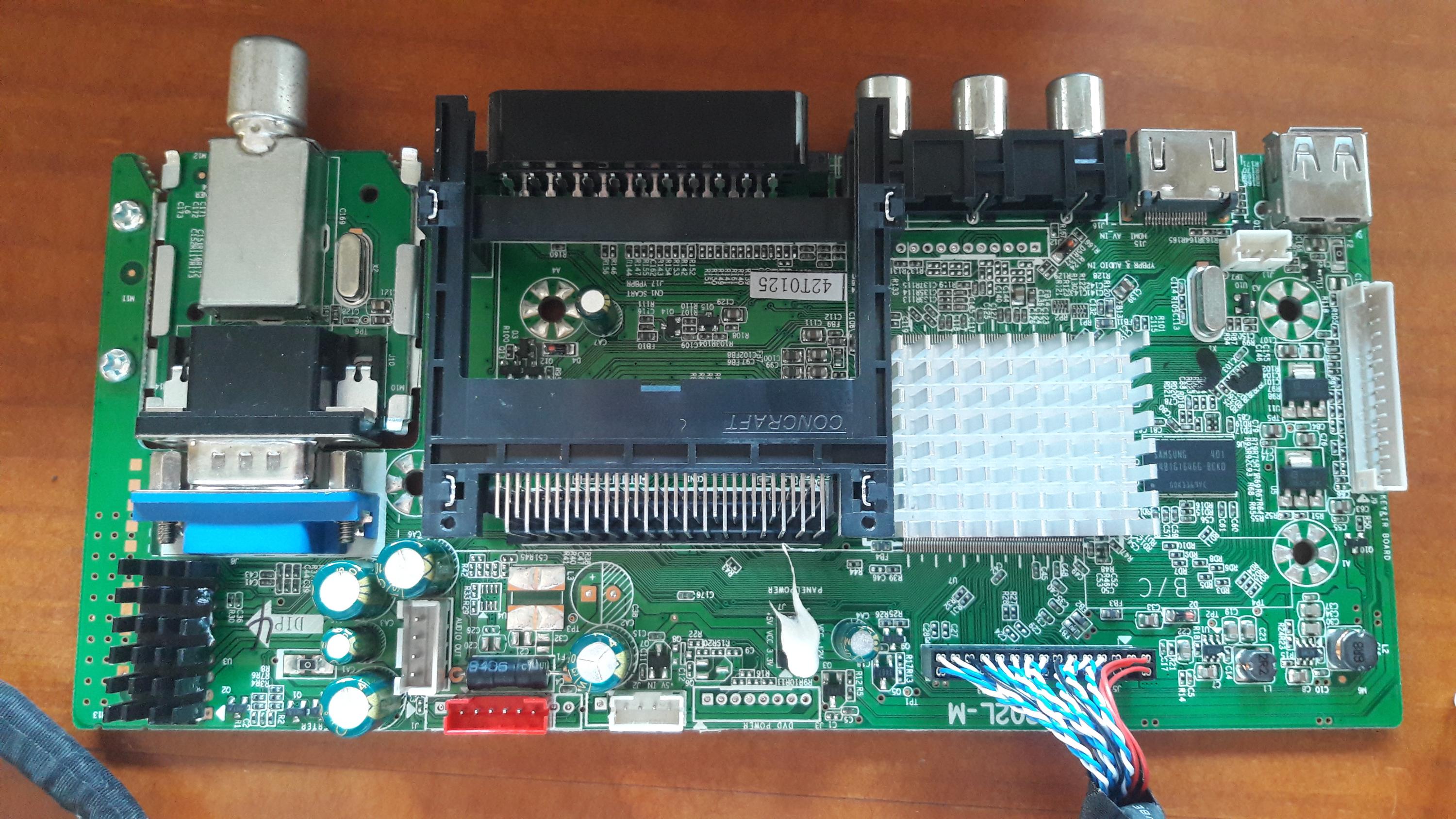

                                    Well I've already gotten the screen to turn on,
                                    I changed the smd capacitor, C-6 that goes with a resistor
                                    in series from 10k to leg 6 of the integrated circuit, U1.
                                    Voltages in integrated circuit, U1
                                    Pin 1.- 9.44v
                                    Pin 2.- 7.13v
                                    Pin 3.- -0.29v
                                    Pin 4.- -0.21v
                                    Pin 5.- 0v
                                    Pin 6.- 1.09v
                                    Pin 7.- 1.06v
                                    Pin 8.- 4.31v

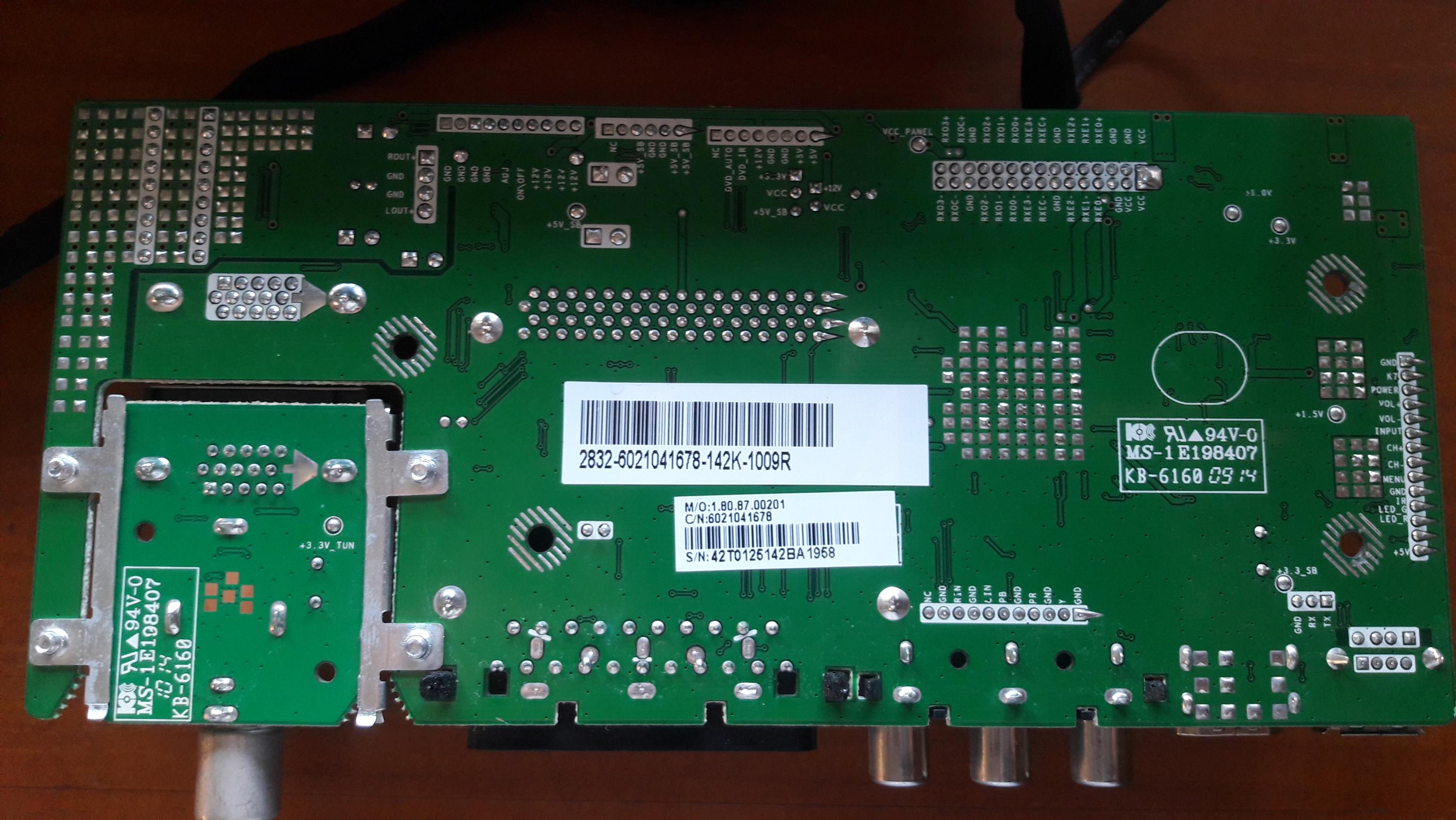

                                    I only have to diagnose, because there is no tension On / off of the
                                    main board to the PSU.
                                    In attached files I accompany photos of the palace, in case it has
                                    a diagram of it that provides it to me, to see where
                                    part tension On / off.
                                    Greetings and thank you.
                                    • CapLeaker
                                      Leaking Member
                                      • Dec 2014
                                      • 8351
                                      If I understand correctly, you have now the back lights, but there is no On/Off coming from the main board.
                                      Here is a little flow chart on how it goes: STBY voltage is sent from the PSU to the main board. On/Off signal would be generated on the main IC on the main board, once you press the power button on the TV. That On/Off signal would go from the main board to the PSU, telling the PSU to turn all voltage rails and back lights on. TV turns on.
                                      However, I do see a couple of LDO's on the main board that could prevent the main IC from running correctly. Also the power button itself, frimware and eeprom could do that. If the main IC on that main board is made by MSD followed by some numbers, there is a very high chance that this IC is bad.
                                        Hello CapLeaker.
                                        As you comment on the power on / off of the main board and the tests that I have carried out, I come to the conclusion that the Main Board would have to be changed.
                                        In view of which I do not deserve to spend what is worth that plate and therefore
                                        I leave this fault parked, until I find another waste TV that has the plate in good condition.
                                        Greetings and thanks for your interest.
