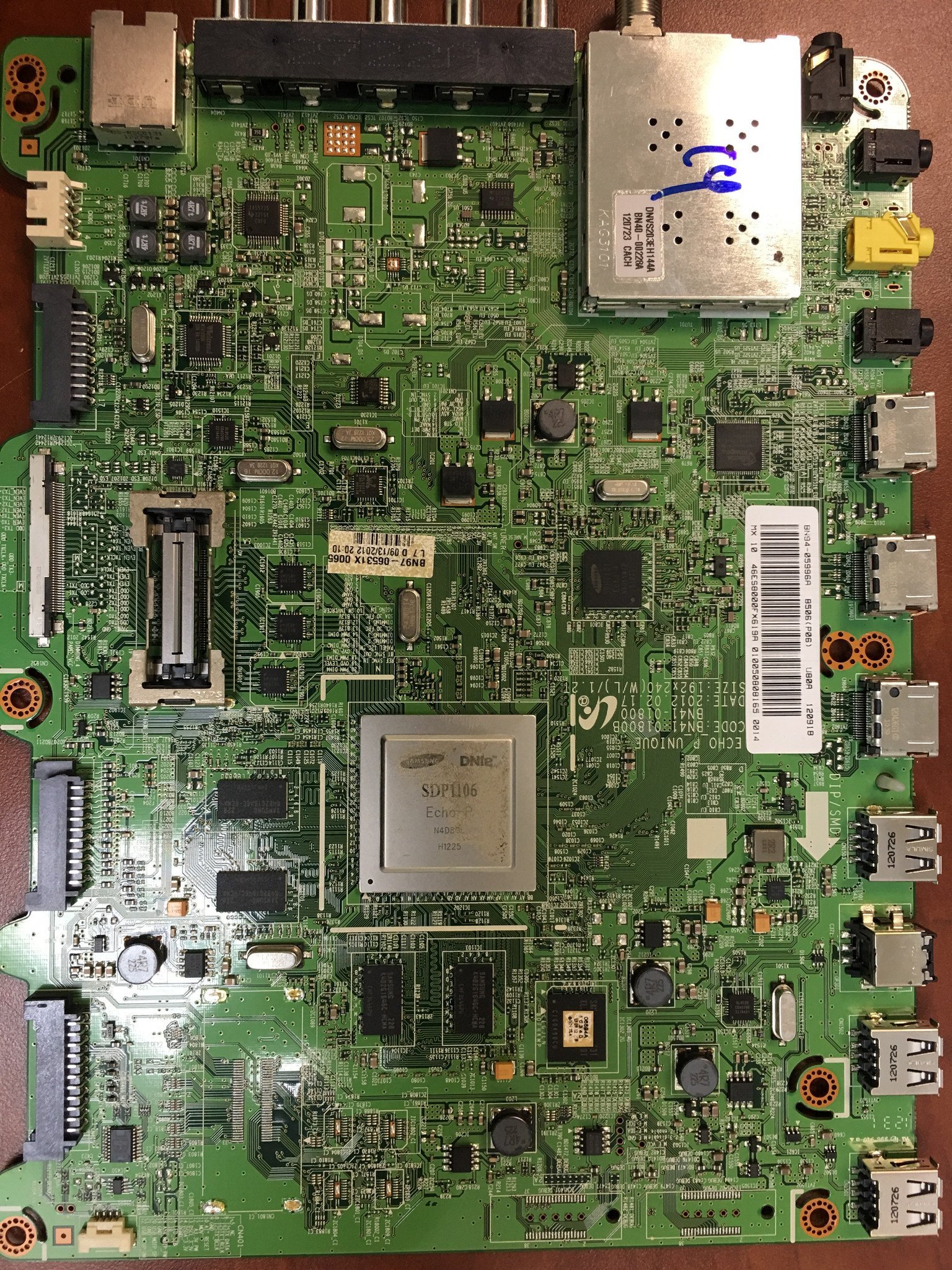

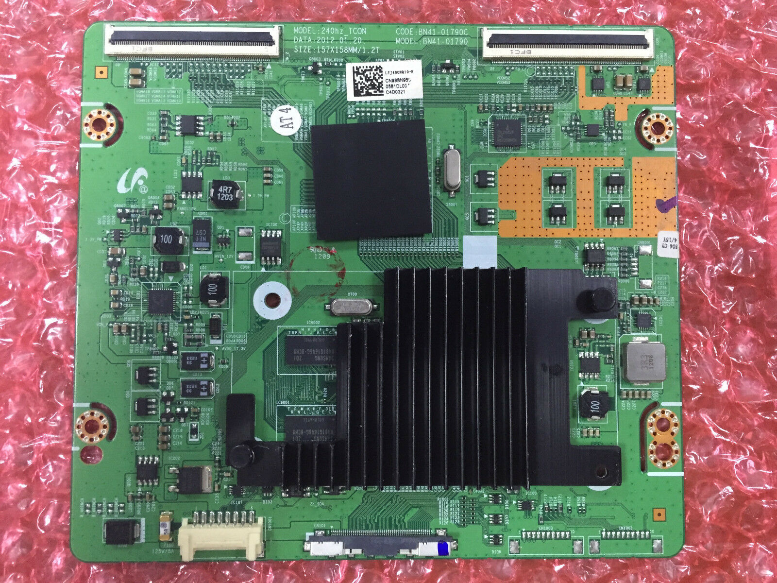

Hey got another free TV, fires up no problem but has just a black screen.. I got another TCON board but it just turns the screen white now and super super faint lettering that i can see.. any ideas where to look? power supply is 100% in spec.
UN46ES8000FXZA Black Screen

Please upload the pictures so we can see what we are dealing with, we do not have the TV in front of us to inspect.Never stop learning
http://www.badcaps.net/forum/showthread.php?t=24809 -
Re: UN46ES8000FXZA Black Screen
I also found this bulletin, but mine looks fine, ill test it when i get home tomorrow.Comment
So what does the pictures on the screen look like?Never stop learning
http://www.badcaps.net/forum/showthread.php?t=24809Comment
