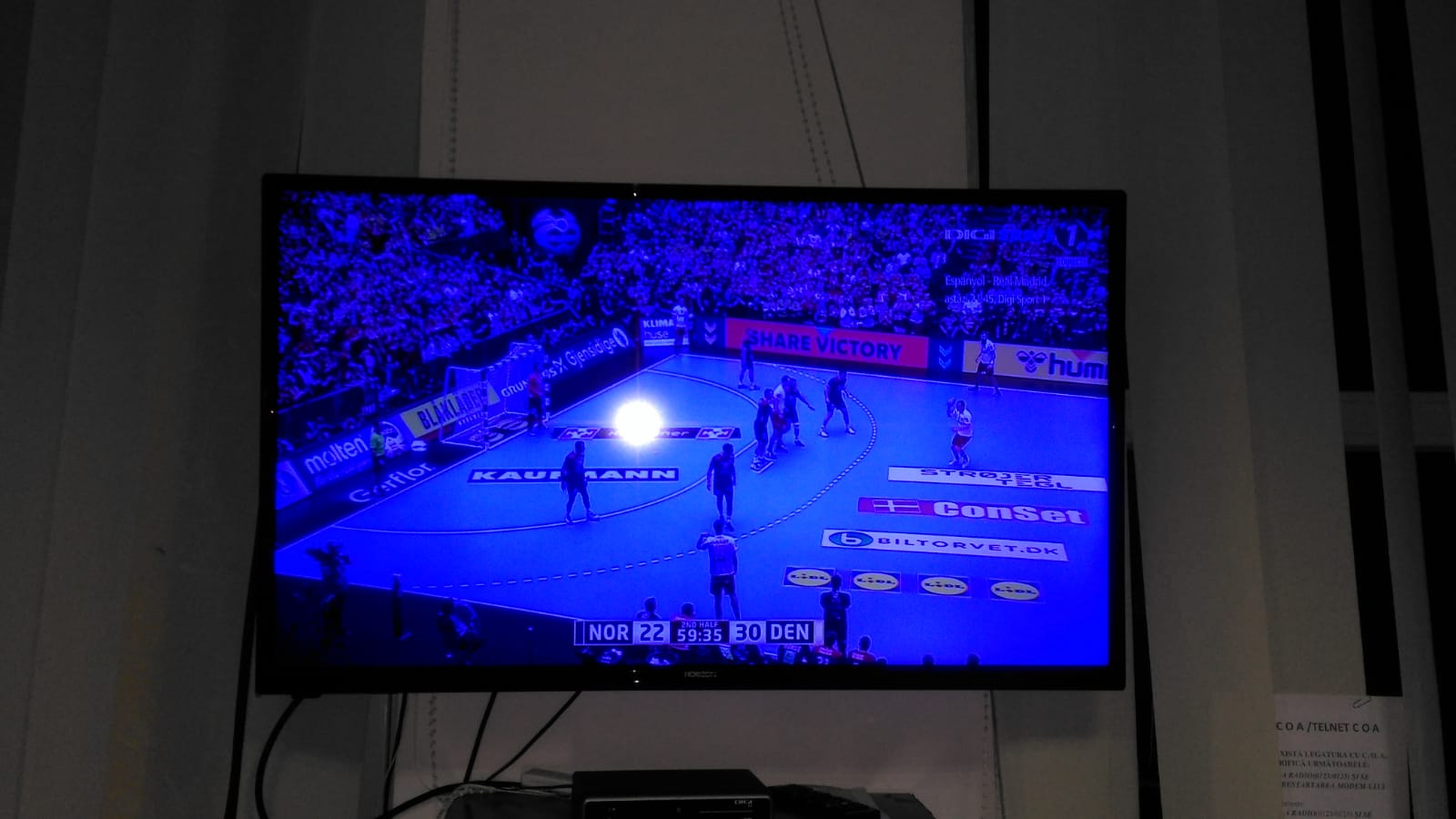

    Good day folks. Wow, seems like ages since I've done any work on a Vestel telly, but now a friend of mine asked me to have a look at his and since I'm a bit out of shape, I'd like to ask for a bit of help because I must admit I haven't yet encountered this issue: the picture is tinted blue (da-ba-dee), menus too ! Unfortunately I haven't seen this telly yet, so the only thing I can provide you is a pic of the defect sent by the owner himself. I don't yet know what board or panel it uses, but leaving that aside - would this be a software corruption that could be alleviated with a dump or is the panel to blame ?
    If it's the former, I could not find any useful resources anyway, so even if it were a firmware issue, obtaining it would be problematic in itself. Perhaps someone can lend a helping hand there too...any ideas ? Haven't seen this problem before. Cheers and thanks bunches !

    Check the leds

      Why would the LEDs cause the blue hue ?

        I don't know thats the first thing that came in my mind. I have had this issue few times with lg models. Also do a factory reset or a color test just to make sure before you take the screen apart.

          I'm not taking the screen apart anyway because I'm sure the LEDs are fine since there is backlight
          I'll first try the software route, since there's nothing else hardware-related that I can attempt...

            I have NEVER seen a bad firmware turn the image blue, but I HAVE seen the leds do such thing.
            If I were you I would do a factory reset and then take the screen apart.

              There have been quite a few posts over the last 12 months regarding backlight leds turning blue on this forum so Ducky29 may have a valid point.

                Hmmm...I guess that should be pretty easy to confirm: pop the bezel slightly off and have a peek under the screen to see if the diffuser is blue also...it would still be weird, especially since the blue is rather "deep", but it may not be impossible after all...

                    Interesting...not having seen the TV myself it's possible this one is in fact purple as well and the hue came out different on camera, although my buddy described it as "blue". No matter, I shall examine the LEDs still as it's a first for me...

                          It looks like it is missing Green Video.

                            Over time, the yellow phosphor will degrade and all you have left is blue light, try to get good quality replacement strips as some are poorly/cheaply made.
