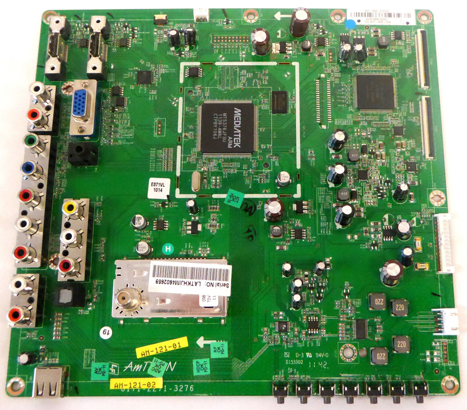

    I have partially fixed my dead Vizio E371VL. After many hours of checking all the components and soldering, I have normal TV stations and sound, BUT an unusual remaining problem that I am hoping my fellow cappers can help solve.
    My Vizio model E371VL will turn on every time and display TV channels, with audio, as normal, ONLY when there is a VGA or HDMI device plugged into the back of it and powered on. Once the TV is turned on a TV channel and working like normal with video and audio, it will continue to work until I turn it off. Once turned off, if the VGA or HDMI device plugged into the back is no longer powered up, the TV will power back on (white Vizio in bottom frame) with no back lights and no video display but only audio playing from the TV channel. What might be the remedy to fix this odd behavior?

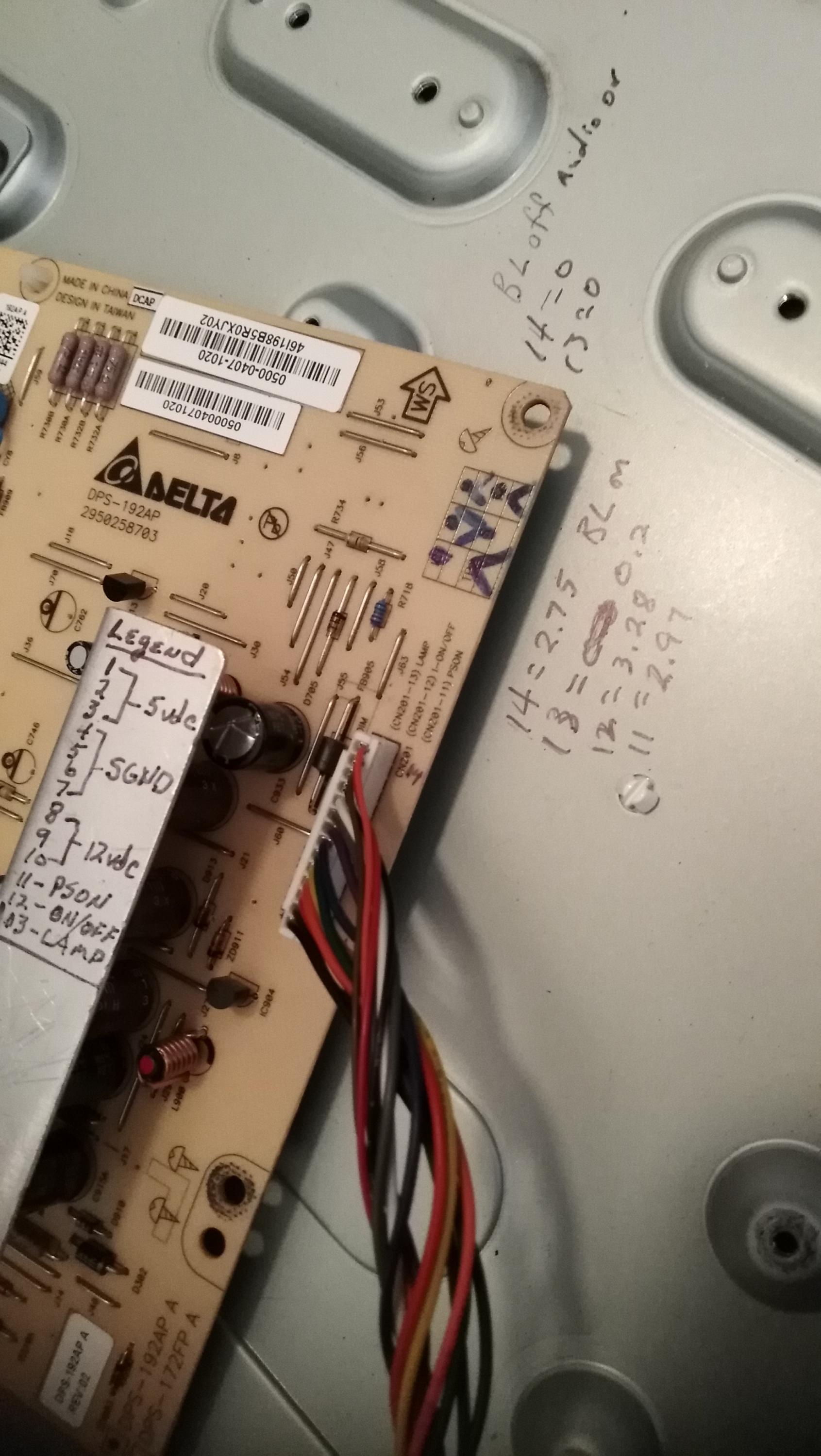

                      So I starting thinking it is on the PS.......so help me out with this logic. I assume when I plug the 110vac in, the pinouts on the PS should only show the standby voltages of 5.3 vdc. Then pushing the power button, sends a signal from the MB to the PS to turn on the PS and the 12vdc circuits show up. And that is what happens. But, there is no voltage on the LAMP pinout of the PS. My question is (duh), does the PS PLACE the voltage signal at the LAMP pinout of the PS or does the that voltage come from the MB? Pls tell me how the LAMP voltage originates so that I can look for the fault in the right place......either in the PS or the MB.
                      There is another PS pinout#14 that is not enumerated. Does the MB send a signal to the PS to turn on the LAMP pinout, thereby initiating the high voltage transformers to power the BL? The more I think, the worse it gets.........
                        Re: Vizio Symptoms and Possible Solutions
                        Main board sends out PS-ON, BL-ON, DIM control signals (steady state LO or steady state HI). Check Voltages on the main board as indicated.
                            The EDID EEPROM IC voltages are 3.25
                            will start checking individual Voltage regulator IC's on the main board
                            I will do the "blank vga plug" test next
                            Currently, noting the PS pinout voltages on 13 and 14, when the BL is initiated using VGA input (then unplugging VGA while running) with everything normal inc audio, the 13 pin shows 0.2 vdc, the pin 14 = 2.75 vdc.
                            Powering off the tv then back on w/o the VGA results in no BL (picture) with working audio from the channel previous on. Then, pin 13=0vdc and pin 14 = 0 vdc.
                            I assume the pin 14 is the dimming? The PS pinout legend is :
                            1-3=5vdc
                            4-7=SGND
                            8-10=12vdc
                            11=PSON
                            12=ON/OFF
                            13=Lamp
                            there is no designation for pin 14

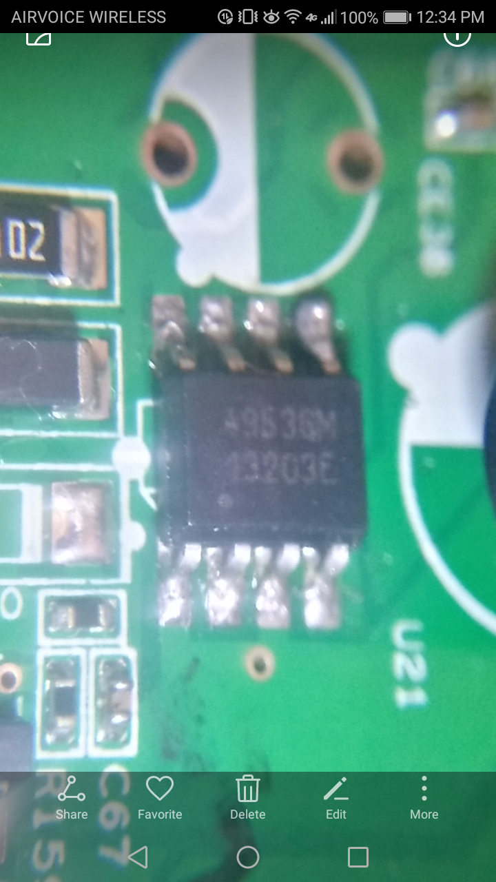

                            Tracing pin 14 on the MB leads to U21. I need help identifying this IC. pictured. On that IC I read 4953GM and 13203E.......
                            google says 4953GM Clock Synthesizer / Jitter Cleaner | Mouser..........doesn't sound like that could solve my issue......?
                            thanks for all the help

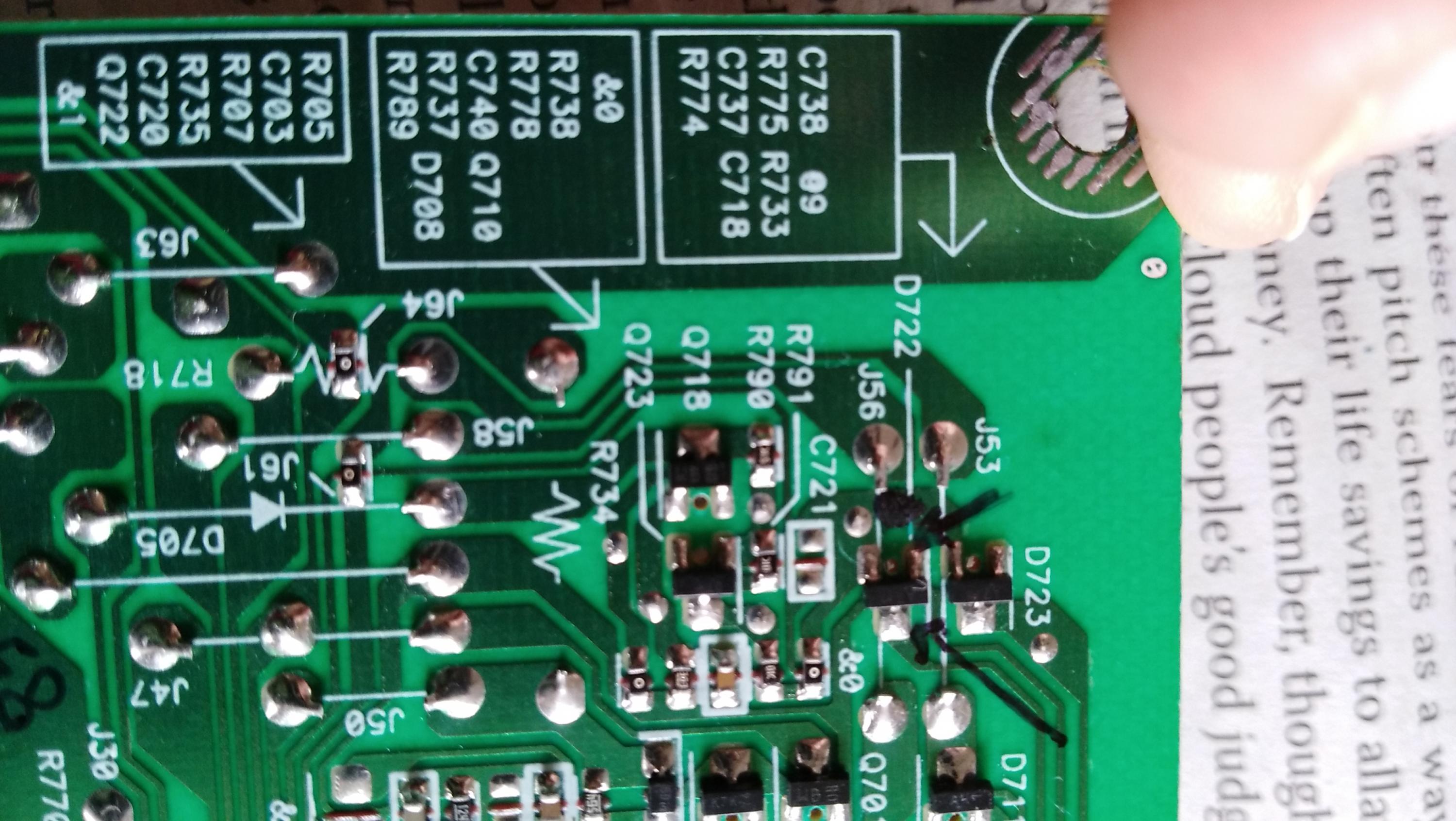

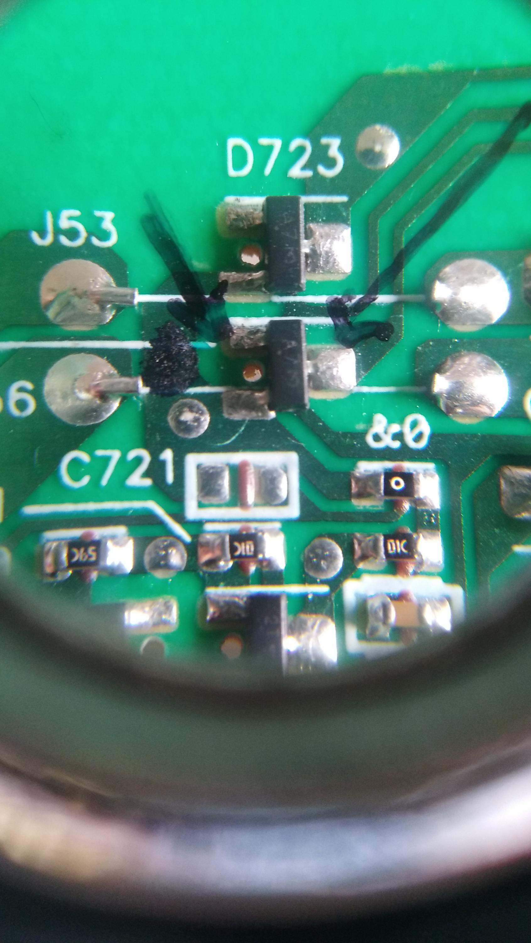

                              Consider this. Do I need to take this out of circuit to test? This is the only one of this type that has a short to ground. Sorry but I do not know what this is, pls tell me how to find or what to substitute. In the pics here this shows short to ground as indicated by the black arrows. The only designation on the top is A7 then a perpendicular 3.
                                You to be clear as to which pin of the 3 pins is shorted to GND. What are the resistance readings for each pin with ref. to circuit GND?

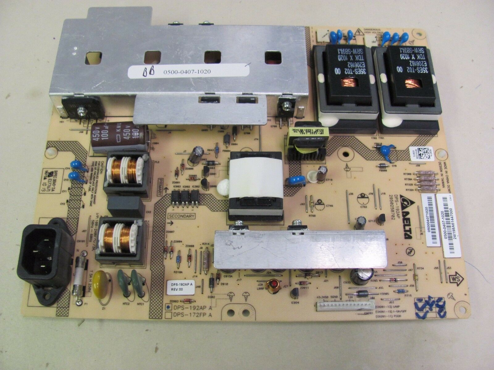

                                  Vizio 0500-0407-1020 Power Supply / Backlight Inverter
                                  https://www.shopjimmy.com/vizio-0500...upply-unit.htm
                                  https://assets.shopjimmy.com/media/c...1020-top_1.jpg
                                  DPS-192AP A
                                  11 PSON = PS-ON (input)
                                  12 ON/OFF = BL-ON (input)
                                  13 Lamp = Lamp Error (output)
                                  14 Dim = Backlights dimming (input)

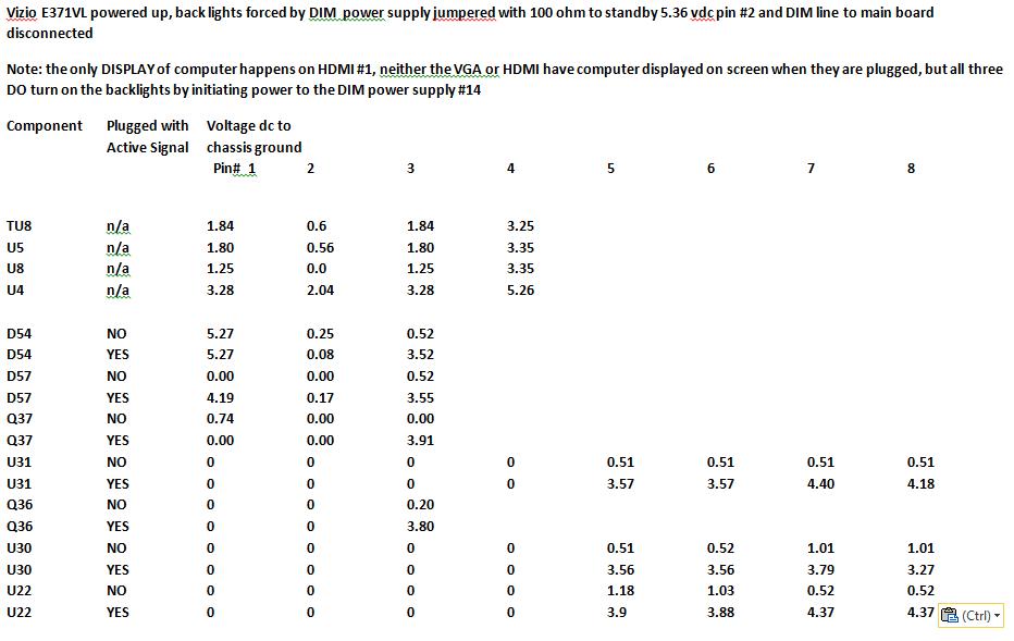

                                      You still did not show us what the Voltages readings are for the Voltage regulator IC's, Voltage around HDMI IC with and without HDMI source connected.
                                      You can also try removing the Dim wire going back to the main board first then force the Dim pin on the power supply board high using 1K resistor between Dim pin and 5VSTBY pin.

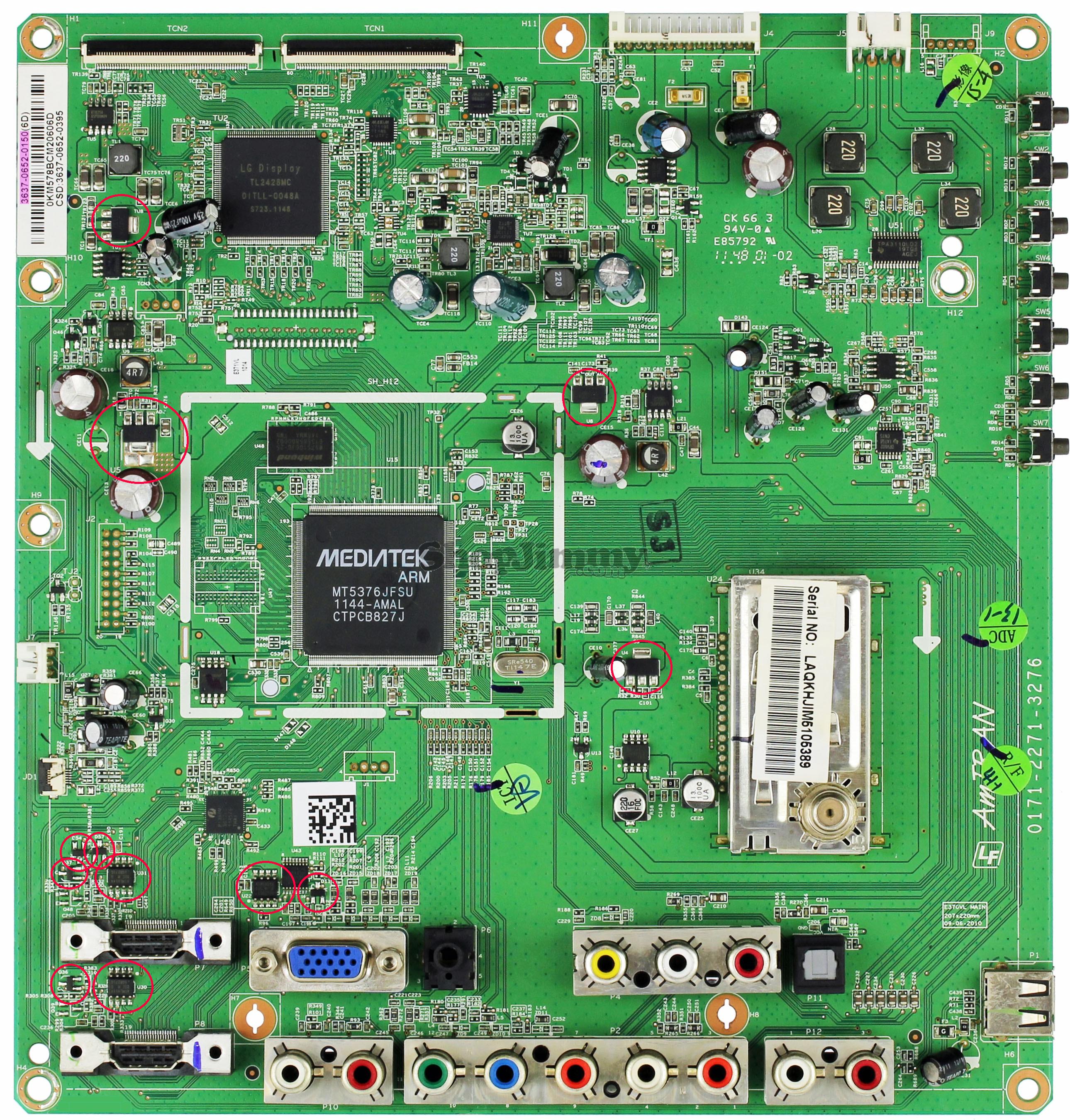

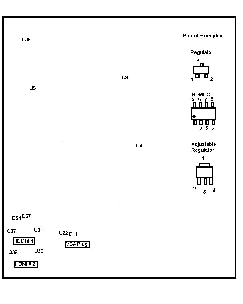

                                        Thanks BudM for the direction. Forgive my component miss naming.
                                        Pls see the attached voltages as directed. Did I get it right? The ICs tested are circled in red. See the table of voltages and general layout to speed things along.
                                        @budwich, thanks for the idea but it tells me nothing cause I cannot tell where this will lead. Pardon my lack of insight. When I plugged "blank" vga connector (ie. no wire connections, ensure no pins are connected). into the set it did not start the backlights and made no difference. Changed cables and nothing else. I could swear I saw the computer display on the TV when I first started with plugging the vga, but since the TV is face down and I put the mirror up awhile back I may have forgot things, or just dreamed them ......getting old is not for sissies....sorry....any more ideas?
                                        @capwizard, thank you and I am still thinking on changing the EEPROM, but the guy that tossed this must have already done that because of his lousy soldering job.......so I am figuring that if it works well after I get the BLs on by using a plugged HDMI or VGA device, it is probably not the EEPROM......what do you think now?
                                        TU8, U5, U8, and U4 are 1117 regulators, U31, U30 and U22 are designated as 402N
                                        Updated
