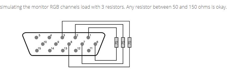

                I am not an expert on vga connections outside of some frustrated "effort" with trying to get a samsung dlp to talk to a PC. :-( In my travels "there", I found that not all vga cables are "equal". First, some do not have all pins wired. So, some metering has to be done to check end to end to see exactly what is wired in the cable. Next, some pins are internally wired in the connector as opposed to using end-to-end wires... these usually deal with grounds. further related, some have "grounding" associated with the connector housing while others do not and use the terminating equipment to "complete grounding" in various forms to allow the signalling. Lastly, there is voltages applied by the orignating / source equipment to get information (start exchanges) about resolution capability.
                The tests that I suggested... first a blank vga plug (you buy these to build a cable). This plug would have no pins connected so no grounds would be connected except for maybe in the equipment that it plugs into. Thus, if your backlights don't come on and basically the tv doesn't start in this configuration, that would indicate that the vga "jacket" in the tv is not making any kind of grounding connection thru the body of the "blank connector plug". Which I think is what you indicated although I think you may be not be thinking about a "blank connector" versus something not plugged into the vga connection on the tv... those are two different things.
                Next, when you plug in a cable but not into a pc, it is possible that the makeup of the cable is providing a variety of grounds within its make up. You didn't appear to do this as you already had the cable connected to the pc. The tv "started up" and "worked" but wasn't able to display the pc. It is possible that depending on the resolution setting, the system wasn't able to "negotiate" a resolution or possibly even start the exchange.... it could be even that some form of "sync" signal (in vga land) was not available.
                It would appear that you are missing some form of ~5v in your mother board that is preventing some detection circuits from functioning until that voltage finds its way there via an external source.
                Further, because some of your hdmi stuff doesn't work also, would give more credence that ~5v has an issue as hdmi uses that voltage to read the "sink" (display) capability to setup the hdmi resolution (and other things). When you plug into the "non-working" hdmi ports, do you get any indication that the cable connection is there but no signal or no acknowledgement of a cable. Some tvs grey out ports that are not "valid" while others don't seem to followany convention (ie. show all ports whether they are connected or not)
                Lastly, I only suggested these tests to maybe help focus where to look in the circuit to find a problem (ie. grounds versus voltages and associated componets). It would still appear that the main board is the problem and perhaps you don't need to do more than replace it.

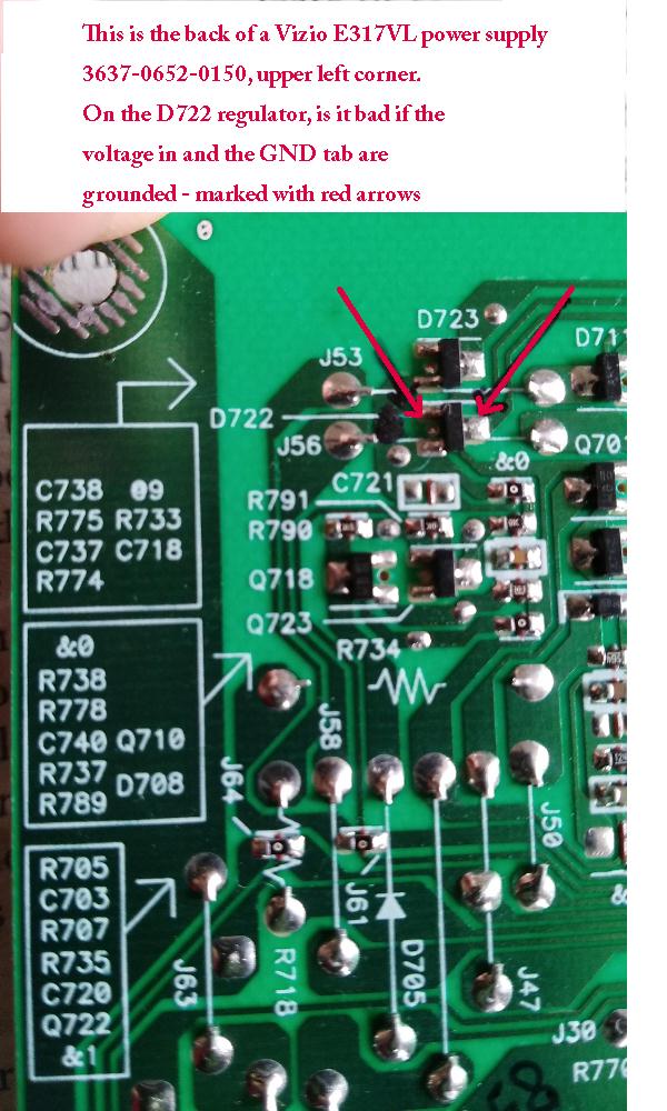

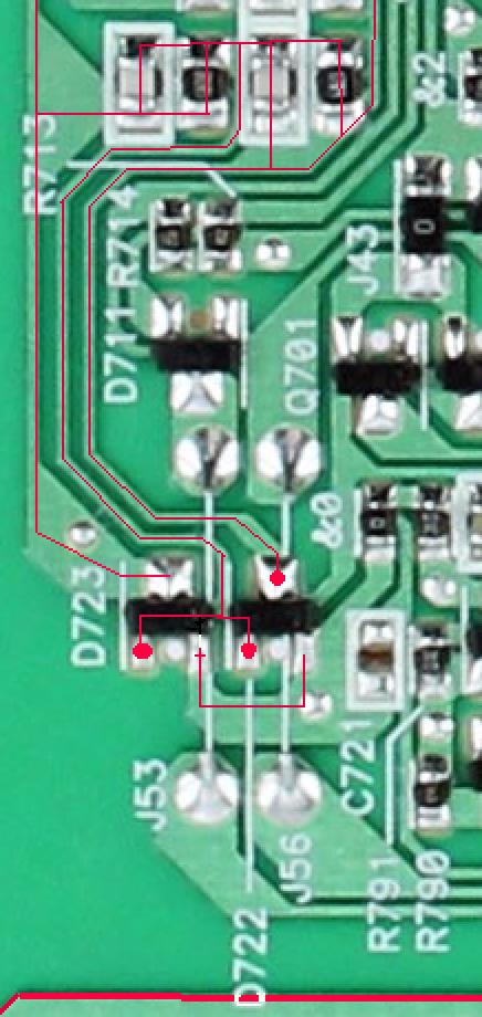

                      Please help this blind squirrel find his nuts. I do not know, and am hunting what I perceive as an issue on my power supply board. I have, what I think is a high speed switching diode with the marking of A7 3, where the 3 is horizontally enumerated. If it is what I think it is, it could be in one of three internal configurations....see the first pic attached(the config on the right in the first pic is what I think it is?). The second pic is from earlier, identified on the board as D722, and is what I am talking about herein. The last pic is of the entore backside of the 0500-0407-1020 power supply, with the D722 in the lower left corner (placing it on the secondary side). What is this and is this EVER supposed to have ANY of its 3 contacts going straight to chassis ground?

                        1) I do not understand why you call that diode regulator and call one pin Voltage in.
                        If you trace out the connection you can see that one of the pin is connected to GND.

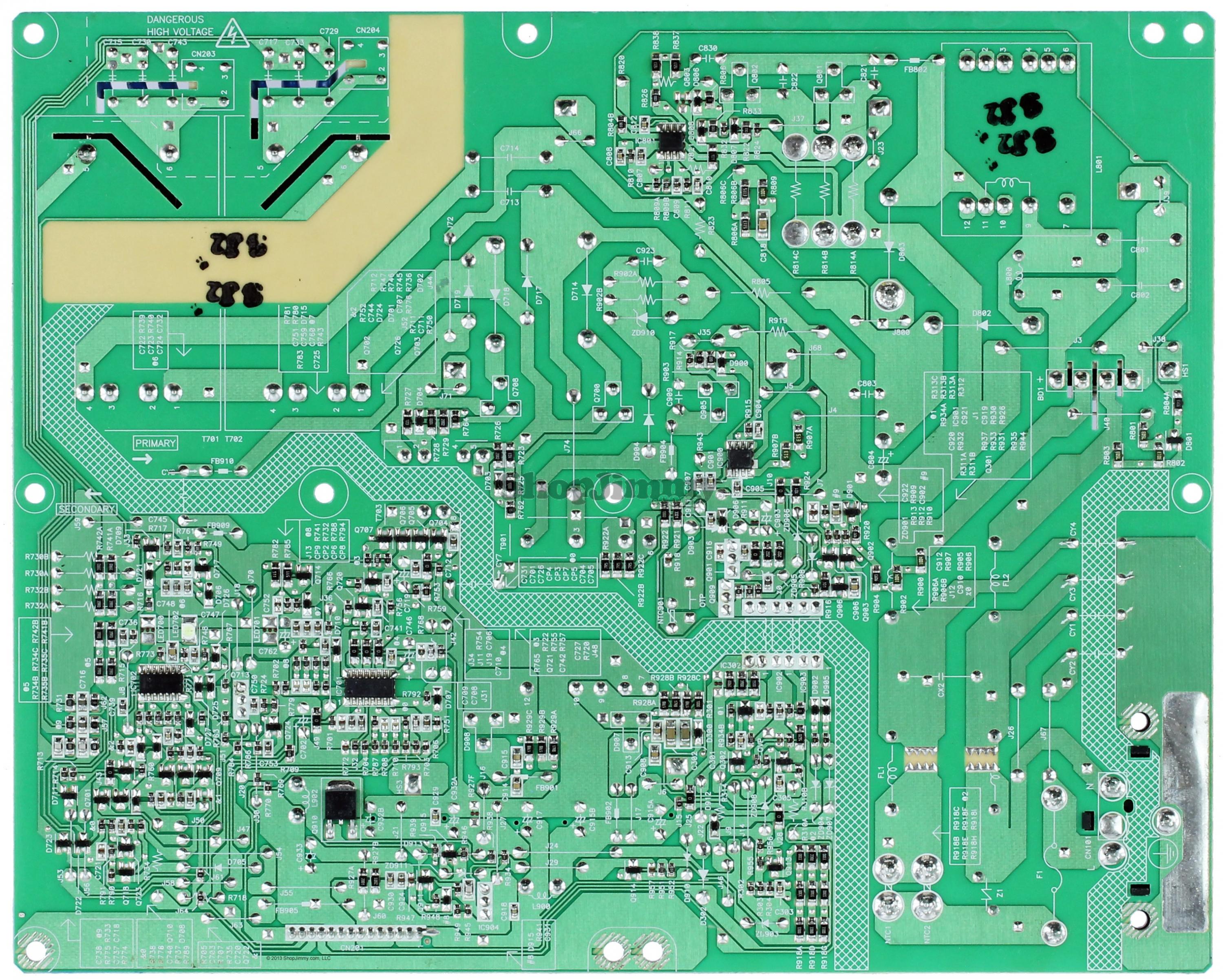

                        2) I do not understand as to why you are looking at the power supply board.
                        3) That is backlights inverter section, if it does not receive the BL-ON and Dim signals from the main board then the backlights will not come on, you can force on the backlights by using pull-up resistors to prove that the backlights circuit is OK.
                        4) You did already hot wire the Dim and get the backlights to come on, did you not?" from your post: "discovered that when I jumper the power supply (PS) pin 2 to pin 14 with a 100u resistor, and #14 wire between the PS and MB NOT connected, and push the power button, the BL come on and the TV audio channel is playing, but the video is NOT there."
                          #32
                          Re: Vizio Symptoms and Possible Solutions
                          Ok, I guess I got to let the D722 go. Both it and the D723 are the same designated component that must work in tandem somehow, unbeknownst to me to figure out, but together must switch on the high power transformers to provide high power to the LEDs and BL thru C743 (grounded to chassis) and C729 (not grounded). See red tracing. Red dots indicate ground to chassis at those points. So, I am guessing the command signals go into C729 and back out C743.
                          I was ready to declare the mainboard (MB) defective, until I unplugged the DIM wire at the MB and saw the DIM output of the power supply (PS) go to a normal 3.03 vdc. Therefore, I got side tracked by assuming the DIM signal did NOT emanate from the MB....and started looking for issues on the PS again.
                          Even when the DIM wire was NOT connected at the MB, I could still adjust the backlight (BL) levels using the remote. If I knew a little more, I might figure this to the component level. No joy, nothing fixed or determined.

                            Just think about it, you are able to get the Light source (CCFL backlights (your TV)) to come on but you still do not have image on the screen, the light source is there so you can easily see the image on the screen. Light source can be CCFL, EEFL, or LED.
                            So at this point you can have backlights but no pictures but you can have picture if you have the TV connected to active VGA or active HDMI which points the problem to the main board but the exact cause of the problem we do not know yet.

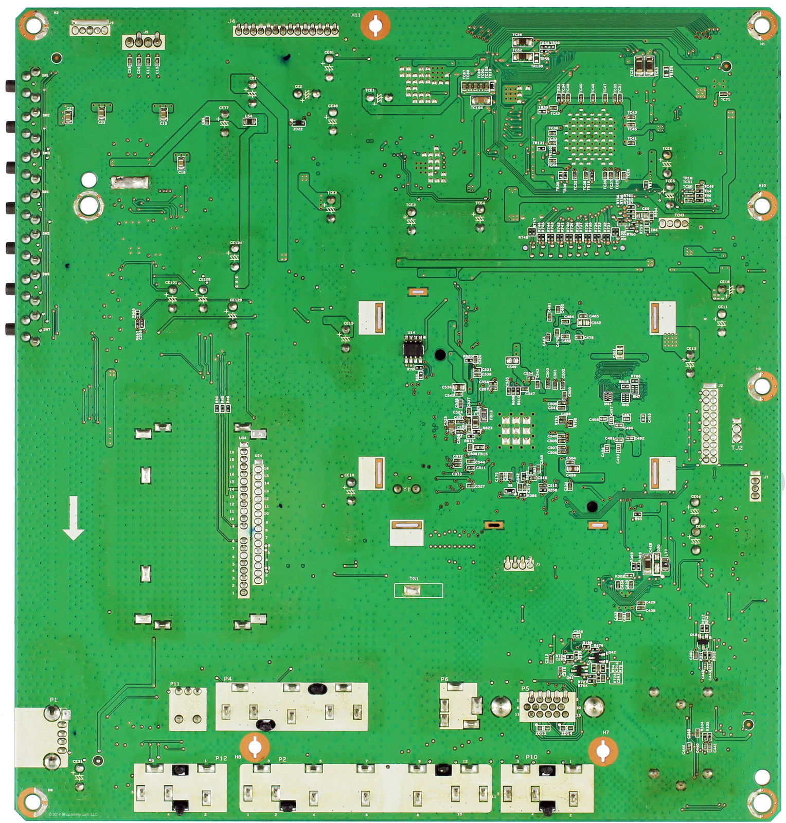

                                As others have suggested, Mainboard is likely the problem and Power Supply is likely not the problem.
                                Specifically you have a missing voltage (like 5V) or a missing ground that is being fulfilled by using a VGA cable or HDMI cable when the other end is connected to a video source.

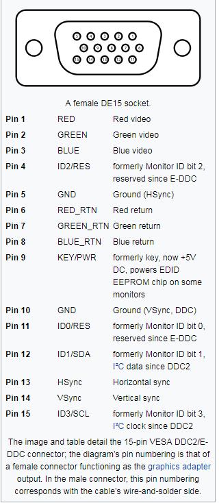

                                Instead of using a laptop or computer which can have resolution or display handshake issues, can you use the HDMI output from a dedicated video source like a Blu-Ray or DVD player? It is much easier to sacrifice a $25 DVD player than risk damaging an expensive laptop or PC video card for such testing.
                                Connecting a bare VGA cable, or a bare HDMI cable has no effect, so it's unlikely a missing ground, and more likely that the PC or device connected with the VGA cable or HDMI cable is providing the missing 5V.

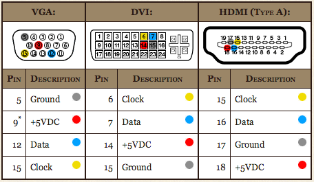

                                See attached diagram. In VGA, Pin 9 is 5V. In HDMI, Pin 18 is 5V.
                                1) Try measuring Pin 9 (VGA) and Pin 18 (HDMI) on the mainboard without any cables attached.
                                2) Try measuring the same pins with the HDMI cable attached to a video output device.
                                MEASURE CAREFULLY AND AWAY FROM CONGESTED CONNECTOR PINS. 5V and GND are adjacent on HDMI connector and can be shorted very easily if your probe slips.
                                My bet is that you are missing 5V somewhere.
                                It's even possible that you have a defective HDMI IC which allows one HDMI port to work, but not the other. Or possibly a 5V line that supplies the HDMI IC, etc.

                                    Thanks Unspun01,
                                    You got me thinking again and back tracking.
                                    I have previously, partially done as you advised and got:
                                    So, I began checking voltages at the some of the VGA pins, on the MB.
                                    With the VGA (with active vga signal) plugged into the VGA port and having normal audio, video and sound:
                                    pin 12=4.39
                                    pin 15 = 4.40
                                    pin#4=0
                                    pin# 9=4.56
                                    pin#14=0
                                    pin#13=4.4
                                    Then without the VGA plugged, but with the video, audio and BLs running, the VGA pins were:
                                    pin 12=1.22
                                    pin 15 = 1.08
                                    pin#4=0
                                    pin# 9=0.47
                                    pin#14=0
                                    pin#13=0
                                    The above only told me that the VGA pin 9 was supplying the 5v, and that is what is coming from the computer plugged vga cable.
                                    So I guessed I need to chase the VGA 9 pin trace and check the components there on, but I failed to find the culprit. The MB is hard to trace (unlike the PS), and I have not found a schematic for this MB.
                                    I guess the failed component is a gate of some kind with a hi - lo signal.
