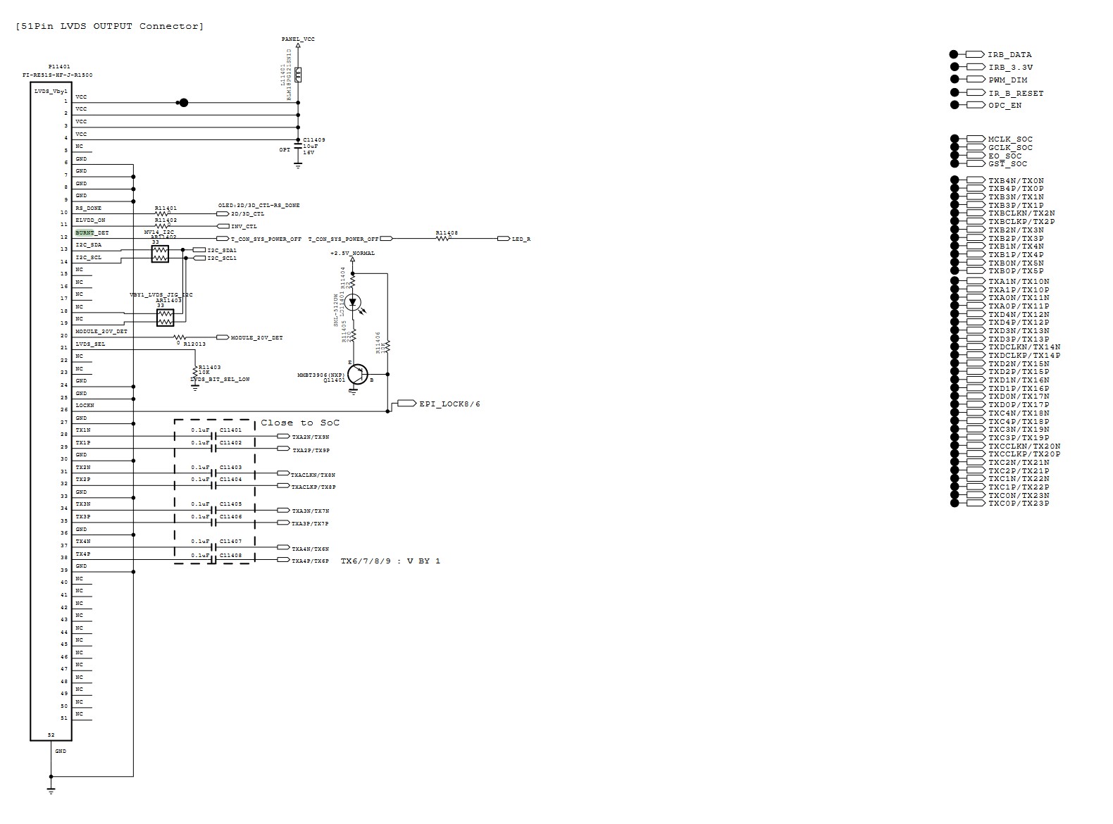

            BTW. Disconnect LVDS cable and TV should turn on or it's a MB Or A Psu issue

                  @tmaster21 ahh, sad to see your screen defective.. :/ but you can bypass it, to turn the tv on with broken panel. on the LVDS there is a pin "BURNT DET", i blocked this pin and then i could start the normally, then i saw on my tv the loading screen two seconds with stripes, then screen went black.
                  here is service manual with the LVDS pins

                                          unplug the EVSS 24V block from PSU side... and send In_Stop when TV go to STBY plug it out from wall for 10 minutes to discharge and put back EVSS socket then turn on
                                          you can also run PSU and T-CON driver bords and OLED as standalone state... it could show you the effect if the OLED defekt
