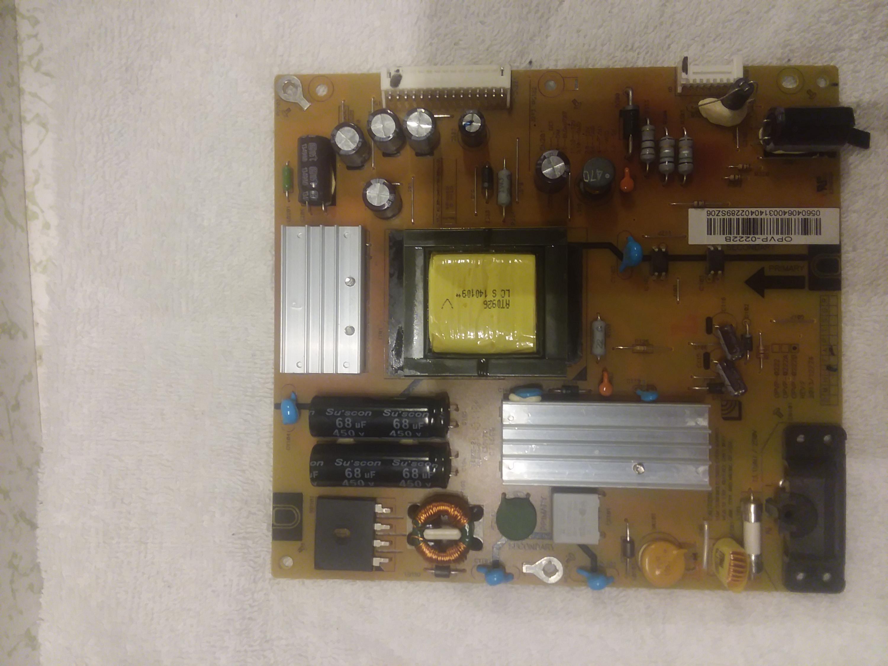

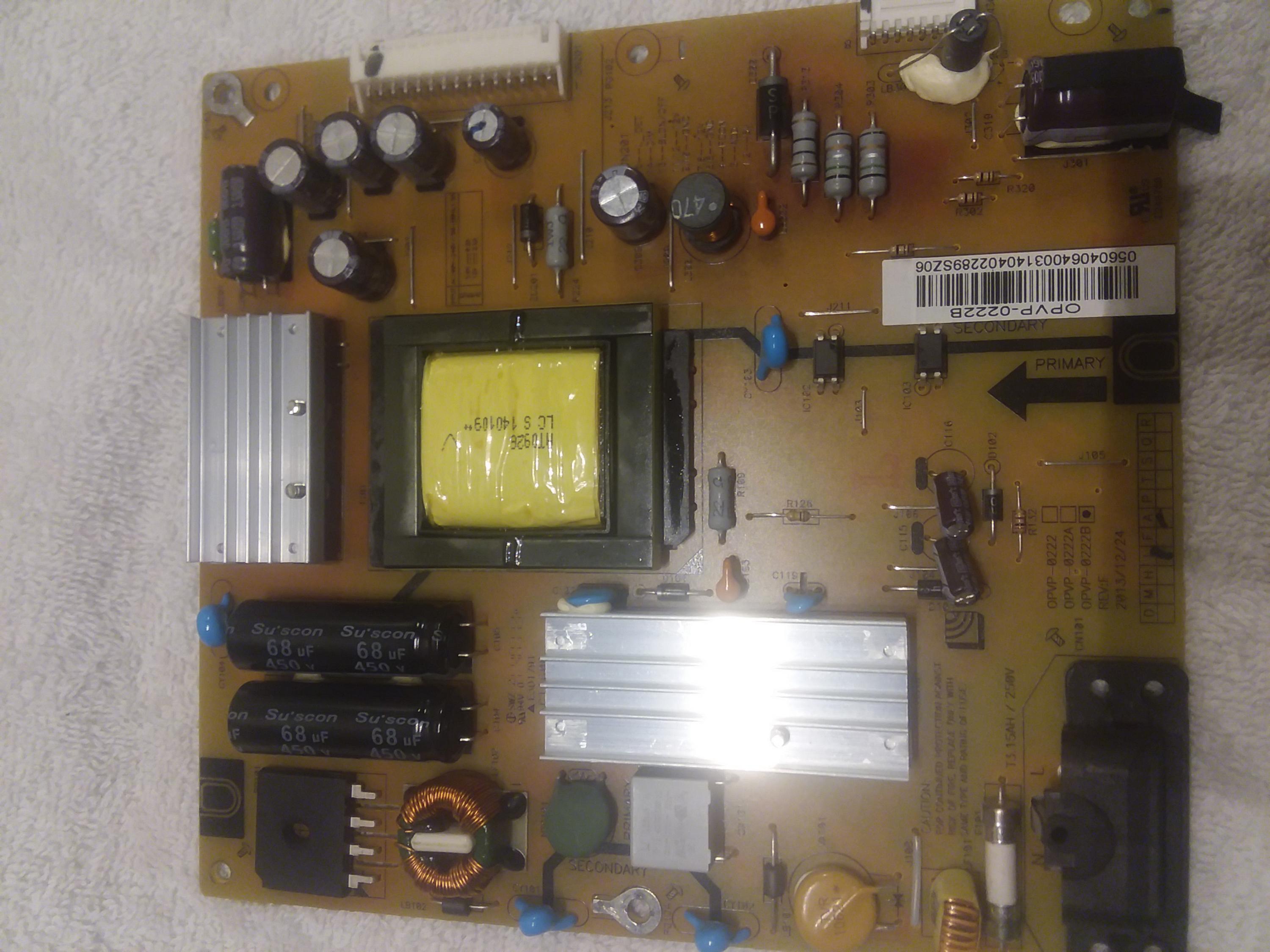

    VIZIO E320FI-B2 dead no standby voltage

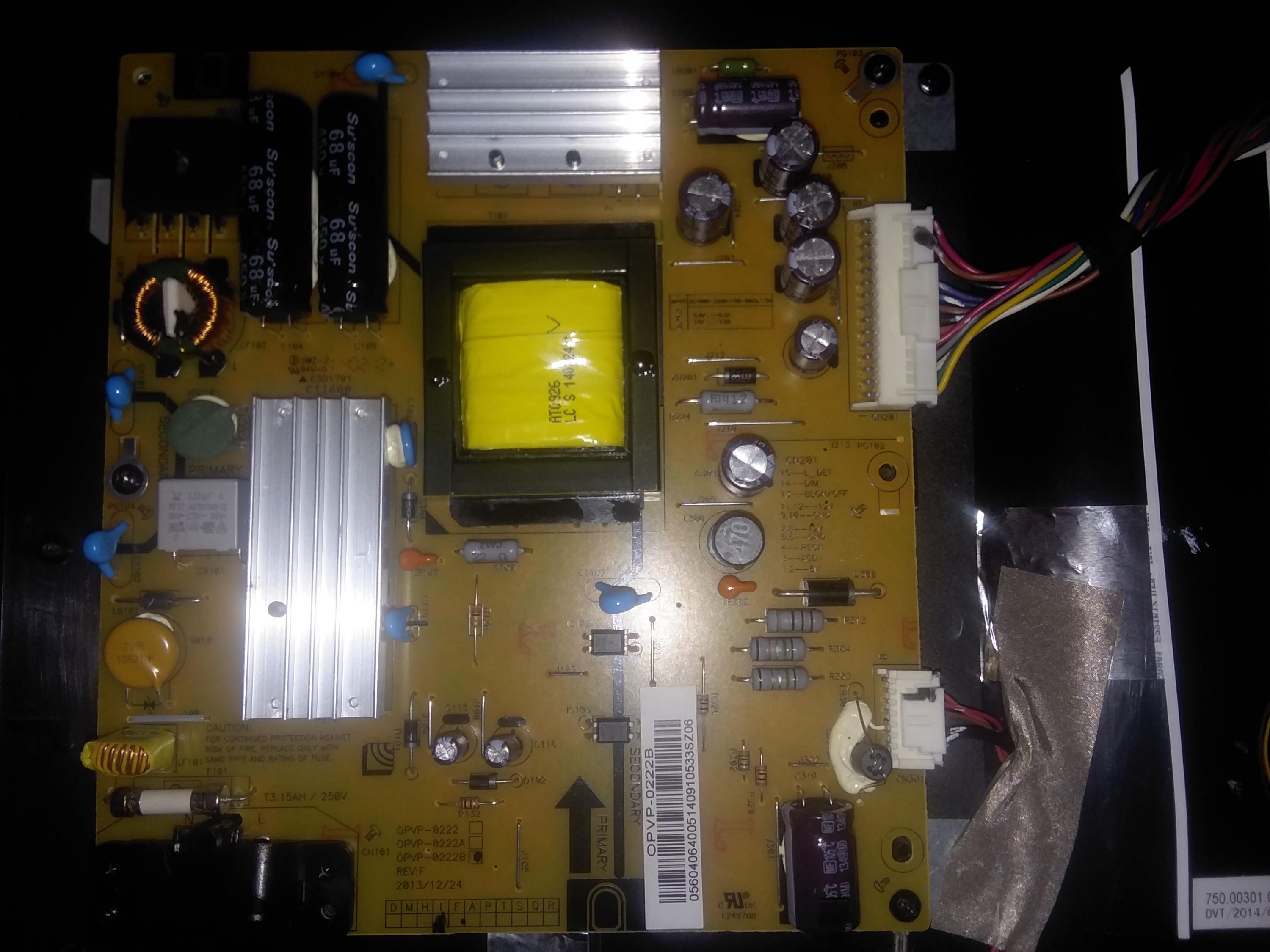

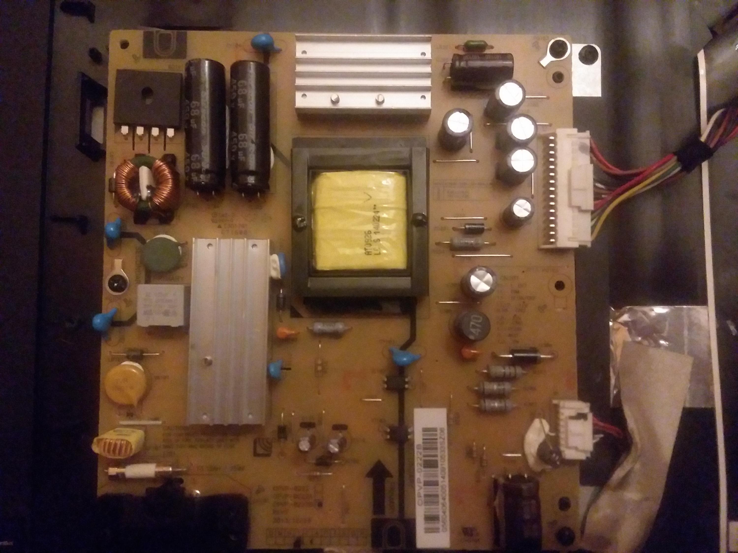

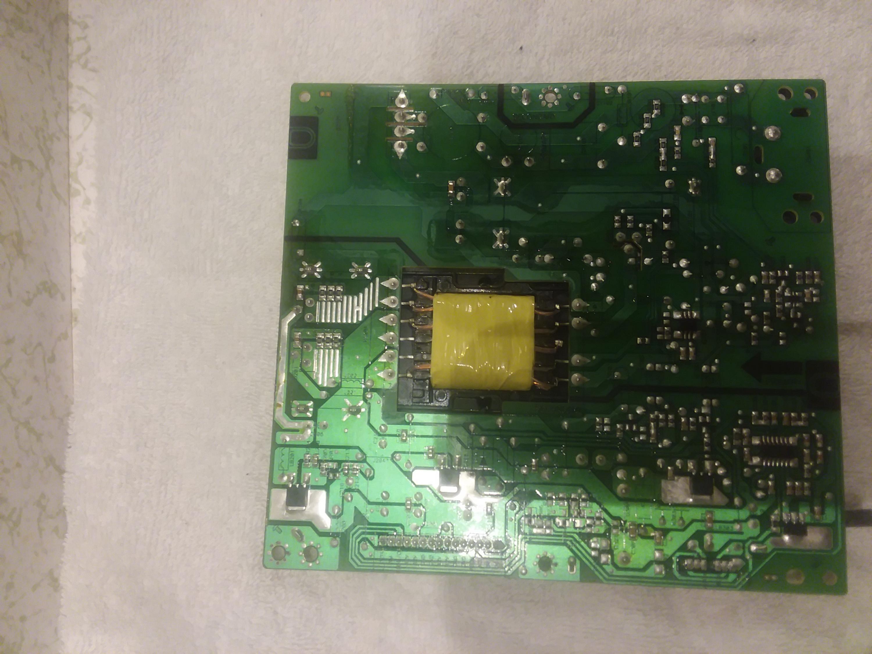

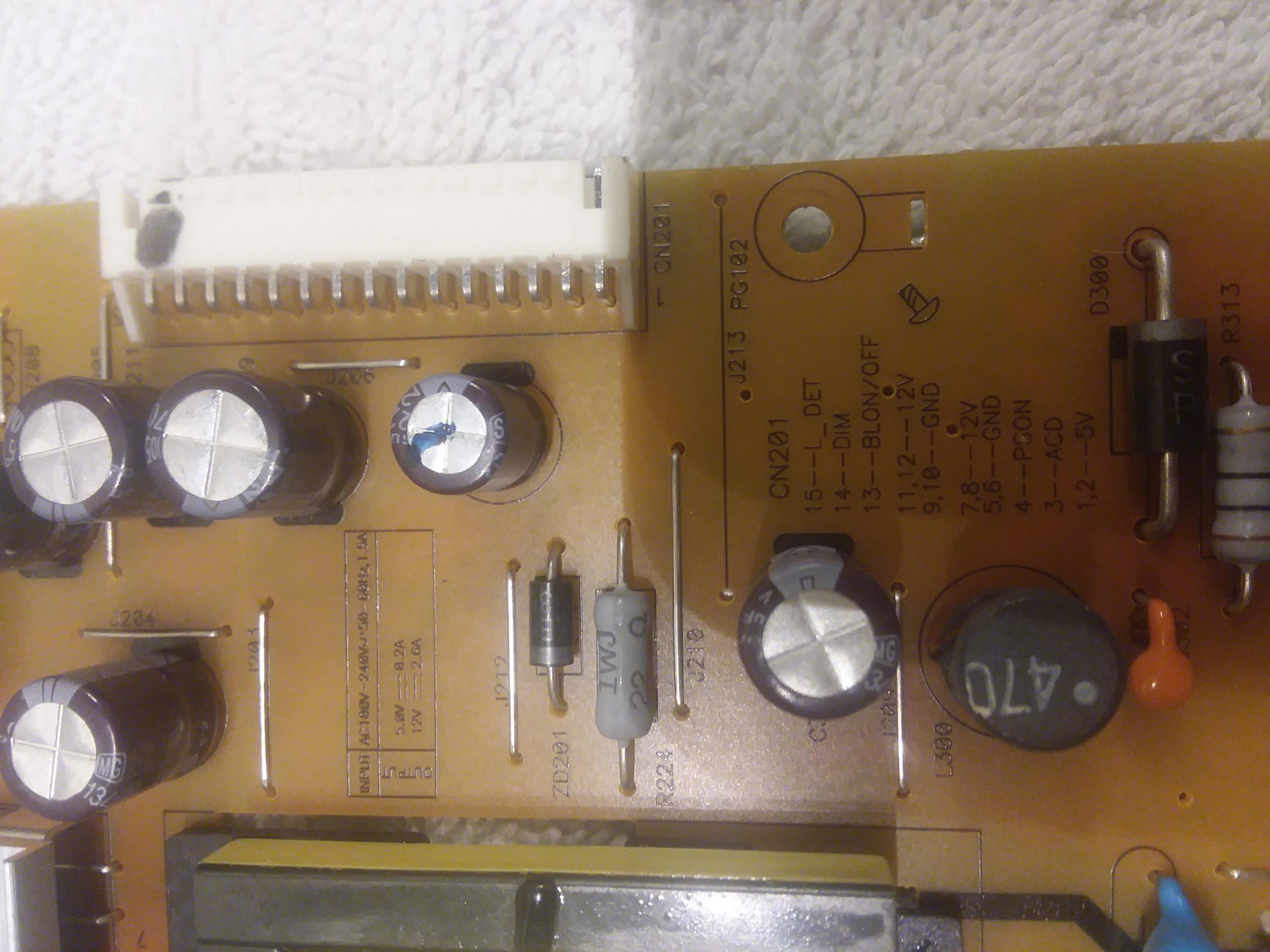

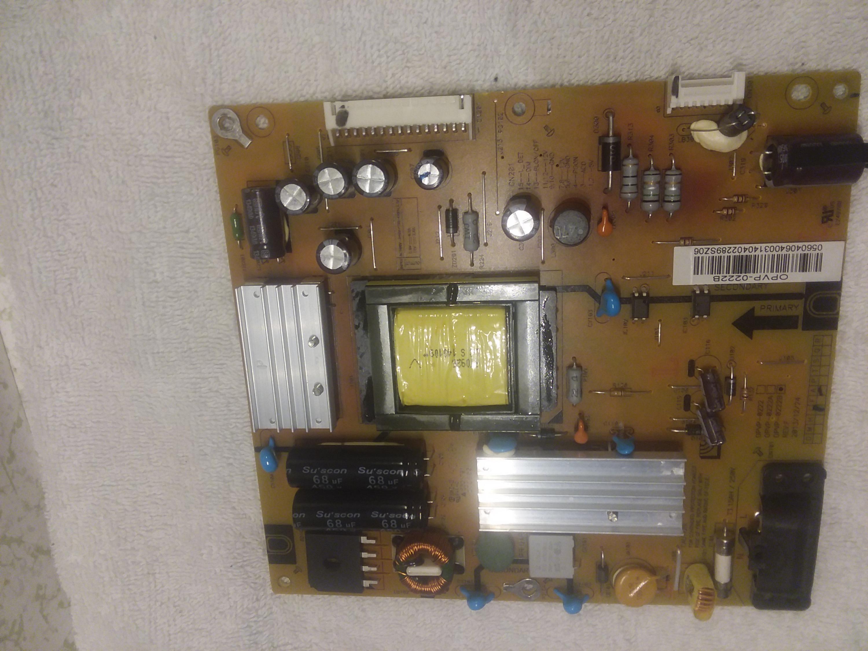

    It's been a while since I've looked for help this time I have a little VIZIO E320FI-B2 power supply was dead ordered a replacement from Ebay and this one is also dead I will include pics of both boards in figuring out how to test the 5 volt side for standby the replacement power supply is not as dead as the original one I have voltages at the capacitors waiting to be turned on obviously I've checked fuses but I don't have 5v on pin 1 and 2 and I think I'm supposed to and that's with and without the mainboard plugged in
    Re: VIZIO E320FI-B2 dead no standby voltage
    https://assets.shopjimmy.com/media/c...005-bottom.jpg
    https://www.shopjimmy.com/vizio-56-0...pply-unit.htm#
    What Voltage do you have on either end of inductor LB201 with ref to GND?
      Well after sitting for how long overnight I decided to check it again and did do with out the mainboard connected and i now have 5v standby so checked mainboard and showing a short to ground at f2 location
        can we have a clear picture of the whole main board and another one of the location?
          How many Ohms does it show?
          We need pictures of the main board and this 'F2'
