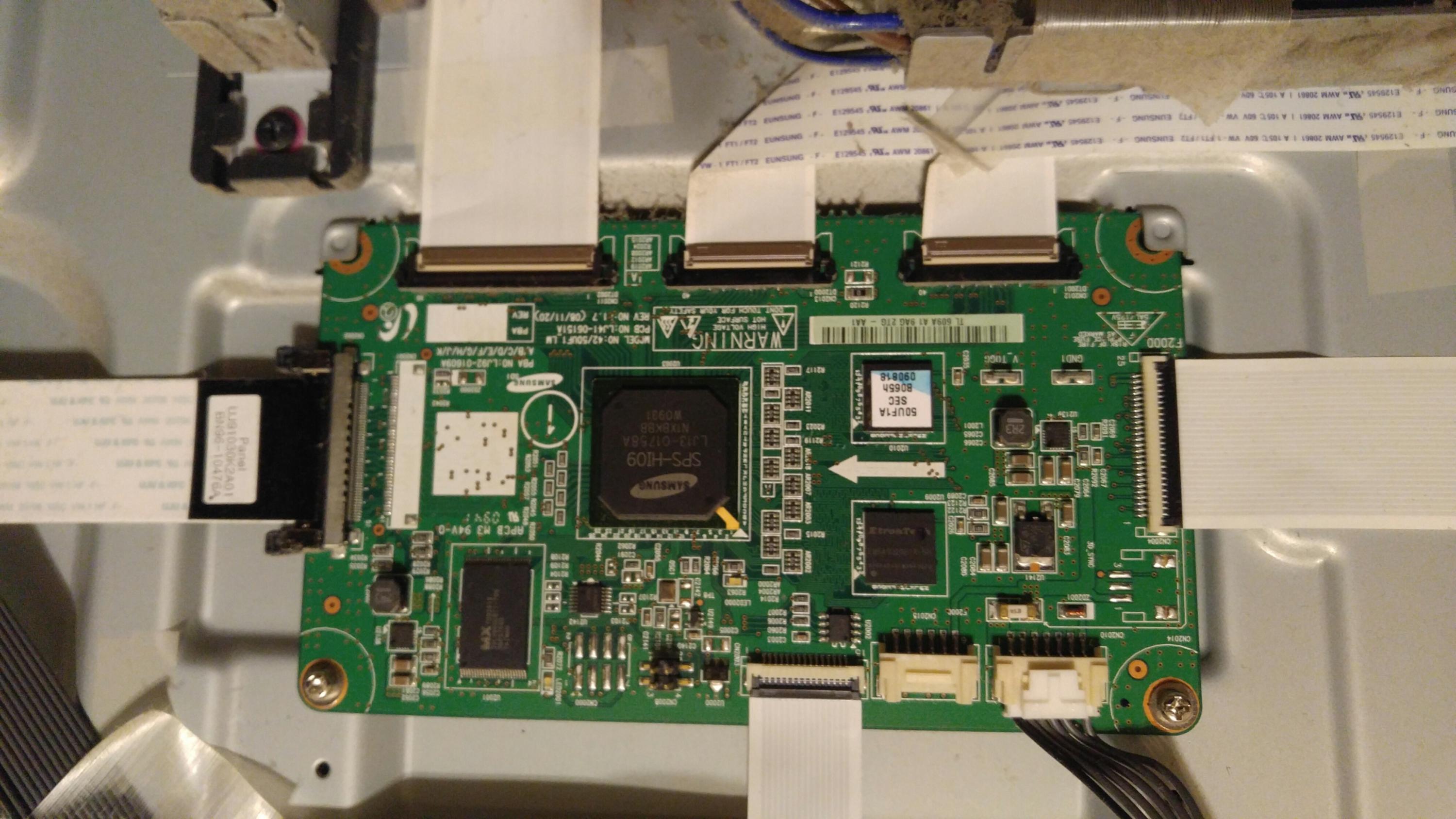

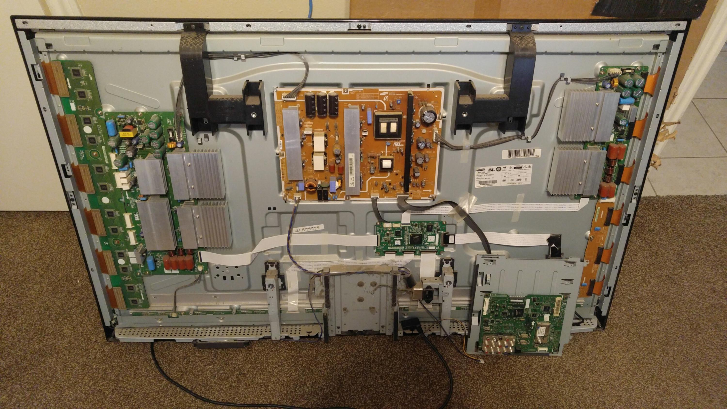

    You have posted almost none of the required information to get help and you repair underway, please refer to guidelines for obtaining help with plasma sets. Post reasonable pics of the whole rear set board layout and picks of the individual boards in the set for a start. Test VA and VS referring to panel spec, Test Vsc, Ve etc also see if Vs and VA have shorts to ground on either sus board.
    Now that said, what I can see of your set and a search on NS-p502Q-10A seems to suggest this is a Samsung with a different badge, so you could try the following remove the flat cable from the Logic CTRL Board to the Signal input board then jumper pins three and four on the Logic CTRL Board. This should produce a test pattern on the pdp if everything else is working correctly.

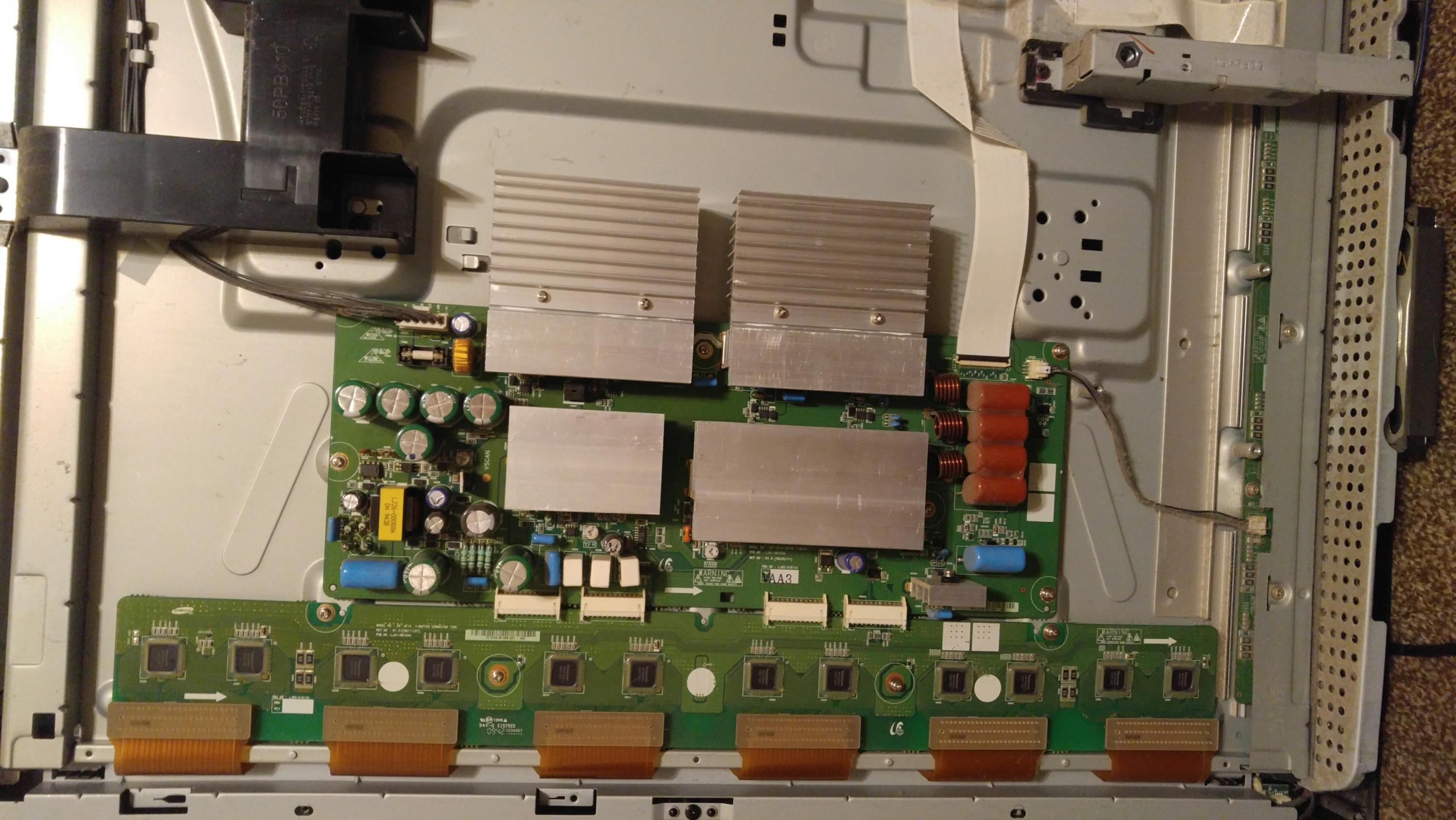

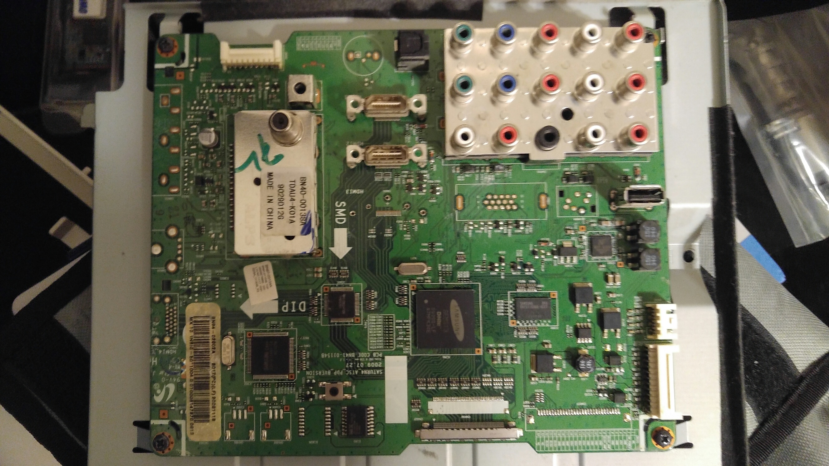

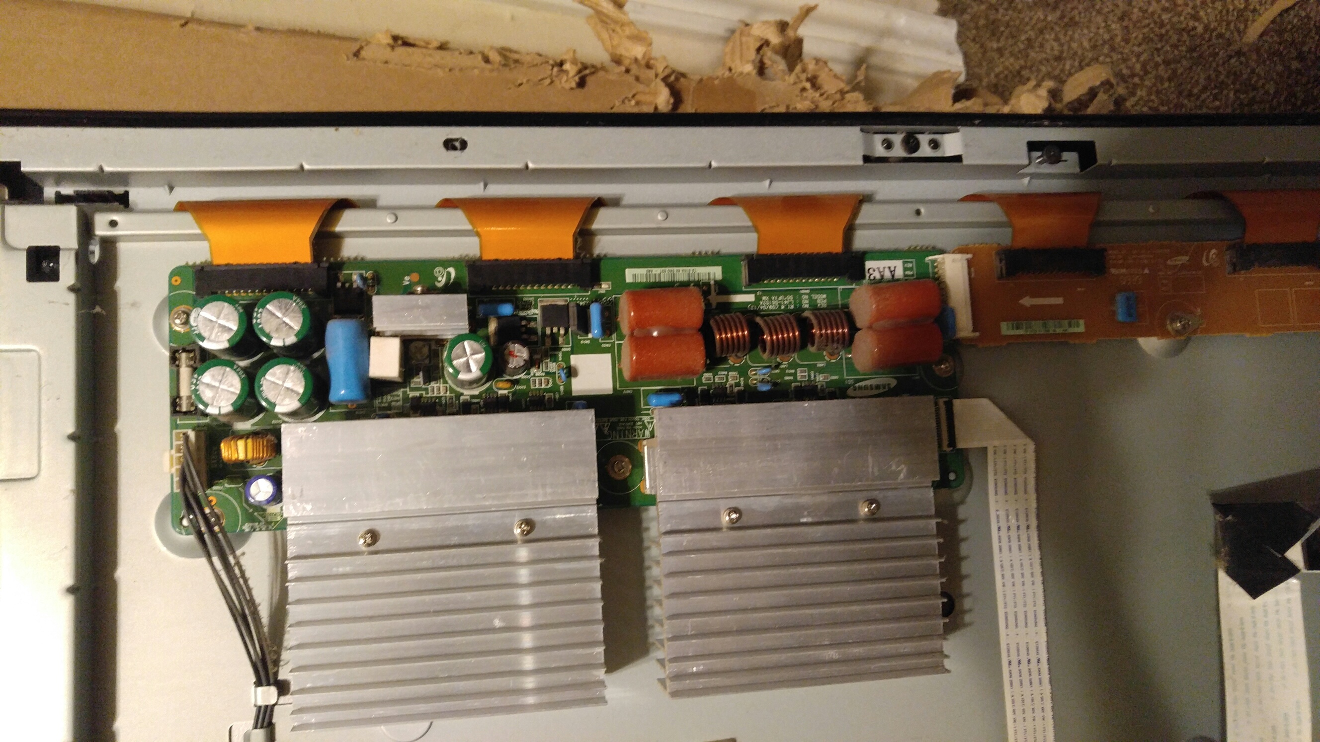

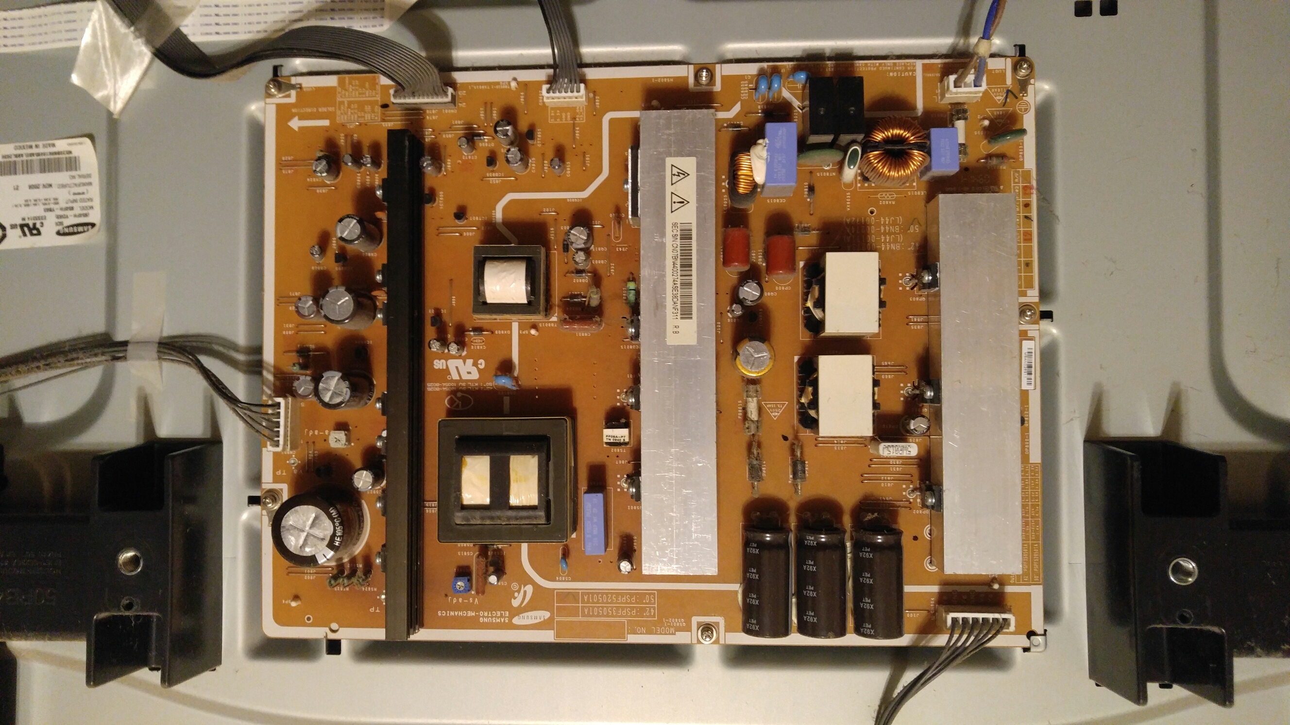

        The model is a NS-P502Q-10A. I've attached pictures of the TV as well.
        Shorting pin 3/4 did not display a picture. One interesting thing I found was that with the power (and control/data cable) disconnected, the TV did not make any noise. When connecting only the power cable from the PSU to the input board, the TV powered up/on and continued making the noise. Additionally, the input board needs to be connected to power, and power only for the IR to work.

                        when you say the "the panel itself" are you meaning the "physical panel" or one of the boards on the panel is making the sound? ... I can't tell from the video.
                        Use a paper towel card board tube or otherwise to your ear and see where you can isolate the sound from and go from there.
                        Further, on some designs (panasonic in particular) have grounding issues which may generate buzzing....BUT this "fault" ultimately takes out some of the components as the grounding is lost to some of the FETS used to power the display.
                        The voltage labels on the power card are not legible... can you improve and identify which you have checked. Same for the main board.
