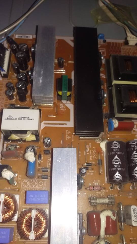

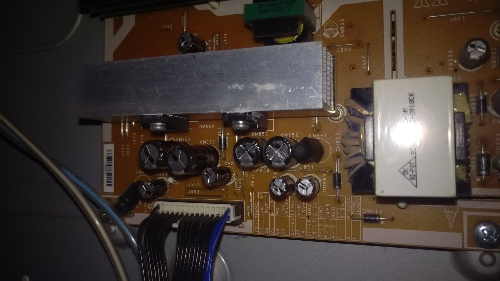

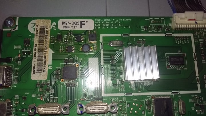

    My Samsung LN46B540 will continually turn itself off and on.
    This will only occur when there is an active signal being broadcast.
    If I leave the tv on with no signal source, just a blank "no signal" screen, it doesn't experience any issues.
    However, as soon as I connect a source, it will start turning itself off and on again.
    It started about a year ago. After not using it for a month it started working again. Now the issue has re-occurred. It will turn on for 5 minutes, then turn off for 5 minutes, then on for a second, then off for 5 minutes, then on again, etc etc.
    I opened it up to have a look at the caps. I didn't notice any leaking or bulging in any of them, but I'm no expert.
    What do you guys think? I'd like to know if I should attempt to replace the caps, or one of the boards.
    Thanks!

              What is the power supply/Inverter board P/N? BN44-?????

                  Re: Samsung LN46B540 turns off
                  Yes the power board/inverter is a BN44 00265.
